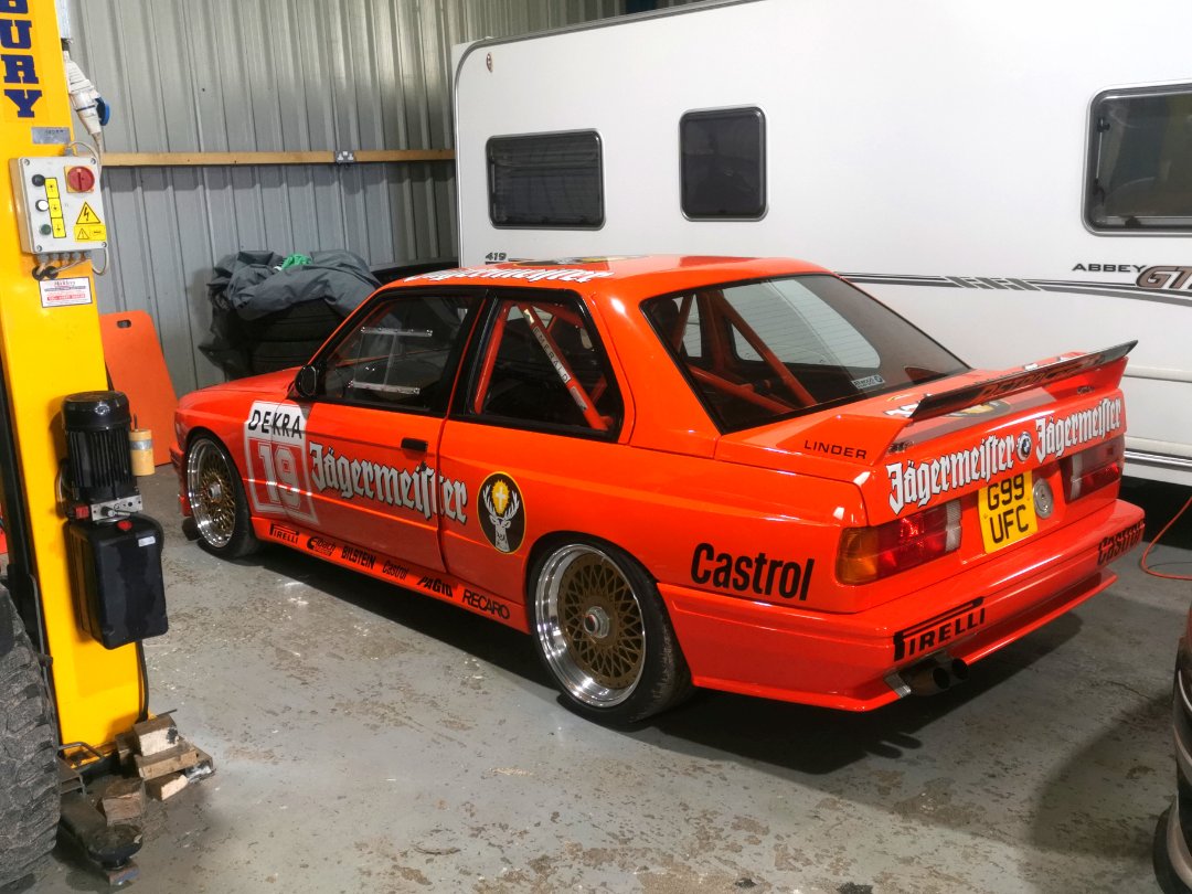

It would seem someone mistook your Jägermeister one for a real one!
http://www.motorverso.com/bmw-e30-325i- ... est-thing/
yes just read it, that car is still for sale at about 5 k if I remember right, about the price of a decent cage and paint job some people just don't realize the cost of building one of these cars and the problem of locating the parts
