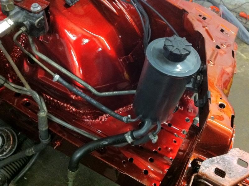

over christmas i had the hydro braking system fitted,this is used in the 740i(e32) and 540i(e34).
after some fabrication i then had to strip it down and then repaint the engine bay.
Here are some pics-
this week i put the engine in to see if the manifolds i bought cleared,but unfortunately they didnt so then we took it back out to take the manifolds off.
now im going to fit the engine in,then drop it off to a mates place to have the whole system hand built.
going to cost around £2k but no point cutting corners.
more to come!

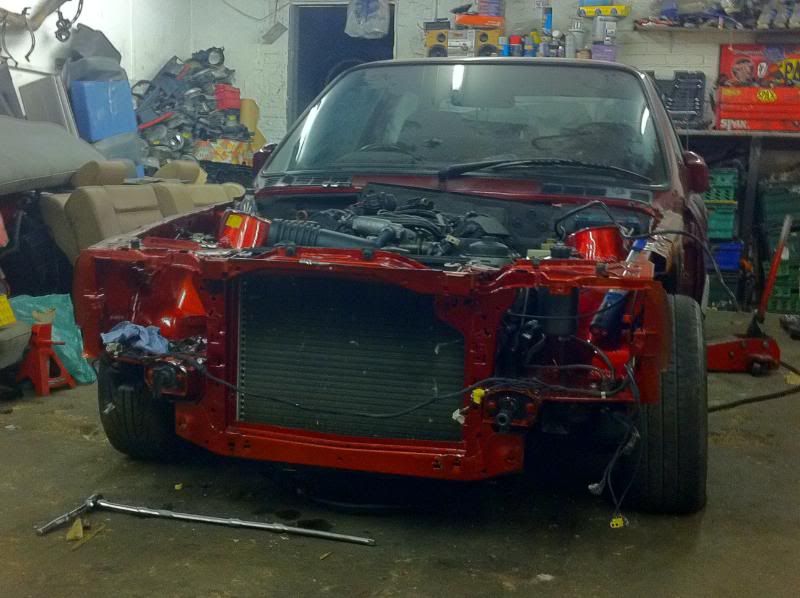

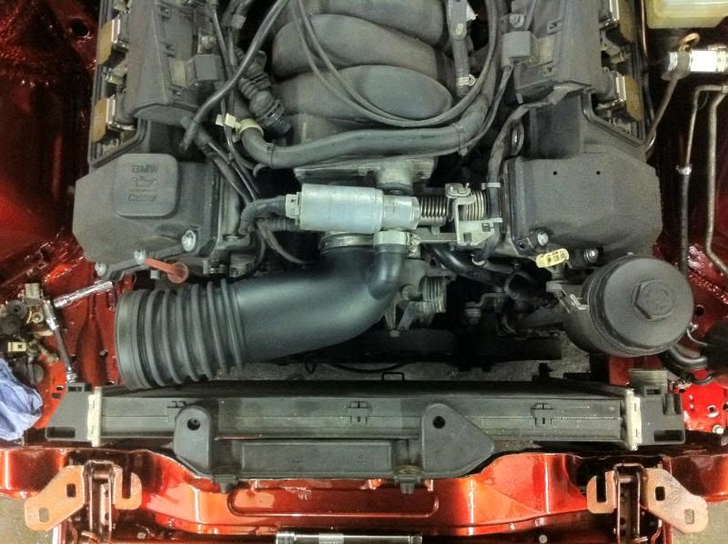

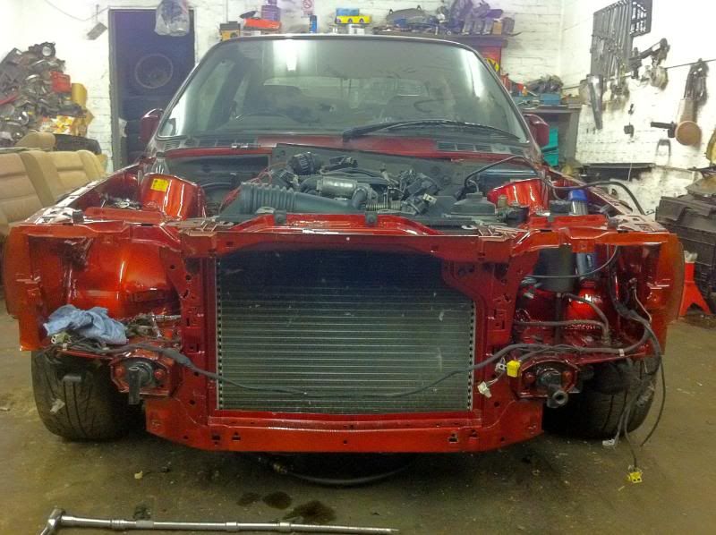

guys havent updated this thread in ages,but alot of waor has been done.
so here are the updates-
engine went in,i found a wiring diagram off my old one,wired it up to see if it all starts etc,and it did,so just need to neaten up the wiring in the engine bay,and then move onto the coolant pipes,and fitting the electric fan.
as you can see the clearence between the hydro servo and the head in very close,but enough clearence,id say a PREFECT fit!
Engine ready to go in
All brake lines re done.
Engine in!
I then managed to get hold of STRAIGHT calypso red wings and bonnet,fitted them.
I got my LSD back from a mates mate who rebuilt it for me,ordered some B373 LSD oil.
Then my wheels had arrived from germany,i tried them on,and obviously arch modification was need at the rear.
The wheel specs are-
Fronts-17"x8.5J ET-15 Tyres-205/40/17
Rears-17"x10J ET-14 Tyres-245/35/17
I rolled both rear arches,then had to use a skim of filler,heres how i far ive got with one side
