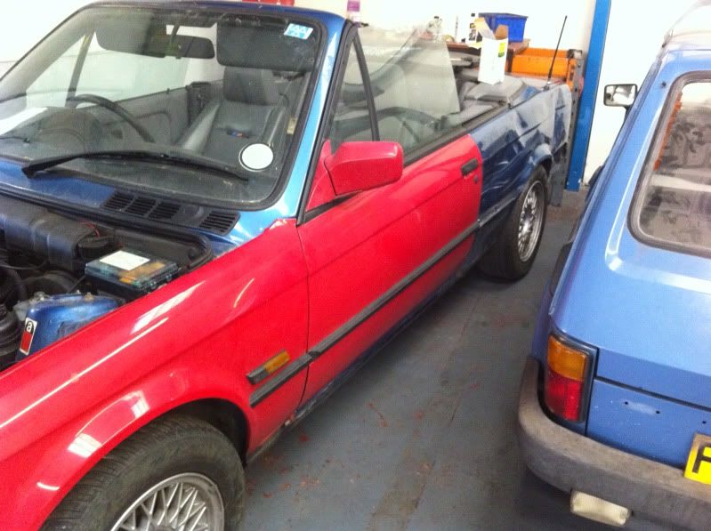

got abit of time today so i put the door on:
Didnt take me that long and it was quite easy to line up but i found some rust so i might repair it or get another one.
When i got the car, i found someone had chopped the left side electric window switch wires which is quite annoying as i wanted to spend more time on the body. Heres the wires and the parts i robbed from the doner:
i went to Maplins to get some wire shrink wrap but only bought one sizes thinking it would be okay but some of the wires needed tape, not ideal but it does the job:
The drivers side front indicator didnt have the plug so i soldered a new one on:
Fitted the bumper on, the original one was bent so i had to put the red one on, only temporary until the Mtech 2 goes on:
Turned all the lights on, only 2 bulbs needed, one indicator and one fog. Didnt replace the fog light as i will do it when i take the valance off:
Tried taking off the rear bumper but bolt wont come out so im going to have the take it off in a different way.
Hopefully be able to do some more tomorrow.

l16ydl
Posts: 404
Thu Feb 10, 2011 7:03 pm
Well, after a few days of graft, its MOT time. A few pics to go along:
It PASSED!! :D Had to replace a few bulbs and adjust the headlight beam but apart from that, nothing to fail it.
As the car was on the ramp, i had a good look around with Brian, my mate and MOT tester, we spotted a few things. The track rod end had a little play but nothing that would fail the MOT, the fuel pump was very noisy, the car had a few dents in the chassis (maybe where the car has been man handled at Copart) and this bit of rust one the driver's side front arch:
Looks like some more welding!! :x
After the MOT, i decided to give the car a good service. Changed the windscreen wipers and got the stuff:
The oil look quite clean and new but thought i would change it any way. Not too sure how old the filter was tho:
Spark plugs needed changing:
Only changed 3 because one was wrong. :(
Also put some of this stuff in:
I do like to use it and not too sure if it makes a difference but i do like to use it.
Next is the VIC test and get the wheels balanced and resealed.

Cheers, i know it looks odd but good at the same time. When Brian was doing the MOT, he said that the panel should come out with a decent panel beater.
l16ydl
Posts: 404
Sun Feb 13, 2011 11:58 pm
Well, taken it to my friend yesterday and he said it can be pulled out and bogged, only issue with that is getting the panel back on and looking straight! I told him the other option and he said replacing the panel would be alot easier and save alot of prep time. So i need to cut the quarter off the red one and give it to Kevin (my mate) and let him pic it and weld on. But before he does, he needs to put a new arch on which i will get from Hadrian Panels. Will try and do some of this before i go away.
