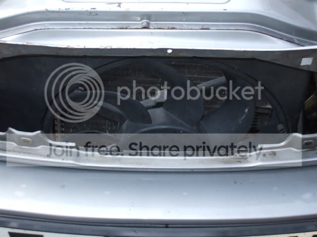

Another update cleaned the engine bay today and fitted the rad and fan while nothing engine wise is in the way. I will upload pics shortly

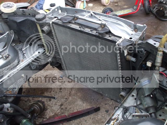

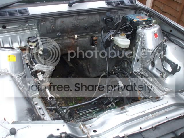

Right then here is some of my progress with this project :D
To start with today i cleaned the engine bay you cleaning homo's got to me and i thought i might as well give it a go

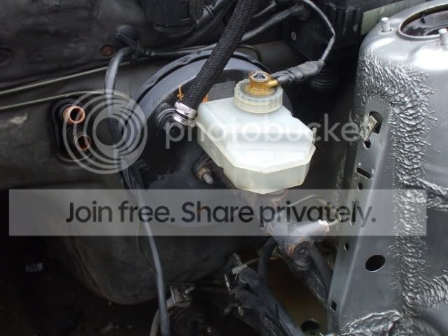

Then there is the Clio servo i fitted this the other day but ive got to take it off again to make the spacer up that goes in the master cylinder and ive got to drill the hole so the e30 pin fits in it
Then i started tackling fitting the cooling fan i had to chop the bottom of this off so it would fit in the front of the touring and i didn't have a grinder so i used my old mans stihl cutter :D
Then i took to chopping up the rad mount on the n/s to get the rad to locate on it cant be arsed messing around in the boon yard for bits like this
And thats it for today i should have the sump back on the engine tommorow and then i can get on with fitting the E36 steering rack :D

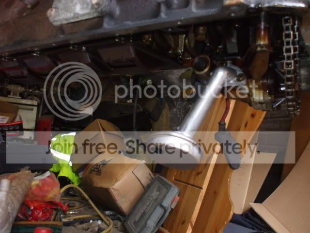

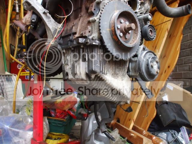

Only had a couple of hours spare this afternoon so ive fitted the E34 oil pick pipe and the sump im glad ive done this now and not when its on the car i did enough swearing with it on the stand
then the sump

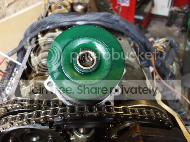

Then i pulled the water pump out and to my horror found a plastic impeller type pump that does not look that old but its still going in the bin in favour of a metal impeller one
Thats it for today not got much planned for tomorrow except for taking the fuel tank out of the breaker so i can fit it in my dads new E30 oh the joy's of E30 ownership :(

Euro sell the better water pumps, I will get one ordered if you want, will drop that UJ round tomorrow if your about 8)
town325i
Posts: 7050
Post Tue May 11, 2010 9:48 pm
Dan would would be bloody good if you could how much are they?
Dezzy
CR24v it's a lifestyle
Posts: 11974
Location: Middlesbrough
Post Tue May 11, 2010 9:51 pm
I think I have a good second hand one if it's needed :D
Posts: 28649
Post Tue May 11, 2010 9:52 pm
£35 - £40 Shall I get one sent out for tomorrow?
town325i
Posts: 7050
Post Tue May 11, 2010 9:54 pm
Yeah get me one Dan might aswell do it right the first time

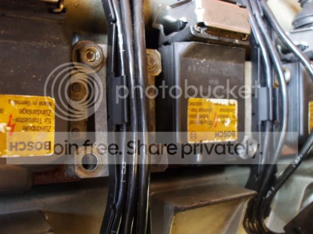

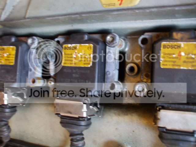

A big thanks to Dan for his work on my engine today he came round and fitted me a new set of seals for my vanos gear and he done these just in time as the old had fallen apart and this would of lost me power and cause all sorts of trouble.
Now for a couple of questions ive put the rocker cover back on with a new genuine gasket, got the nut out i dropped down one of the spark plug tubes put the plugs in and i seem to remember there being a thing to link the coil packs i just have a gap
I was thinking there should be something like the thing that hold the plug wires on? Am i right in thinking this
I hope i havn't lost these bits
Posts: 28649
Post Thu May 13, 2010 8:02 pm
No those things are just to hold the cable clips, only 2

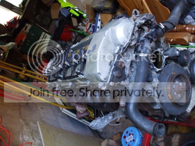

Here's a pic of the engine a bit more back together :D
Hopefully this will be in the bay in the next couple of weeks all ive got to get now is
Rubber engine mounts
Exhaust down pipes to mate up to the e30 one
Fit the E36 air box
wire the cooling fan and get a twin speed switch
then that should be done i think :D
Then its time to sort the rear hand brake out rebuild the lot for a bit
