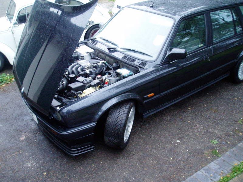

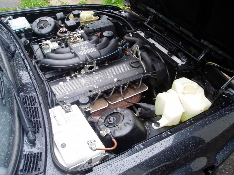

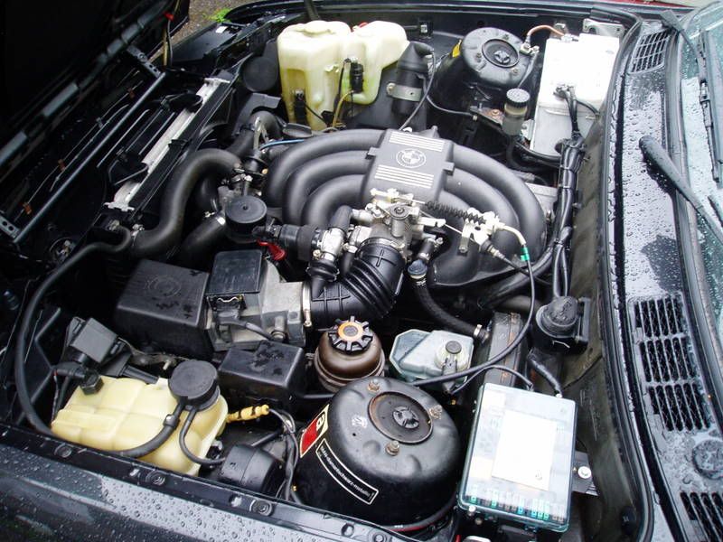

I went to Trevs yesterday B7 and this is really gay but cleaned out all the arches and engine bay and a bit of love on the paintwork
It's come up very well i think considering the milege of 170k. The engine bay was very minging!

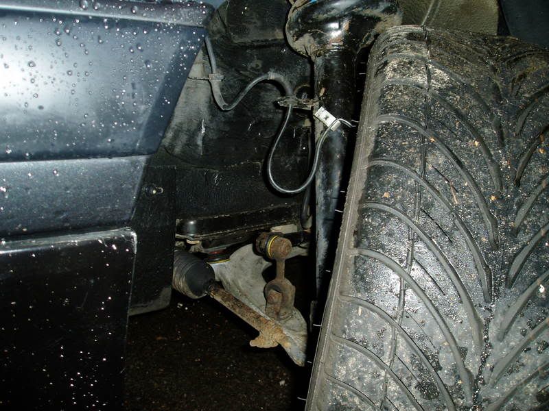

is that wheel arch shot really from the touring turd or was it sneakily swapped from the restomobile???
is there a part no. for those top mounts, need some new ones and they may as well be offset jobbies
toby
- Posts: 3609
- Joined: Thu Aug 11, 2005 11:00 pm
- Location: Kent
Car looks awesome! Engine bay cleaned up nicely. What did you use? I've recently been using a cutting compound to clean up the engine bay paintwork. Getting the old wax of the air filter box is a mystery so far though.
- Posts: 22697
Matt straight up it's this car. they have come up really well.
Toby we used TFR and some degreaser left it all to soak in for about 5mins and then a pressure washer thingy. You need to cover up a few of the electrical bits and not blast it too close. It did lift some paint on the cam cover but it's flakey/f**ked anyway. I must buy one they are great fun! hose pipe in roids.

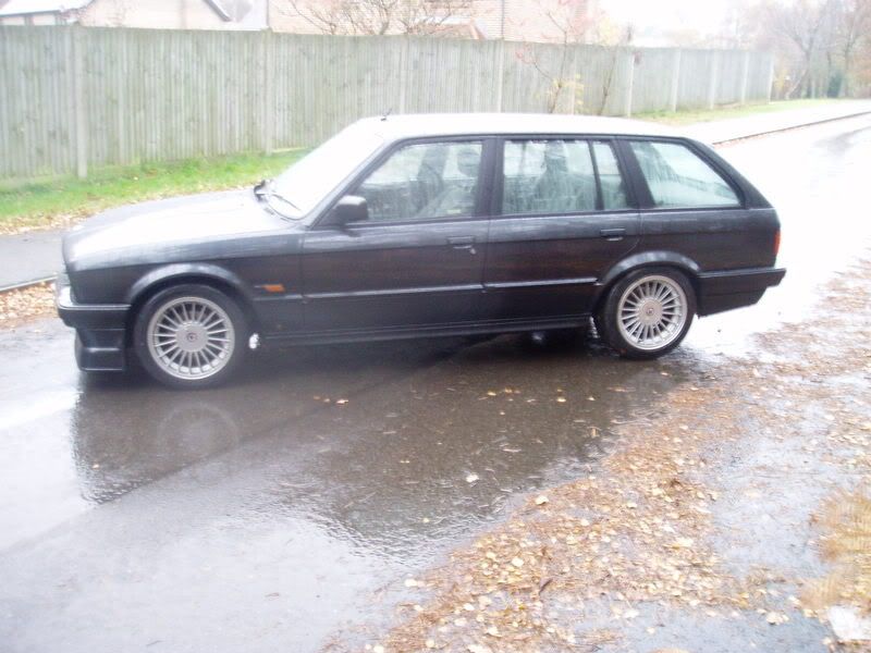

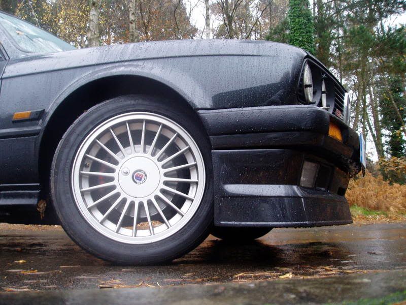

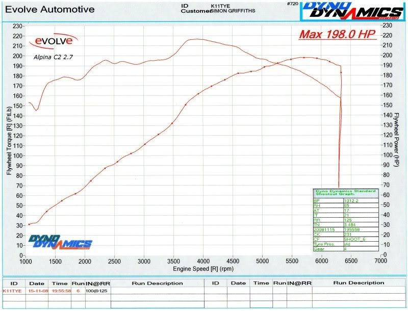

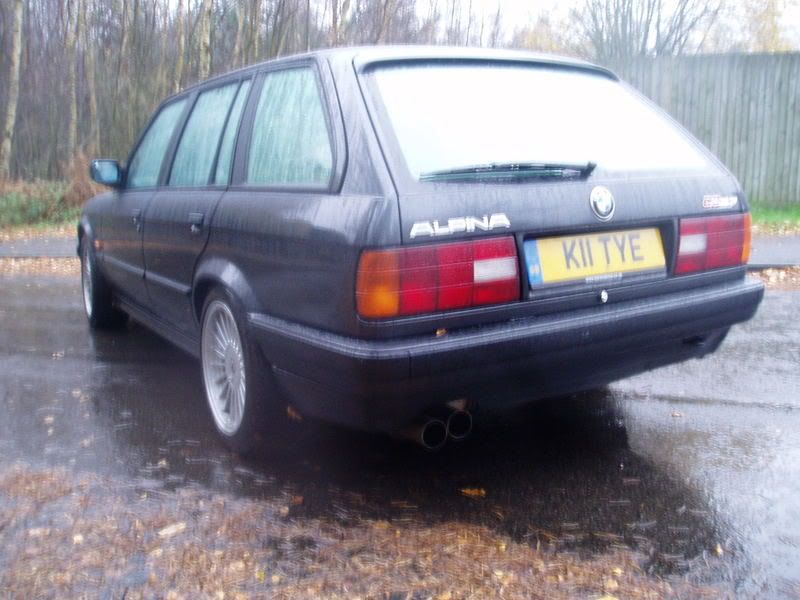

Well it's been a while but i've been busy on the chariot instead of the 2dr recently
Car went onto the dyno yesterday, twice! once at surrey rolling road, then at Sal's at Evolve.
First run at surrey's was done in 3rd gear for some unkown reason and was 185bhp, 185lbs. I was miffed at this seeing as the car pulled a 14.9 1/4 mile at the pod and that aint enough power to do that!
So off i went with Barry up to see Salad. Now Barrys car dynoed on both Dyno's in 4th gear and made identical power on both. This time the car was done in 4th gear and made a more like it 198bhp and 220lbs. Make of it what you will but it feels like the latter dyno run on the road. Barry has the graphs so post them bitch! Fueling is spot on too which is great news
Anyhow i've been busy fixing the central locking today and it's fixed much to my relief, but i battled the rain and fitted my map light mirror for it
Also the Alpina exhaust has been blowing and needs some welding so off it came 2 weeks ago and this went on
Racing Dynamics 6 branch with full scorpion, The backbox is a DTM one but i had the upswepts cut of straight. Me likes. Very loud now too

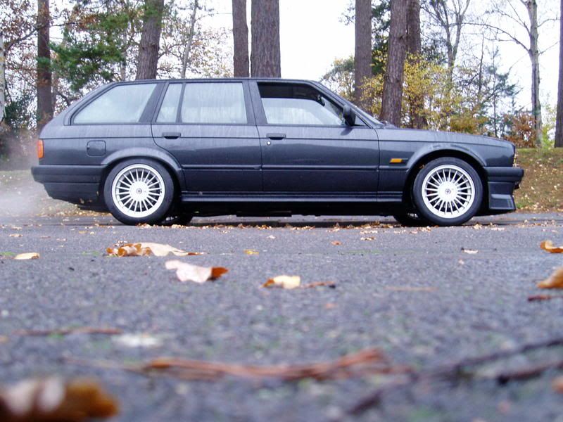

Last week again in the bloody rain, i fitted a new front valance and front spoiler as i had destroyed the old one! plus i'd bent the valance and lost a fog light in a fox incident and she was looking scruffy again!
Few others taken in the rain today
Still loads more work to do still to get her up to scratch but it's coming on nicely and alot better than when we bought it

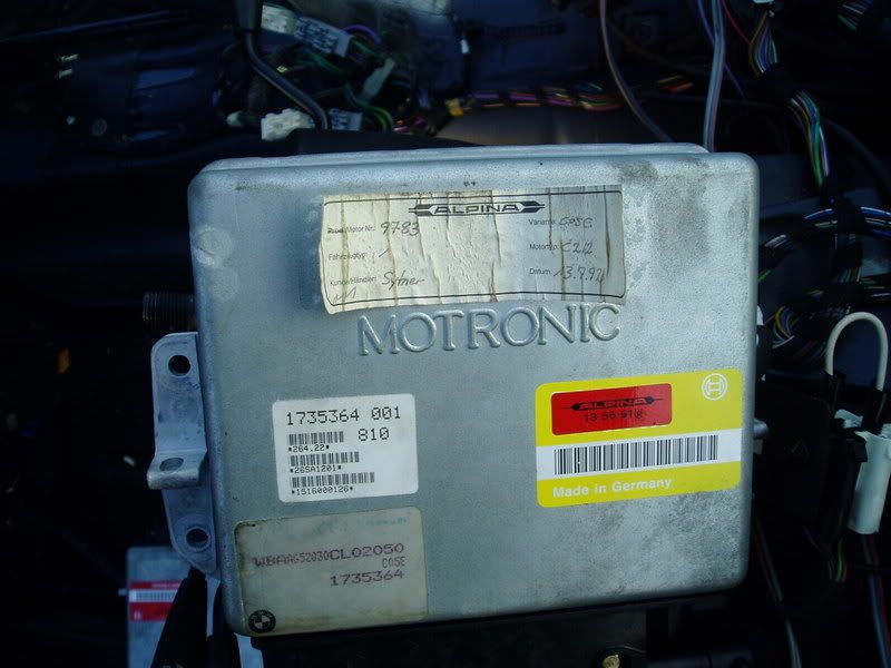

I looked at the ECU today and the date is 13/9/92 on it. my birthday is 13th sept how uncanny! Hence the simon and 13 bit
- Posts: 15846
Si. So the ten pound council back box is on then?
Did you speak to your nan re doctoring those seat parts. Be interesting to know if it's possible and get a minty mint pair of silver fronts out of it.

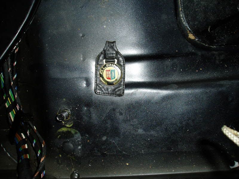

Found this under the carpet!
i've got 3 now he he
ECU i think on the top left is the cars number if it had a dash plaque

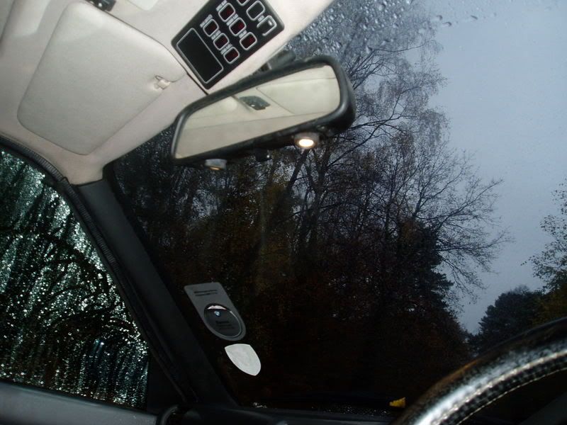

So hopefully 2moro we can sort that wiring and get the 13button OBC in also. Carpet cleaning also but i expect it's going to take a long time to dry and i need to findout where the water is coming in

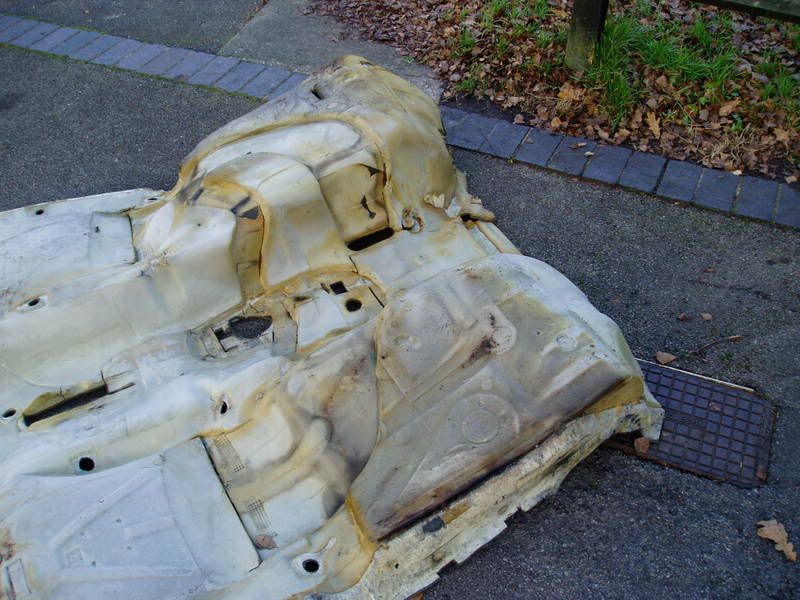

Carpet out and to greet me a bloody swimming pool, the f**king carpet is soaked, so i've got a leak somewhere!
