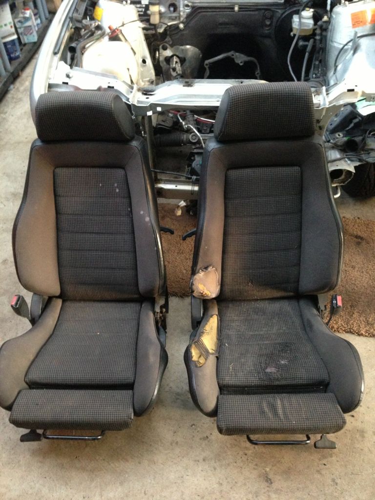

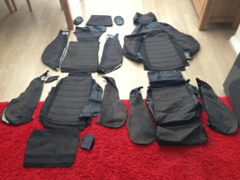

Kedge wrote: Job I'm dreading the most is stripping the Recaros down!
Not a hard job dave,done it on mine,once you look at it,you'll realise how to do it winkeye
Kedge
Posts: 7698
Post Thu Jan 17, 2013 8:01 pm
I've done Sport and Comfort seats but never touched Recaros. In theory they should be similar I suppose.

Away from actual work on the car there's been a development with the interior, was totally unplanned. Originally I was going to be using my Houndstooth Recaros and retrim them in fabric I had.
However Ferg tipped me off that Barry was selling his leatherzzzz winkeye
It was an opportunity I couldn't bring myself to pass on even though I'm not a big leather fan, the man above has since quickly relieved me of the houndstooth and I think has had the horn in all week :chuckle:
