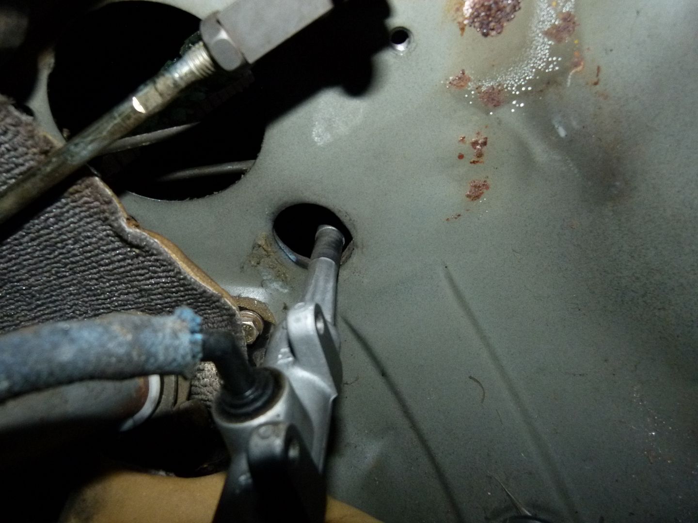

Cypriotgeeza wrote:Quick one peeps
Just looking at the scrapper and i noticed this..am i going to need to do this to make the 3.5 fit?! (obviously not in such a crude way)
No mate
Thats some caveman business
No idea why the tunnel is cut either unless the wrong linkage was used, you need E30 325i.
Cracking progress btw and i love dressing an engine up to make look nice
Which exhaust manifold you got for it?

leeparkes wrote:Cypriotgeeza wrote:Quick one peeps
No mate
Thank fuck for that! I was telling my dad id rather get a custom exhaust made up then smash the car in like that
The manifolds in the pics if you scroll up..like everything else with this car who knows where it came from haha

agree with Lee, you should not need to touch the bulkhead, it's a tight fit but there is enough room. Also the 325i linkage fits perfect in the right place exactly.
Great updates, got to love an M30 build, proper hero's chariot !!

Thank you mate! I was thinking the same thing and i just kept thinking nooo way was i taking a hammer to any part of this car! Lol
Not sure on the linkage but i will check part numbers and see what i have lol
Frankenstein strikes again!

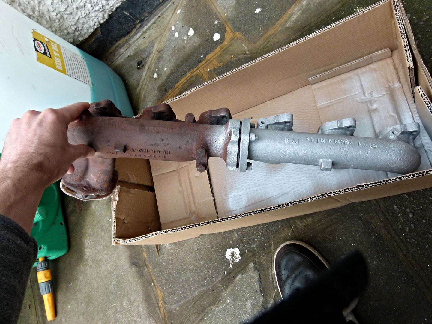

Cypriotgeeza wrote:
The manifolds in the pics if you scroll up..like everyhin else with this car who knows where it came from haha
Cant see em bud? Exhaust manifolds?

No, seriously, thats probably why the bulkhead got smashed in to fit that manifold, its best to use E34 manifolds and downpipes that 'sleeve' into an E30 325i system perfectly.
Look like this....

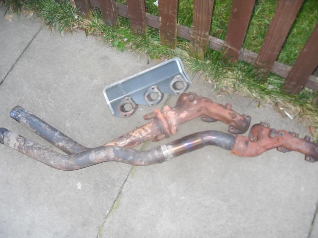

leeparkes wrote:That looks nothing like mine! lmao
Look like this....
so yet again where the hell did this manifold come from?!
good old Frankenstein!
hmmm so now i need E34 manifolds?

I may be wrong but i think there E28 manifolds
You will need the downpipes too to mate up to your exhaust.
