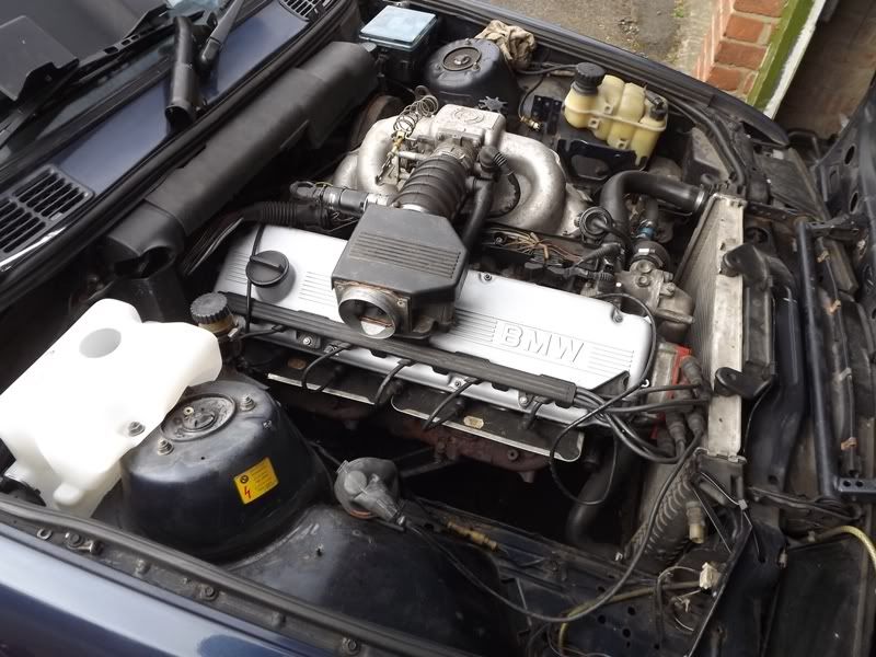

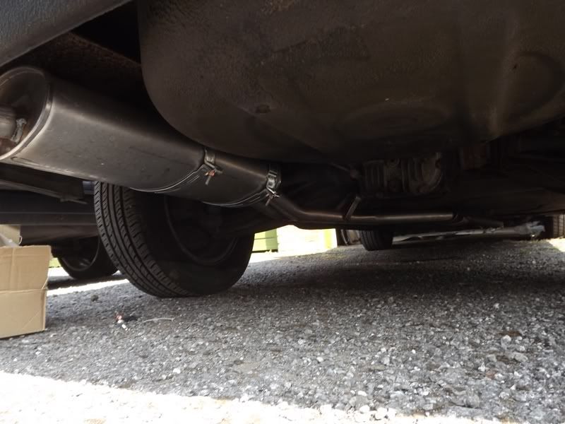

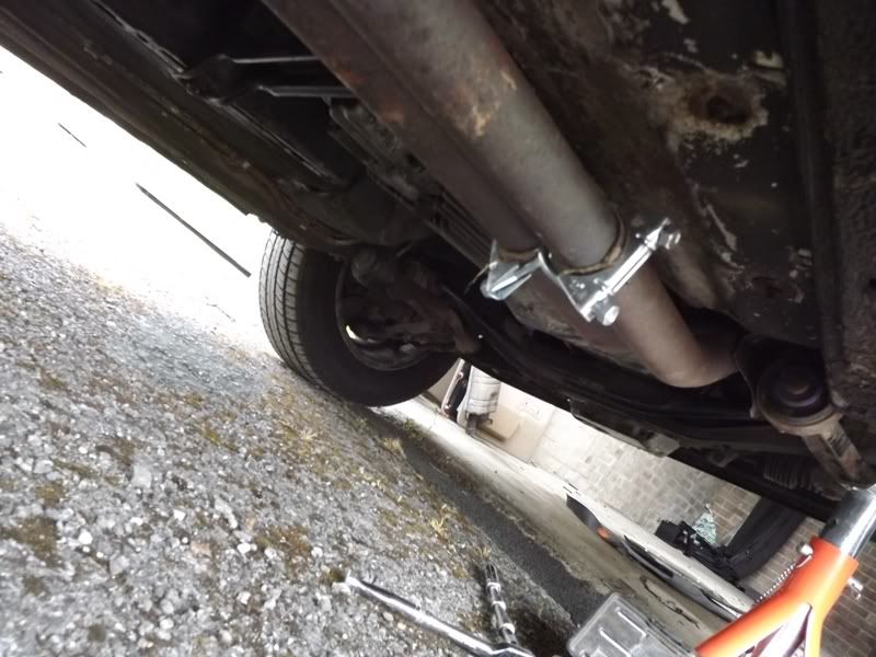

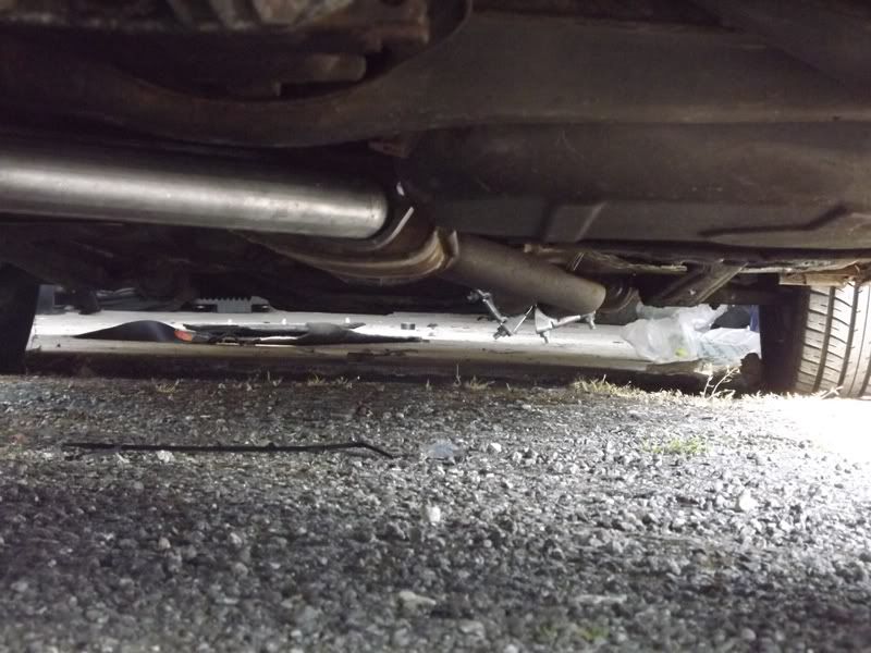

Finished exhaust today, however seems quite loud ? is this because the exhaust technically is not made for that engine ?
Also the down pipes knock of the bodywork :?
anyway i can now MOT it, not convinced it will pass but hey ho
not happy with the way the front sits but its missing the bracket
M3 battery panel wont fit with a diesel washer bottle so i used the small 4 pot wiring cover

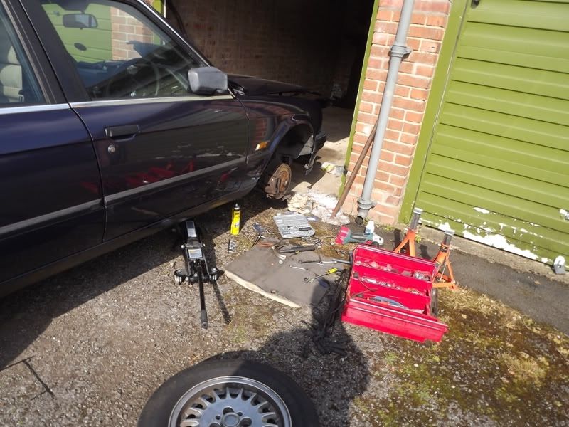

had a look at the grinding noise, there was a bolt that had came out to hold the caliper on :mad: managed to to a temp repair for mot
Sun May 20, 2012 5:59 pm
Here is a video sounds shit to be honest, not convinced the engine is running right either, i'am wondering if its got the right temp sensor in?

3 out of 6 cylinders aint bad I suppose. :D
Sun May 20, 2012 6:32 pm
Running on 3 do you think ?
johnl320
Posts: 3125
Sun May 20, 2012 6:36 pm
Mate that should be smooth as silk not sounding like my single cylinder 350 motorbike, Deffo not on all cylinders, check leads, plugs and injector loom.
Sun May 20, 2012 6:40 pm
are the injector looms removable on these as thats seen crip connection action aswell
:roll:

Bub bub bub bub bub bub bub....
As john said it should be silky smooth, very similar to M20.
leeparkes
Posts: 9538
Location: Black country
Sun May 20, 2012 6:42 pm
Pull the plugs and see what they say.

If i got the crank sensor and the injector thingy the wrong way round would it start ?
leeparkes
Posts: 9538
Sun May 20, 2012 6:47 pm
Pull a sicky at work. :)
leeparkes
Posts: 9538
Sun May 20, 2012 6:48 pm
Alex wrote:If i got the crank sensor and the injector thingy the wrong way round would it start ?
No.
Sun May 20, 2012 6:49 pm
No.
Its not that then, i'am wondering if its something ive done or has always been like that, it is hard to tell with the old exhaust system :mad:

Are the plug leads on the right plugs?
Sun May 20, 2012 6:57 pm
Probably not going by other things ive seen, how do you tell from the dizzy cap side which is what plug
Also does plug 1 start at bulk head and go out or is it the other way around
Sun May 20, 2012 6:58 pm
#1 at the front of the engine Alex
Sun May 20, 2012 7:00 pm
Cheers Lee will have to check that
Hope i can have it running right for York :(
When i remove the oil cap nothing changes, so must have an air leak too

Dizzy cap will be identical to an M20 one (same part number) number 1 is nearest the dizzy and 6 is nearest the bulk head.
Cant remember the order they fit on but the numbers should be printed on the cap somewhere.

What else is worth checking, can faulty temp sensors cause it to drop a few cylinders ?
leeparkes
Posts: 9538
Sun May 20, 2012 7:22 pm

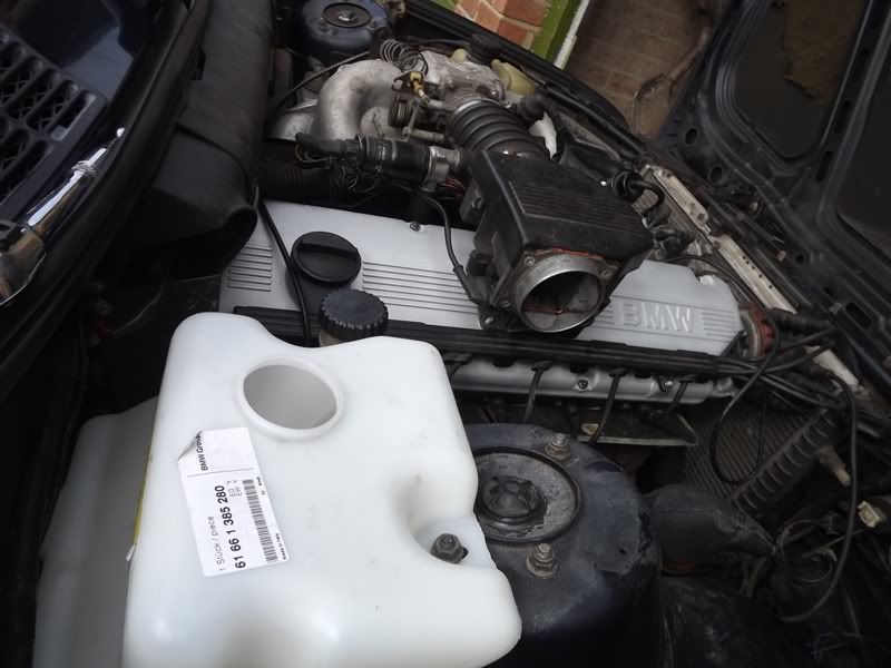

For a start it looks like you have M20 type leads on it, where they connect to the dizzy they should be angled like this.
They may be aftermarket? to test the leads they should read between 5-6K ohm from end to end. King lead should read under 2K ohm.
