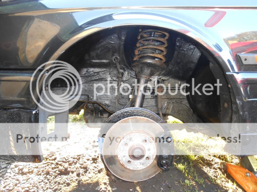

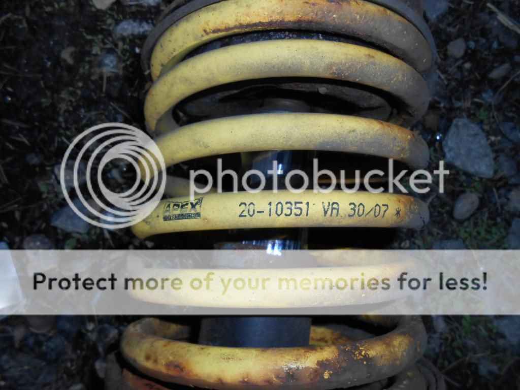

Slowly getting there with this. :cool: 3 out of 4 springs are now on :mad: Passenger rear still to do which I will get done tomorrow now :cool: Then i'll get the driver rear off again and just give it a quik clean up for now as didnt bother when I changed the spring and now wanna underseal it all.
Anyway, got a few pictures.

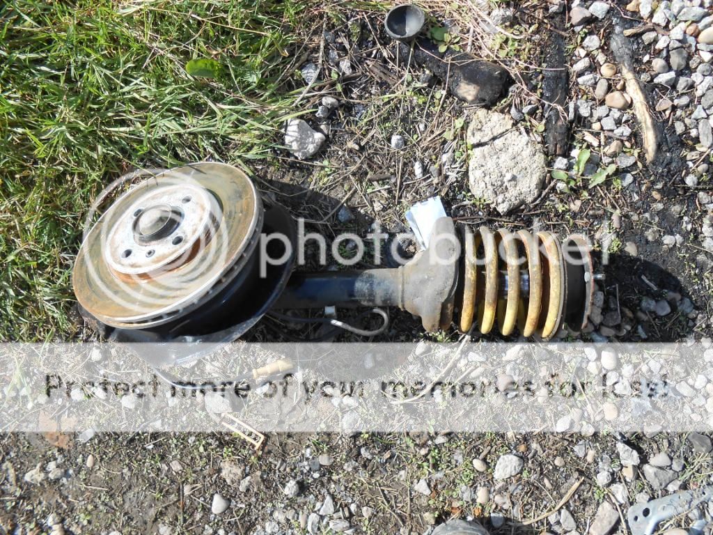

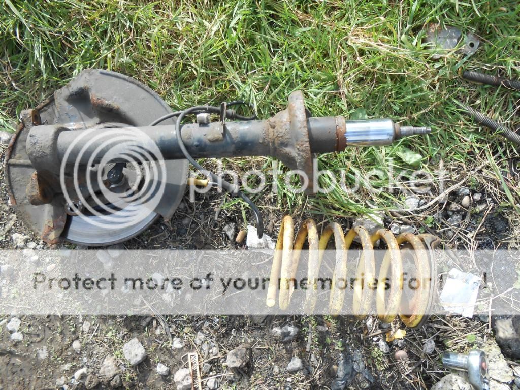

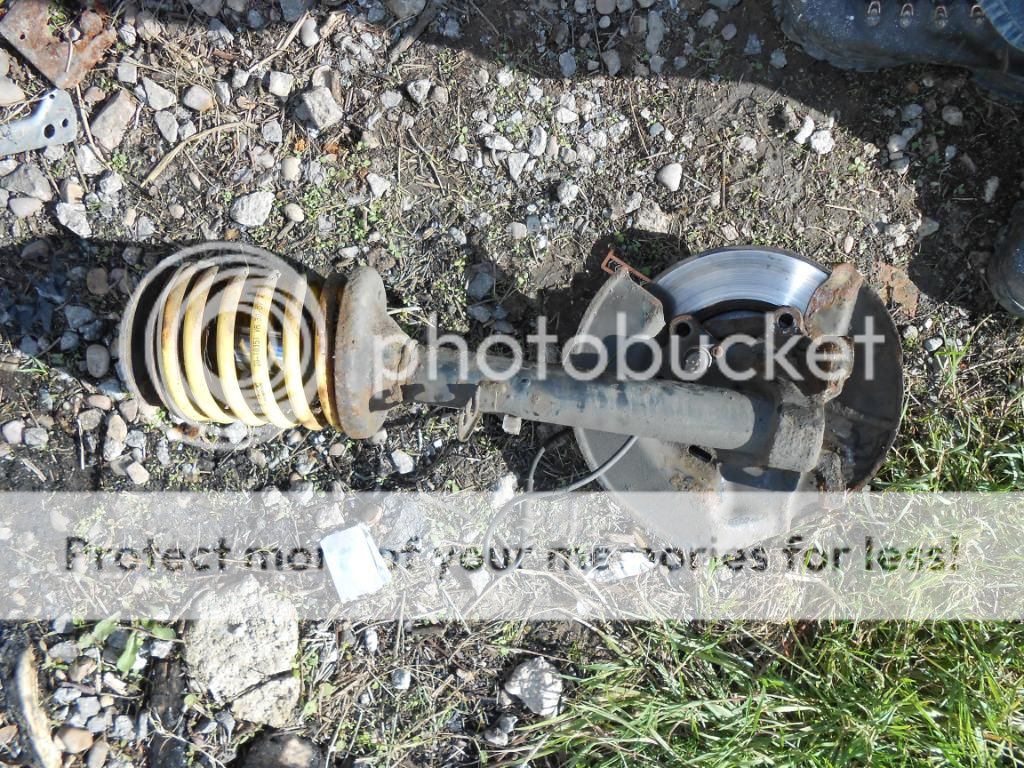

Front Strut
The Shocks are completely shaaagged so the ones from the 4 door 325 chromie have gone on it. Not sure what make they are as I just used the whole strut towers.
I do need to replace both Tie rod ends as the ball joints have splits in them :cry: I've got some replacement ones but will do it when im over my old mans or something so im more local to somewhere to track it up

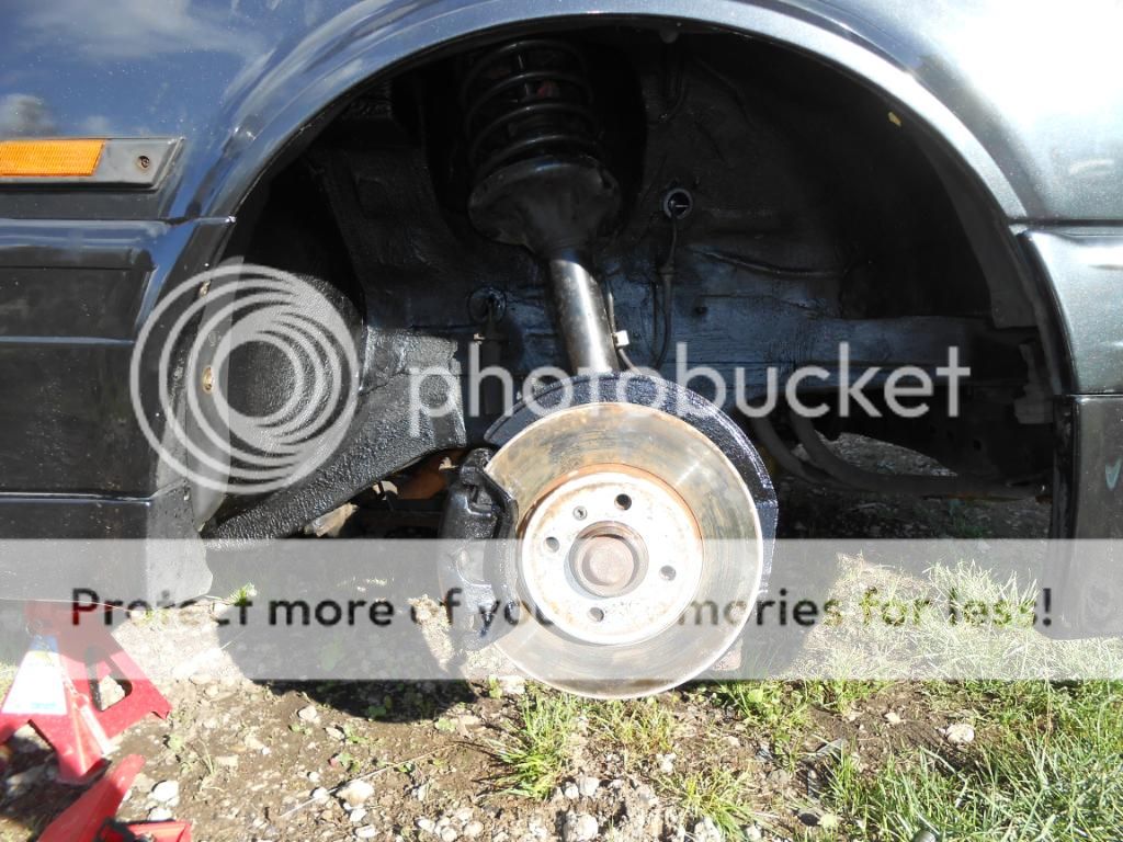

Anyway, cleaned the front arches out, found some scabs. Poked some holes through. Had the kit off the other side too which has the same kinda welds, but looking at it, I would say its close to rare compared to the other Sport I seen on here a moment ago :eek:
Cleaned, Rust 'treated', under sealed and calipers painted up, springs and shocks switched

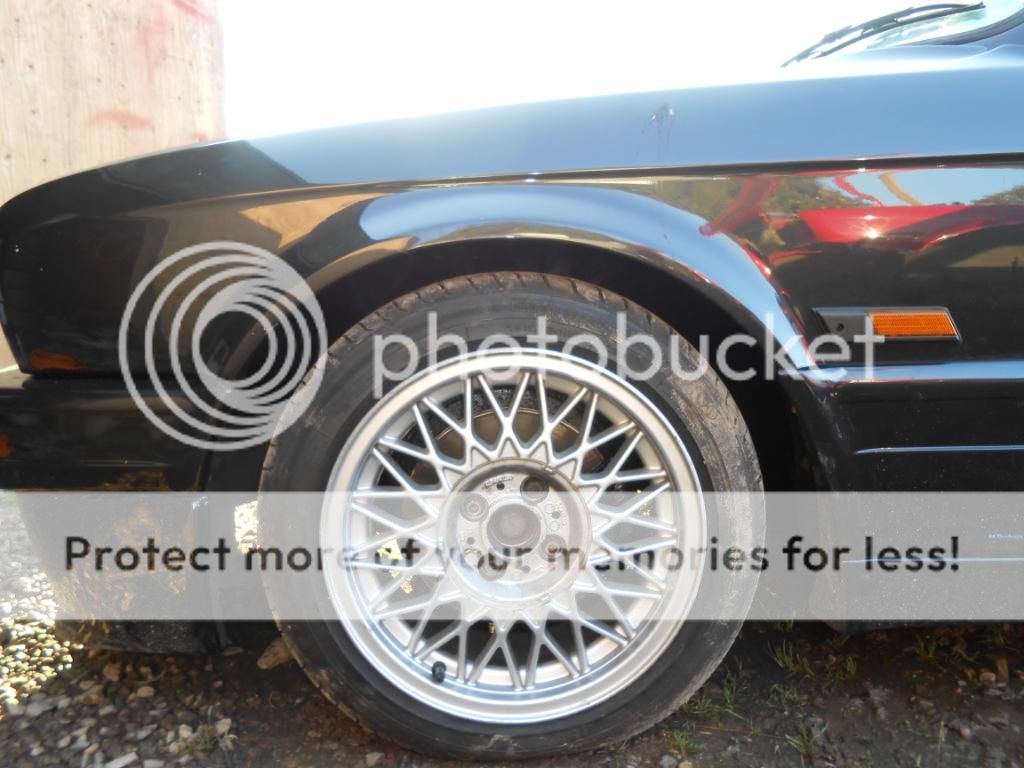

This is how its sitting, keeping in mind I still need to do the rear passenger side
The suspension on the front moves now too :cool:
Tomorrow i'll get the last spring in then have a little drive and see how it feels.

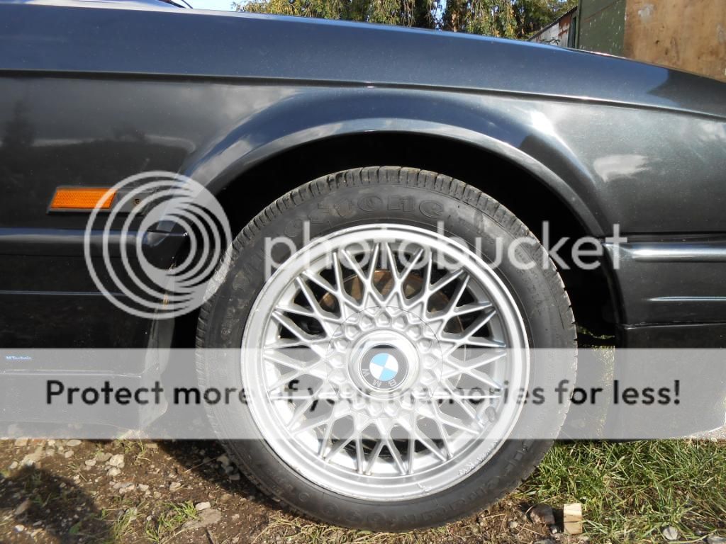

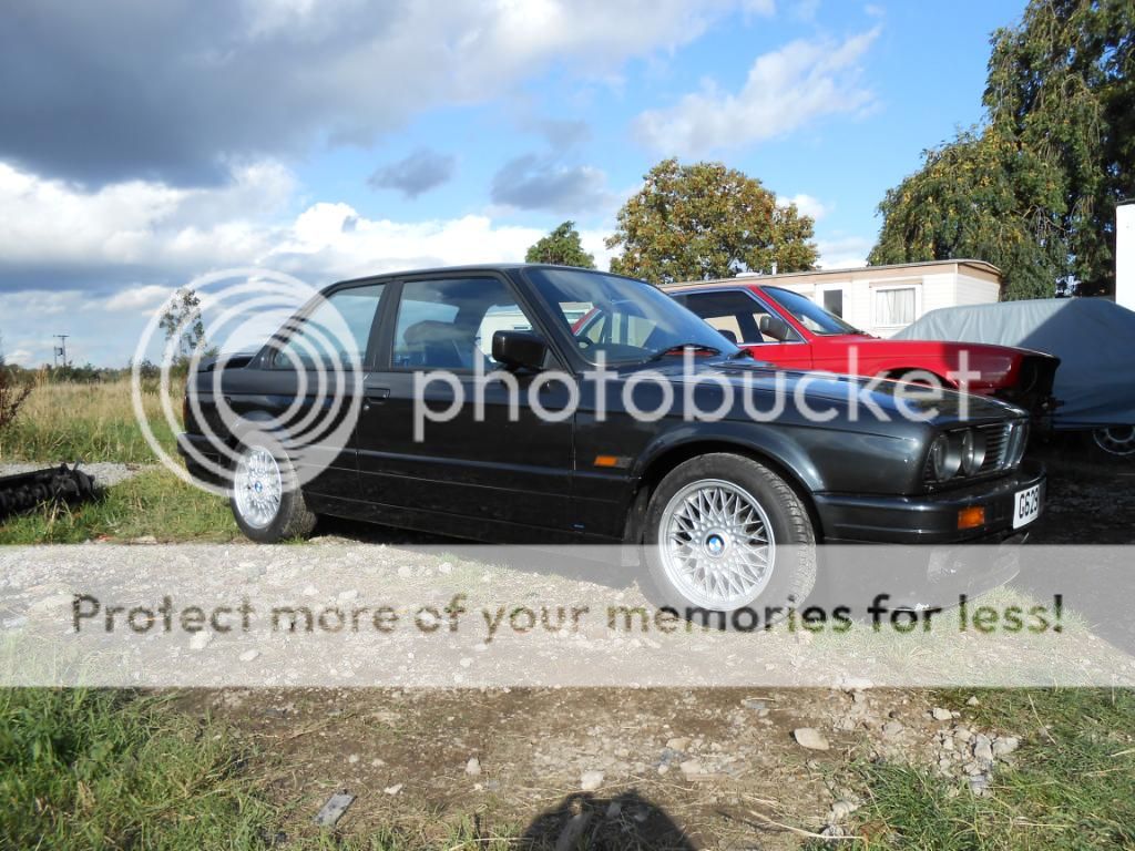

Springs done :cool:
Rear Passenger before
After
Exhaust will be cleaned properly at some point soon too, gave it a quick clean, but not fully.
Got to work on removing those Smoked lights too for the originals, unfortunately the driver side high beam is clouded, tried to wash it out, no good, so gonna get new high beams for both side I think. Standard grills back on too and wiper motors back in place. Need to rob the chromies wiper arms and get some rings too
Rear end now :cool:
Pulled it out and had a little drive up and down the drive way and it feel 100% better :cool: Engine still runs like shiiit though :cry: Which will be one of the next jobs

Just need the correct size tyres on the front now. Looking MUCH better so far!

bss325i wrote:Just need the correct size tyres on the front now. Looking MUCH better so far!
Well spotted :D I've got a few sets of bbs with the correct size tyres on, but all budget brands so wanted to get somethign decent on them before changing them over.
Should have put them on for the pictures though :cool:

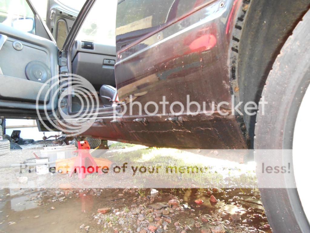

Got some pictures of the scabs under the carpet
Got a few more on photobucket but nothing that great.
Had a look at the scuttle areas too, driver side is set down on the engine bay lip, the passenger side had some news paper clagged on the back of it :? :cry: Bodge baaarstards, the amount of time it takes to bodge, why not just spend an extra bit of time and just fix the issue?

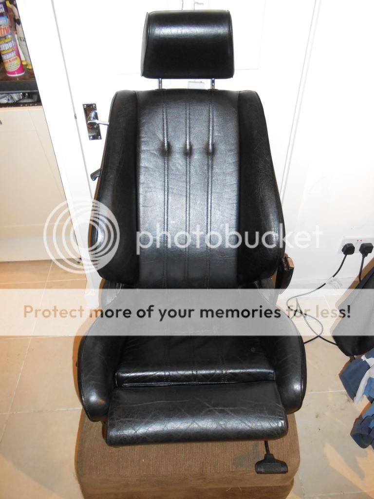

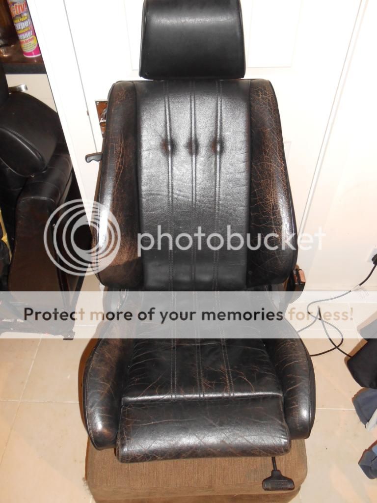

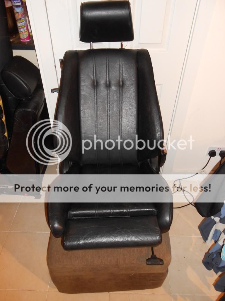

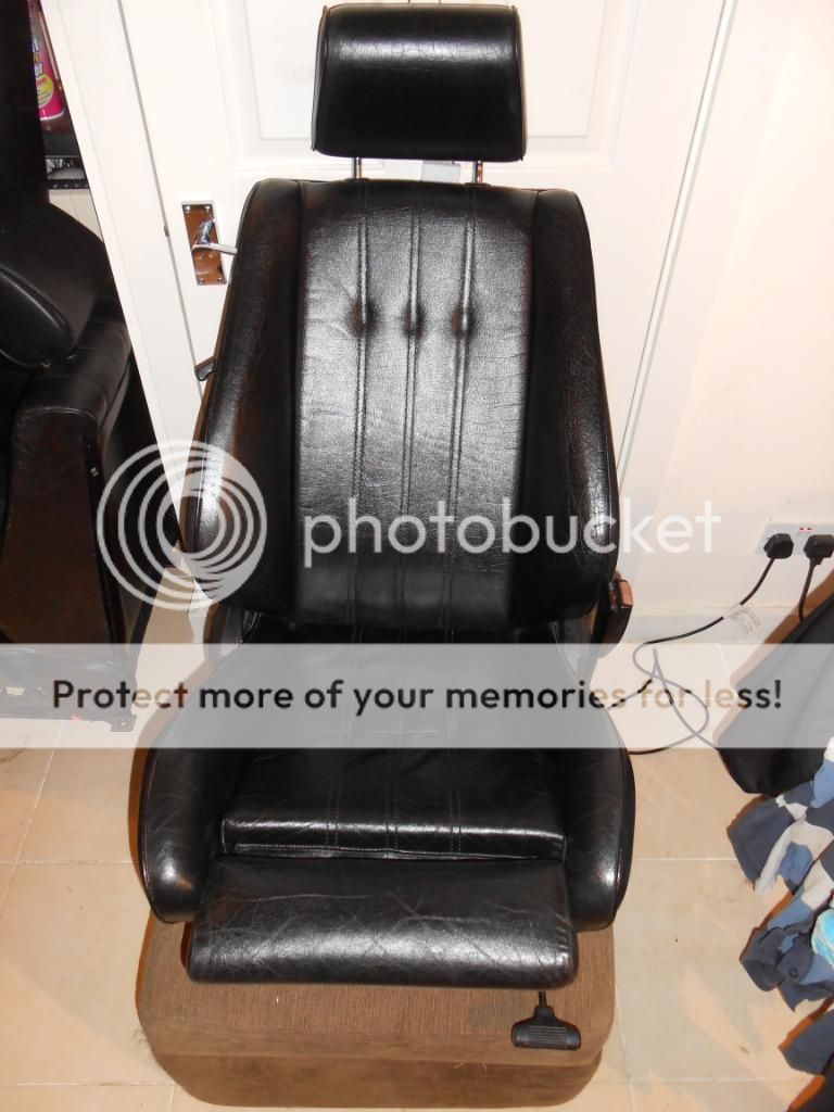

Got the driver seat in too and just finished it :cool:
Start ( I tried it on the bottom corner of the upper bolster the other day just to test
Cleaned and used the leather blacking stuff
Buffed
Conditions and finished

Wow good renovation, looks really clean but still holds that nice used leather look...
What products did you use?

Thought I added that picture...

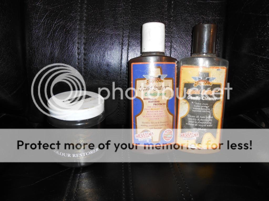

Cleaned it with warm soapy water first. Then the Liquid Leather cleaner. Then used the colour restorer which is called 'Leather Forever'. Then used the Liquid Leather conditioner on it :cool: Smells like new leather now too in my house so should be great when fitted back in and should get rid of that fuel smell :mad:

The more you say about the engine and after hearing it myself and also knowing the previous owner broke a few sumps I think it's about dead. It's not like it's had an easy life listening to the two previous owners comments and the fact we know it's been used for diffin!
Floor looks at tad ropey, and newspaper repairs in the bulkhead are a worry and more reason why not to go spending much on this turd.

That floor looks bad, that car is definately on borrowed time. Admire your efforts though mate, how easy does having a donor car sat next to it to rob all the bits from, that is one thing that e30topless said to me that is 100% true.
Agree with Dave, fix it up and get it served to an unsuspecting type OR strip it and stick all the bits on your chromie (minus kit and fooked engine) and stop noncing about with a 320i Auto :)

The floor isnt as bad as it looks in that picture... In that spot :mad: I wire brushed it all up and it was just scabs caused from untreated metal that had been patched over... The bit to the side of it on the right is where there is nothing there :mad:
got any links to these products ?

Gliptone Liquid Leather, wouldnt have got it from this seller but this is the cheapest I can find on Ebay right now... Basically a cleaner and conditioner which make it smell bloody great
http://www.ebay.co.uk/itm/Gliptone-Liqu ... 1c27f232d5
Then the Leather Forever was recommended by essexgirlracer a few years back at Santa Pod
http://www.leather-forever.net/
It doesnt do anything for the cracks in your leathers, just makes the colours match. Just a standard black I used, nothing specific about the shade for BMW... They do a few colours too £14.99 a tub.
