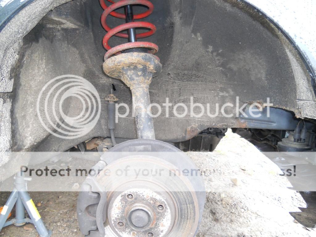

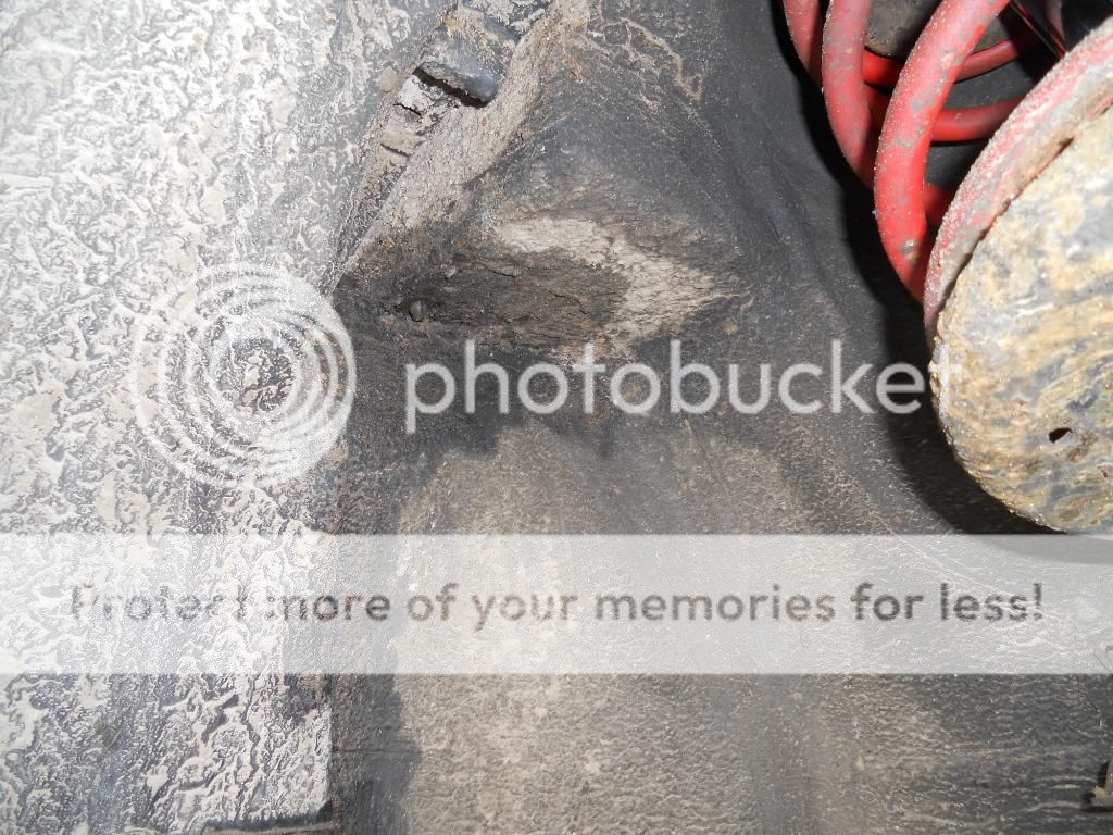

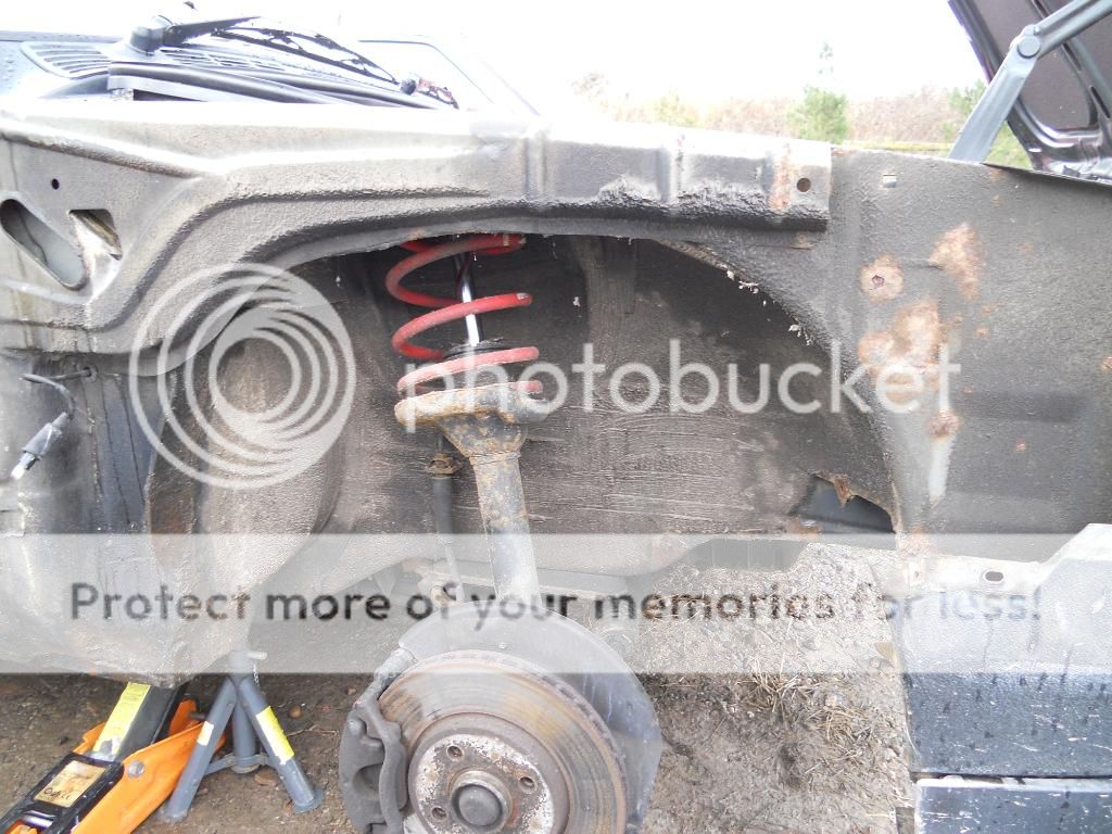

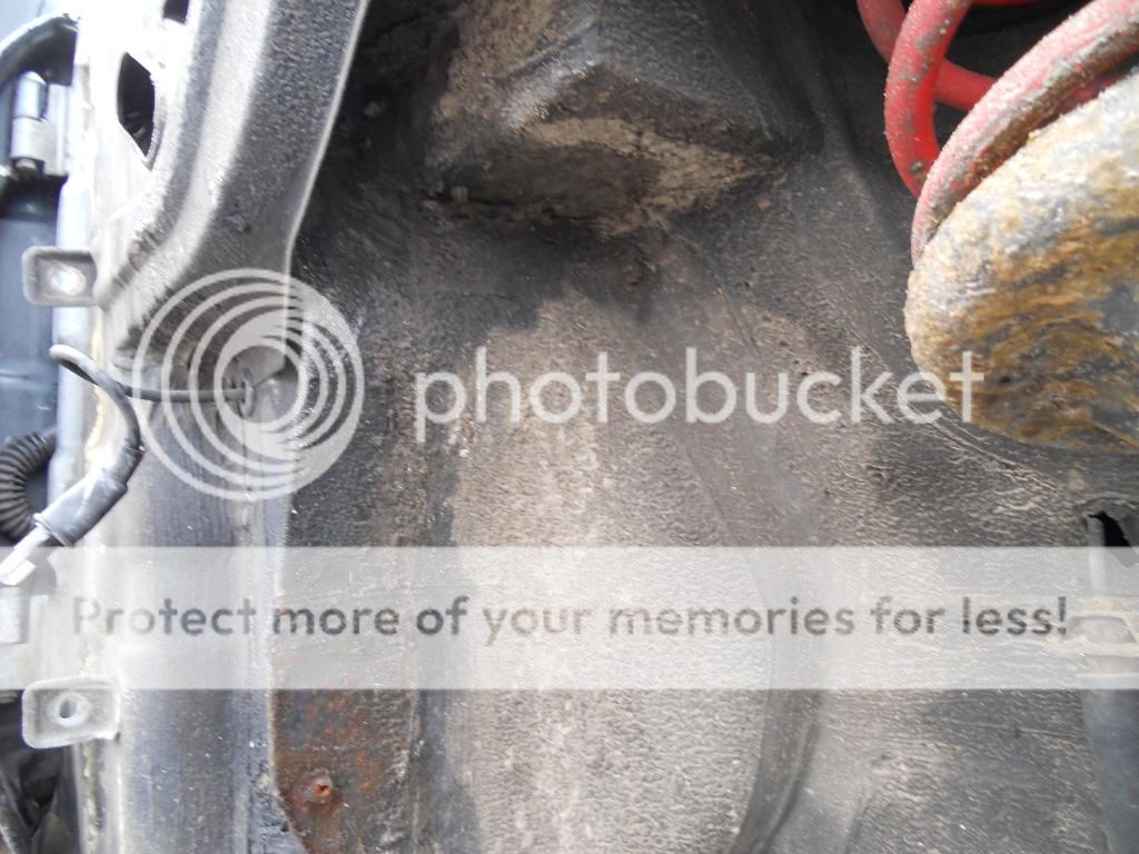

Driver side Arch today
Spotted this damp mark and suspected the same issue as the other side...

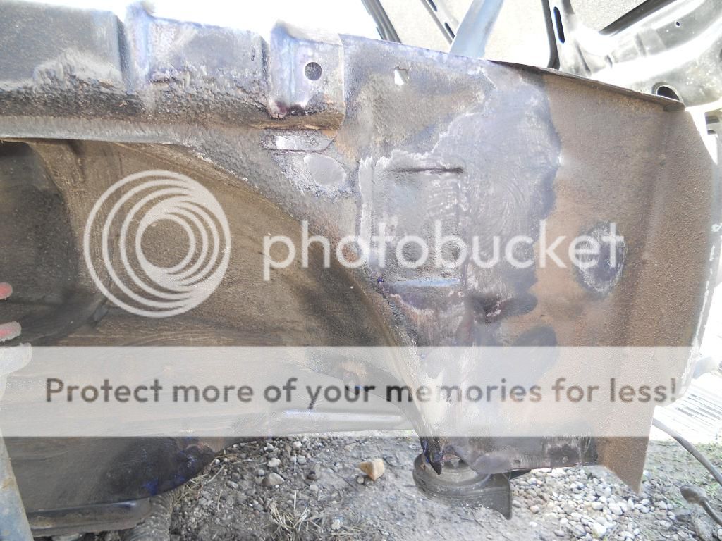

Wing off...
Someone prior has been welding...

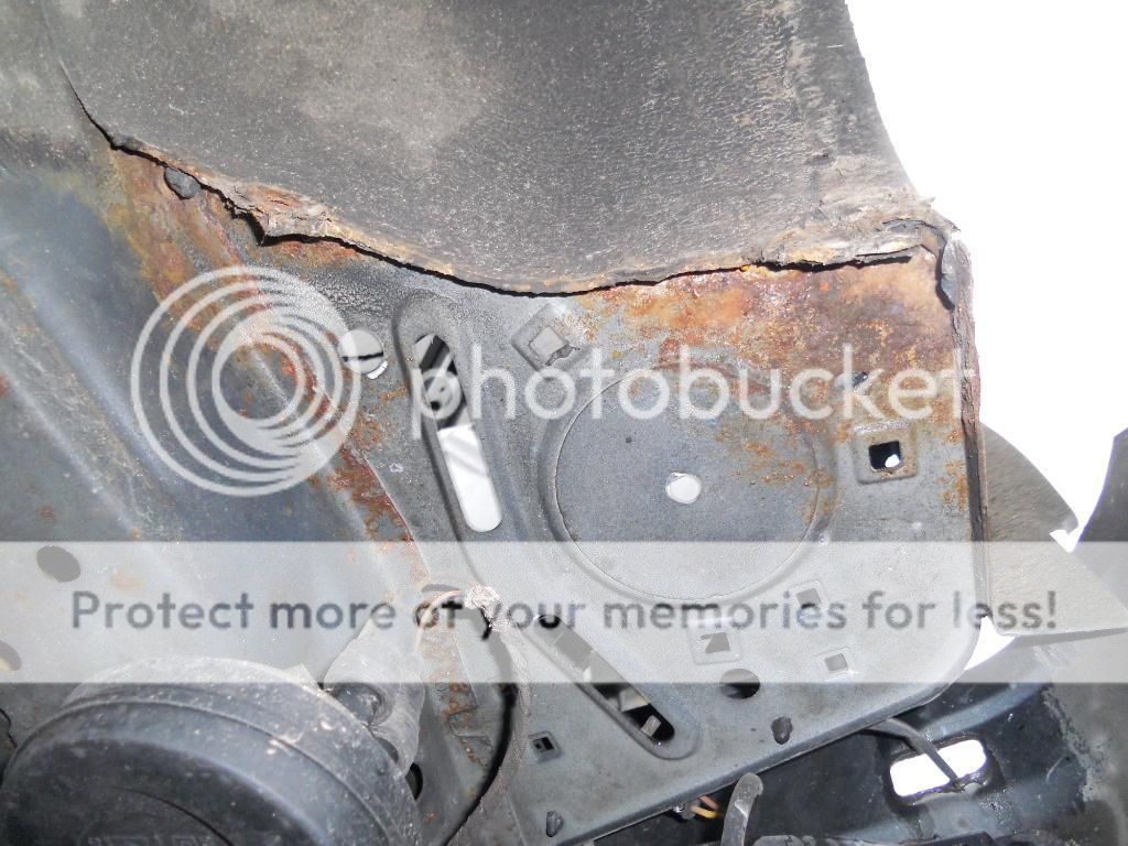

Suspect top bit..
Same as the other side just here too

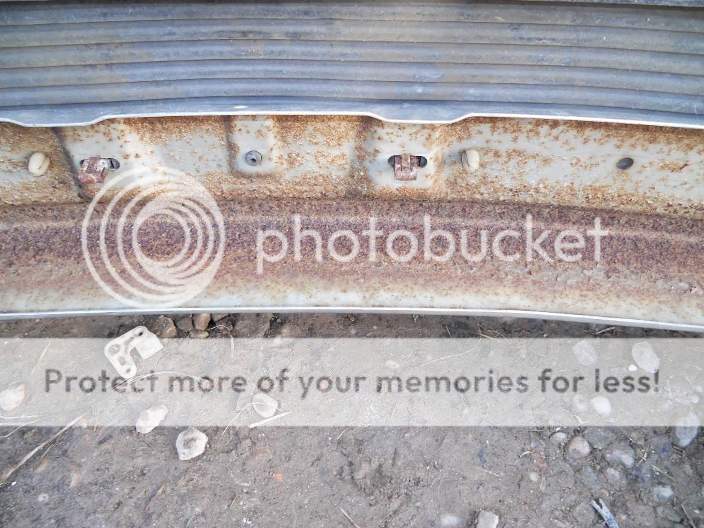

Valance off too now, gonna have a look at that tomorrow as a bit scabby on the inside..
Note: Cheap toolbox

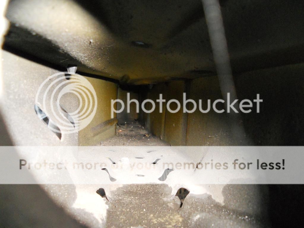

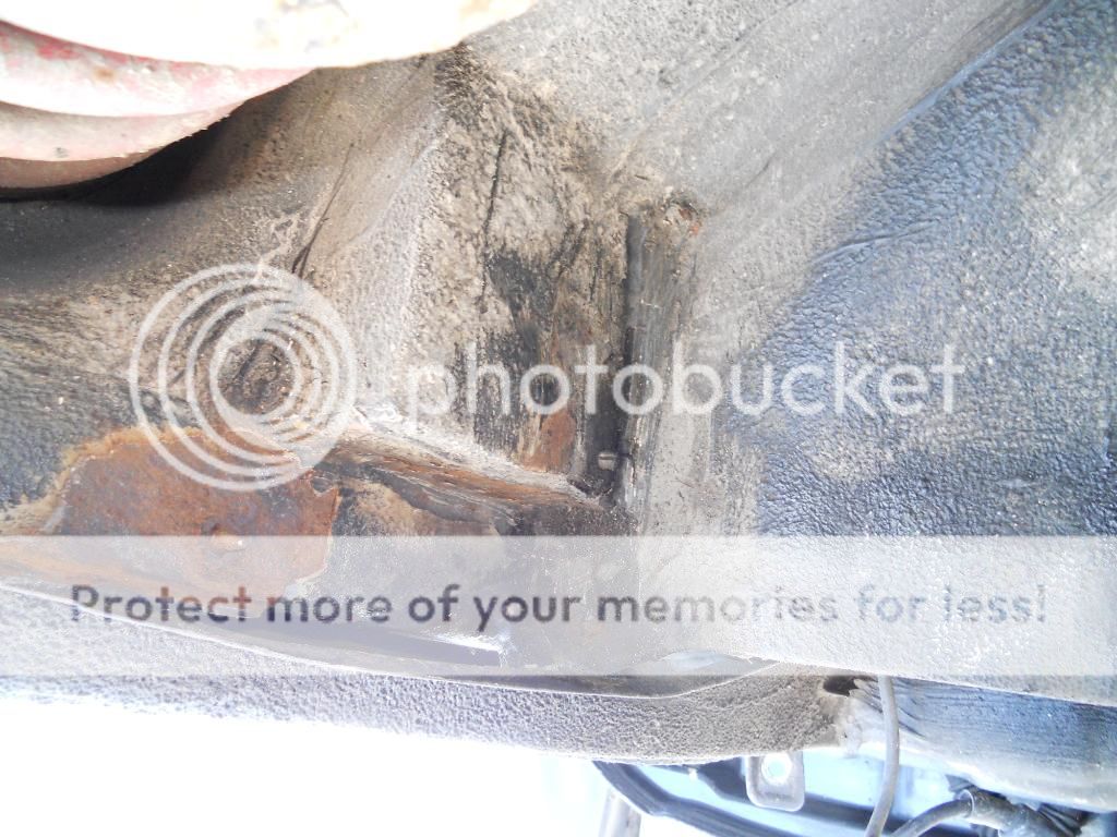

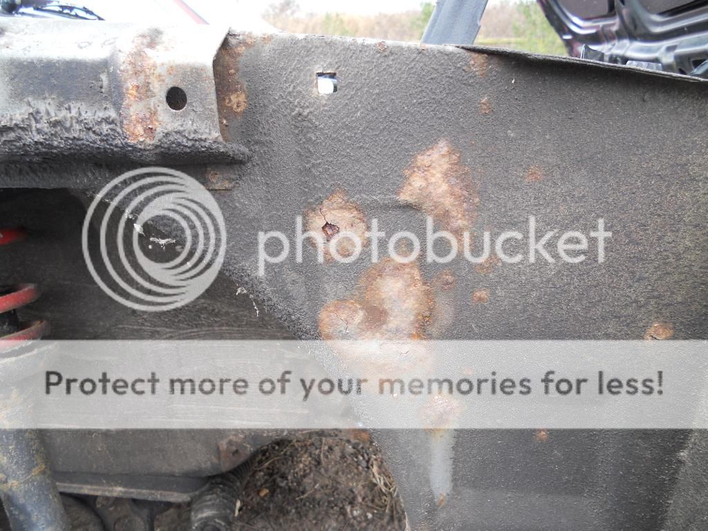

Inside the rail bit where the bumper outs go...
Grinded away and poked around and it is all surface scabs
Top corner had no holes..
Grinded it all back and treated it with the rust stuff...

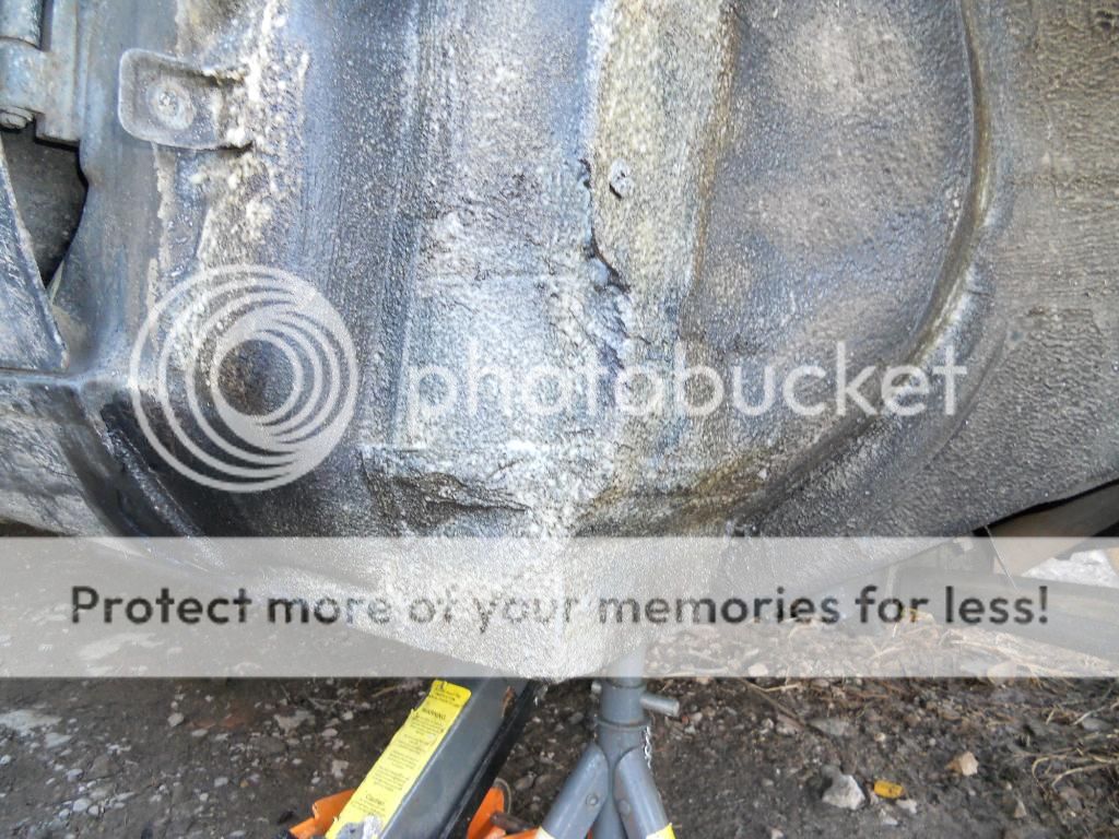

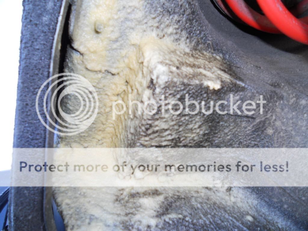

Then caked it with waxoyl... This is the first time i've used this other than the other day into the roof lining... Seems like it doesnt really do much?
How long does it take for the waxoyl to actually dry? I want to underseal the whole arch but the stuff didnt seem to dry

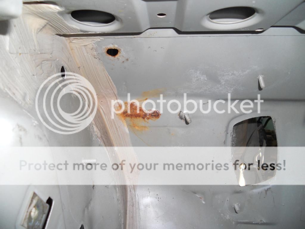

Had a nosey at one of the shells too and inspected where my rust spot is on the chromie and its directly here
Which is the screw for where the wiring loom bracket clips upto.
On the outerside there is a spot weld that runs all the way along, aswell as any pin/prong/screw thread that are on them, they seem to rot... So need to remove the dash, carpet and loom by the looks of it.

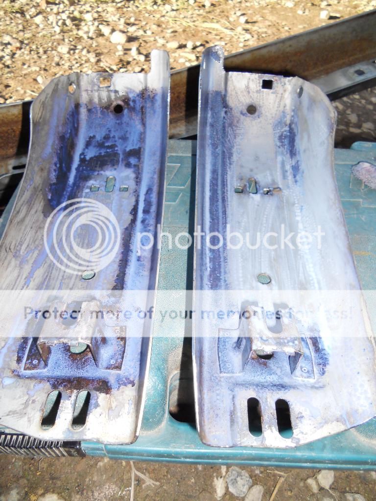

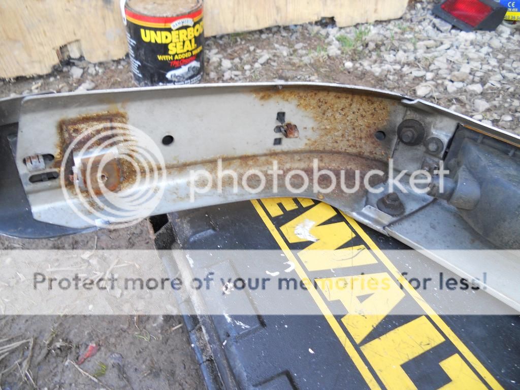

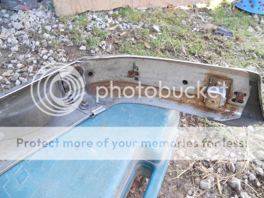

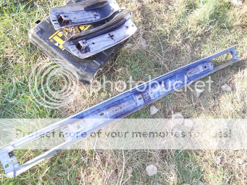

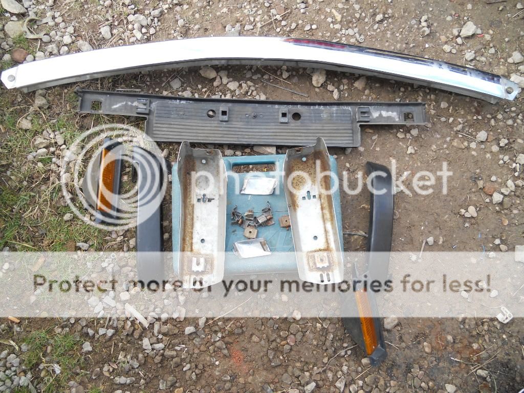

Had a little look at the front buper too while it was off, as it had some good rust on the inside...
The outsides are in great condition, a couple of scratches and needs new joining peices so need to find out how much they are at some point.
Grinded back what I could then put some rust stuff on them
Not sure what to paint the insides with though now? I have some underseal which I thought about using? You can not see the insides and it will preserve them well enough, whats anyone else used for chrome bumpers?
Thats as far as I got today, gonna have a look at the valance tomorrow and paint the inside of the bumpers with something.
Gonna try and clean up the plastics tonight, they have a few surface scratches
But thought I might be able to sand them out? Anyone been successfull with that? Its only the end peices so I might replace them yet...
