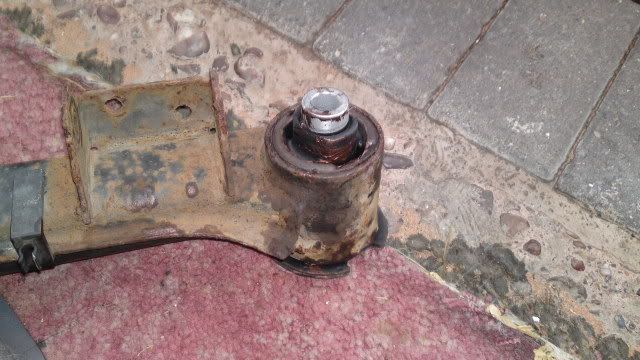

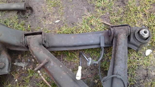

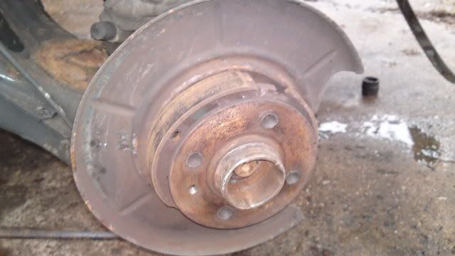

OK just a small update from Saturday - we're nearly there :D
New Lemforder bushes in my "new" rear beam
This is the state of the worst rear trailing arm :eek: the locator for the spring has completely gone 8O
Backplate is knackered - new ones on the new arms :D
Trailing arm bushes definately seen better days :eek:
The only thing better about this side was that the locator was still there - it was attached by a thin layer of rust though :eek:
