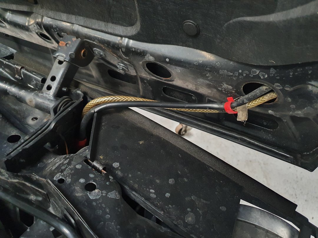

Every time I went to wash the windscreen it would take a few wiper passes before the washer fluid came out.
I know the washer hose was tired and needed replacing.
Well, as it turns out the check valve was missing - was replaced with a simple 'Y' joiner - so that would explain the drain-back of washer fluid between uses.
I don't have headlight washers or heated nozzles, which makes life simple.
You'll need item 15 (Valve) P/N which is 61661374978
OR do what I did and source the OEM part which I understand is BBR Automotive P/N 003-60-12387.
Also replaced the washer hose while I was there.
Sure, I could have used a generic 4.6mm hose, but wanted to keep things period correct.
From memory you need about 2.3m of hose to do the main run from the pump to the check valve.
Plus a bit more from the check valve to the washer nozzles.
Few pointers to avoid unnecessary work & make installation easy:
Tape the old hose to the new hose with some strong tape
Pull the old hose out through one of the openings in the bonnet.
While feeding the new hose from the top
And keep feeding it down past the RH headlight
Check there is the right amount of hose near the bonnet hinge.
- not too long so it gets caught when the bonnet is closed
- not too short so it under strain when the bonnet is open
If you like taking off your bonnet frequently , you can add a joiner here for quick disconnect/reconnect.
Interesting to know that VDO made the original hose...
Windscreen washers work brilliantly - water on the glass before the first wiper sweep!

Interesting. My hose follows a slightly different route and appears to be missing a clip - it always seemed a bit "wrong".

Dod you buy VDO hose? :D Looks great either way!
You have routed that hose slightly wrong btw, will post a pic from my phone shortly

This hose came from FCP out the U.S.A.
Looks virtually identical & measures-up the same - but without the VDO branding like on the original.
I followed the hose routing & clips that were already there.
If you can snap a pic of the correct routing - that would be helpful.
Yours might the correct route...
I'd say my bonnet has been off when the car had some paint repairs early in it's life.
The fact that it was missing the check valve indicates someone has fiddled with it.

Aha - so that's factory hose routing?
(through the circular hole closest to the edge of the bonnet)
Pic is worth a thousand words.

Well, after 35 years the bonnet cable finally gave up the ghost.
Thinking it was going to be a major pain and expensive exercise it wasn't too bad.
Firstly, the part is still available from BMW (51231884281 Engine hood mechanism).
And comes with a new interior handle & bracket...
And at a very reasonable price (less than A$75 / £36) from a local BMW dealer in Melbourne....
No overseas freight - brilliant :)
Installation was easy thanks to the E30Zone guide on replacing the bonnet cable and the Classic Bimmer Bits E30 Hood Release Replacement article.
The emergency bonnet release location worked a treat.
Hardest part was seating the rubber grommet in the firewall.
Few tips:
- Removing the headlight gives you plenty of working room
- Best to clean and lubricate the hood latch mechanism
- unbolting the fuse box and bonnet catch also gives you plenty of room
- check for rust while the fuse box is loose
Thankfully no rust for me.
