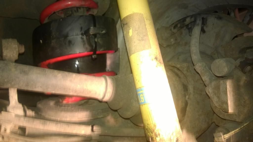

What did you do to alter that, Jimbo?

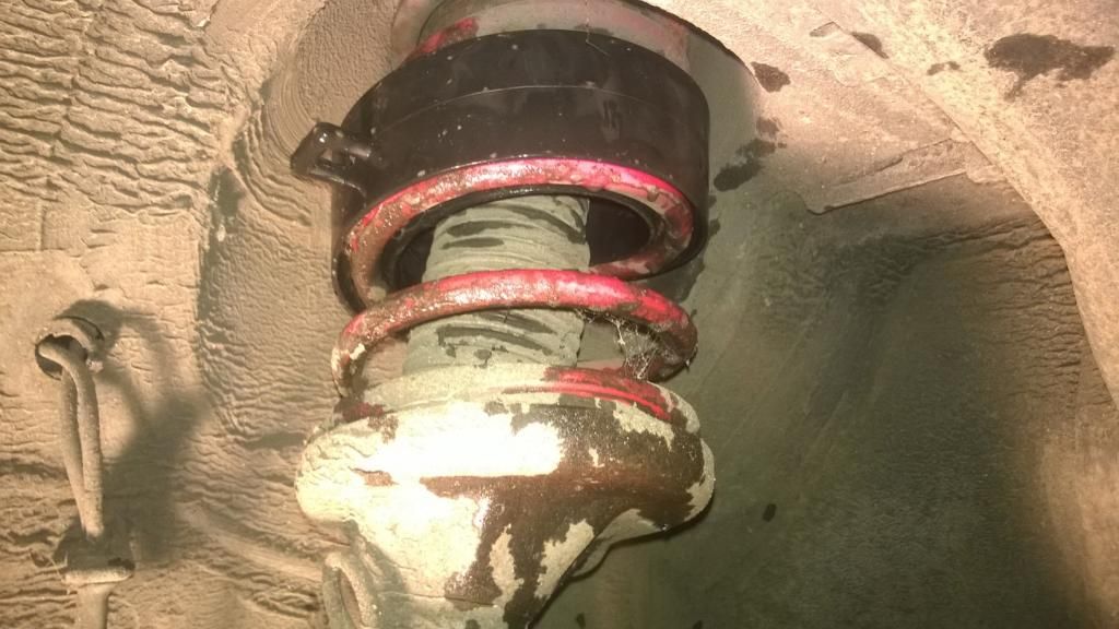

Never seen that before. Is it strong enough to withstand harsh British roads?

I presume that is a temp fix, rather than changing the damper and springs for the moment?

Yes, they are very strong, i've had them on another car for over a year with no issues
but yer, it a temp job until i can afford/find a set of genuine mtech springs

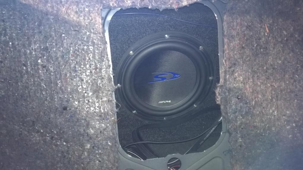

Fitting a radio is not a small job !! All done now and the sub and amp i got off some dude on here are great.

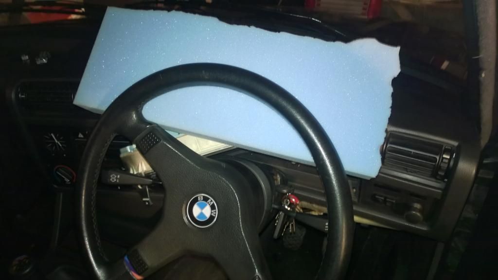

Whilst the clocks were out i fitted a load of this foam, i've used it before and it does cut down some of the noise.

Word of warning
Be careful with them inserts as they are known to brake the springs (especially older ones) due to reduced travel and load increase on spring ends.

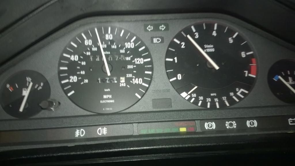

This speedo is over reading I think.
70mph at 2550 rpm....with a 3.64 diff and 205/50/15s fitted....not quite so sure about that. It should be 2800rpm with 195/55/15 fitted
