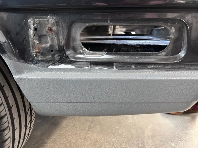

So after that.. I was preparing for the installation of a new front valance.
Mine had seen better days and I took the opportunity to get the brake ducts and lower lip painted at the same time.
So it’s not a massive job, but mine was hindered by a lot of missing nuts bolts and speed clips, from historic body shops messing with it.
I went from this…
To this…
Can’t beat fresh new panels…

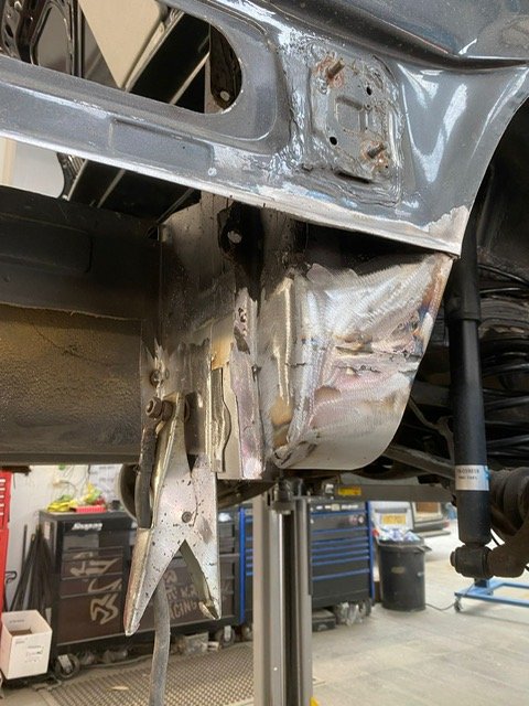

Ok so whilst the car is in winter hibernation I've decided to do some major surgery.
Although this car is pretty solid, any E30 owner that tells you their car is rust free is either a liar, delusional, or it's undergone a major/bareshell resto :)
The car has had 2 major repairs in the past and they've both been done badly. Firstly two rear inner arches back in 08 before I acquired the car and secondly a new rear panel in 2015/16 under my stewardship. Unfortunately I wasn't in the trade at the time and went with a bodyshop that I should have avoided. The old adage 'you get what you pay for' was made for car bodyshops.
Although I supplied a genuine rear panel the whole job was a bit of a lash up.. areas that should have been protected and treated at the same time weren't and sure enough fast forward 6-7 years and rust is starting to appear at the joins of the rear panel and rear quarter. It's also been letting water into the rear boot pockets. This is a prime of example of having a body shop that aren't familiar with the car or at least cars of a similar ilk... or maybe they were just s**t :mad:
Whilst the car was in storage the last 2-3 years I've been planning on getting this work done and just decided this winter is the prime time. Although my current bodyshop will destroy your bank account, their experience, craftsmanship and attention to detail is second to none.. especially when it comes to E30's.
Below gives you a jist of what was occuring through water going through seams that should have been sealed and then sitting with nowhere to go. Corrosion starts and then spreads.

Time to cut off the rear panel :o:
The OS boot pocket was beyond saving and had to go...
Any one who's gone down this route will no doubt appreciate how scarce repair panels are nowadays.. particularly genuine parts. I managed to get a section of the boot pocket from Holland.. but the rest needs to be fabricated.

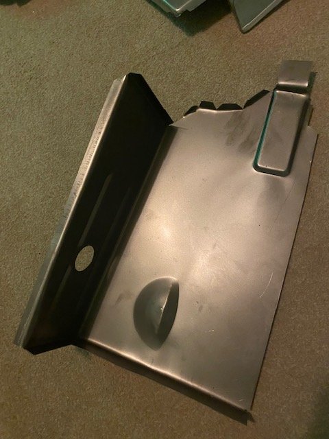

Here's the repair panel in all it's glory
Then came the craftmanship.. This is just the OS.. same still be done on the passenger side and then the new rear panel to be attached.

Mitchen
Posts: 2376
Post Mon Oct 17, 2022 5:03 pm
So the time for attaching a rear panel to this old jalopy has arrived
And we have lift off.... :clap:
