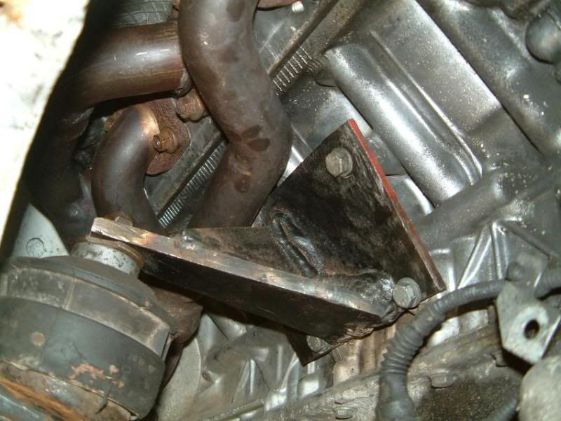

si- wrote:what mounts of you guys all used???
Thee options basically;
-Use standard mounts and weld supports to frame rails.
-Buy mounts from www.300mm.de and use 540 rubber mounts & stock E30 mounting position on subframe. This is what i use.
-Fabricate your own mounts and use standard E30 mounting positions on subframe.

i think its going to be fab ( read- get someone to make them!!!) my own mount's..........
does anyone have any dimension's etc of the mounts?

Si- For the grief it is making them up, just fork out for the proper mounts. Unless you have access to a hoist or like fitting and removing engines often.

oze30 wrote:Si- For the grief it is making them up, just fork out for the proper mounts. Unless you have access to a hoist or like fitting and removing engines often.
hoist is no problem the cost of the mounts off the shelf is....... 300mm.de works out at about 900 quid form what i can gather!!!!
jonsku - have you got any pictures of your mounts or have any of the option's you detailed above, im having trouble navigating and finding what i want on e30de my lack of german and google's literal translation confuses me which aint to hard :roll: :mad:

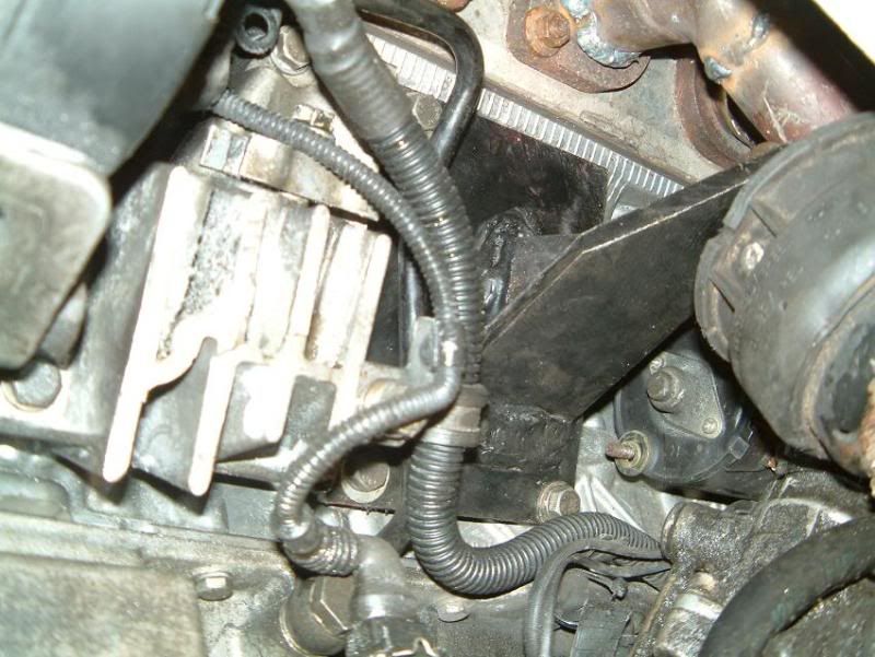

here you go.....here's mine.

wicked thanks glenn, did you just make the mounts up and use the standard e30 rubber's on the crossmember??
