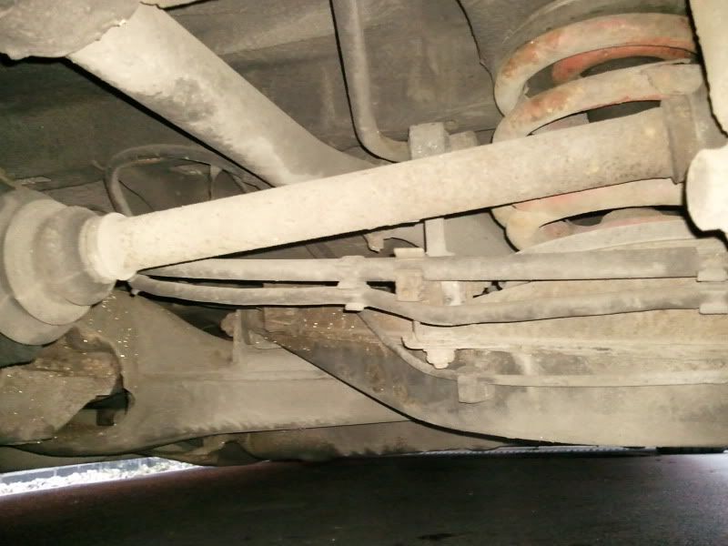

Looking where I poked through any bubbling will be hidden by seam sealer from the inner wing to the boot floor.DanThe wrote:Surely that bubbled on the inside? At least you dont have sills and arches to graft in!
It does need a spot of work on the rear section of the nearside sill, as with all the paint and metal work needed on this car, it's getting done by a professional.
Certainly makes me wonder how many E30s really are rust free!

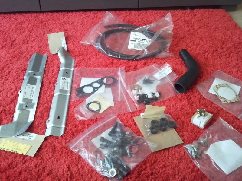

Also had a delivery from BMMiniParts, just a load of clips, nuts, bolts and general crap (few things for the touring in there to). Was suprised to see that the tank guards are metal rather than the original pastic, dare say these will get powder coated next, not much there for just over £100

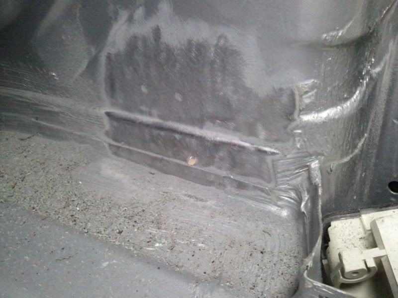

Cleaned down the inside of the rear wheel arch now ready for welding, certainly now sign of rust on the inside;
I have also got the underside and box sections waxoyled, need to do the box sections from inside the boot as well for maximum effect now;

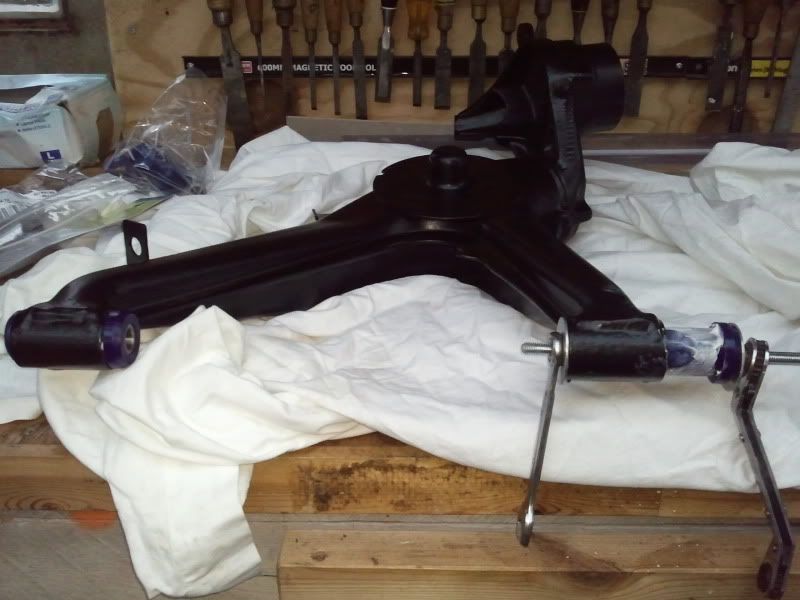

Finally got the spanners out and started putting this back together again. Firts off I owe Dan a big thanks for sorting out the powder coating of my last batch of scrap, pressing in the beam bushes and wheel bearings and then coming to the rescue with his beam washers this week as I went and lost one of mine :notworthy:
Got the tank fitted last week, what a ball ache!! With it being the bigger tank and the chromie having external fuel pump mounts it took some real persuading!!
Then with Dans washers in place and Waxoyled the beam went in and the diff got bolted up.
One Waxoyled washer(bargain compared to new OEM ones).
Forgot to get a pic of the beam & diff in place as I tried to crack on with getting the arms on and light was running out (no lights in my mums garage
Supaflex bushes getting wound in, please tell me I've not fitted these the wrong way round, the instructions didn't mention whether they had to go a certain way round.....
Arms and shocks ready to go,
Quickly found with light running out that the Supaflex bushes are a VERY tight fit into the beam, had pretty much the same issue with fitting everything else like that to the powder coated shizzle. Will be cracking on with that tomorrow when I can see properly.

The inner bush is the wrong way round mate, the large parts of the bush should be on the outsides

Got ya! Could've been worse, take it they comeback out ok?DanThe wrote:The inner bush is the wrong way round mate, the large parts of the bush should be on the outsides

They'll come out DaveKedge wrote:Got ya! Could've been worse, take it they comeback out ok?DanThe wrote:The inner bush is the wrong way round mate, the large parts of the bush should be on the outsides

They are what Dan recommended, beam bushes are OEM thoughe30topless wrote:Noice powdercoating that Dave![]()

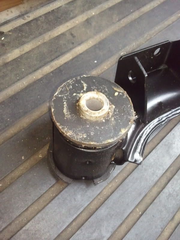

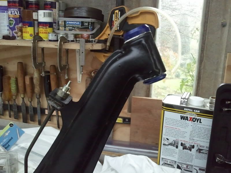

Bit more progress this afternoon. First thing was obviously to swap the bushes round the right way, which wasn't too hard thankfully.
Funnily enough this then seemed the make the arms go in a bit easier, still a bloody tight fit, especially the nearside. Also got the ARB, springs, brake lines, handbrake cables all fitted. Got a feeling i need to clip the handbrake cable to the arms, will double check the touring tomorrow to confirm that though.
