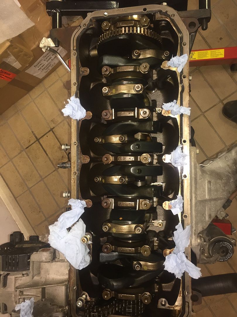

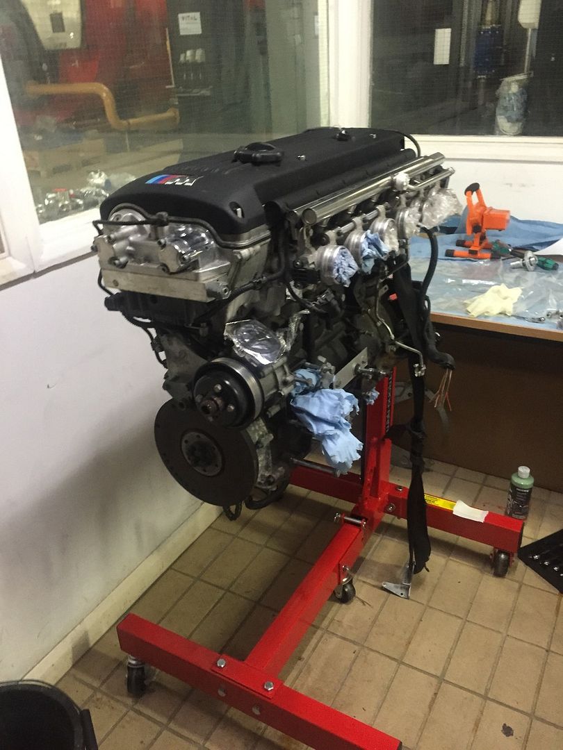

Last night I picked up the new engine - E46 m3 s54b32. The plan is do to precaution things like the rod bearings + arp bolts, vanos rebuild, oil pump shaft upgrade to the engine. I'll be fitting a lightweight flywheel, keeping the e46 m3 gearbox and doing a few bits here and there.
Although this will probably take me a while to do it properly, it will get done eventually!

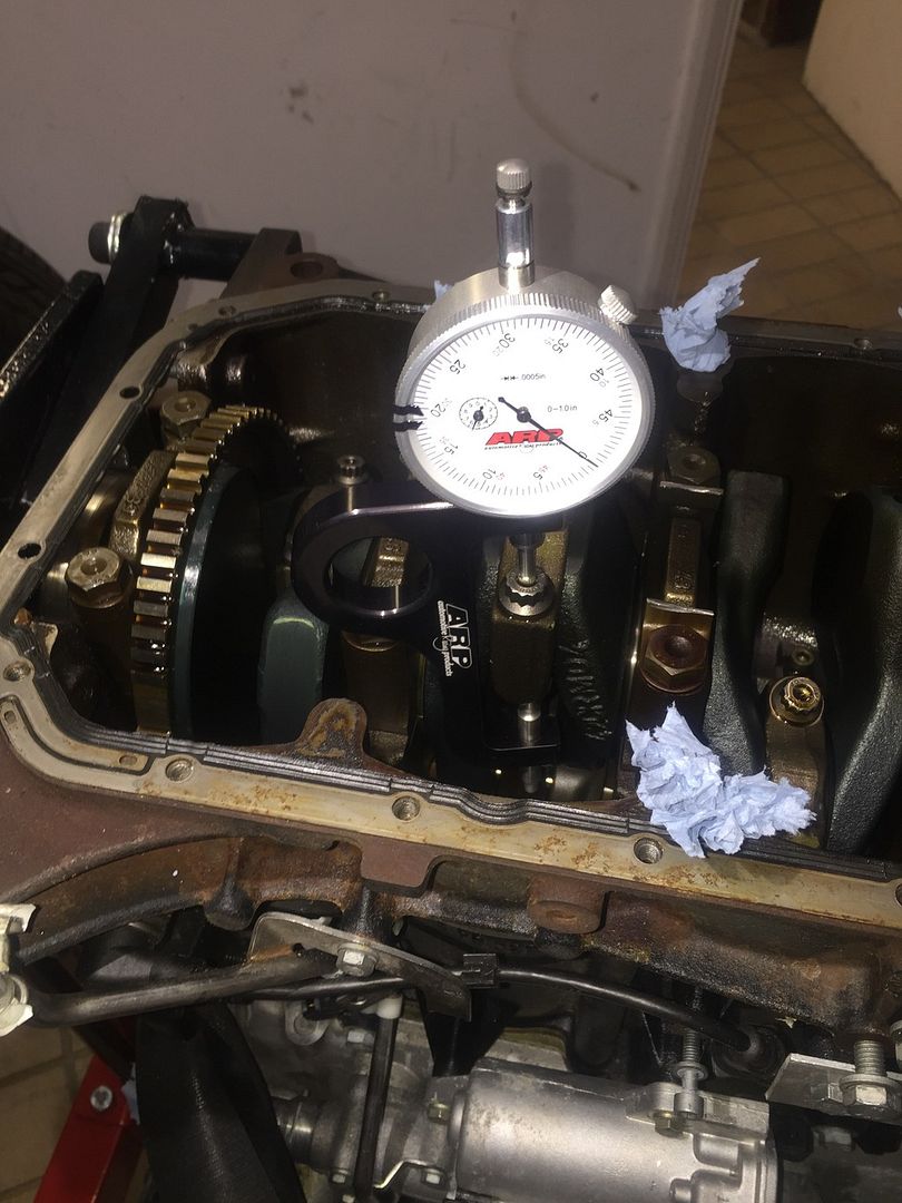

That looks a handy tool, I dont suppose you compared the stretch reading to the recommended torque figure did you ajay?

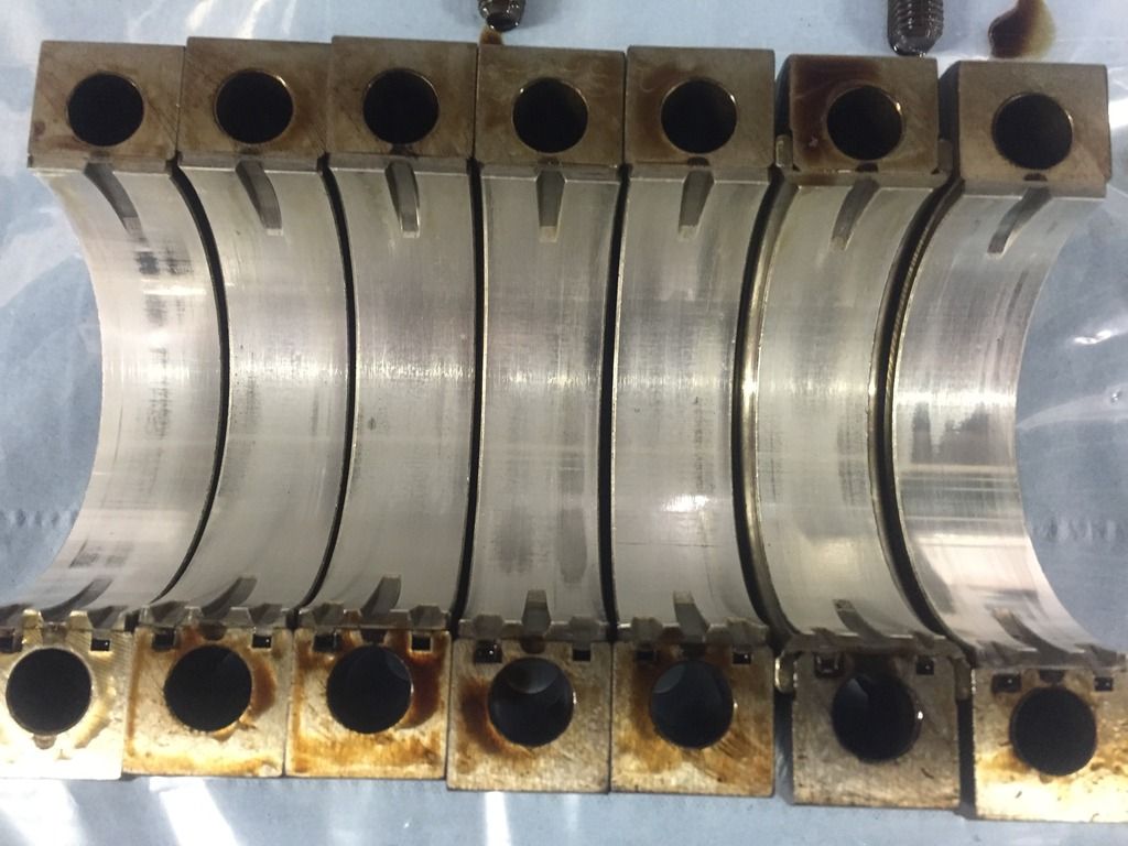

Yes i did Dan, i had the big end bearings replaced and arp bolts fitted a couple of years ago,but the mechanic that did the work did not have a strech gauge & torqued up as per instructions on the packet, the stretch gauge shows they were under the recommended stretch parameters & the shells that were fitted although not worn were not original parts....a˜³, no harm done, and the right time to find out if you know what i mean. Glad i made the effort.a˜Š

Not many seem to make the shells from my searches, ended up using the dealers myself at a nice price :cry:

I've seen vac motorsports do a coated bearing set, I'm guessing dealer bearings won't be that much different in price because of m tax?
