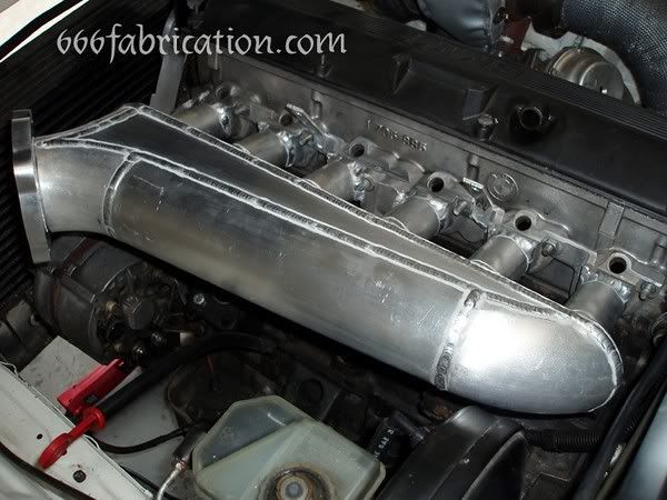

this is the 666fab one volk makes

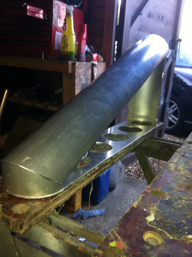

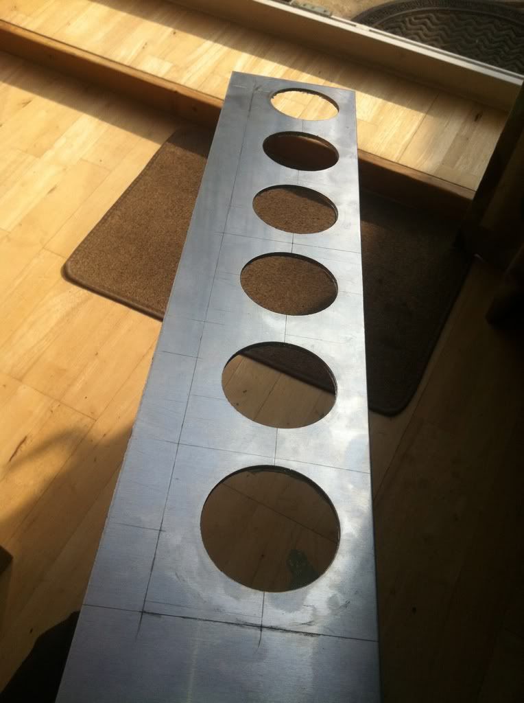

Post Fri Mar 23, 2012 2:21 pm

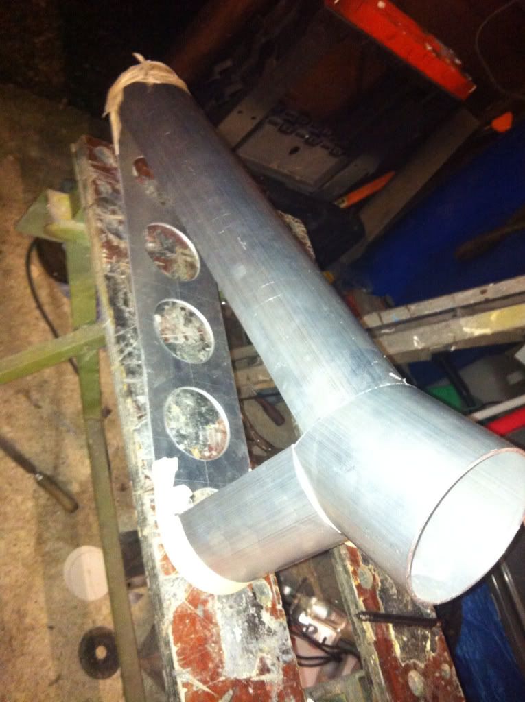

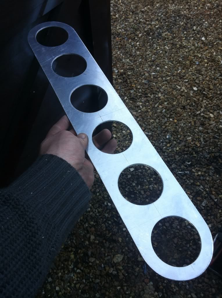

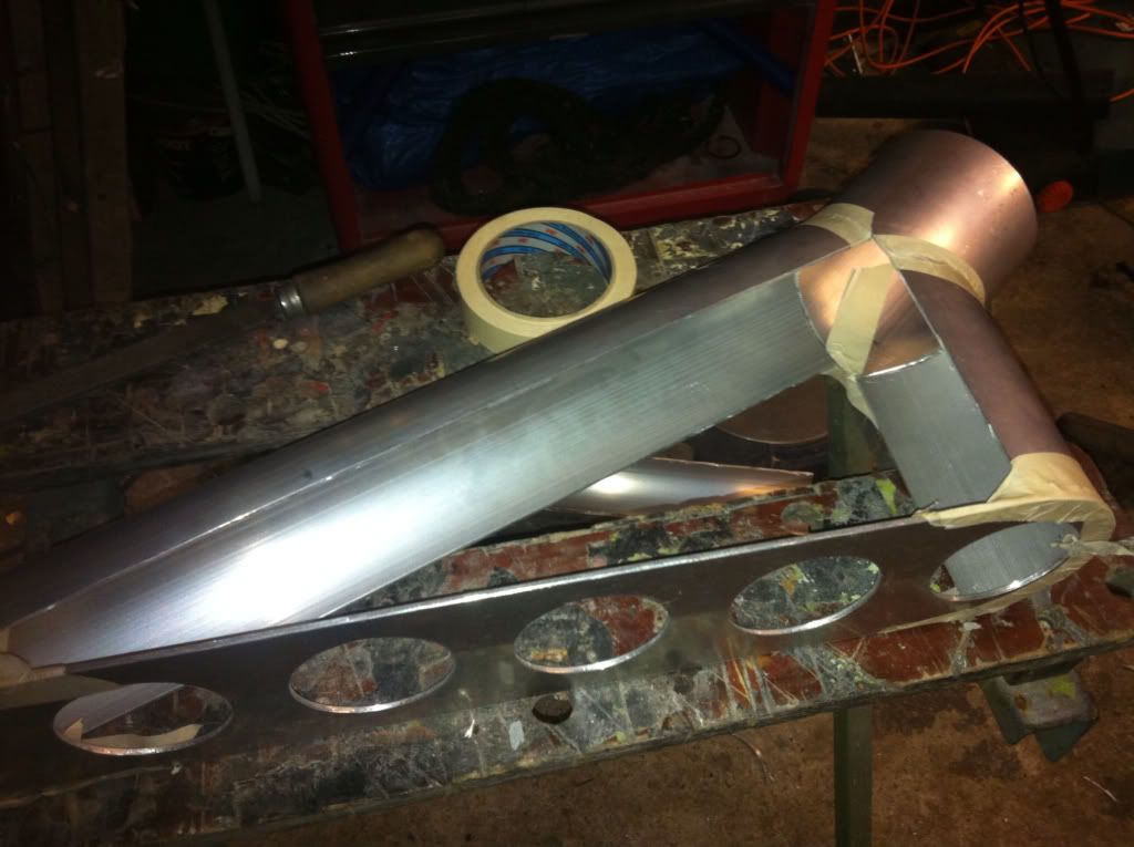

holes cut for the bk plate just gotta shape the ends and cut to width
finished article :)

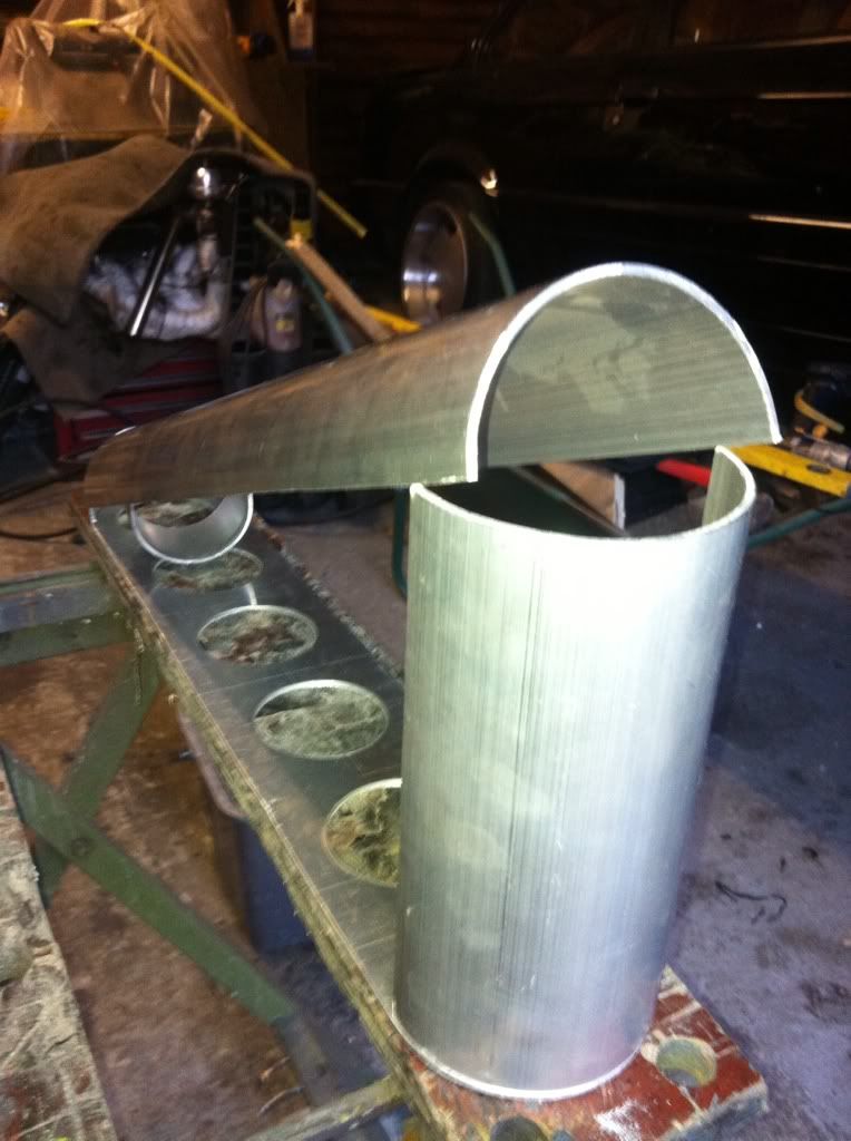

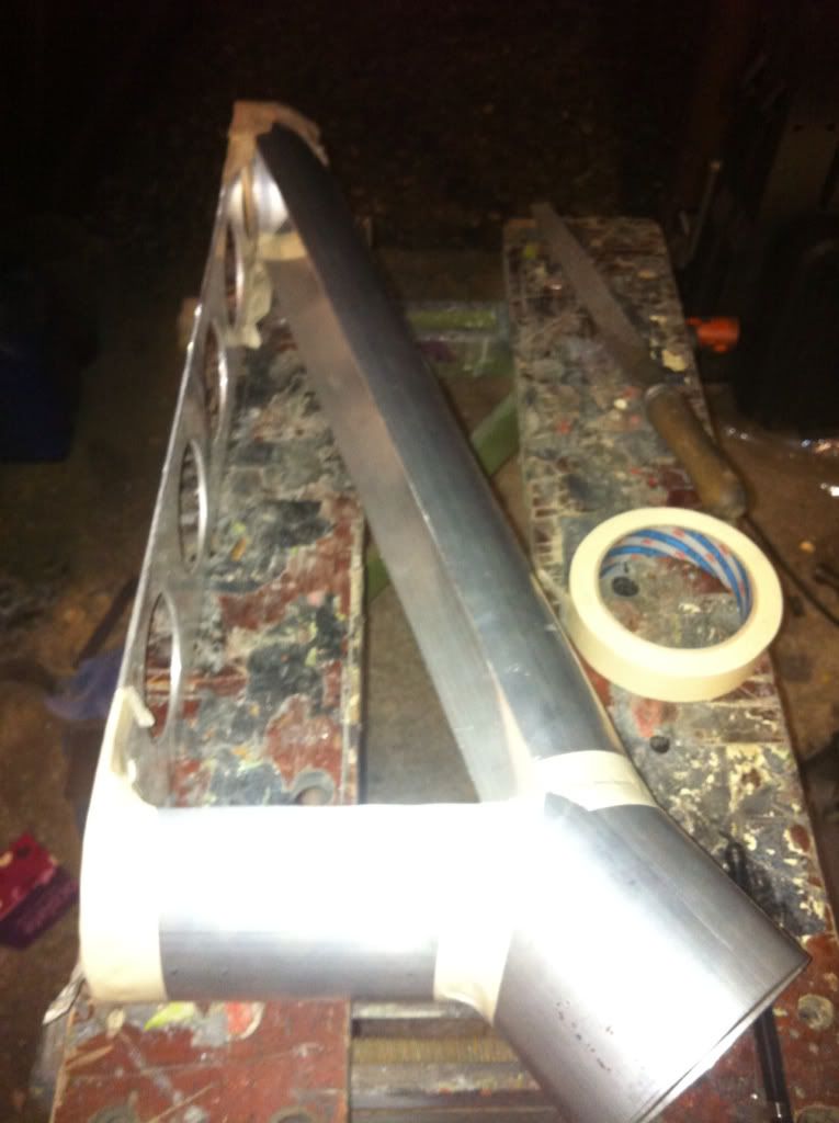

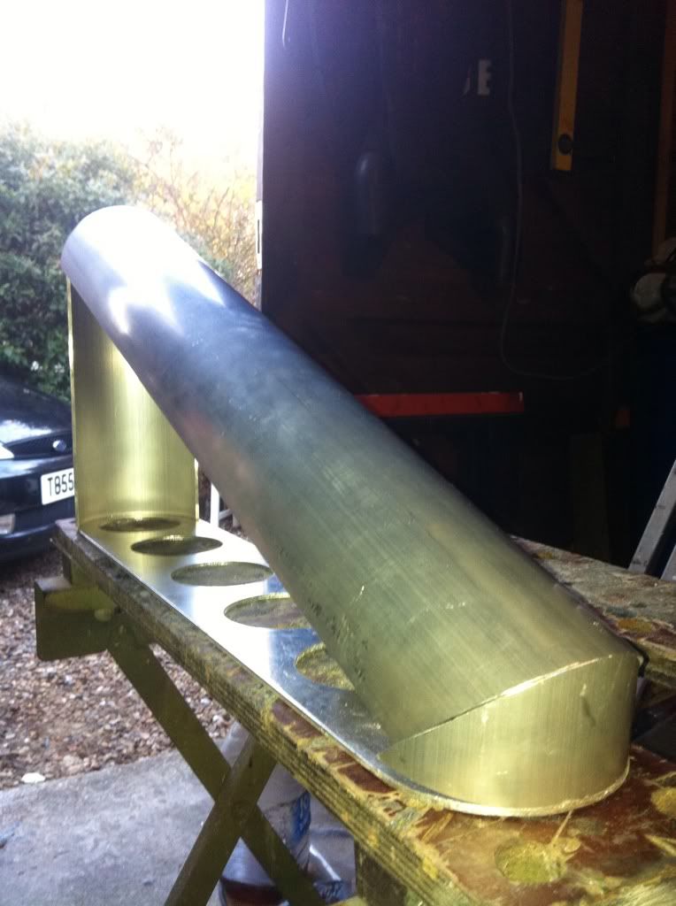

Post Mon Mar 26, 2012 7:11 pm

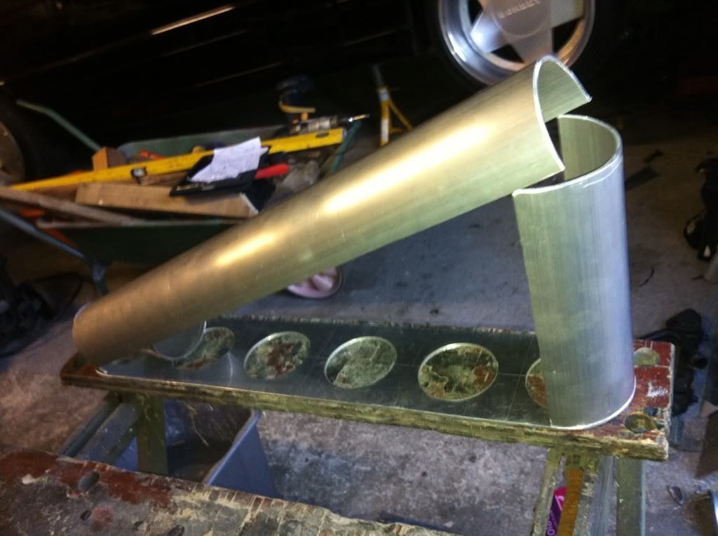

a few more its taking shape slowly

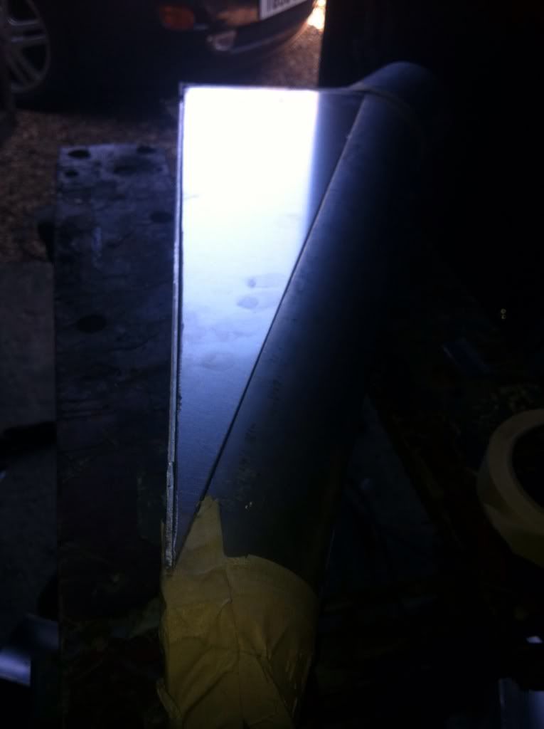

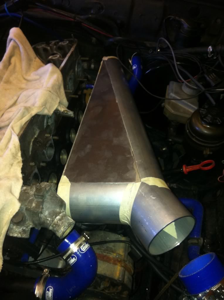

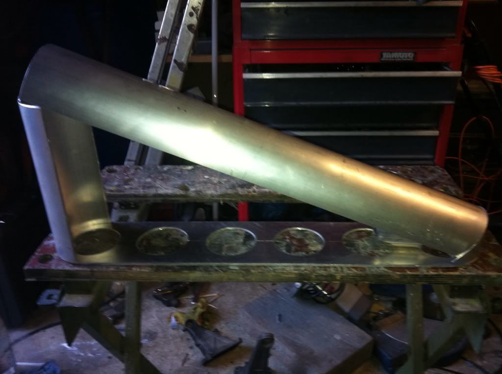

ross2009
Posts: 2762

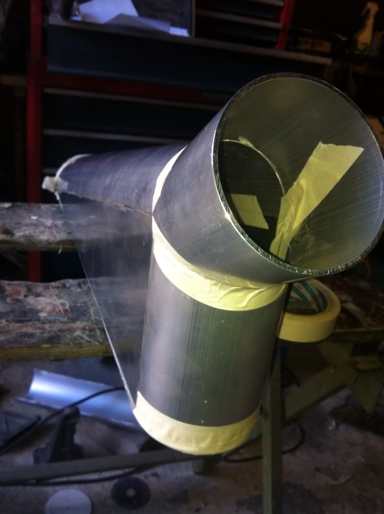

Post Mon Mar 26, 2012 7:23 pm
breakermart wrote:do it do it :cool:
lol ha

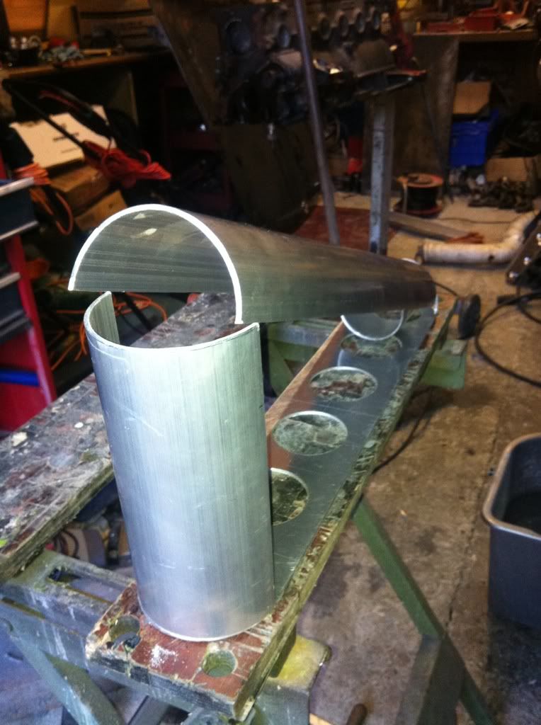

what ya reckon ??

breakermart
Posts: 671
Joined: Sun Mar 29, 2009 11:00 pm
Location: Loughborough
Post Mon Mar 26, 2012 8:36 pm
yes looks like its going perfectly. just need the welds to be neat and tidy to finish it off nicely. i do like to see some good fabrication. alot of the sh** you can buy off internet can be done so much better by a good fabber and it seems your doing just that mate. DO IT DO IT :idea:

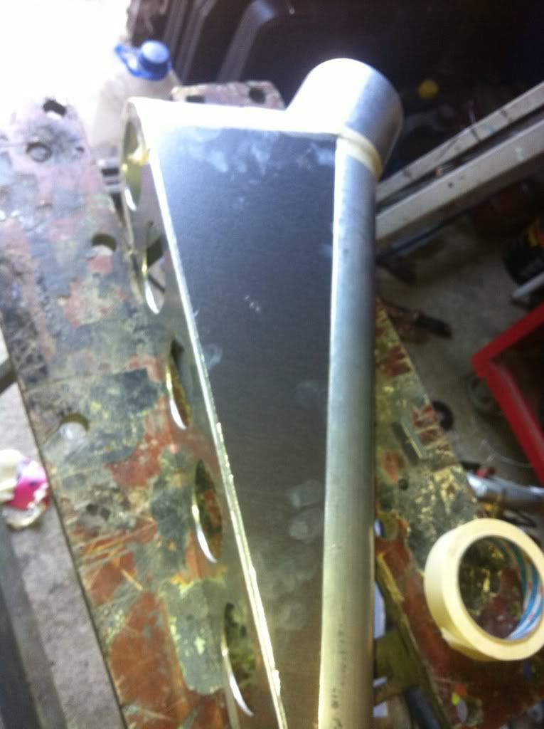

Post Tue Mar 27, 2012 7:15 pm
ha got bit more cutting and fabbing to do be for i weld it i want it to fit nicely together first then i can weld it all in one go :)

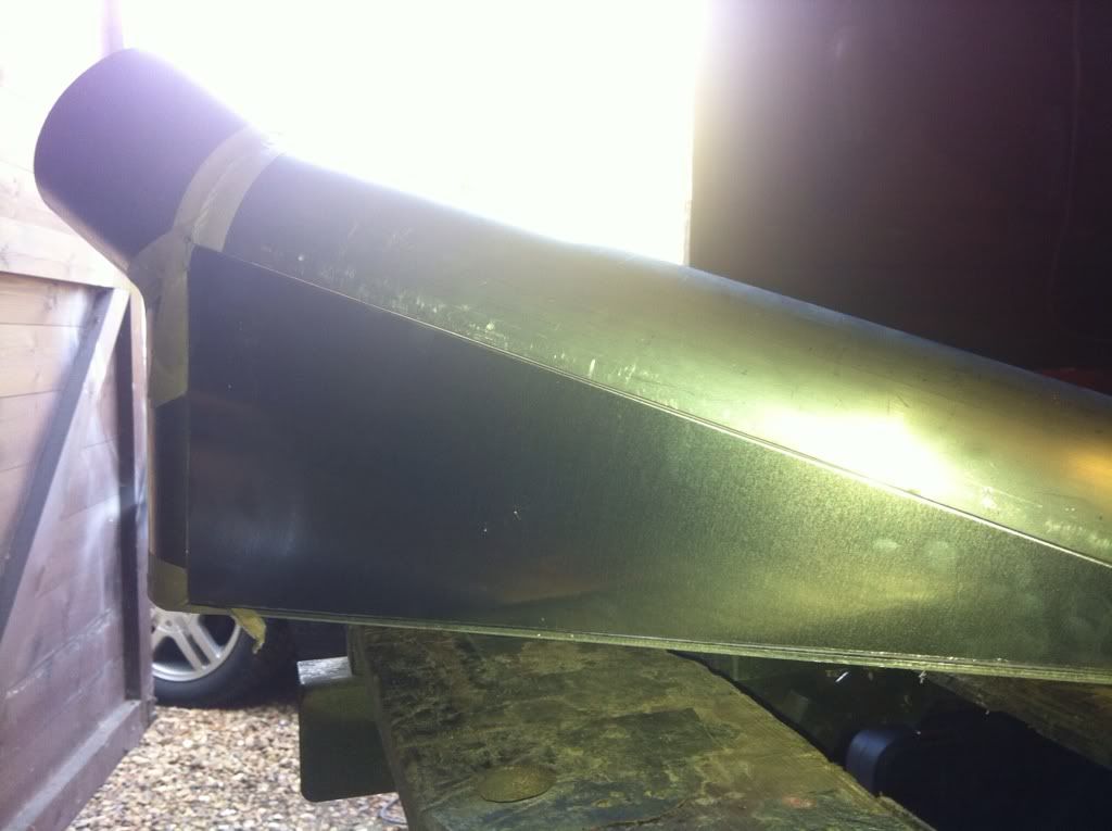

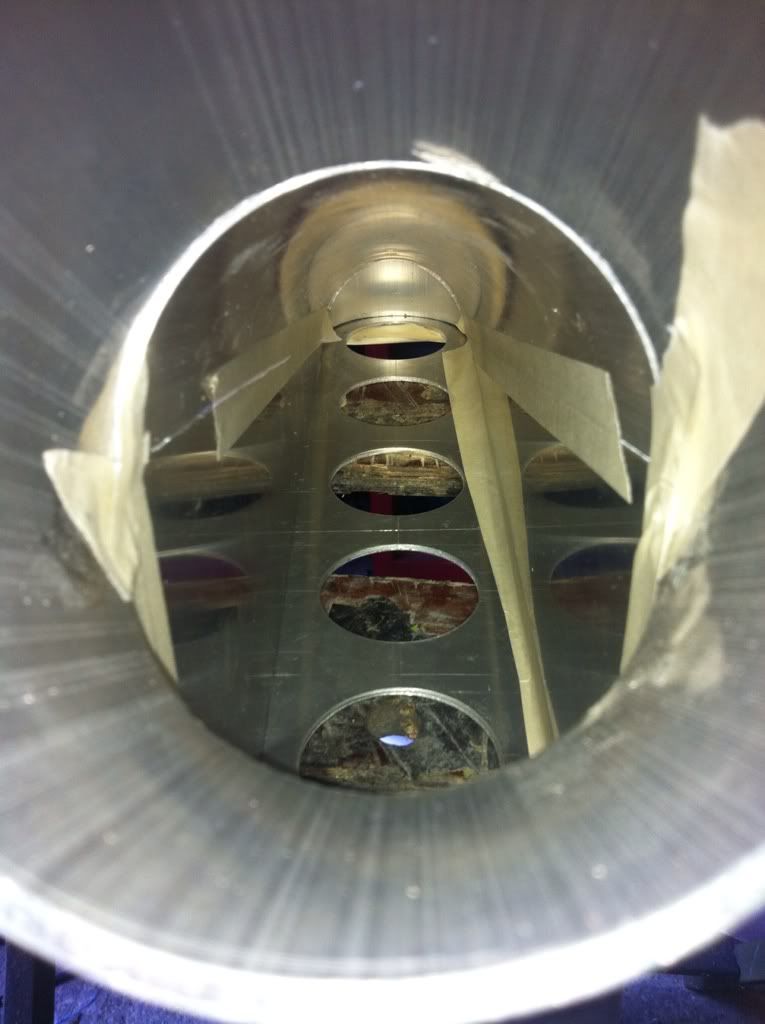

ross2009
Posts: 2762

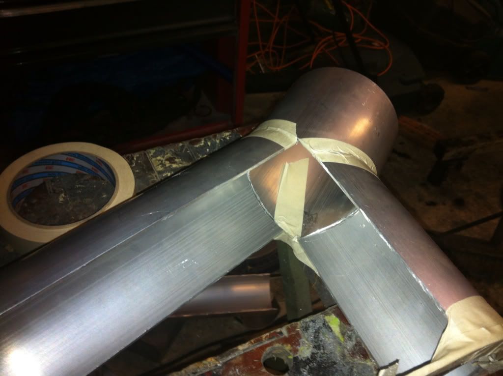

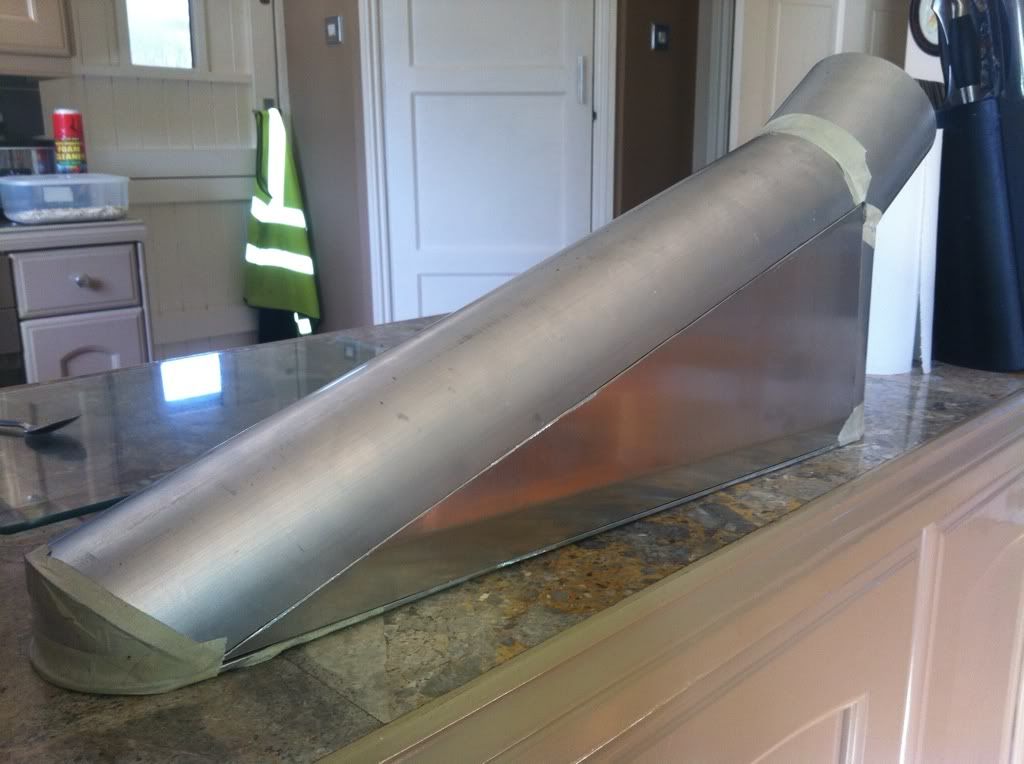

Post Sat Mar 31, 2012 9:16 pm

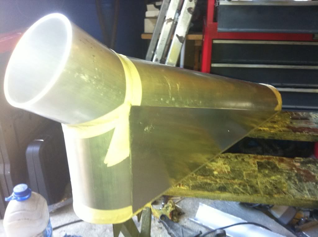

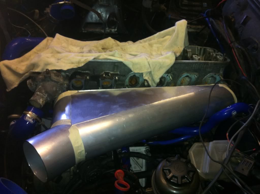

A little bit more done today :)
Turbo M20
v8 project 6.0 twin turbo
Post Sat Mar 31, 2012 9:17 pm
Will the masking tape hold up to the pressure Ross :mad:
ross2009
Posts: 2762
Post Sat Mar 31, 2012 9:19 pm
Na I'll change it to some duc tape winkeye

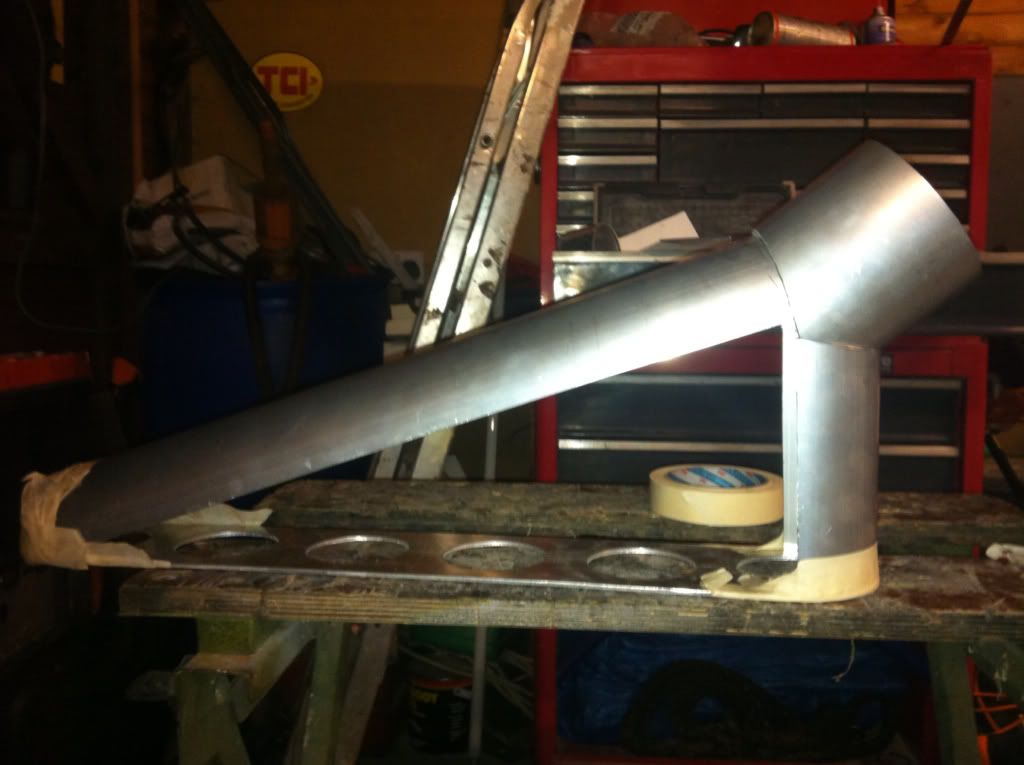

Post Sun Apr 01, 2012 3:11 pm

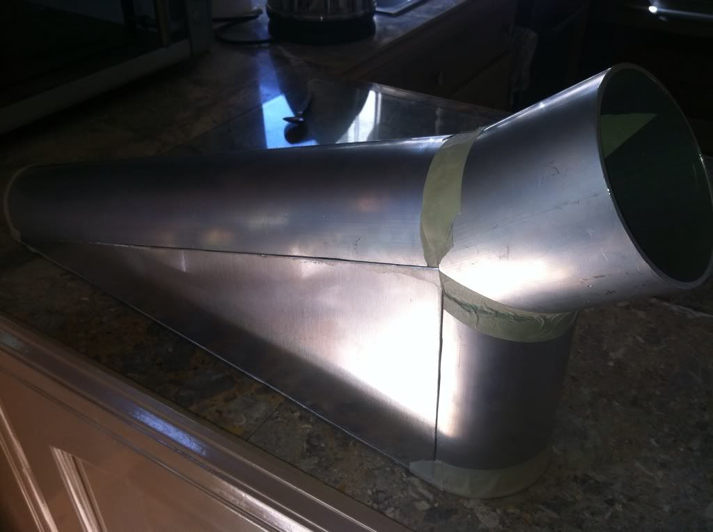

made the side plates today :)
