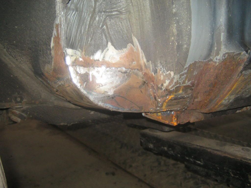

Somebody asked about progress so just have a couple of new photos to add. Spent lots of time with the scuttle which really isn't very photogenic, but I needed to crack on with the sill anyway so here's the progress on that...
More welding of course. It was fairly difficult to keep such a large piece of metal mated because there really isn't a lot you'd want to clamp to.
Dremel with a 40-grade flippy to run over the joins. I then used a simple sander to ensure the flat bits are still flat. Then take back the rough with grade 120.
The big void before
Here's the semi-completed piece which will definitley need some blending in. All the lines are pointing in the right direction and I'm quite happy with it
The big void before

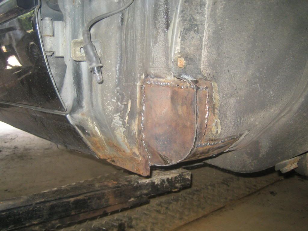

Actually got round to this jacking point today. It looked fine but could put a finger through the side of it. Out it came.
Only one of the skins needed to be removed. Bit of help with a hammer straightend out the worst dents when prising off the jacking point.
Self explanatory pic
Needs a bit of help but hey no more rust
A little tricky but hour-by-hour I cut away the rusted areas.
and here, almost
and finally that problem inner arch from earlier
and here, almost

Progress is slow, but here's some recent rust removal action...Still waiting on welder to be repaired (read: its cold outside)
Here's the outer sill about a foot and a half from the rear wheel arch. You can just see the inner sill which appears to be where a lot of sill problems stem from(?)
Had to remove quite a bit in the end. It's the only way as you know.

Another fresh bit, this time on the sill. Yet to apply a bit of filler to this.
