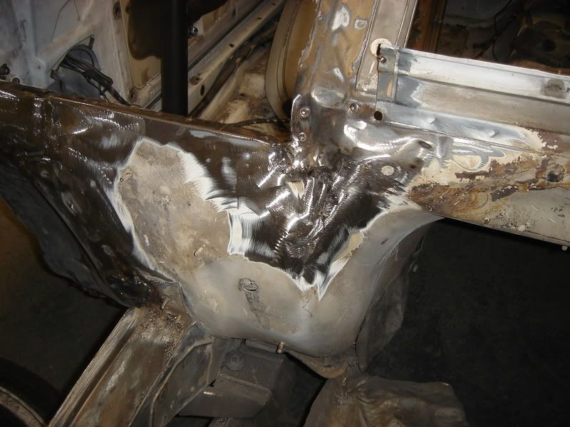

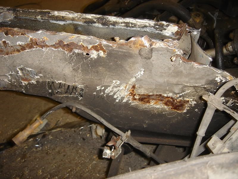

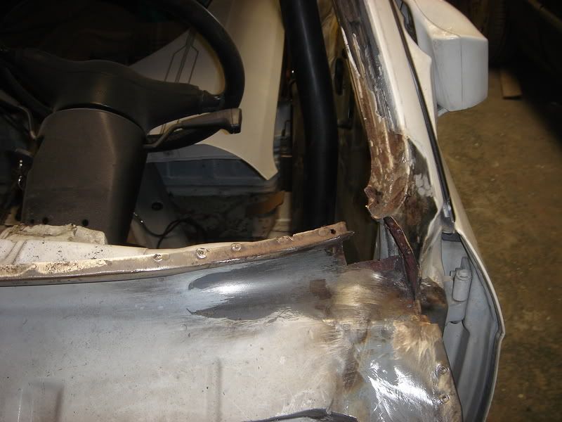

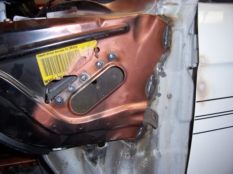

my e30 m3

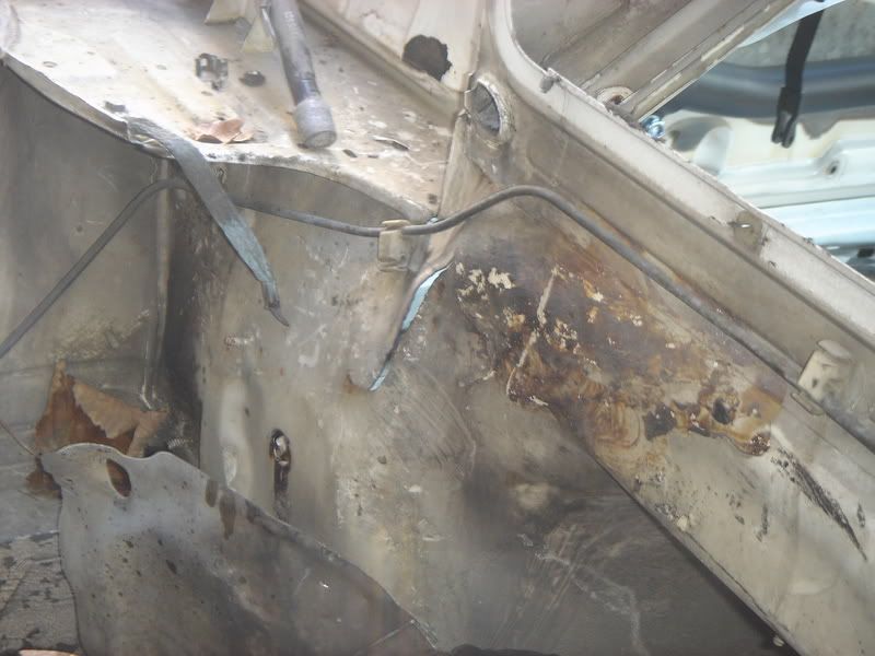

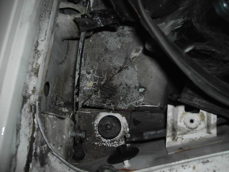

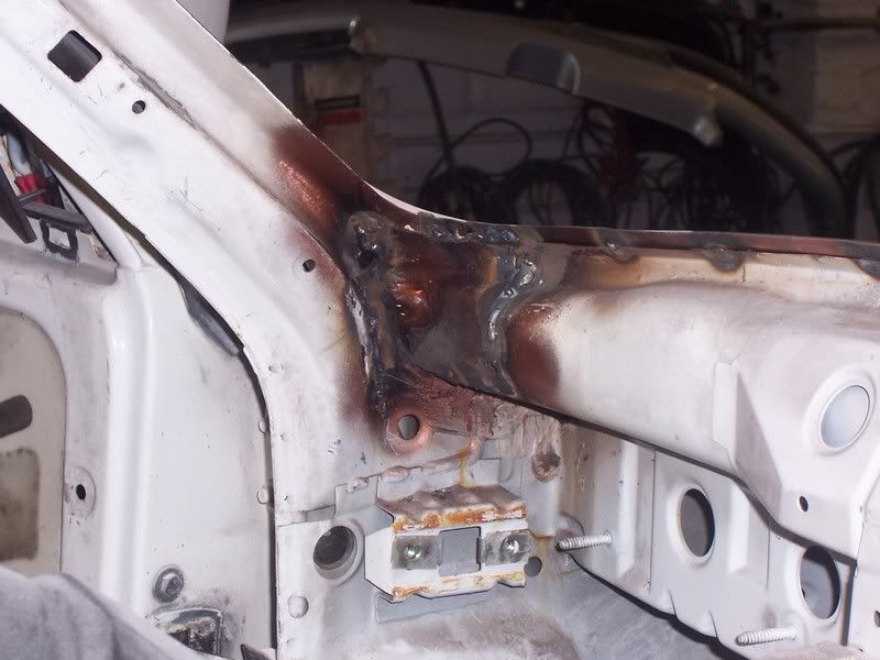

inner flitch
under fuse box
and from the top

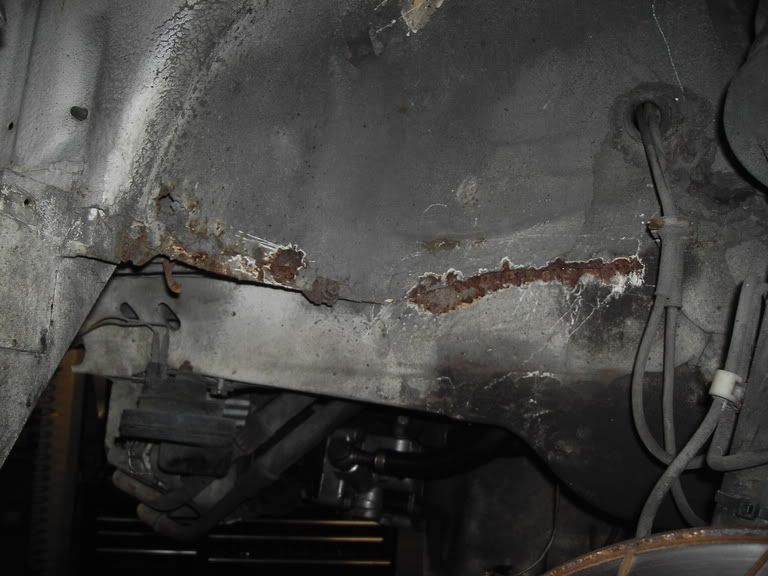

bulkhead
and rust the same place yours has gone
cut out
repaired, its doent have to be pretty but we did grind it back after

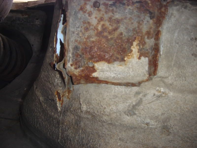

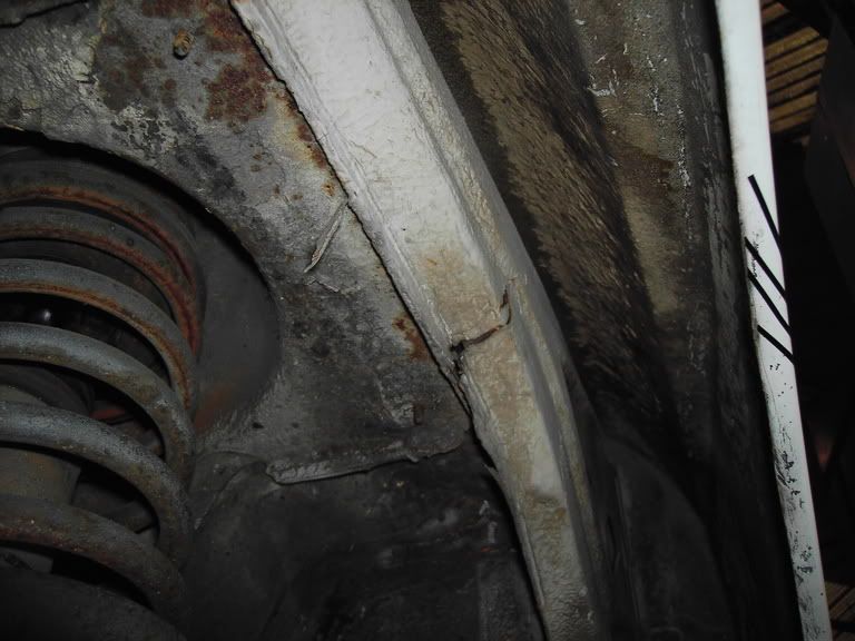

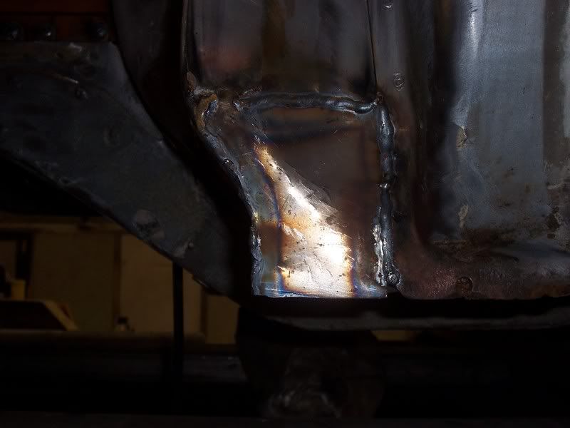

"jacking" point before & after

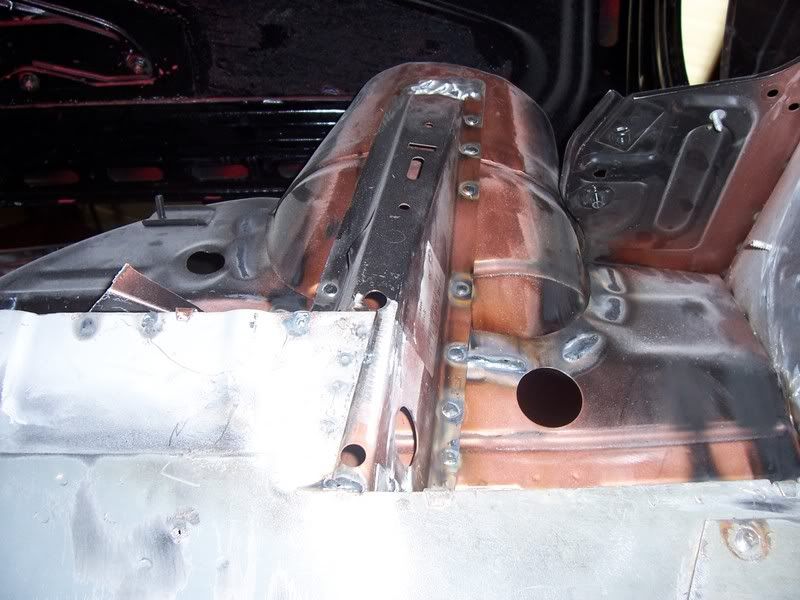

battery tray
[/URL]
cleaned up
[/URL]

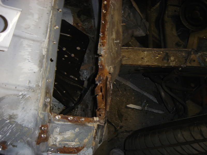

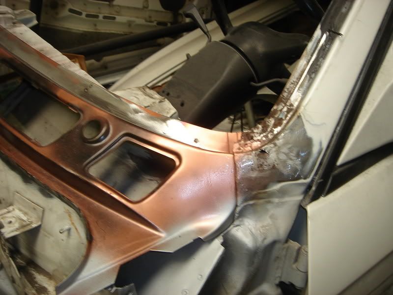

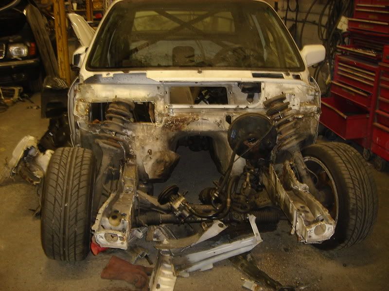

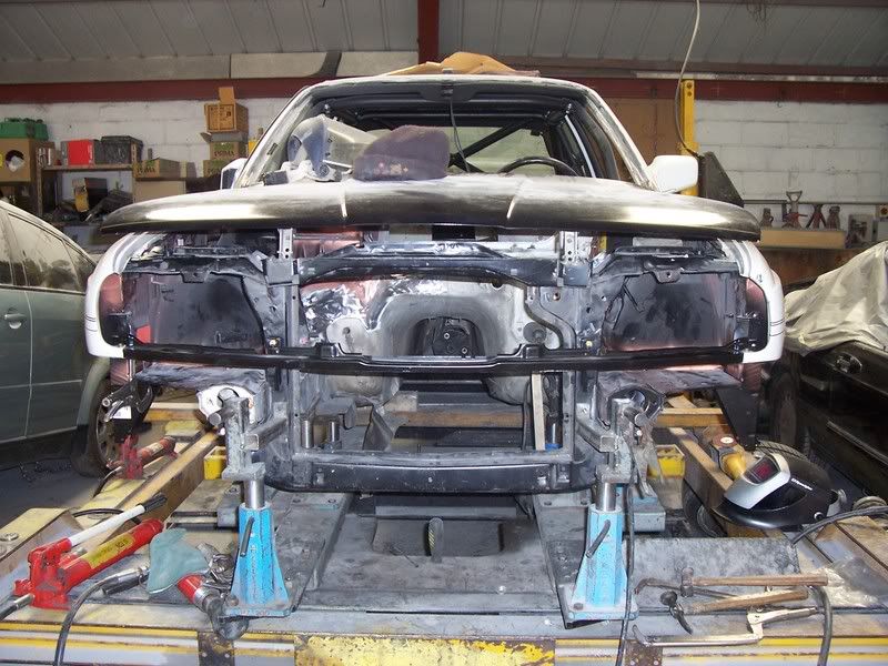

one of the chassis legs had evidence of previous very poor repair
basically the whole front end was fubard so we just cut it out
[/URL]

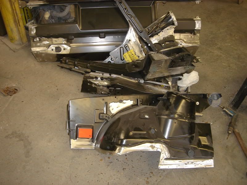

everything from the scuttle forward is new

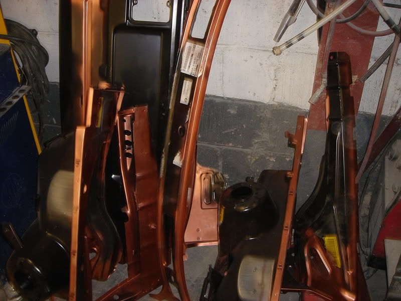

some of my panels being preped

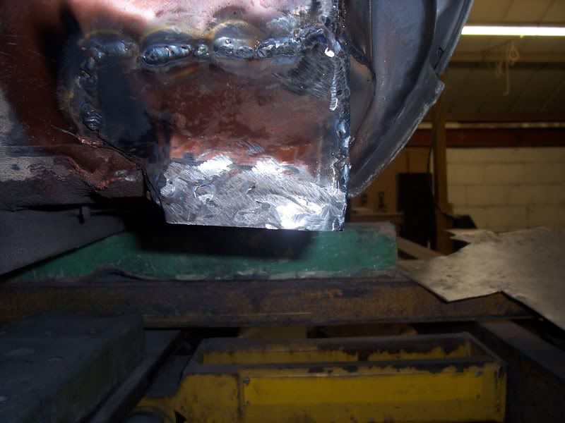

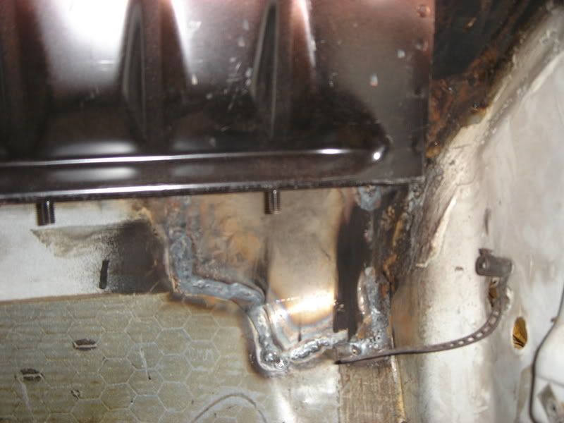

new battery tray and bulk head welding
some strengthening of the turrets
all built up on a jig
inner flitch
under fuse box
and from the top
bulkhead
cut out
battery tray
[/URL]cleaned up

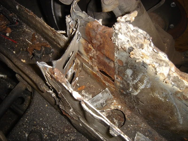

[/URL]one of the chassis legs had evidence of previous very poor repair
[/URL]

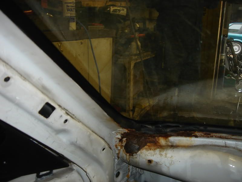

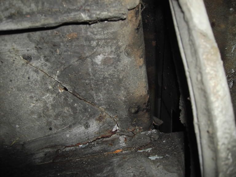

thats the scuttle
there is no repair panel for that rusty section as it part of the mail shell/monocoque
current state is the shell is done, i have lots of nice parts for it including bilstein grp N coilovers, brembo brakes etc
need to decide what donk to but into it, paint it and fit it up
sounds easy but its not

the scuttle needs to be cut and welded
the internal bit needs fabrication

- Posts: 18168
Be aware that the replacement scuttle generally comes with a stamped VIN that looks like it was done by Stevie Wonder after too many rocks !
The preferred move is to use both outer sections and join it through the scuttle grille aperture , thus retaining your original VIN stamping.

Kos wrote:some inspiration for you coming up
Nice work Kos, what way did you prep the new panels?

I've been pretty lucky with the vin no's that I've had stamped they were not too bad
As far as prep goes, edges that would see a welder were ground back to metal and had copper primer put on to them. The guys that did it were spot on, it wasn't cheap but it was done properly
