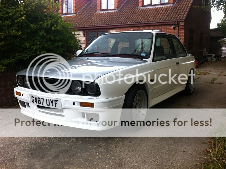

Got my hands on some replica mtec 2 bumpers and got to fit them, with a great deal of difficulty! then gave the car a mammoth rub down and alot of filler and filler primer! then skirted over with white primer-

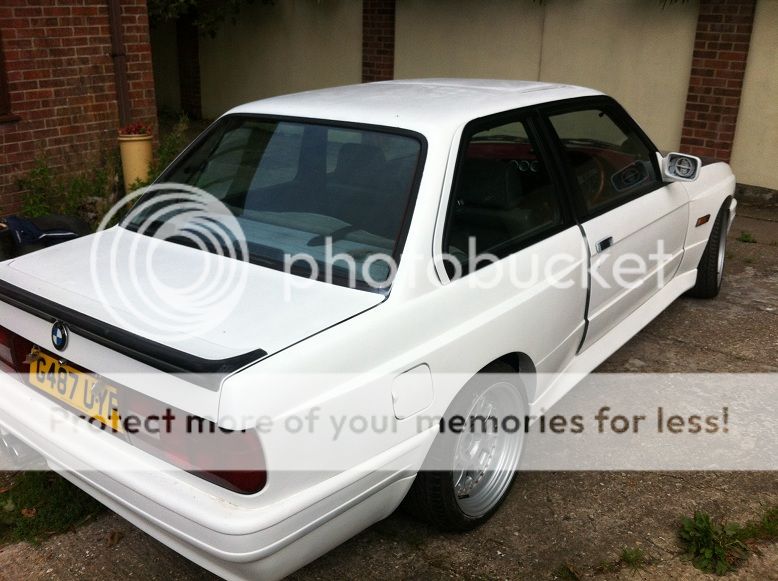

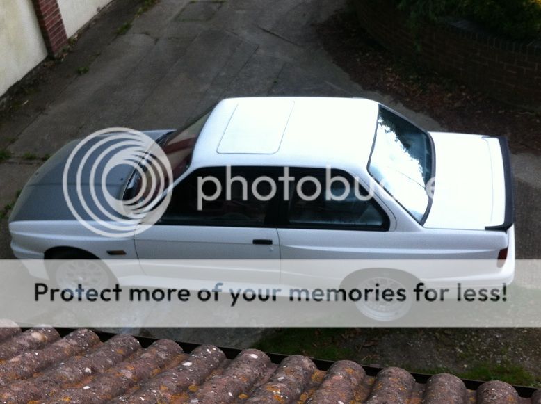

After that I thought that i like the whole matt white thing, so set about making it a better finish, but im having to build this project outside and due to weather im having a mare! but managed to finish the boot area so you can hopefully see whats its going to look like-
as you can see ive made a few purchases, like all red lights, mtec 1 spoiler and the red number plate surround! have a few more goodies being prepped and ready, like my image 3 peice split rims, they are at the refurbers right now but this is how they looked-
Now im also aware that this is not everyones cup of tea, but im feeling pretty positive that when im finished it should look pretty different and above all I should be over the moon with my efforts!
