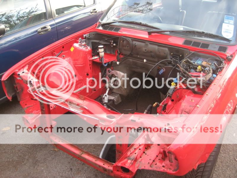

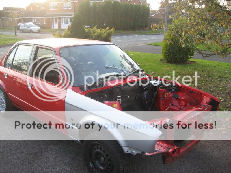

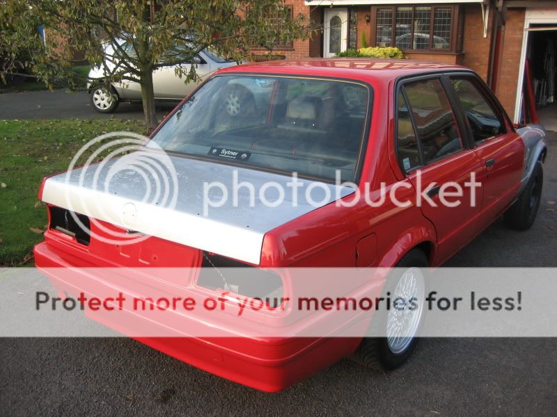

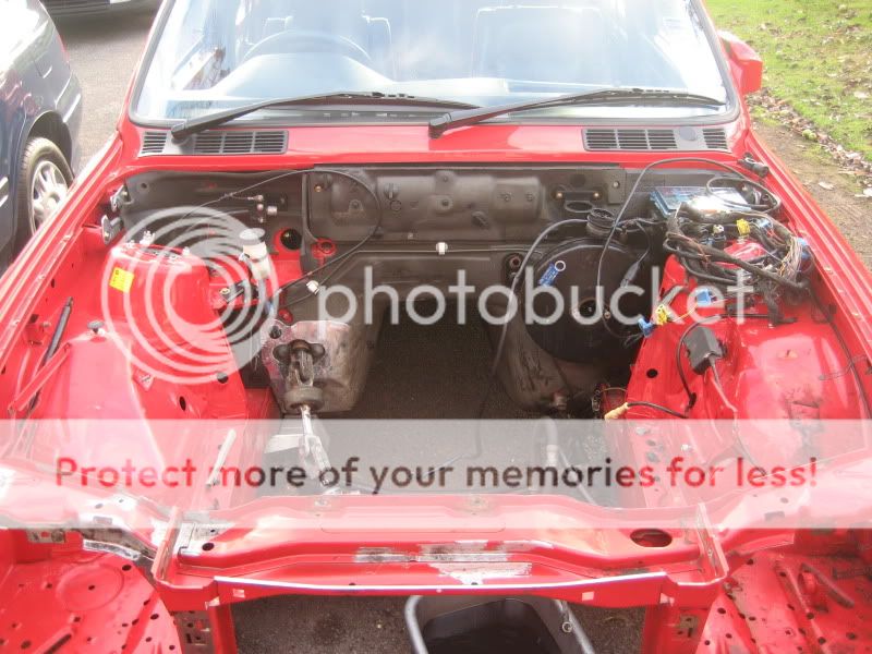

Well DanThe popped around today to get things progressed, engine now removed along with gearbox, prop and exhaust. ABS pump removed too, wont need that anymore, need to get that brake servo out as well, its a little too big !!! winkeye.
Need to degrease engine bay and remove a few more bits and pieces before hopefully it goes to the bodyshop in a few weeks time.
I'll let the pictures do the talking.
New drivers side wing and bootlid fitted thanks to dave318 for the parts and DanThe for getting them when he popped down to see Dave, my bootlid and wing were looking a bit too crusty in places for my liking :D :D

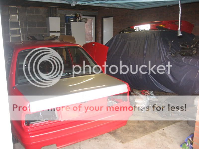

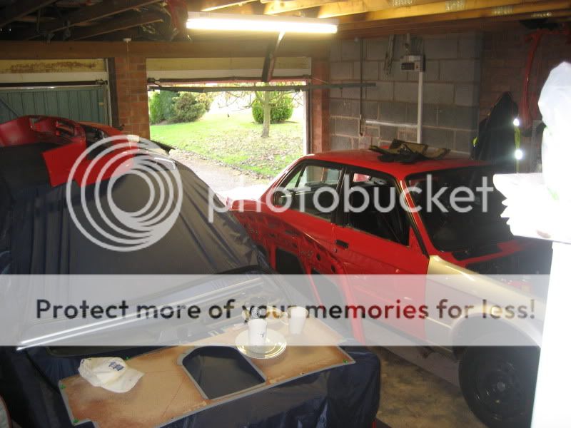

Heres home for both the moredoors, you can see the 84 moredoor nice and snug under the covers, dont worry it hasnt been weighed in, just waiting its turn :D :D
Thats all for now, busy day today, thanks again Dan :thumb:, not much to remove now then its time for paint, thats the next job to get done :)

M52?

Hmmmm.... Danthe assisting..... Got to be a twin cam....... could it be a tuned iron block b28 of certain provenance???

bss325i wrote:M52?
S50????

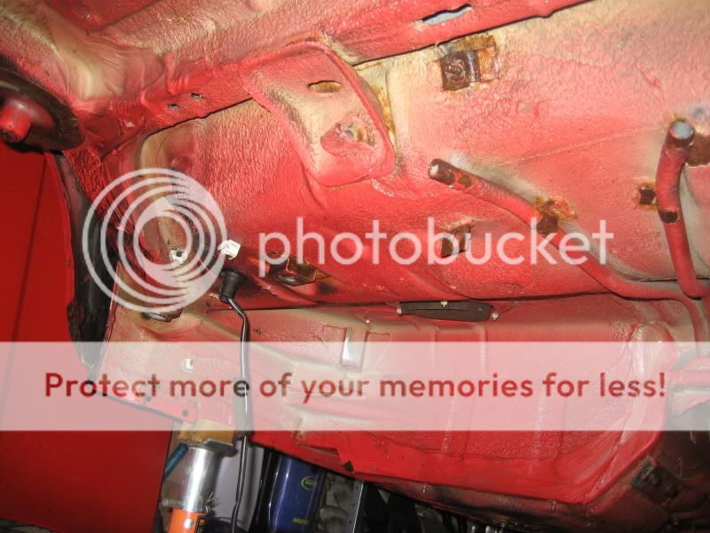

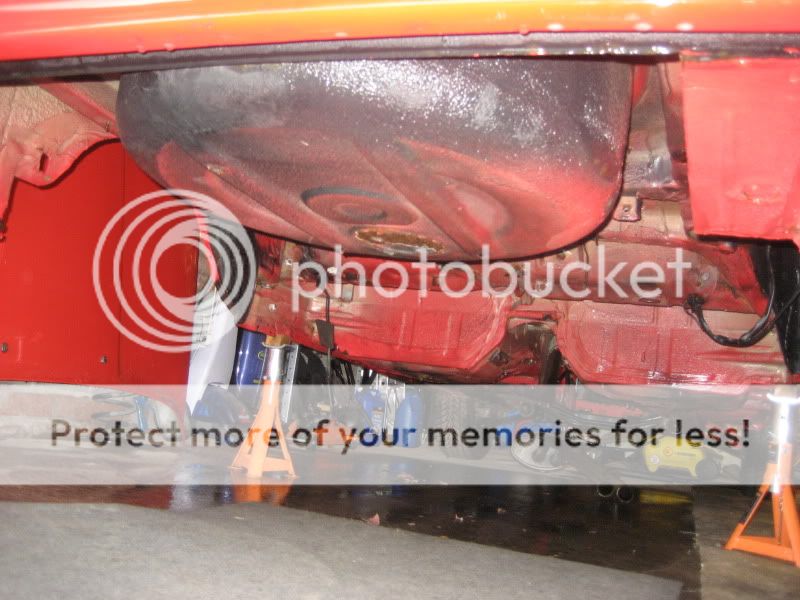

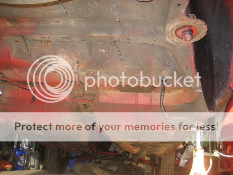

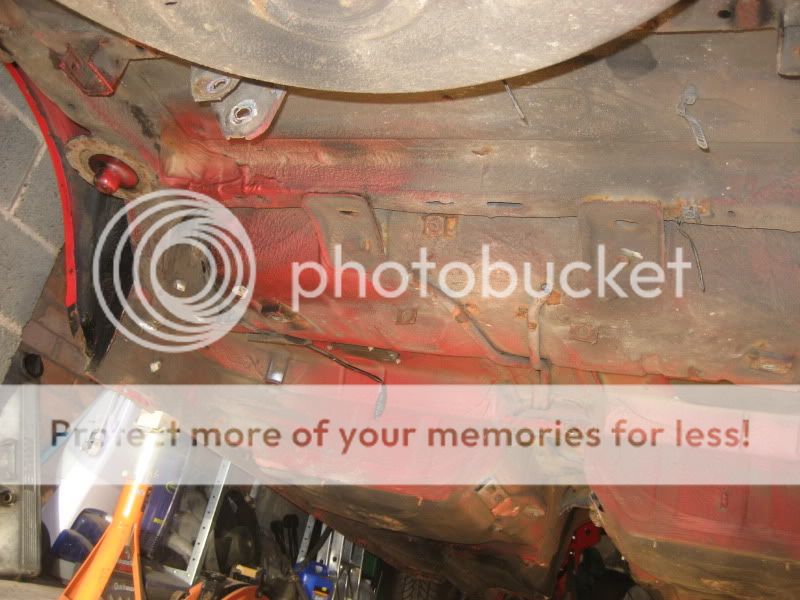

Update 21/11/09
Things have moved on a tad now, need to really as the moredoors booked into the Bodyshop from the second week in jan 2010 8O 8O
As i've got plenty of time until then :cry: :cry: , the underneath will be getting some attention, so off with everthing underneath to make way for:
New fuel lines, clips etc
New brake lines, clips etc
New heatshields, nuts, bolts etc
New fuel tank, nuts, bolts etc
New handbrake cables, nuts, clips etc
Suspension getting completely overhauled, new rubber, stabilisers, nuts, bolts, clips etc.
New set up will be Bilstein B12 kit for the front and back
New brake backplates, wheel bearings, discs, calipers and arms going for overhaul to make minty mint again
Rear beam, trailing arms, ARB's (Front 20mm, Rear 14.5mm), fuel filler neck all away for powder coating along with some front struts, Front cross member already done and waiting fitment of a minty E36 steering rack.

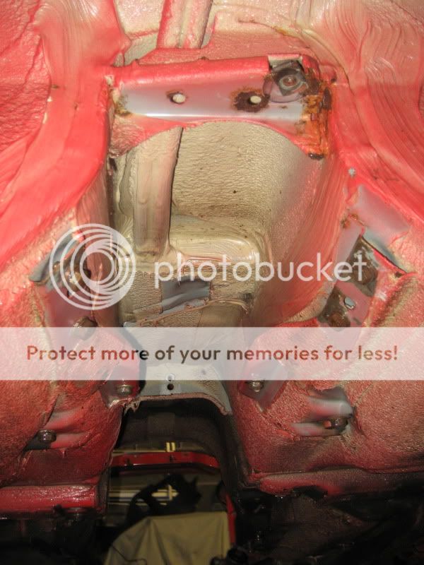

Had a litle help from a fellow zoner on, to move things on a bit, guess who.......?????
A few underneath which is now ready for cleaning, and spruce up 8O :cry:
This will involve locallised repairs to anywhere the original BMW body underseal has become split/compromised and affected by a tad of the dreaded rust, process will be:
Clean area with wire brush in drill to clean metal, apply rust treatment, paint with red oxide, apply seam sealer etc, then paint the complete underside black, easy....................... 8O 8O
Underside as of Friday afternoon before cleaning commenced
Update tomorrow with hopefully a nice clean underside.... :D :D

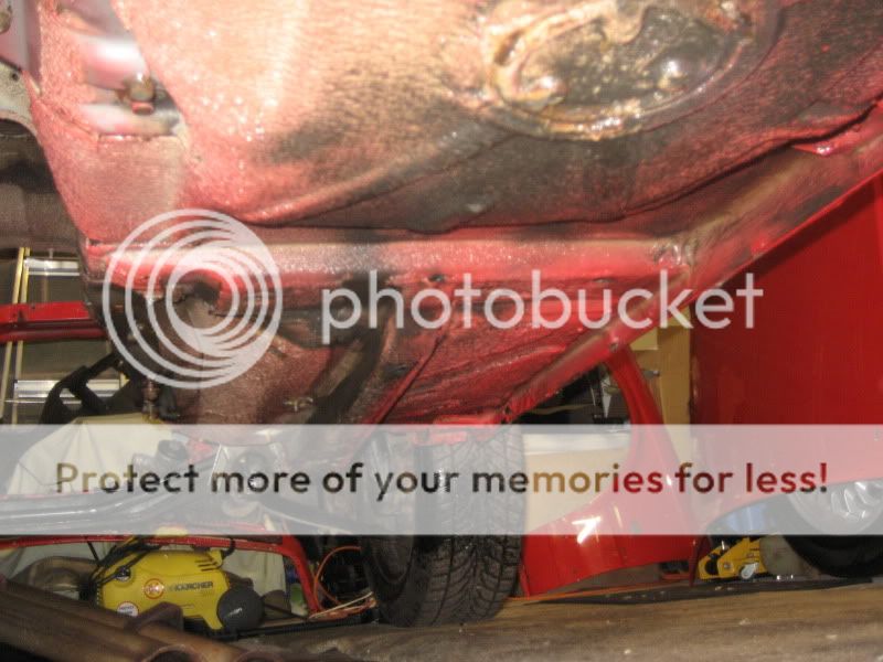

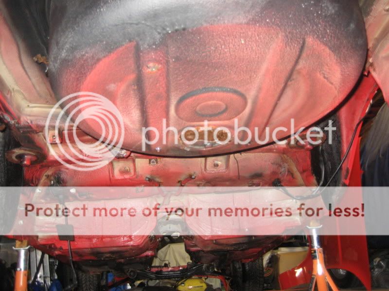

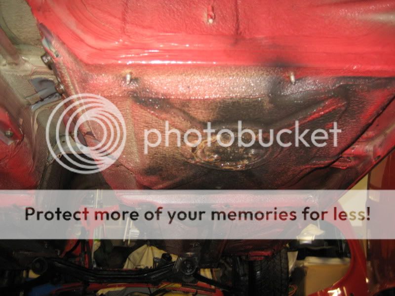

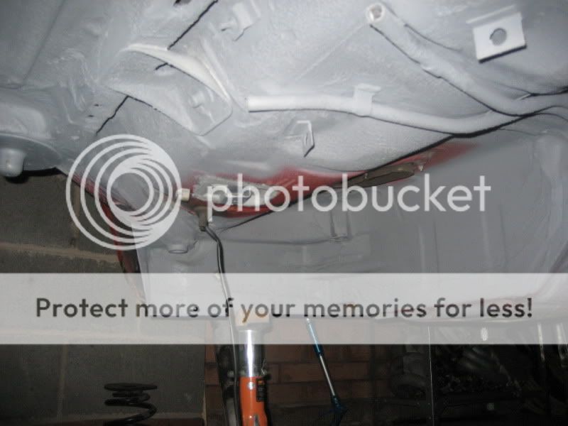

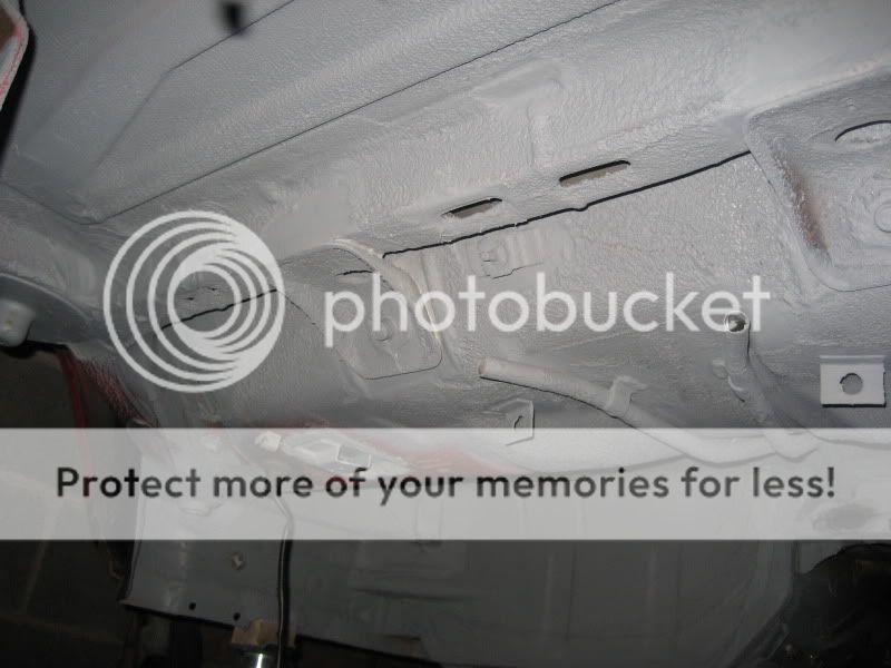

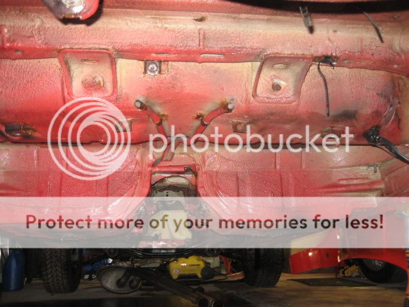

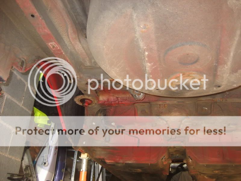

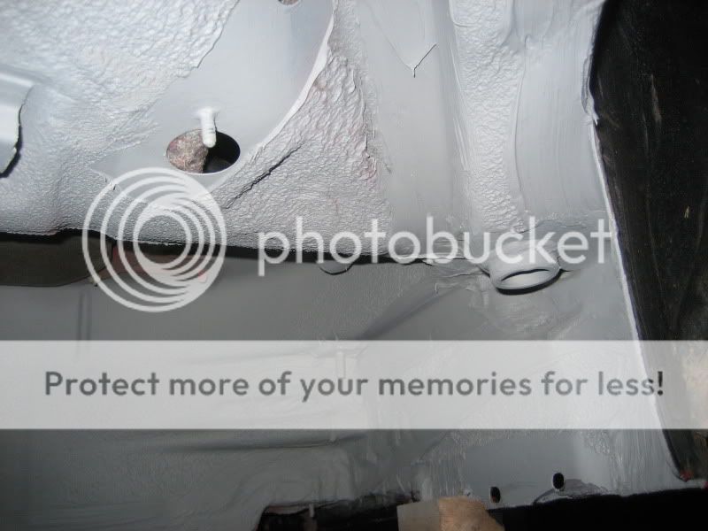

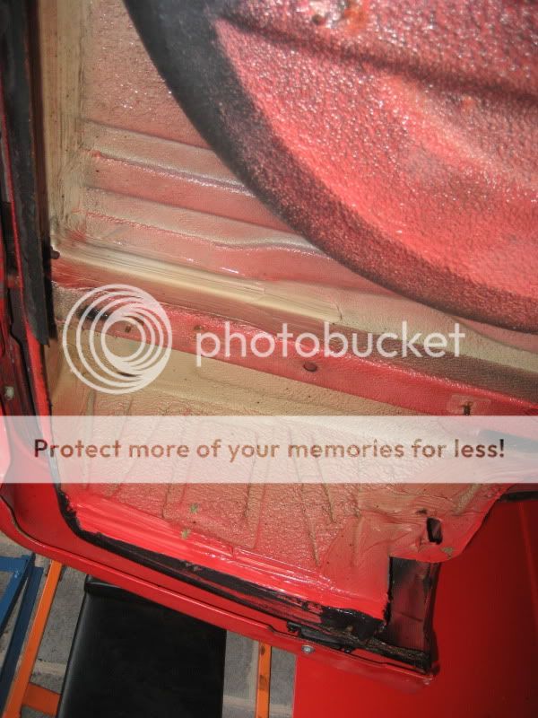

Little update nearly finished cleaning the underside now, not that many areas need attention, but those circular jobbies in the rear footwells and boot well look a bit crusty, will find out more when scrapping commences :( :( :D
Great news thou today, car now has confirmed booking at Beardmats body shop on 11th Jan 2010 woohoo........ :cool: .
Just need to get my finger out, get the underside sorted and rear beam back on after refurbishment, that little lot will keep me busy for a while over Christmas.
Here's a few piccies of the underside after cleaning......
Thats all for now.
Just purchased today some wire wheels for me drill, some zinc primer and some seam sealer, mind i might swop the zinc primer for etch primer instead now after talking with another zoner.
Mon Nov 30, 2009 8:59 pm
great stuff , I have all this to do .... :(
Paul what did you use/method to clean it underneath ?

Top job! Pressure washer in the garage FTW :thumb:
I see you have some of that nasty underseal around the spare wheel well :cry:

DanThe wrote:I see you have some of that nasty underseal around the spare wheel well
Thats what i thought, however its just black paint, probably to hide the wheel well from view, no horrible underseal to remove, just plenty of crap to wash off :( :(

Mon Nov 30, 2009 10:49 pm
e30topless wrote:great stuff , I have all this to do .... :(
Combination of Meguiars Super Degreaser
http://www.elitecarcare.co.uk/meguiars- ... p?cPath=48
and this Surfex HD All Purpose Cleaner/Degreaser
http://www.elitecarcare.co.uk/surfex-hd ... p?cPath=48
50/50 mix with water did the job with various old paintbrushes, washing up brushes(bristles a bit stronger), and old toothbrushes, ohh and lots of scrubbing........

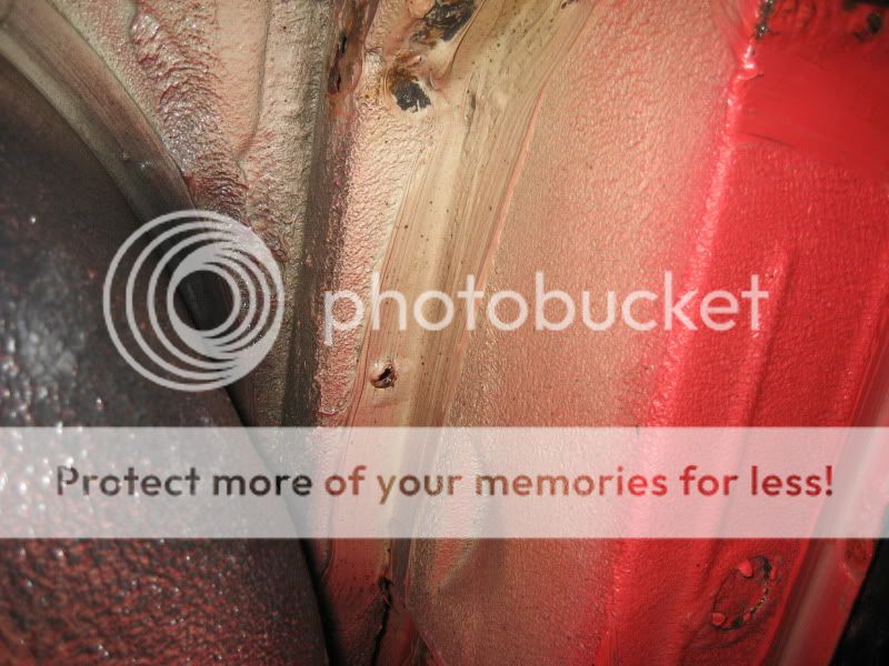

Sun Dec 13, 2009 9:39 pm

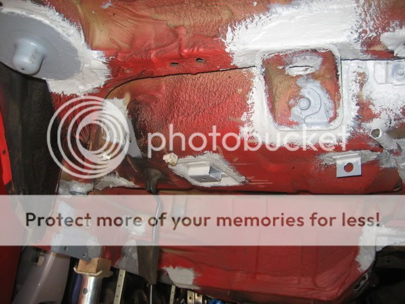

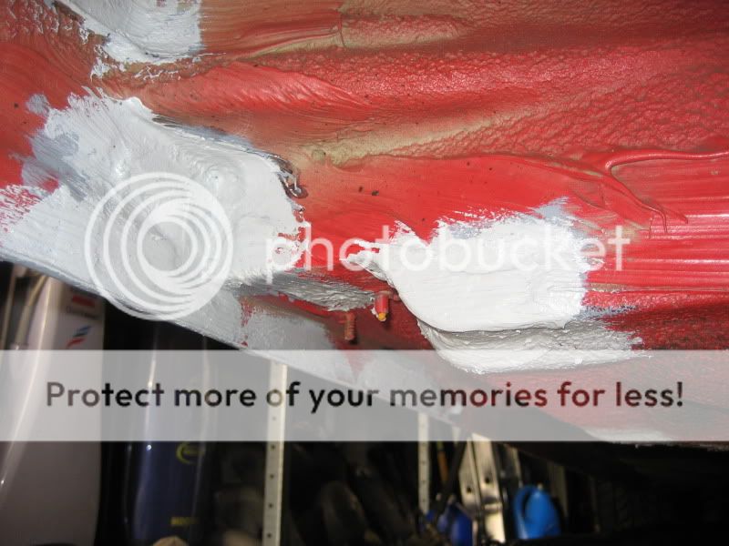

Little update for you......

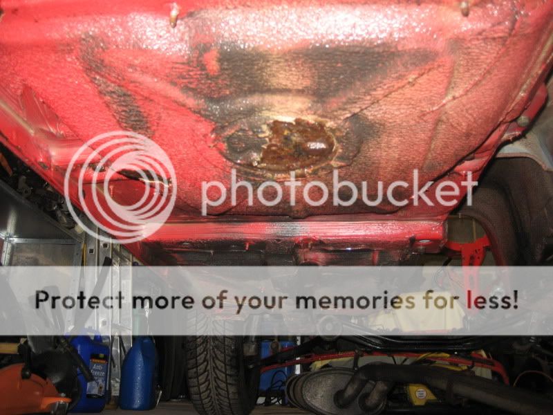

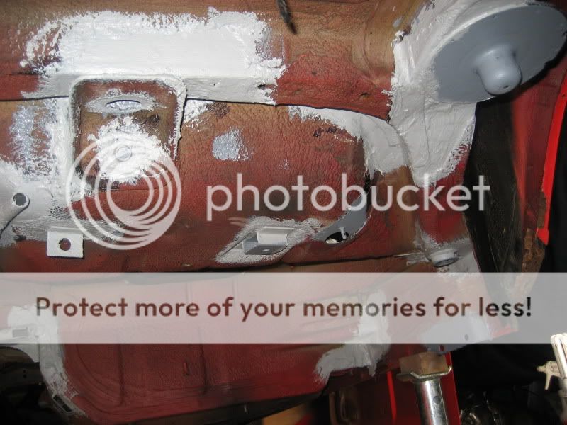

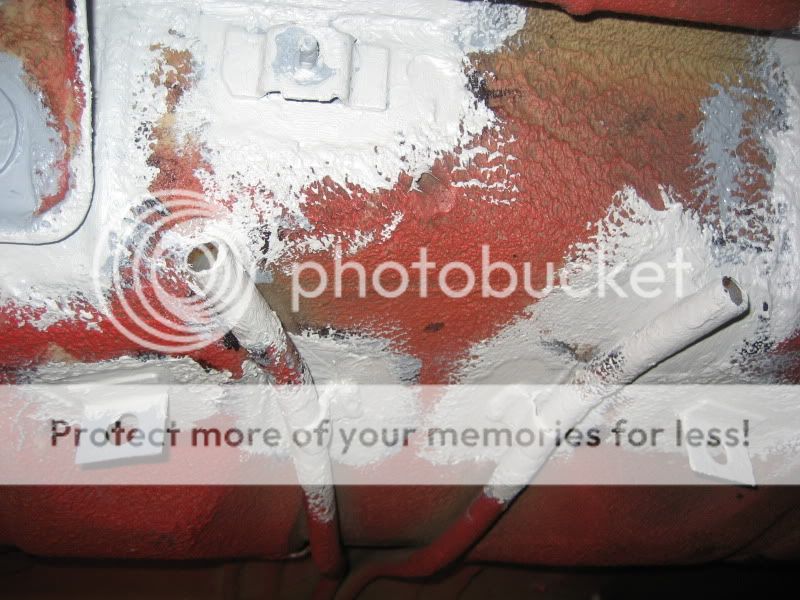

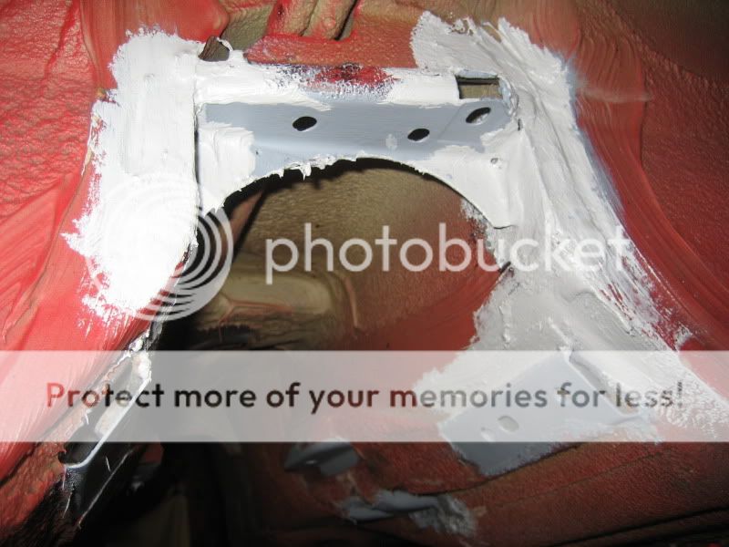

I took the wire wheel to any signs of split factory underseal/rust.
Lots of little repairs, However its amazing how far the rust spreads underneath once the underseal splits 8O 8O
Heres a few after:
1. Remove old underseal, grind rust down
2. Apply "Krust"
3. Apply Zinc Primer
4. Apply Seam Sealer
Ignore the bottom of the arch, move along no rust to see here!!!!!
And a couple after having a play with some primer, lots more to get painted and finished :D :D
Still lots to do underneath, before all the new goodies can be fitted winkeye

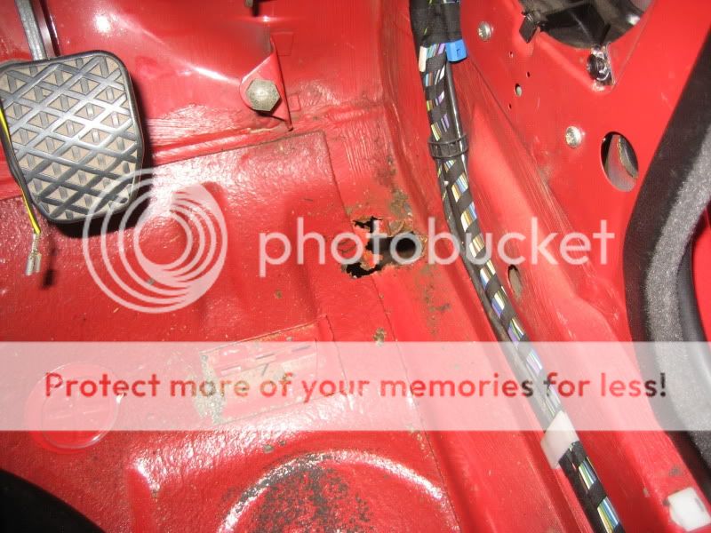

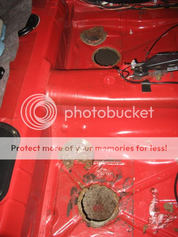

Good day today got loads done, so as i am retro-fitting A/C out with all the interior, dash and heater box 8O 8O
Knew these were fooked, new ones coming from stealers
Yet another hole for Matt to fix, exact size as the square factory jack pad, hope he isnt looking at this thread yet :( :(
So, only 4 weeks until its off to the Bodyshop, need to get underneath 90% finished, Matt hopefully will sort the rest, and get new rear suspension fitted so we have a rolling shell
Thats it for now :D
