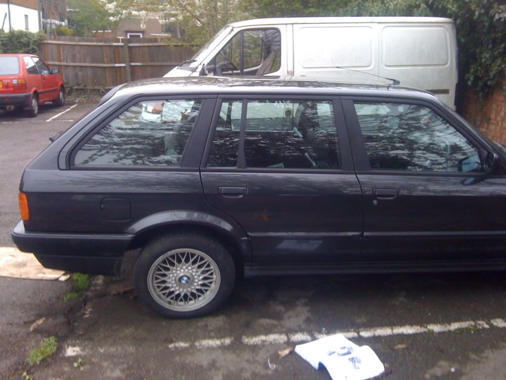

Got the touring back from Ant at A-Tech on Thursday. I would like to do most of the maintenance on it but thought it best if someone who knows what they are doing gives it a sort out to begin with.
He's done a great job I must say and the car drives really nicely, no comparison to how it was before it went in (it hadn't been serviced for 4 years).
It's had full service with new brakes, cambelt change, water pump, fluids, steering rack, pump, pretty much everything at the front suspension wise replaced, plus new rear shocks and top mounts as the self levelling suspension was knackered.
Prob some other stuff I can't remember as well but it now has an MOT and to drive it feels really tight.

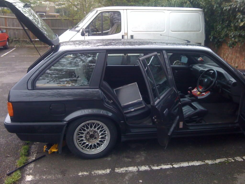

So, pic before (note laptop for Zone advice on how to change rear springs!):

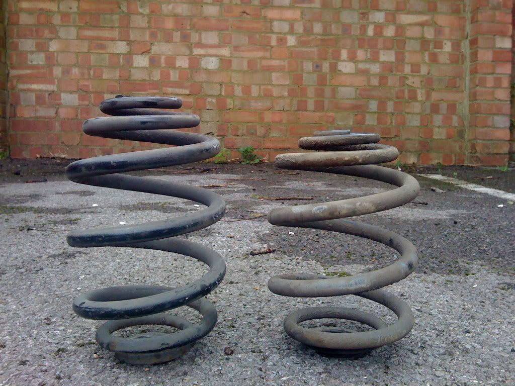

Simply undid the 19mm bolt on the damper, dropped the arm and took out these short ones. Putting these bigger standard touring ones on:

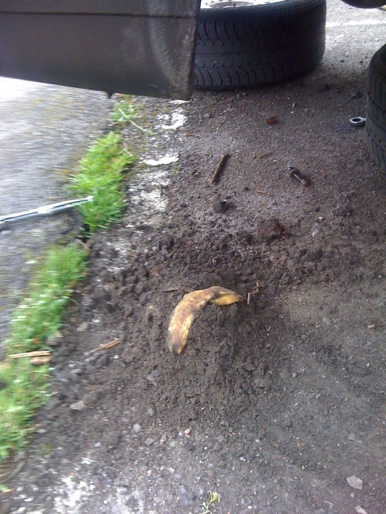

Ant recommened a good pressure wash under the arches and despite doing that still found a bit of mud around the filler cap while the wheel was off (banana skin touring optional extra)
Then swore a lot as it's a PITA getting those bigger springs in if your on your own and don't have a spring compressor thingy.
Ended up disconnecting ARB links and final drive bolt on the diff which helped get the arm a couple of cms lower. Then wound the spring as much into position as I could, sprayed a bit of wd40 on to make it slippery, then lying on the floor gave it a well aimed boot onto the spring seating. Not sure that's recommended best practice but it did the job. Just got to be very careful round the brake lines.

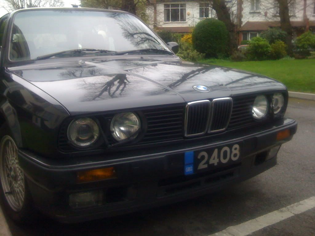

Swapped a very faded front grill round too. Before:
After:

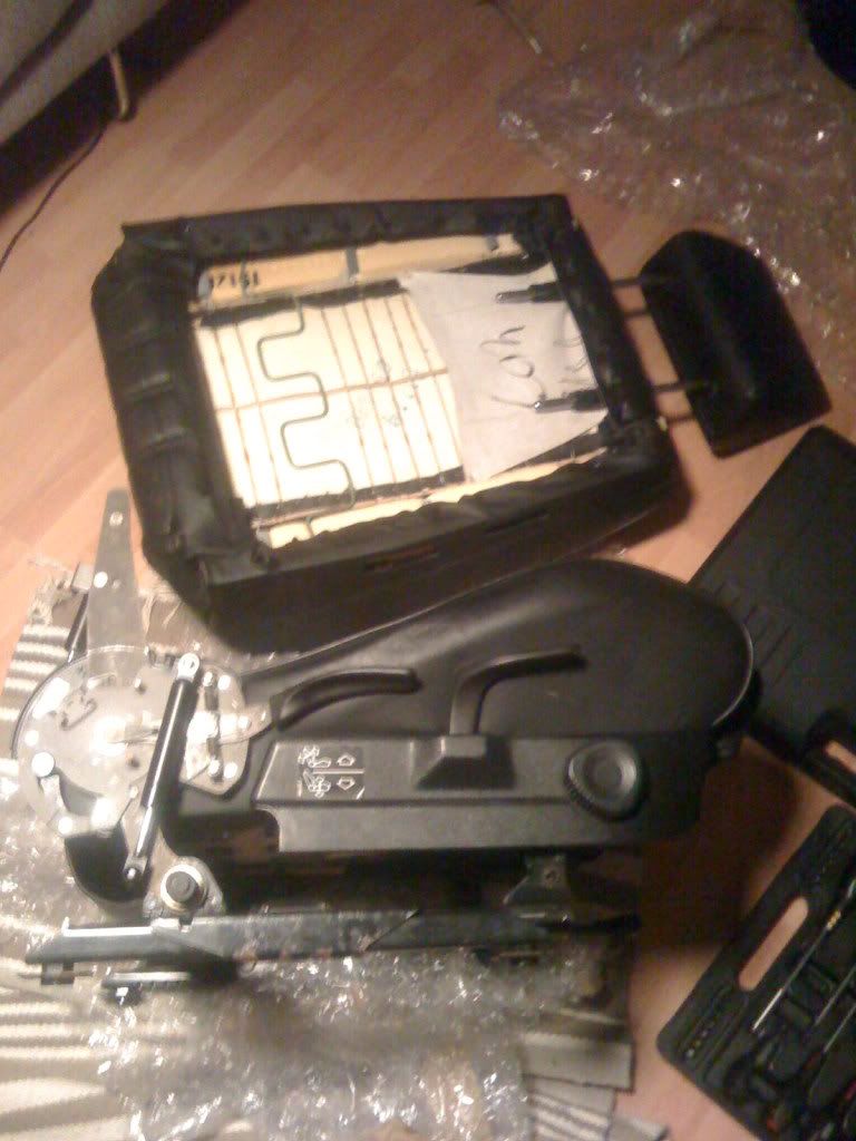

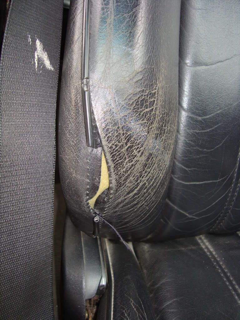

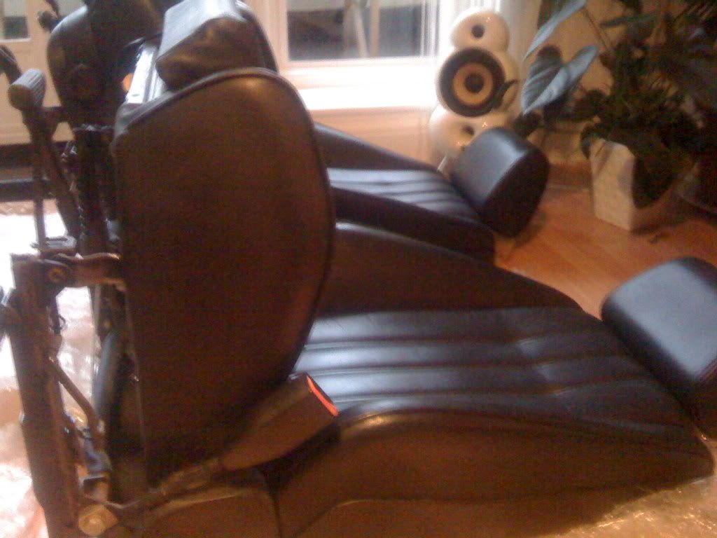

And my front room now has a nice new two seater leather sofa while I swap driver and passenger mechanisms round:
In order to get this bolster fixed up and have the driver seat as the passenger seat:

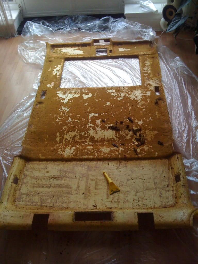

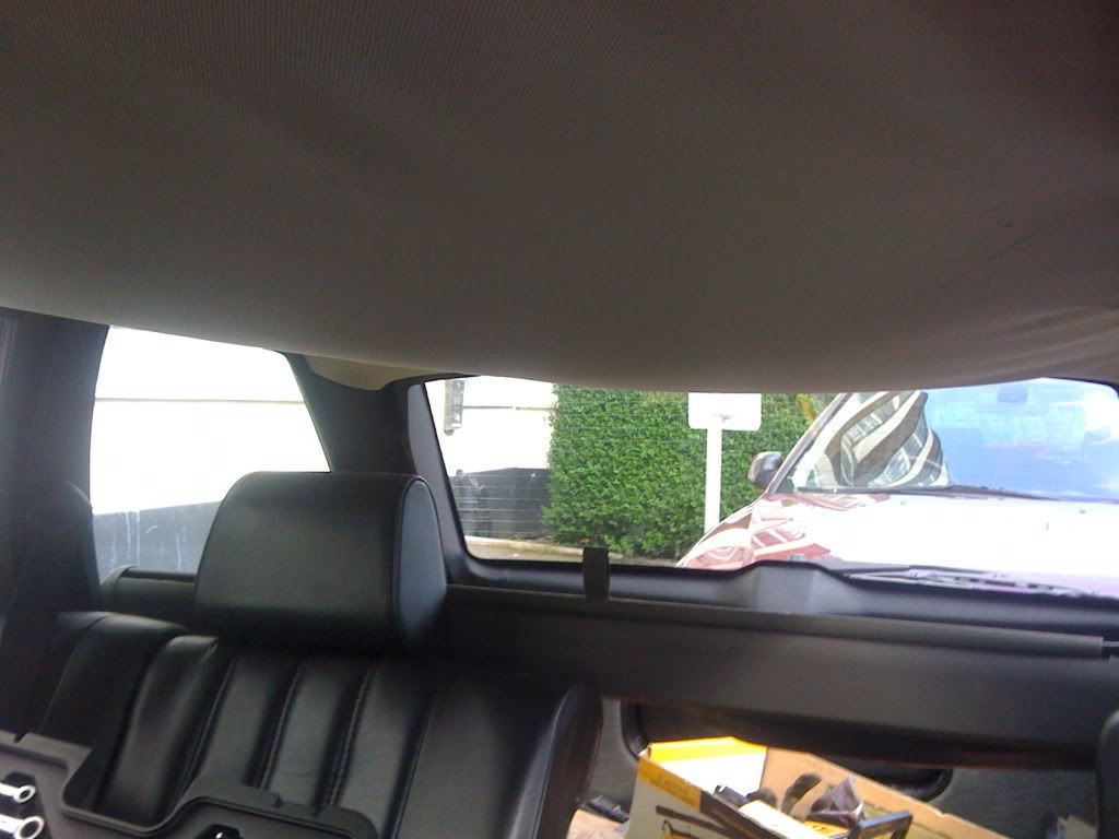

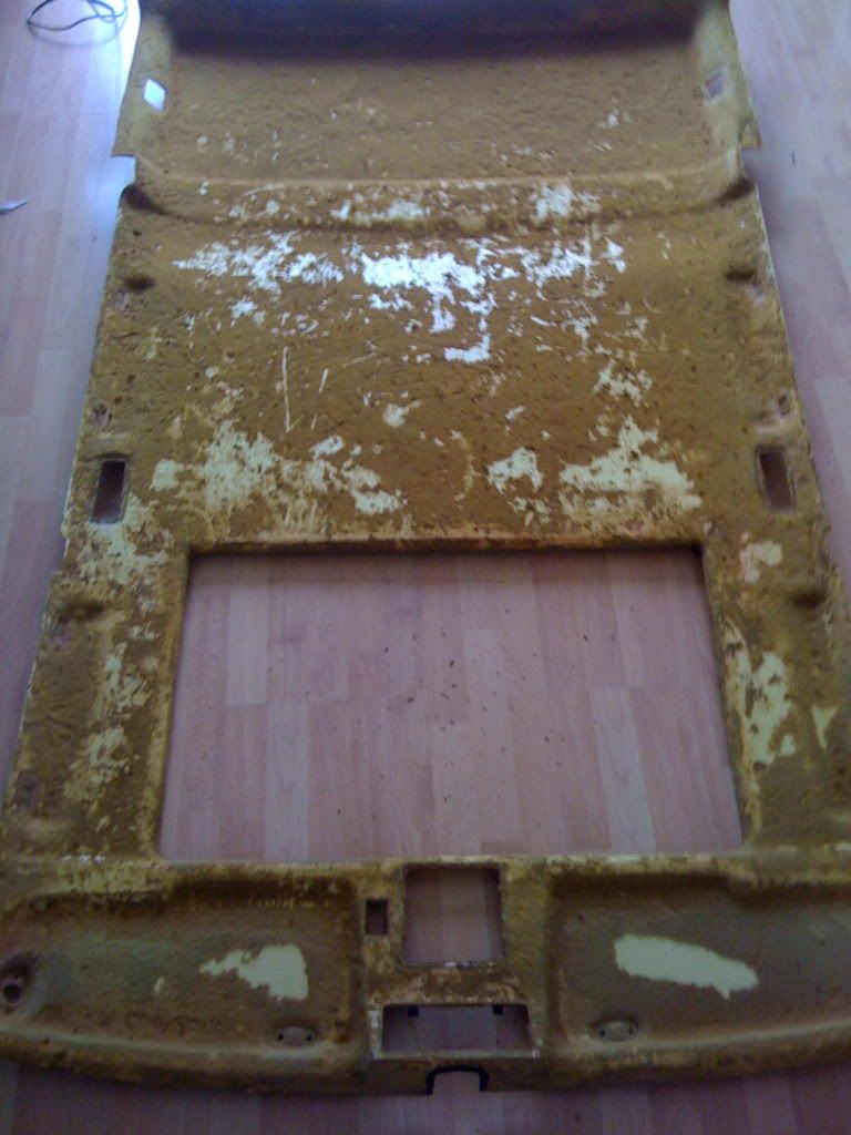

1) get the headlining out, re-trimmed in black suede and back in
