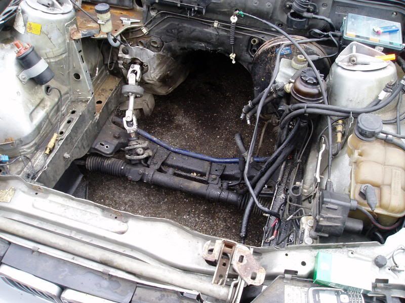

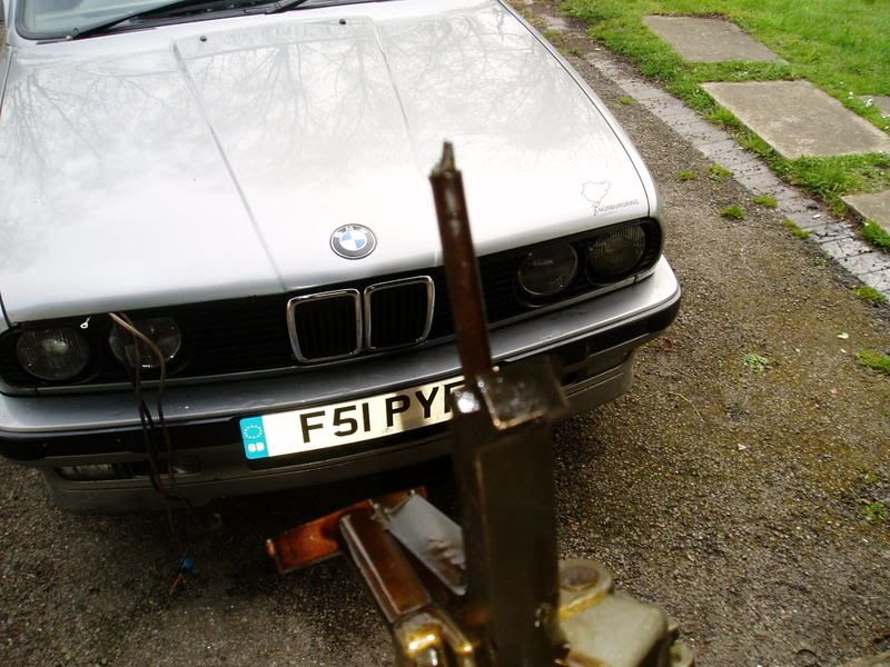

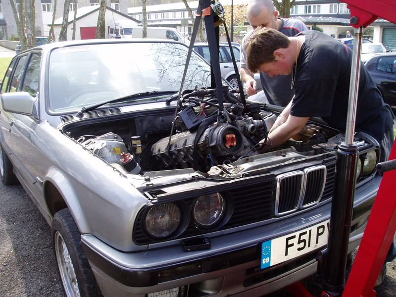

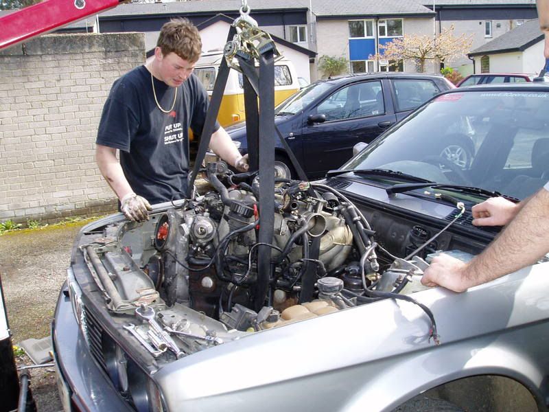

Got the engine out today
had a bit of a poke around once it was out but i'll know a bit more tomorrow
Chav i know before anyone says!
It's out!

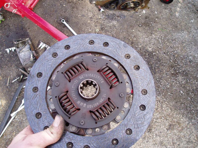

fubared clutch
Do i clean in here this week?!
So hopefully i'll have my lightened flywheel of Temple30 and i can get my replacement engine in and fitted with a new clutch and some other bits and see how long the next engine lasts! lol

fubared clutch

I would give the engine bay a good clean Simon, will make it a nicer place to work and its easy with the engine out init!
Dont stop there though, if you open the door you will find the driving control area which could also do with a damn good clean and general cess removal
cue mattg dissing the state of my van

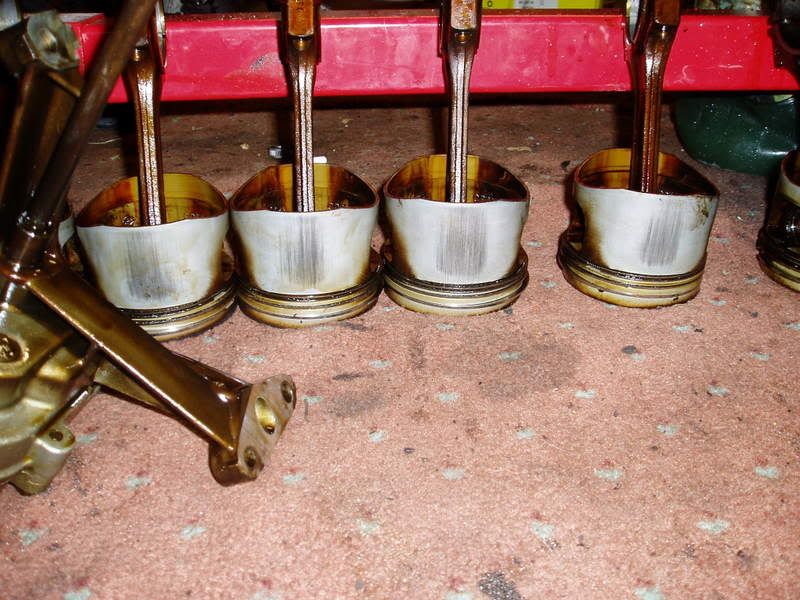

Stripped her down tonight and found the "problem" lol

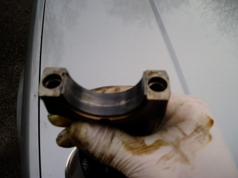

Shells look like they were getting hot! would of seized quickly i recon

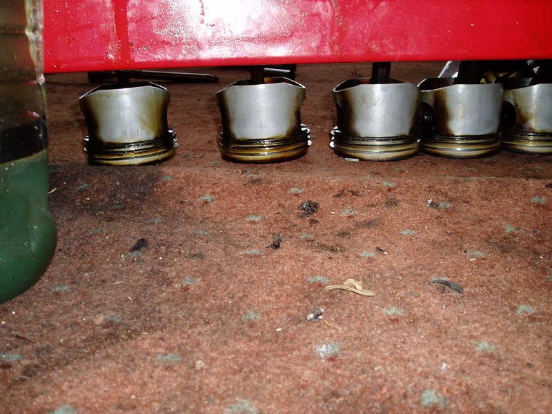

Pistons coming out usual wear on the thrust side, bores look pukka with honing marks clearly seen down all of the bores but nothing obviously wrong yet........

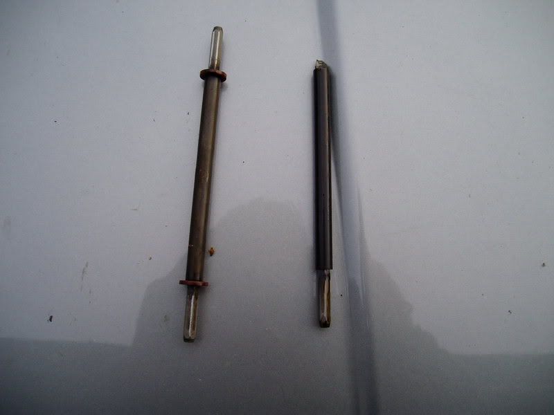

Ouch that'll be why the oil light came on! The bloody spindle had snapped but why?
broken spindle next to a good one

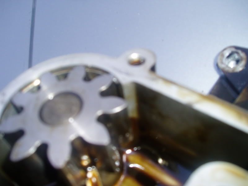

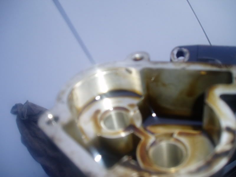

Also i couldn't spin the pump gears round by hand, so i took that apart
Pictures are sh!te but basically the gears were jammed by a small piece of metal. You can see in the bottom pic where theres a big groove in the casing and then the pump or spindle had had enough. It nearly worked it's way right round though. Who knows what would of happened if it had been passed else where through the lump. What gets me is how did it get through the filter? i doesn't really look small enough
Also it doesn't prove to me that wacking the sump on a speed hump caused this to happen either and it could of been a coincidence?
Top end was mint and had no wear on the cam lobes or rockers. Light scores on the main ends of the cam but don't they all? So overall i'm pleased that the engine looked to be in good health, and lots of parts can still be re used. So i think as i quite like this engine it shall have to be rebuilt into a 2.7 of some sort.

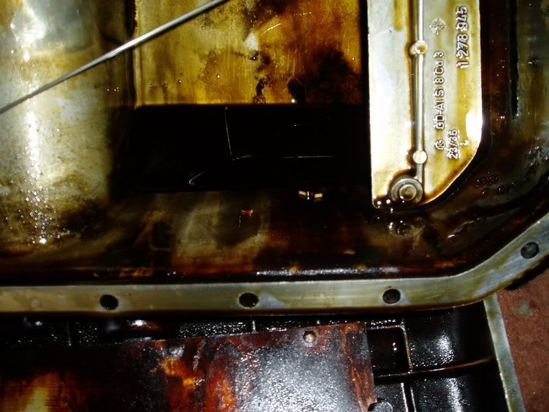

Hmmm bits of red plastic in the sump
Time to look at the oil pump
Well the filter is after the pump, you need to see if the strainer has any holes in gauze before you re-use that, to be honest that piece of metal could have been sat in the sump in a quiet corner out of the main flow of oil for weeks, months eaven years. Then it got disturbed and somhow got past the strainer, only the tight tolerances of the pump gears stopped it makeing its way into the bowells of the engine and saved your top end.

[quote]Hmmm bits of red plastic in the sump
Did I miss it or did you find out what the red plastic bits were??

i won't be re using the oil pump! Thing is i cleaned out the sump when i changed the gasket last year.
The red plastic bits are off the broken spindle, Matt i only got the old engine out on sunday i'm getting the new one in this weekend i hope!
