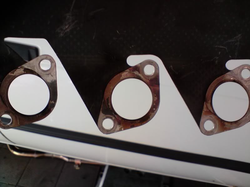

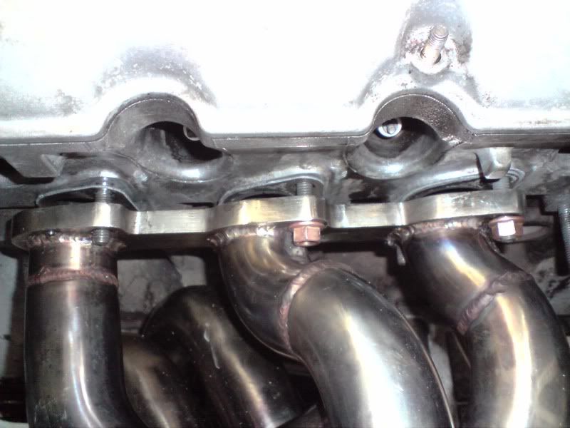

Ok guys, I didn't have a chance last night but here are the pics:
This is the back gasket that doesn't line up with the pipes, you can see the soot around it and where it has sat against the pipes the past week and that it is quite a long way from fitting properly
And here you can see how the manifold doesn't line up with the exhaust ports
A shot of the gasket against the pipes (front one used for the pic)
I have sent a detailed email to hottuning with those pics so hopefully they can sort me out with a rear manifold section quickly. I'm supposed to be taking this car on the zone roam! My tech 1 is in bits. :?
Now i've calmed down, i'd say to those that are now a bit weary about getting one shouldn't be, it seems as said that this is a one off case. Its otherwise well made and the front section fitted very well. As long they sort me out with the new pipes quickly and some compensation then i'll be happy with it.
I still can't believe the performance improved (and I assure you it did) with that amount of gasket overlapping the pipe, will only get better!
Its off the road though now, i'm not driving it with that blow, so i'm not too sure how i'm getting to work this week. :roll:

Wed Apr 09, 2008 7:51 pm
Guys,
I have to wait 2 months for a new manifold!!!
Hottuning say that every manifold they have in stock has the same problem!
They have confirmed that the defect is that the flange has indeed been welded on the wrong way round on the back section.
They say someone else has reported it as well and I have had a guy from the zone pm me saying he has the same problem. :(
Hottuning told me it should fit for the time being as their other customer with the problem managed to get it to fit without any apparent leaks. :?
However, we couldn't get it to fit without leaking and i'm not prepared to drive it around like that so we dug my old rusty bits out of the metal skip and put them back on for now.
Makes me wonder though, if the other guy managed to fit it and it didn't leak, are there any other e30s out there with this manifold that have sealed ok but the pipes aren't lined up properly? :? If you placed the gaskets over the studs in the head and then put the pipes on, you might not notice, just like we didn't the first time!
Hottuning have been pretty good so far since, always quick to respond to my emails, although i get the feeling we're not always on the same wavelength. They have offered to compensate me, although i don't know how much yet, and even offered to send a new defective manifold to see if it would fit any better for the time being, can't see it making any difference though!
So obviously all of you that have got new ht manifolds or are getting them, for pete's sake check the gaskets against the pipes before you fit them!
