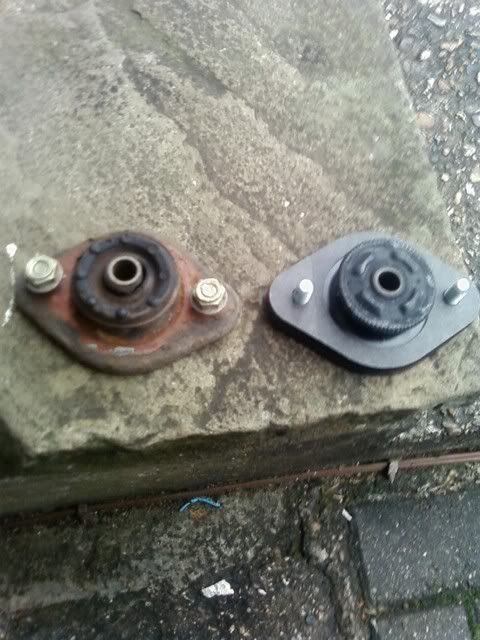

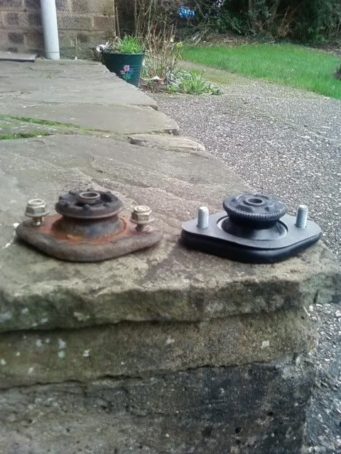

a pic i took recently when upgrading whilst upgrading the rear top mounts

Thanks for the replys and pics mate
Think what i must have seen looking up at the underside is the bit on the pic below that has 4 raised bits - looked completely split in half 8O
Cheers! :)

on mine the centre core had come off the rubber and was rocking like a bitch
