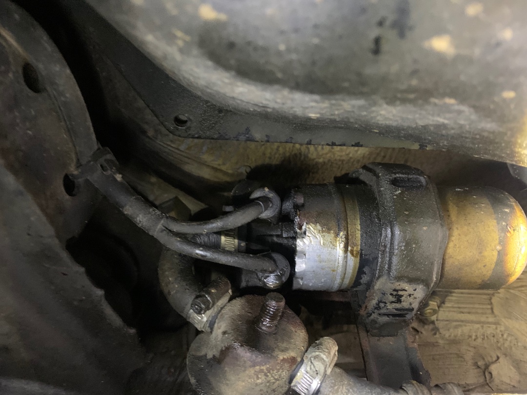

ImageThis is it. Why does the fuel filter have wires to it?

ricardo2019 wrote:
Tue Jan 11, 2022 6:31 pm
Because it is a pump :D Not known later cars to have them but early Motronic cars were a bit of a basket case and they are all well over 30 years old so anything could have happened

Thanks mate. So would you think that is the only pump?
flybynite
Posts: 1693
Wed Jan 12, 2022 4:26 pm
ricardo2019 wrote:
Wed Jan 12, 2022 8:51 am
No there will be a pump under the back seat too, at least that's the way it is on the L-Jetronic models like my 323i.
My 325i is a bit later and only has one pump which is under the seat.

My '87 car has just the one pump in front of the n/s wheel- under the seat there is just the fuel-gauge sender-unit.
The way to tell if there is a pump in-tank is to check the number of electrical wires going into the top of the tank- if just 2(i think) wires are present then that suggests just a sender-unit is inside the tank. More wires means a sender plus pump is fitted.
