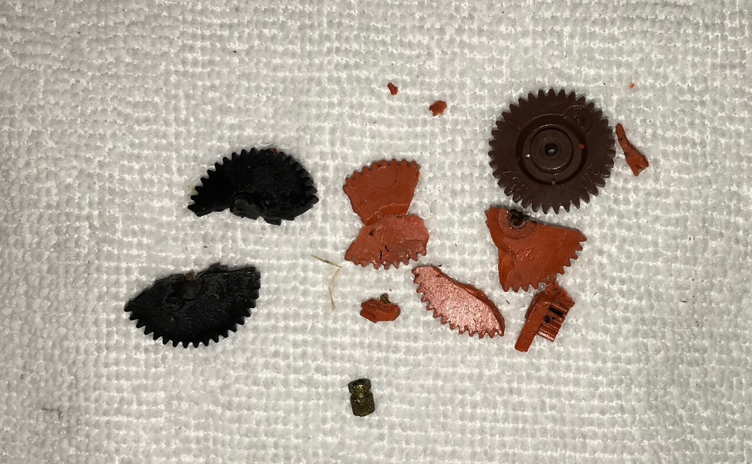

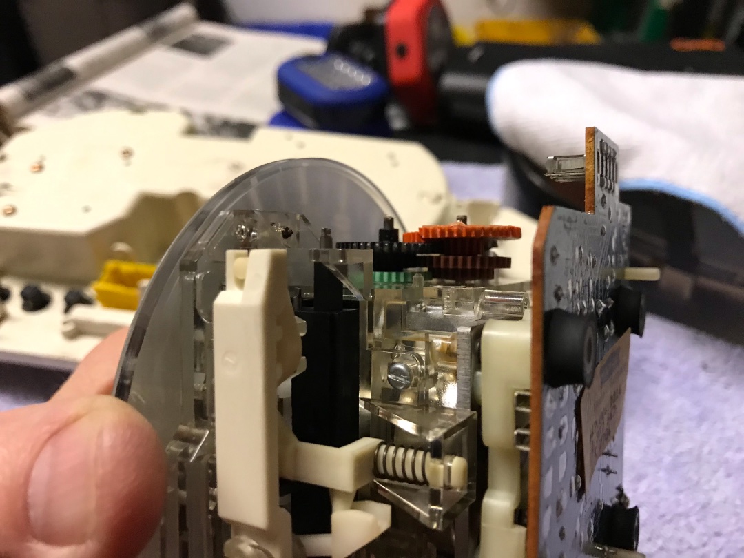

Saturday evening I installed the new odometer gears I ordered from Garagistic a couple weeks back. I definitely recommend their gear set. The installation went very smoothly, with the exception of what’s called the E1 gear. It’s very tight by design, but installs onto the spindle that comes off of the odometer’s drive motor. Pushing it on was difficult in that and there are warnings in the directions (and all of the YouTube videos I watched) saying DON’T push too hard or tap the gear into place, for fear of damaging the odometer drive mechanism. It is recommended to hold the spindle with needle nose pliers while pushing the cog into place “firmly but gently”. It was awkward and scary, but after 20 minutes, some swearing and walking away a couple times, it suddenly popped into place. I took some photos of the old gears. They all crumbled like bleu cheese, save one which flexes like rubber. I meant to take an “after” picture of the odometer with new gears in place, but I forgot. I can you tell it looked like an odometer should look.

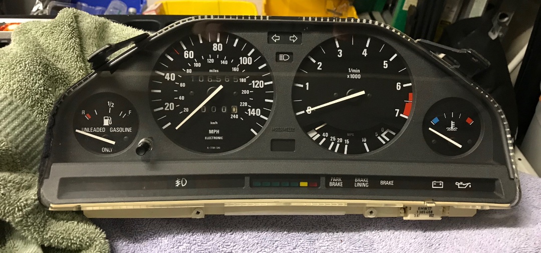

A photo of my finished instrument cluster is attached as well. I hope this is helpful to others running into this rather common problem. Sean
