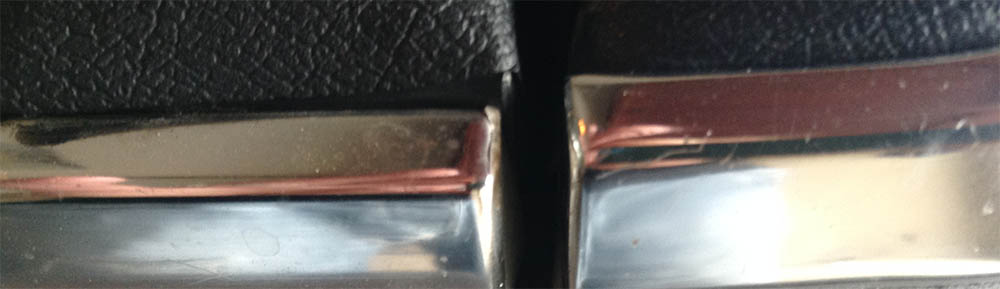

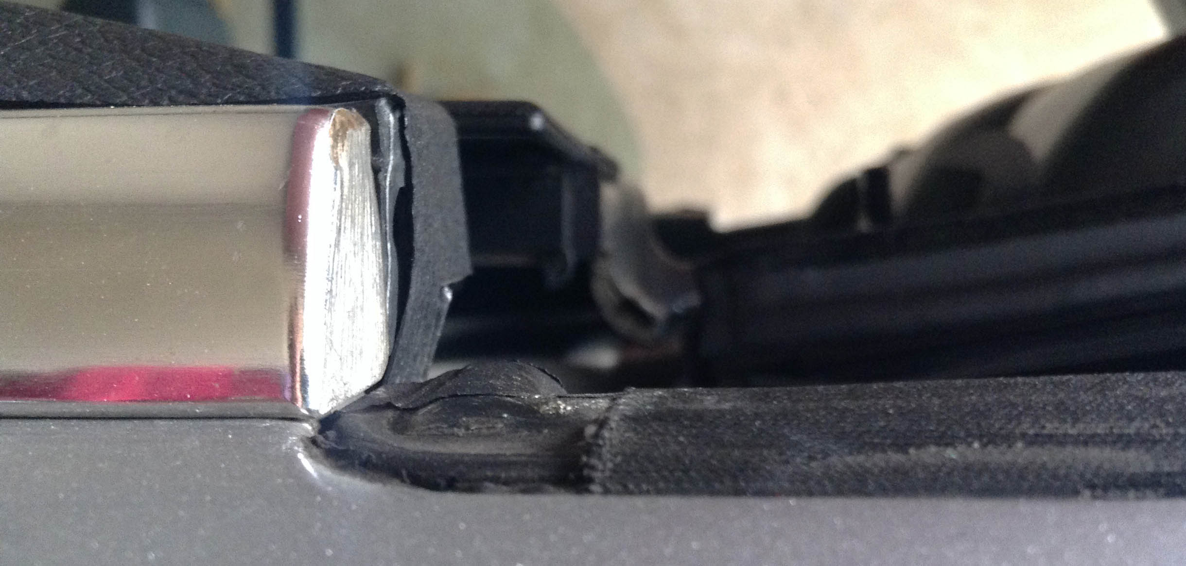

There is a 5mm gap between the horseshoe and the window escutcheon allowing easy access for plenty of water off the roof, even with a new rubber - which is widely available from BMW, Leebmann, EBay, Pelican etc etc
Also at this point the rubber is flat and doesn't stop water ingress at all - just badly designed - but if your drains are clear then no issue at all.
http://whitewatermedia.net/media/horseshoe.jpg
http://whitewatermedia.net/media/horseshoe%202.jpg
Paul :-)

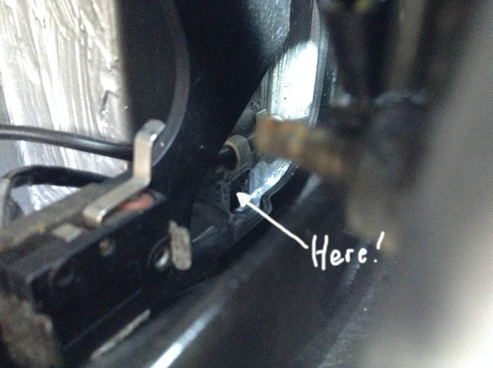

They are on the outer face - and a bugger to find if full of crap - I'll see if I can get a photo -
http://whitewatermedia.net/media/drain.jpg
image of Near Side drain
here ya go
Paul :-)
