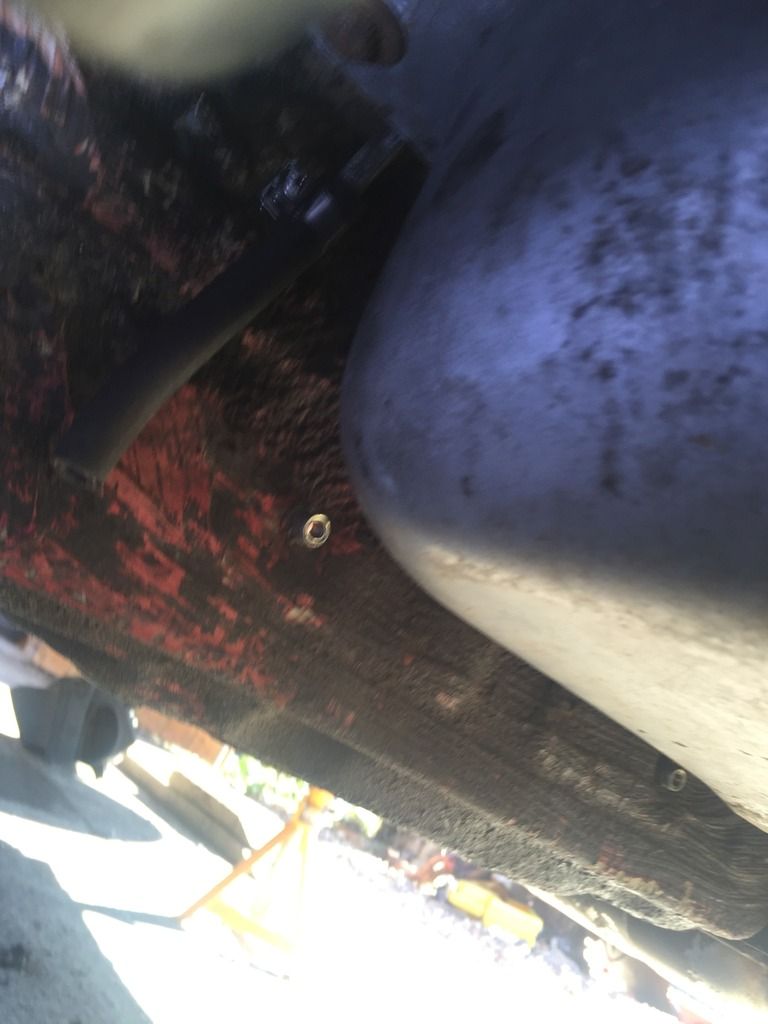

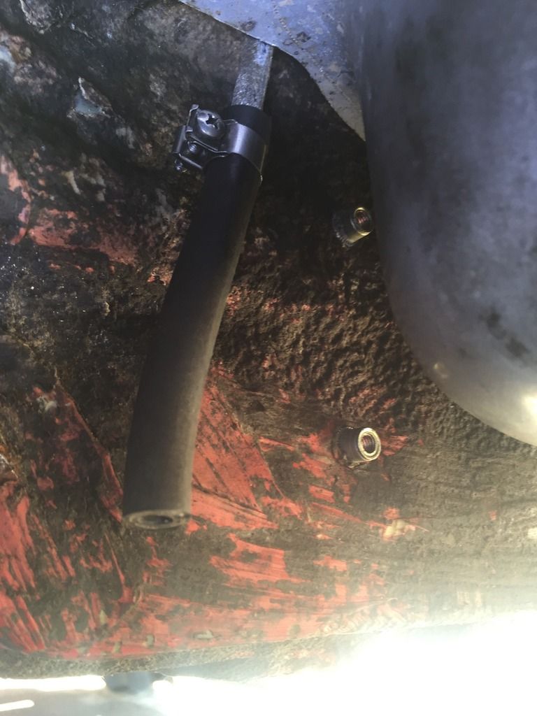

So I did some work on the car today, please could someone let me know if this is the correct way to do it?
I just cut the hardline and popped some fuel hose on the end of it.
It's lower than the left side of the tank (55l)
