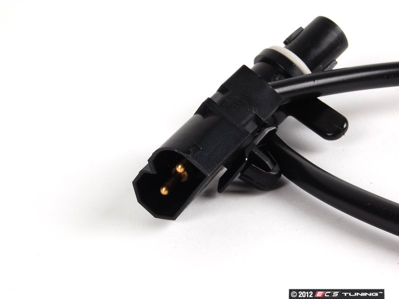

It's not the plugs I need Dan, it's the pins. The only source I can find would be the little headlight loom that feeds the front parking lights:

Yes I realise that, I was thinking of this type of thing - http://www.ebay.com/itm/BMW-1984-1999-E ... 566cbede45

Part 2 here - http://www.realoem.com/bmw/showparts.do ... g=61&fg=15

Yes! Them's the buggers! Cheers Dan.
