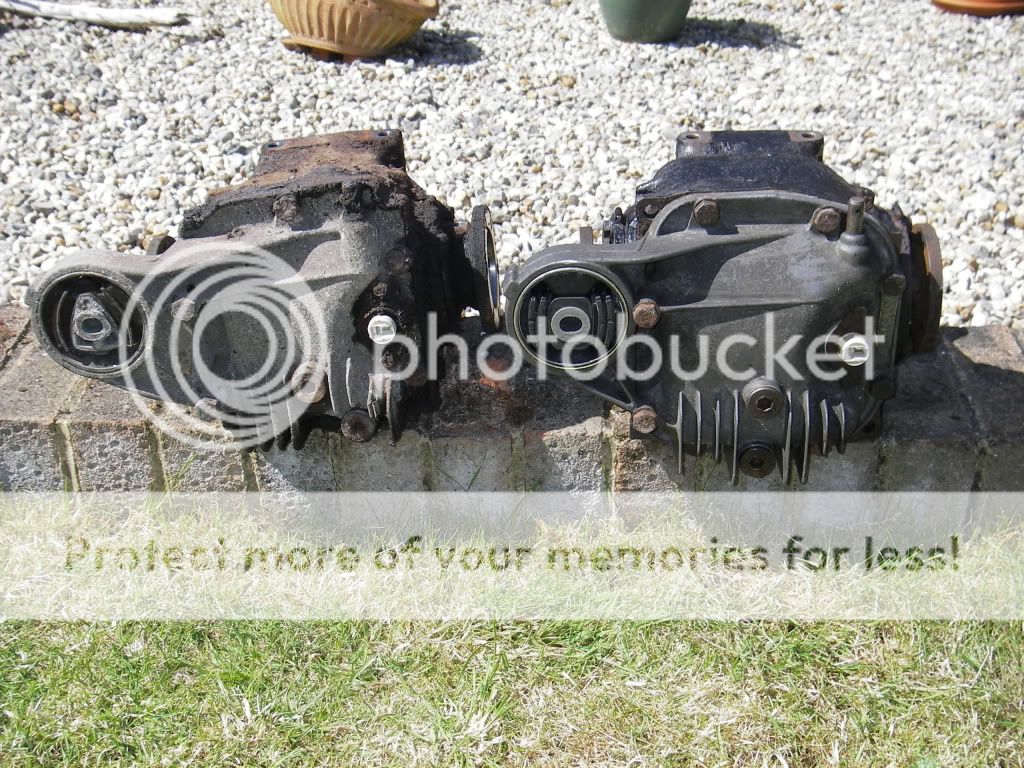

Other bushes at the rear are the trailing arm bushes, these rarely fail (worth a look though), there are also the top mounts (top of the shocks, see Alex's thread here for a pic: clicky) and the diff bush.
A well known upgrade is to use E46 cab rear top mounts and a Z3M diff bush, here's my old and new diffs, the new (cleaner) one has a new z3m bush.
