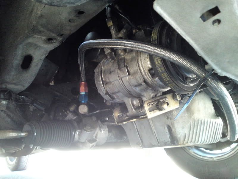

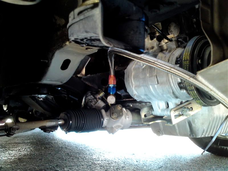

So i flushed the radiator today and all went pretty well. I emptied the radiator then put the flusher through the system, Drove it around with the heater on for a while then emptied the system again. Refilled with mineral water and drove around some more, emptied again. Finally filled with good coolent.
I found the 19mm plug on the block and it is damn near impossible to remove, I feared if I managed to get it undone I would not be able to do it up again. So I left it alone.
You can see the plug here I have the torch shinning on it.
Dirty under there
Oooh nice and clean now. 23 years of shit removed.
Why do I have a braided hose coming from the steering rack?
Mike
Dirty under there
Mike
