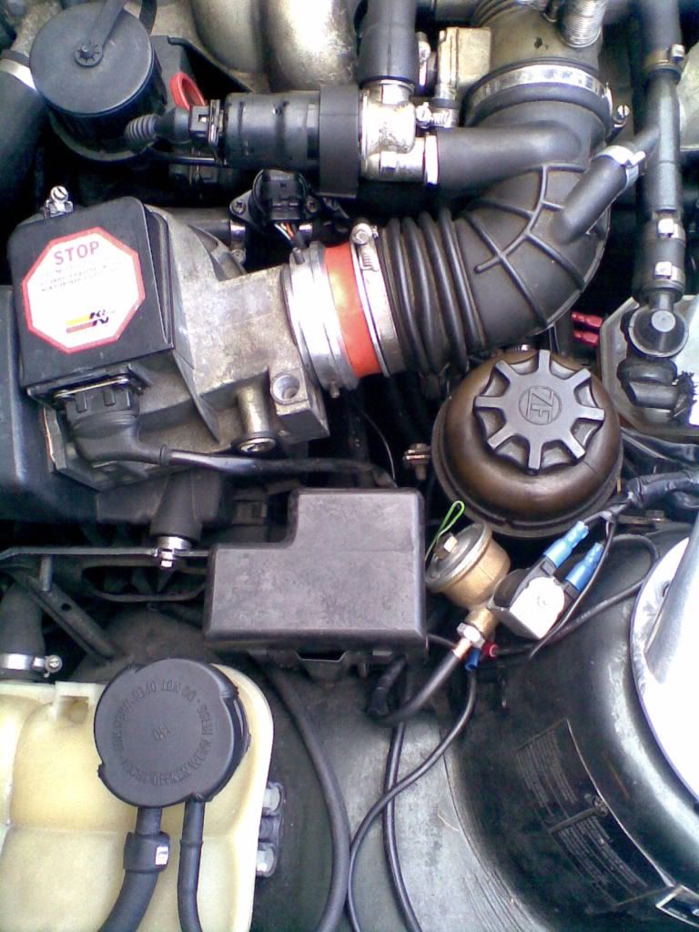

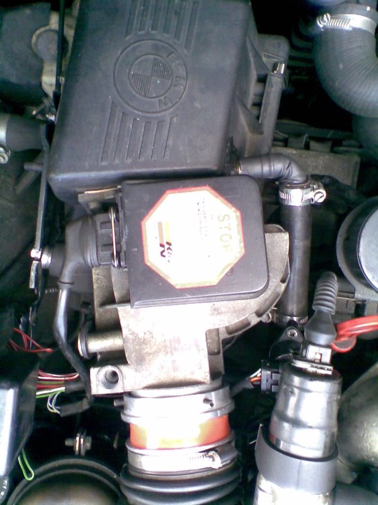

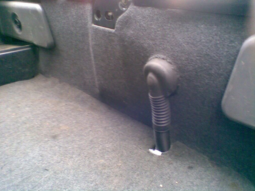

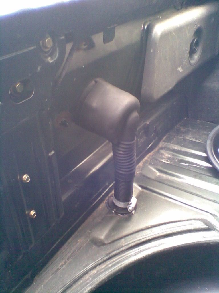

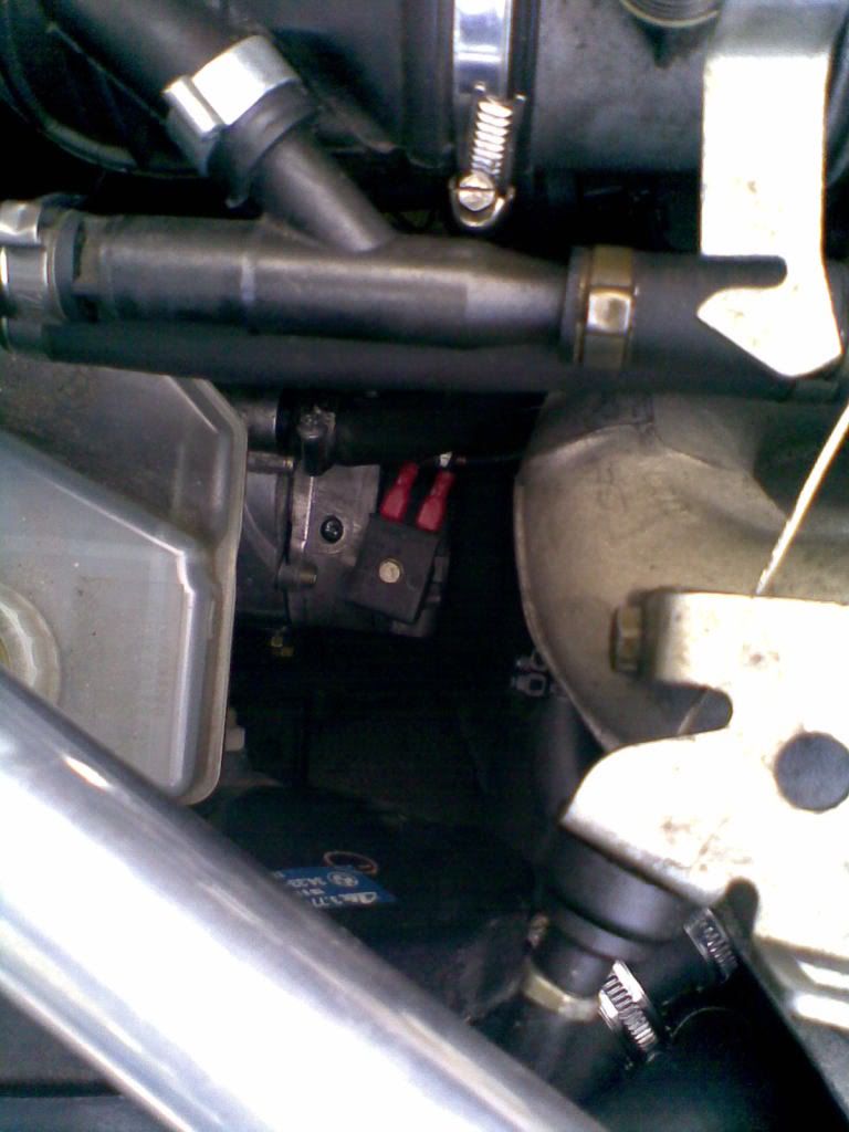

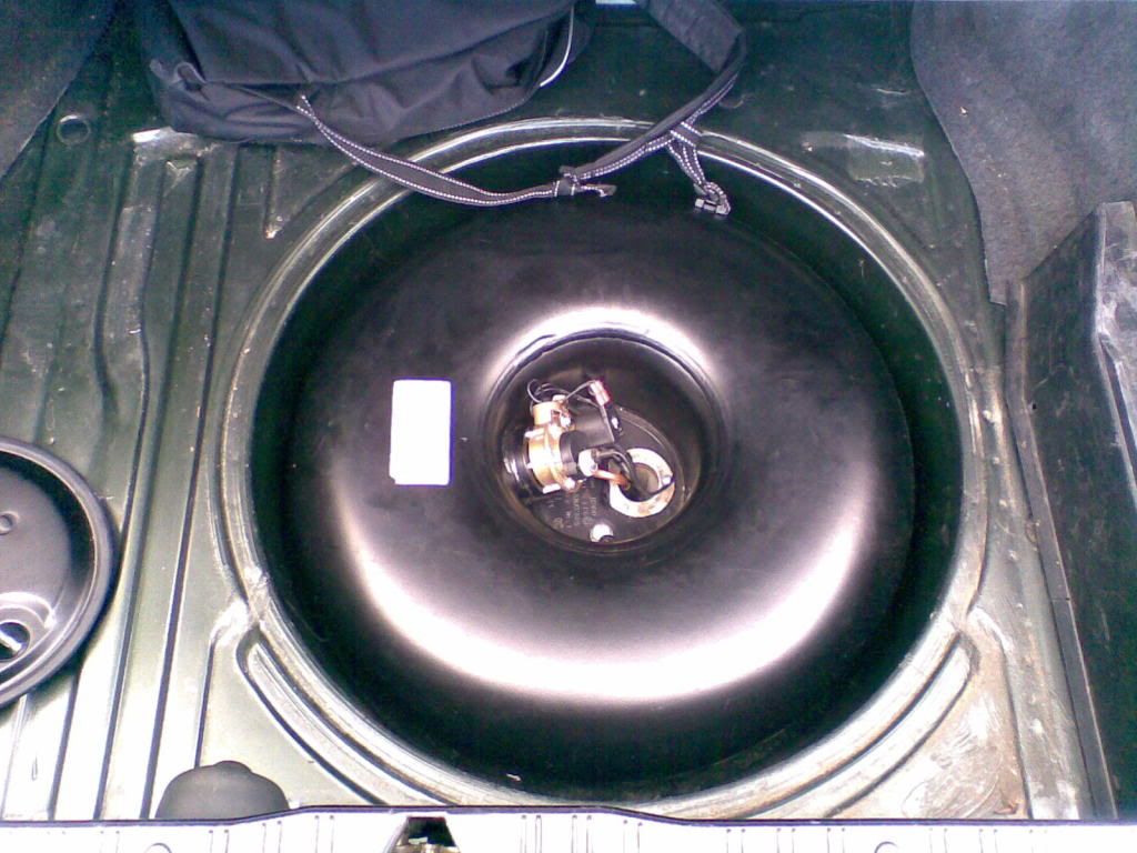

Still having trouble switching over, It only switches after driving about 2 miles and everything is warmed up. If I try switching any earlier, it just stalls and wont run. Any ideas?

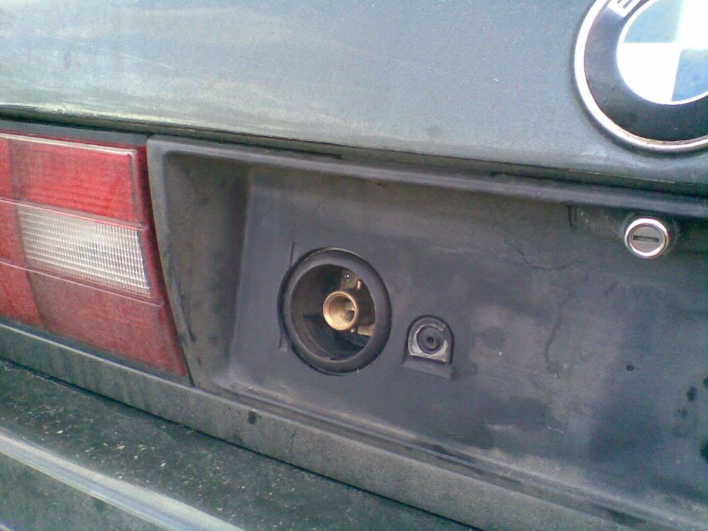

I thought I would share some photos of my install since I havent put any on yet.

I’m liking that filler, very stealthy 8)
Mine is just hanging below the bumper as it's a touring.
Just a thought, how have you plumbed in the coolant for the vaporiser? mine is in parallel with the heater matrix teed into both hoses which also makes a handy bleed point, it also means that for initial warm-up if I get any hesitation on gas I can try switching the heater to full cold so all the coolant flow in those pipes goes to the vaporiser.

Still havent thought of a proper way to have a quick release number plate. At the moment, it is on velcro which is working fine at the moment but im scared it will some day fall off!
The coolant is plumbed in parrallel with the heater matrix like yours and after running is very hot so I assume it is working well.

Maby a hinge at the top with a little bit of velcro at the bottom?

Thought about a hinge but there isnt really enough room for the numberplate to move and I want it flush with the back.
