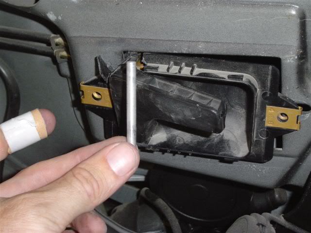

What a wicked weekend to have the roof down and drive around except if ur dad trys to take the roof down and brakes the handle in the rear of the car clean off, I mean he has pulled the handle off thinking it released the roof lid (muppet)
What I need to know is if the front door handles are the same as the rear release handle for the hatch lid but its just upside down???

51211926306 is the part no. r h door handle and also the flap handle $1o.83 according to realoem

mine has been broken since I got it
I enquired at the stealers if the door handles were the same
but they said no they were slightly different
but its only £4 ish for a new one

Its not just the handle its the hole unit he has pulled the handle so hard its pulled the metal bar int he handle clear out of the handle surround he is such a div,
I have a wire tie round it so i can release the hatch but it looks crap
I have had a look at the uni it looks the same as the door mech fingers crossed

when I got my replacement from the dealers
I got the handle and the surround it sits in
(mine has snapped at the top of the handle)
so should be a direct replacement
you can try a door handle if you wanna
would be good to know if it does fit
but if you need to get one from the dealers
its only cheap at less than a fiver

my handle broke, when i brought a door handle and took it apart they are different!! the roof handle has two cables attached one top and one bottom, but the door handles only have one!! so im trying to get one from a breakers.... one guy wanted £20!!!! what??... do i look stupid????
but think ive traked one down now tho!!
p.s. getting the rear handle out was a bi*ch!!! :mad:

Right after Dave's post and speaking to folower the bushes can attach to a normal door handle so if lee can come up wit the handle i can remove the bushes from the old unit result

Ali has come through with the door handle, im picking this up tonight and then im gonna take me old one to bits for the parts if needed.
Befor I go to Ali's im gonna look at fitting the ITG filter

Ali ur a star mate, Got the handle and Im gonna fit it tomorrow.

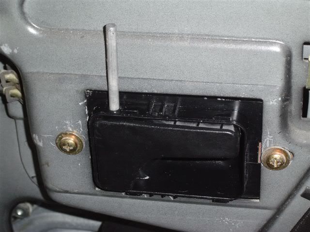

i changed the handle for a normal door handle after mine broke. i removed the pin and kept the actual handle part and changed the surround (as normally thats the part the breaks) the surround seems to be the same but obviously the handle is different due to the two cables attached.
i also figured out how to open the roof cover with a flat screwdriver, worth doing while the roof is open, just look how the mechanism works and do the same with a screwdriver

I start just that last night, Again removed the handle and put it onto the new unit form ali
Thanks for the pic's
