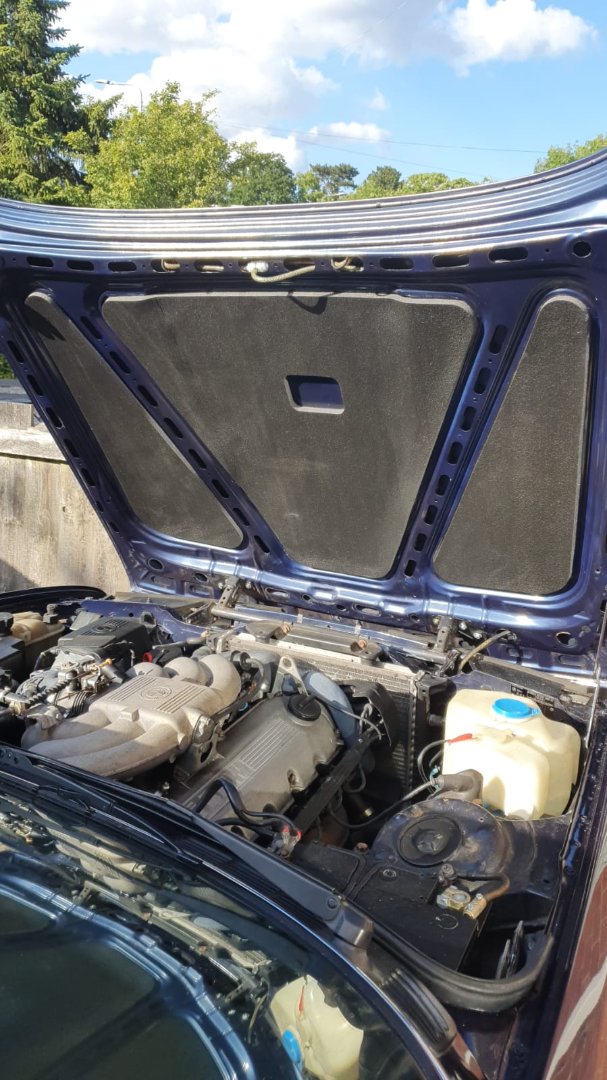

I've recently done mine and found isopropyl/isopropanol alcohol to work really well with a foam eater used to desolve expanding foam.
See midway and after photos. You can see the two side panels are back to painted metal.

Looks good
