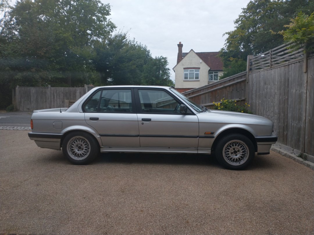

Just replaced my springs and shocks with Eibach Pro Kits and Bilstein B8s. The rear has dropped nicely and it rides really great but the front springs appear higher than before for some reason? Is this normal and they'll just take a bit of time to 'settle' or have I totally ballsed something up?

They do take a while to settle but the front does look very high! Springs have different rates for 4 or 6 pots, are you sure you have the correct ones?

I actually don't know but mine is a Straight 6 so if anything it should be too low if it was wrong?

Just had a thought that possibly the wishbone bush which attaches to the subframe could be pulling it down as I didn't adjust it. But that would mean that the twisting force of the bush would be enough to pull the entire strut down which doesn't seem right?

It is a long time since I put the Koni's on mine, but it did not do that. Any settling tends to be similar both ends.
Something wrong there but I'm scratching my head to think what.
Are the springs seated properly?
Were they new? if so what was the part number on the springs or box (not the order) A lot of BMW springs have the same diameter and would fit.

On the springs themselves it says BMW 07/05? I measured the height and it was 315mm at the front uncompressed?

Right.................. measured end of spring to end of spring it is around 278mm uncompressed
It does not say BMW 07/05 mine look like this:
These are genuine Eibach Pro from the Bilstein B12 kit that comes with B8 dampers. They are the correct springs for the heavier M20 865kg front axle load.
I would guess yours are not correct at 315mm and probably not Eibach unless it says so on them. Where did you get them from? Did you buy them new?

The front springs he has are 37mm longer than the springs he should have and that is what it looks like from the photograph.
