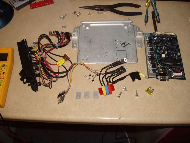

Well I've been outside in the glorious sunshine today for some more tinkering.
I've not yet got the laptop thing sorted but...

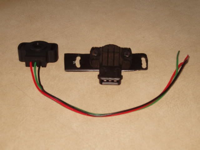

... I put the M50 TPS back on, changed the CPS and it started!
However, I believe this was purely coincedence, as it soon stopped again.
Then it started again, and I noticed that when it was idling that if I tapped the TPS just lightly (not whacking it!) the engine almost stalled.
So I re-wired in the RS Electronics TPS and it passed my highly scientific 'tap test'!
So, I ran the car round the block and....
... it stopped again!
When I got it back home again I noticed something else, if I gently tapped the MS unit with a finger whilst it was idling the engine almost cut out again.
So, could it be that I had a faulty TPS AND a bad connection in the MS..?
I'm going to have a play with the laptop now!
