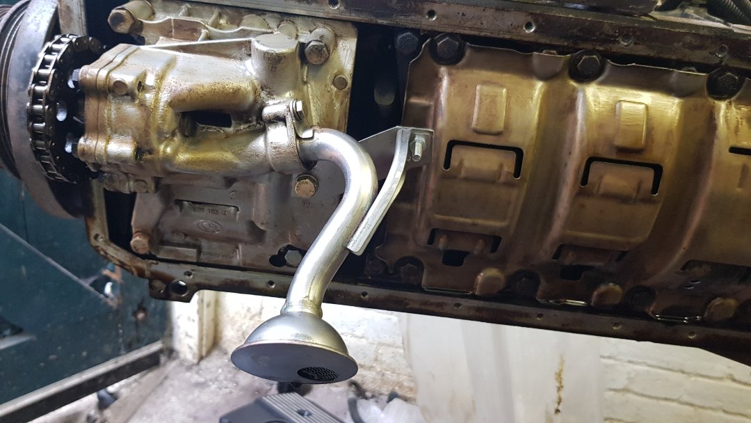

I'm one of those who is doing it now and while it's not finished yet I am a reasonable way through. The engine is in and the only remaining things I need to do are fit the exhaust, fit the radiator and sort out the writing.
I agree with pretty much all of the above, although I've gone a slightly different route with the transmission. My E30 had an M20 and decent LSD in it so it made sense to keep the existing drive train. I just did the usual M52 thing of taking a bit off the flywheel to get it to fit.
I also of course had to take account of the additional 10 or so degrees of rotation of the engine. I went for a Garagistic gearbox mount and dssr which they make specifically for this scenario. Both work fine although the gearbox mounts I'm using (E21 ones I believe) use larger bolts then the E30 ones so I had to open up the holes slightly to get them to fit. I also made up a custom gear lever mount from the E30 one and an E46 one, this puts the gear lever back to a more central location as it comes through the chassis
There is an oil pick up from the E32 728i that works, there are actually two variations of this pipe, part numbers 11417503261 and 11411432735. The one ending ...61 costs £108 and the other one £42, luckily I needed the £42 one but not before I had bought the other one! The information I read on the internet gave dates of production for which part would be required, but don't take too much notice of this as it's obviously not completely accurate. I managed to send the other part back which was good of BMW considering it was a special order from Germany.
I didn't take a photo of the two parts sides by side but one difference I did notice was that the oil pump on mine has a bolt holding the pipe right next to where the pipe enters the pump and therefore part 11411432735 was right for me, the other one doesn't have this fixing point. I also had to make up a bracket to fix the other bolt on the pipe into
I had to remove the baffle from the E34 sump as there's already one on the underside of the M54 block. The M54 baffle also has to have the old oil pipe mounting brackets removed.
There are a few other things but I'll put them in a separate post.
