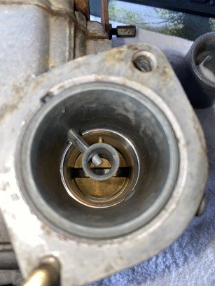

Carbs rebuild with bigger chokes and jets sized to suit and hopefully make some power and get up onto the 292 cam!

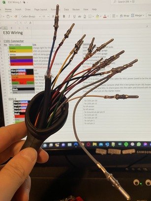

Engine rewired with all new wires and pins. Wiring includes megajolt EDIS-4 based ignition and wiring for additional VDO guages (quite proud of this)
