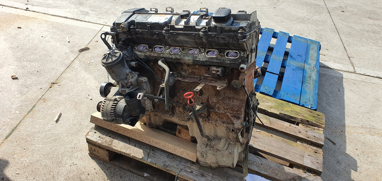

Engine out and later sold on ebay for ~£150. It ran fine and sounded good, with 73k Miles on it. My plan is to go M54B30 unless i can find a reasonably priced M52B28 (Doubtful).

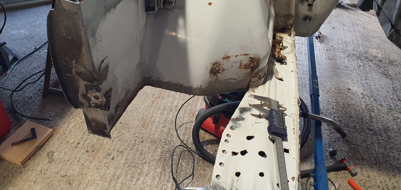

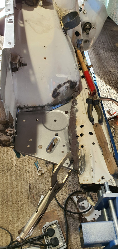

There was a lot of work cutting out small sections of Rust in the Wheel Wells and where they join the sills. The passenger side also had a large amount of the inner arch already replaced, which i needed to re-do.
The process of re-working the inner arches and lips was something that took me many many weekends, a lot of double measuring, checking fitment etc. A steep learning curve but rewarding, if i were to re-do them now, then i would probably make a slightly better job of it, i am however still pleased with the outcome i got. Its also worth mentioning that its pretty much impossible to find any Cabriolet specific Body panels, the replacement inner arch lips were advertised as Cabriolet, but when i received them it was pretty clear that they were Coupe or Touring, so i had to cut and modify these to fit.
Unfortunately i did not get many pictures of this process as it was time consuming enough as it was, there was a lot of corrosion in the Drivers Side Inner Wheel Arch from the fuel Pipe Cover, Vapour Tank mounting points etc.
Drivers side inner Arch & Lip done (Really sorry for the terrible pictures, just using what i have).

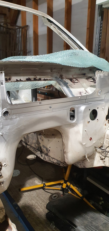

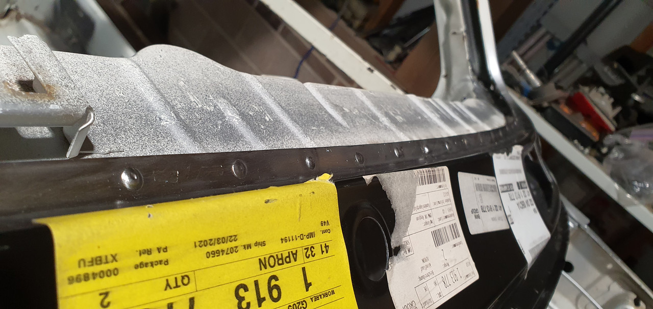

One of the unforeseen problems of doing an entire facelift conversion, was that the boot floor on a facelift must sit ~100mm Lower, because of this i had to create some extension pieces to bridge the gap. My welding has much improved since this.
I began dry fitting the Rear Quarters properly and doing final / more precise cuts on the body where they would meet.
This was quite a tedious process, especially on the end where the Quarter Panel meets with the doors, these (and most other joints) are braised from factory and it took a long time to remove the braise and tidy the joint enough so that it could be welded without contamination.
Once i was happy i removed the rear panel and dry assembled the rear end with the boot and also the roof cover / hatch so check all the gaps. An old guy across the road gave me a tip of using self tapping screws to lock in the panels in places, this gave you a fixed position to go back to and also really helped hold the panels in place. The Panels surprisingly did not need much tweaking, though i was disappointed with the quality of the rear panel from Schmiedmann, some of its contours did not match the OEM Rear Quarters particularly well around the rear lights and will require some work with filler to make it look perfect.
I then spent a LOT of weekends, triple checking everything, doing small bits of work i thought was easier with the panels off, before finally taking the plunge and welding the panels on - i did not braze them like from factory, i did seek advice on this and although it is not the original way of doing it, was told the risk of cracks etc were very low.

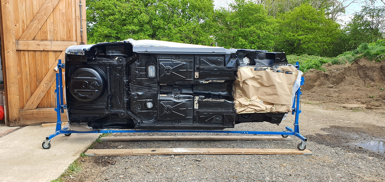

Now that i had the Rear End back on, i wanted to get the car on a Rotisserie i bought what felt like a very very long time ago. This was from a company called Ade Foreman Light engineering, its the heaviest duty one he offers on wheels rated for ~1300kg. I braced the door shuts, boot, and front where the crossmember would have been.
Mounted using the Bumper / Rail Positions:
Pretty happy with the Jig, from memory it was ~£375 delivered, it has some flex when moving it around or doing pretty hard work on the car, but worth its weight in gold.

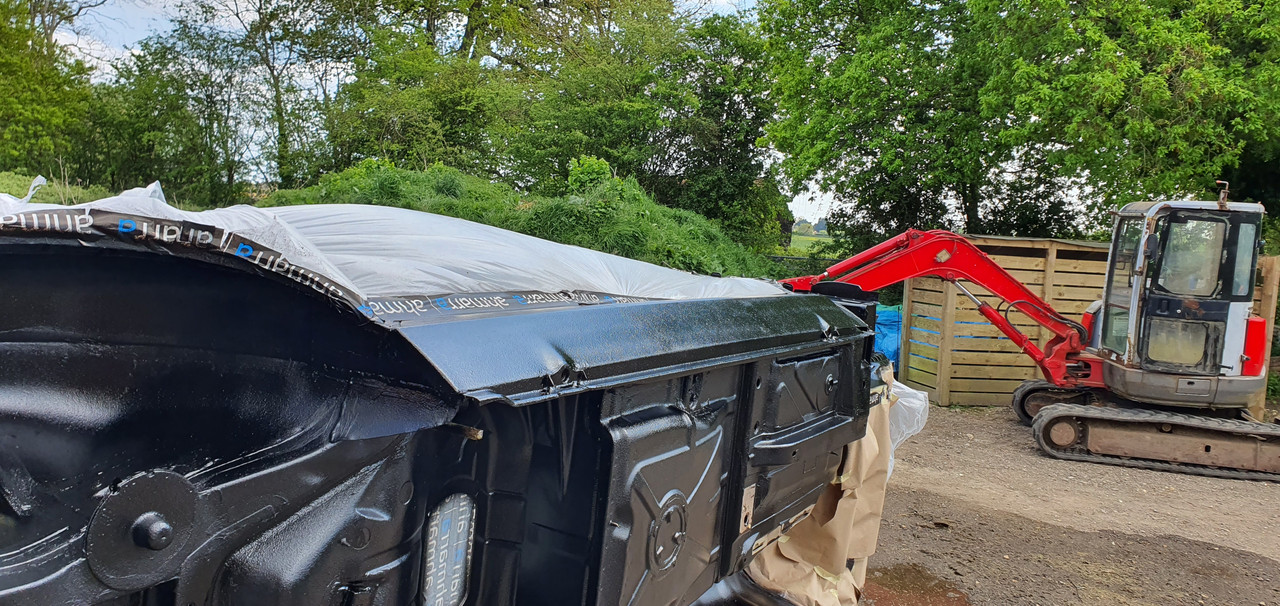

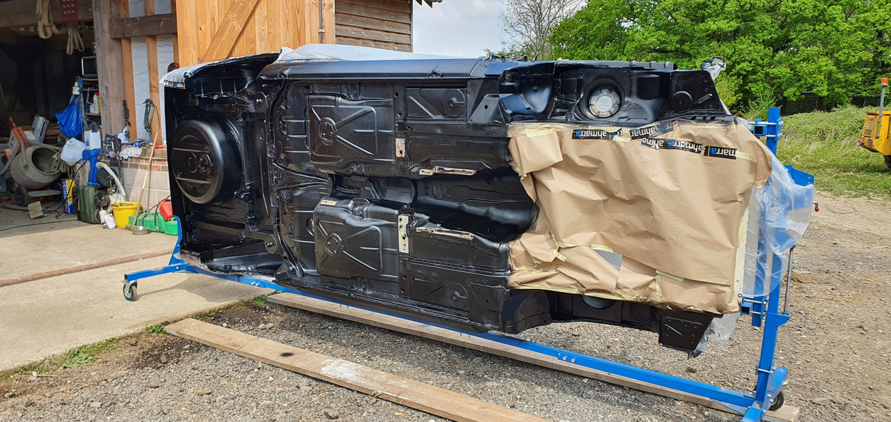

I then wheeled the car out to the doors and used our Karcher Steam Wash to totally remove any remaining Mice leftovers, and also strip of as much wax oil and other shit from the bottom of the car / engine bay as i could:
End Result:

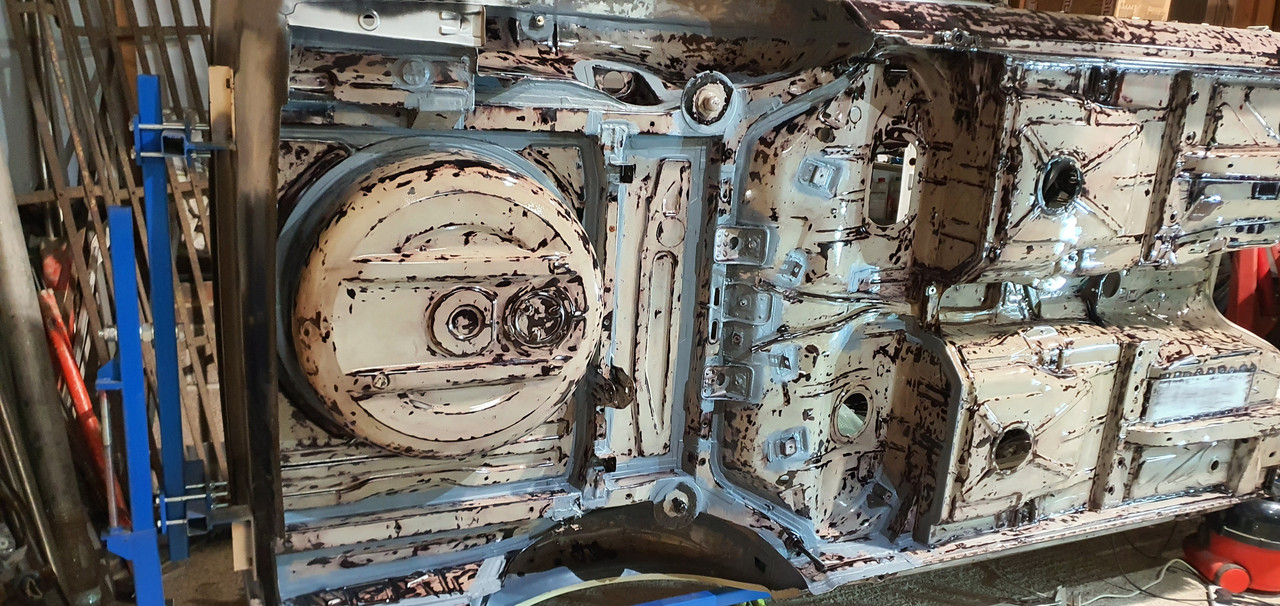

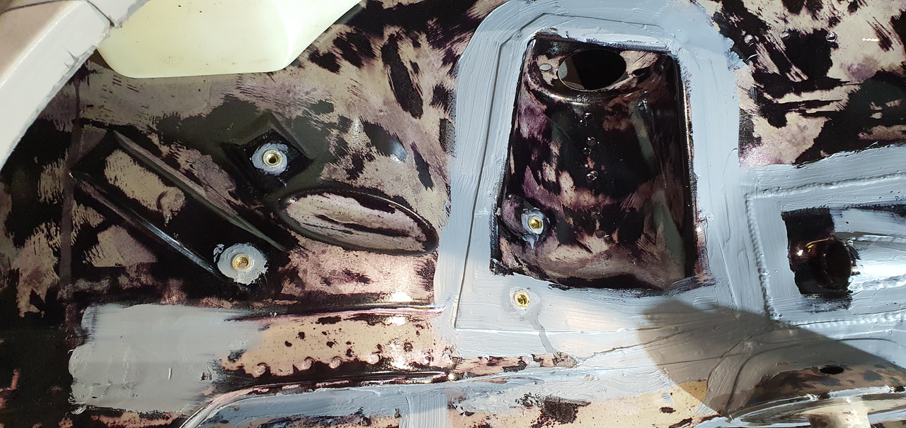

Now was the time to start the tedious process of removing all of the underseal, i got about 90% done in one day with a an angle grinder and large wire wheel, it then took about another day or two to remove all of the underseal from all the tight corners / areas. Originally i was not going to remove all of the underseal, however i am glad i did as it revealed many many places of corrosion that had not yet visibly come through the sealer. Some of these places had originated from inside the car where i can only assume heavy amounts of Mice Pee were and started corroding.
The worst areas of rust on the underside were:
- Rear Seat / Seatbelt Brackets.
- Rear Tank Brackets.
- Rear Brake Line Mounts.
- Tube that carries Fuel Tank hoses from Filler Cap.
- Passenger footwell areas.
- Drivers footwell areas (both footwells were bad behind where the sliding nuts are for the gearbox).
- Drivers side Footwell / Jacking Point / Front Arch Area where all 3 panels meet.
These were the areas i deemed necessary of cutting out and replacing, the rest was only surface rust and i concluded it was acceptable to let Dinnitrol RC900 deal with it. Pictures in no particular order of Rust Repairs to the bottom (Yes i know my welding does not look particularly great / perfectly penetrated):

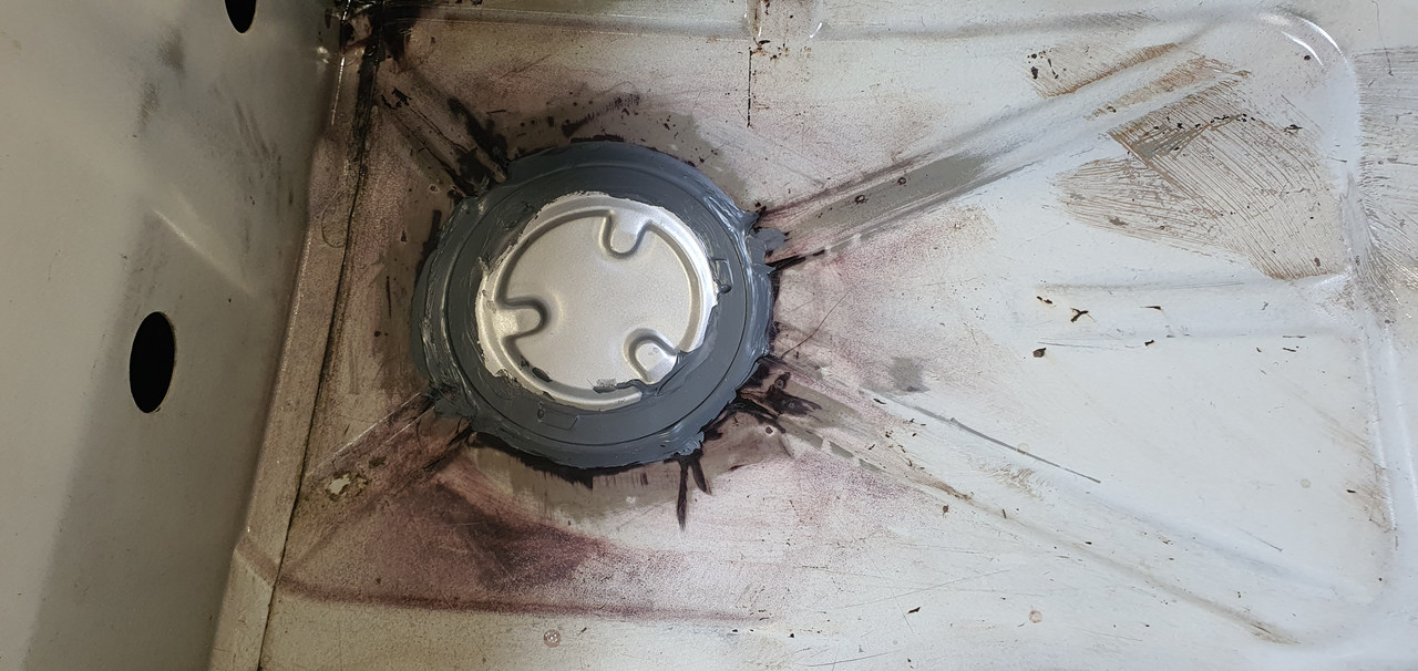

Checking Fuel Tank Mount Positions:

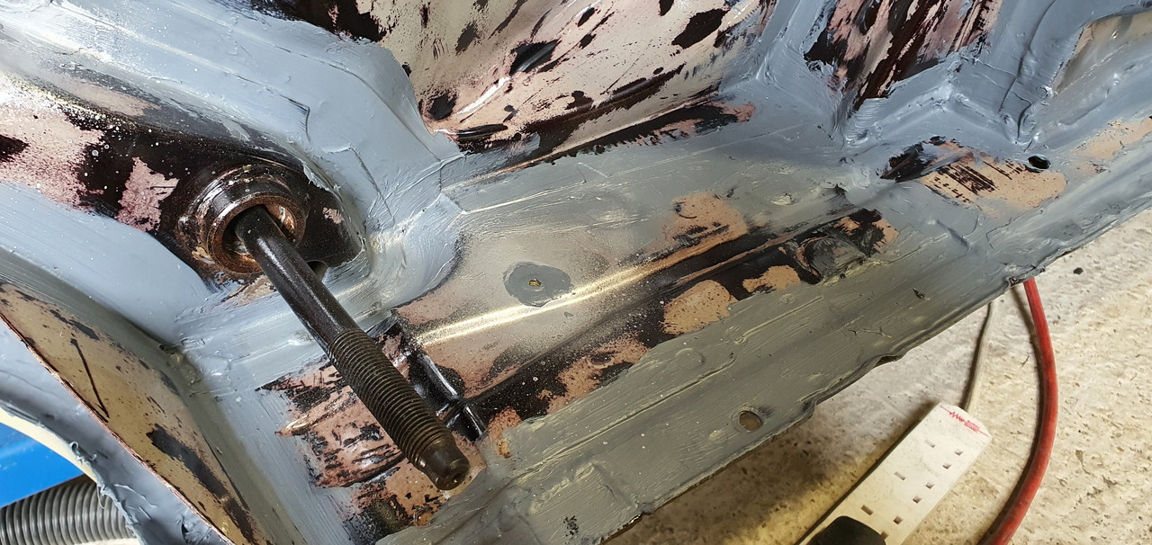

Various other bits were done and then i spent a long long time prepping the bottom to do a first coat of Dinitrol RC900, i first saw this product being used by Driftworks on their V10 E46 M3 restoration, i thought it looked really good and decided it was a good product to use in this situation.
This was only done last weekend, and i need to do another coat, it seems to have penetrated extremely well. Slightly counter intuitive to spray on, it doesnt feel right as visually it appears to be clear coat.

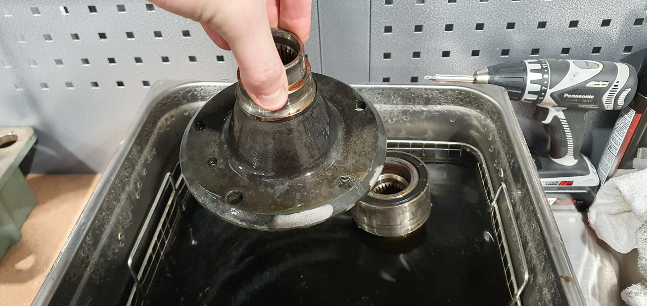

I managed to get a cheap set of E36 M3 Evo Hubs and LCA's, i also picked up a cheap Compact Rear beam, i began tearing these down and shot blasting them ready for new bearings & bushes. As of yet i am undecided on what brake setup to go with, i had done some light reading on it and though maybe i could use E46 330 brakes? Any advice on that would be great.
I had also held off buying Balljoints for the Front Arms, i had read online about people using E30 ones instead of E36? What is the reasoning for this? Does anyone have part numbers for ones which can be used? Also which offset bushes i need for the LCA Mounts.

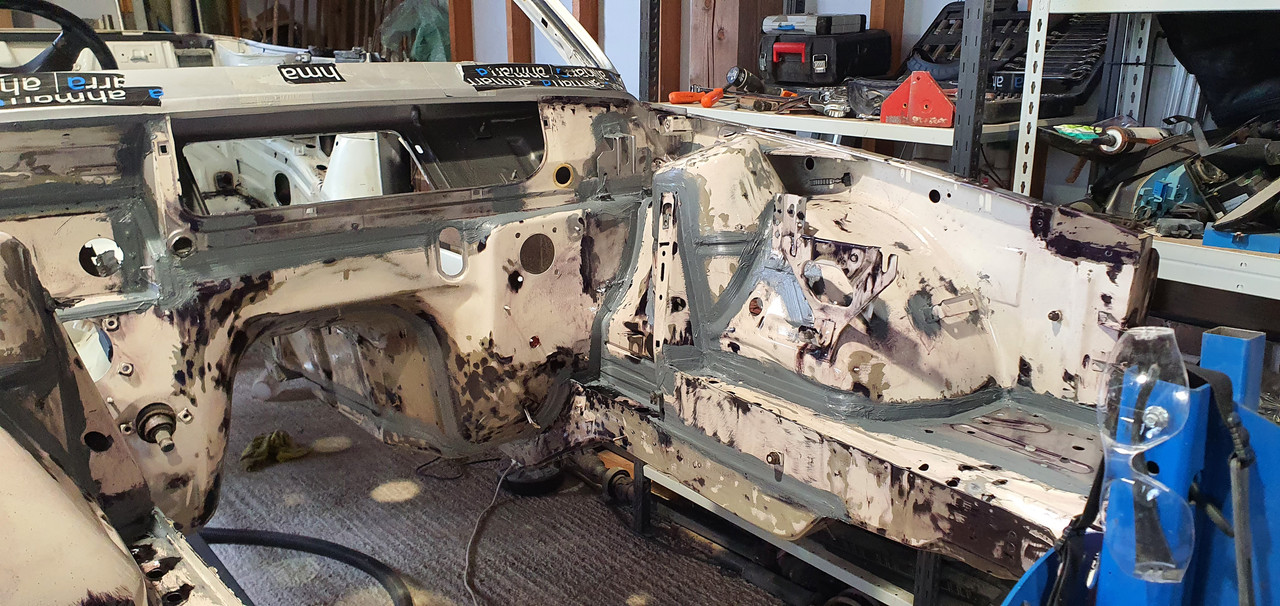

Got a second coat of RC900 on at the weekend, dont think ill do anymore as it looks to have covered nicely:

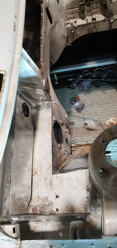

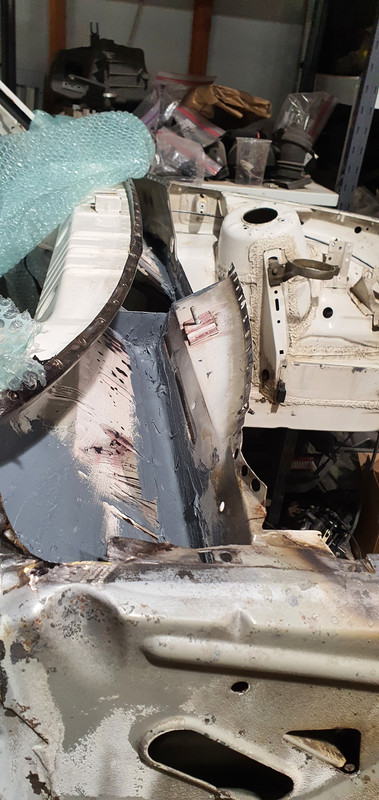

Then stripped the Drivers front Wheel Well, i repaired that hole in the bulkhead, forgot to take pictures of it after:
I cut back the front batter tray as it was completely rotten, im moving the battery to the boot so will tidy this up and seal it before painting the engine bay:
I then started to look at the rot around the Scuttle Drain, upon first glance it didnt look too bad, but it is quite severe, also most of the void behind the scuttle has rust to some extent, i begun to strip it but ran out of time, a job for next weekend:

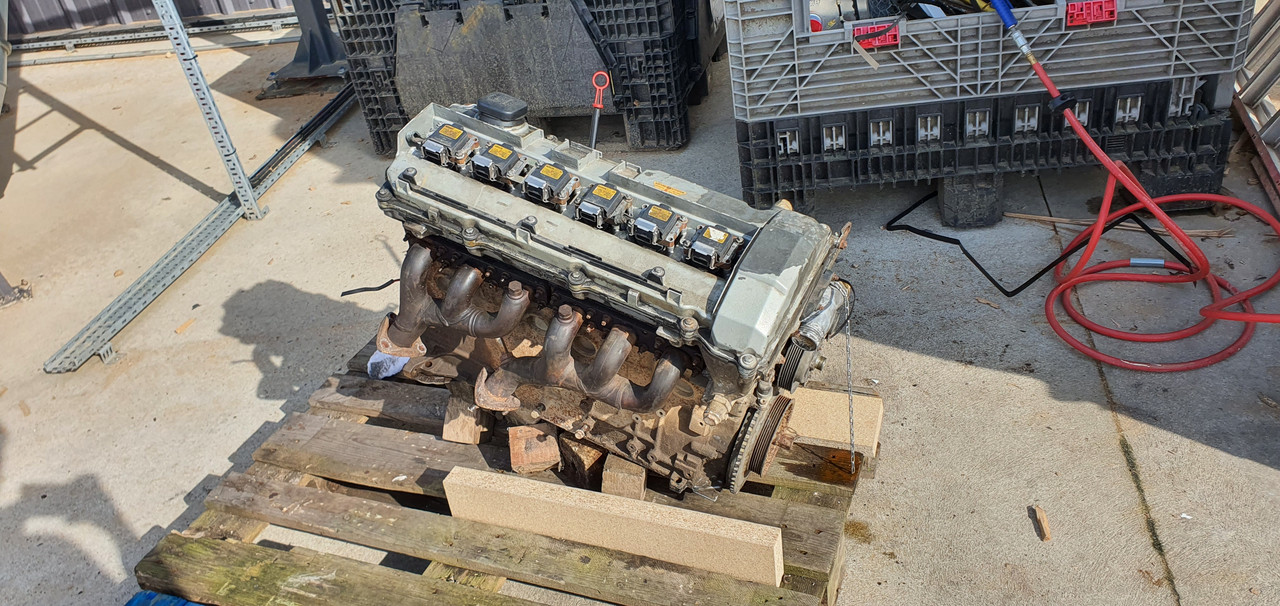

I also managed to find an M50B25 from an E34 which i should be paying for this week, just waiting on a video of it running and some more details first.

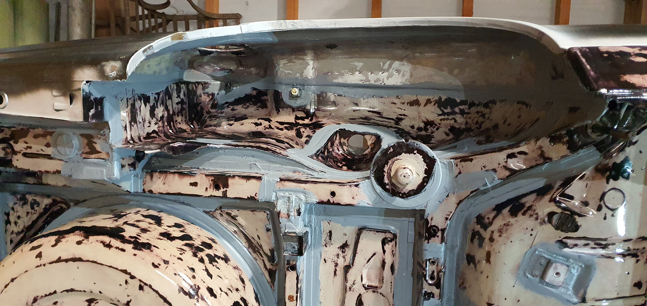

First of all the corrosion under the scuttle panel was pretty bad as mentioned, although i'm not 100% happy with the work i did under there, i'm happy the corrosion wont return, quite simply without de-constructing the car in the reverse order to how it was constructed, its very difficult to replace every piece of corrosion with fresh metal. Cleaning, treating and sealing the corrosion still takes a very long time but you kind of feel like its a bodge at the end of it.
I left it last weekend with a large amount of Seam Sealer curing, i've tried top layer it up so any water naturally drains towards the drain holes. I now need to paint the inside of this area before re-fitting the new Scuttle Panel.
Whilst waiting for the Seam Sealer to dry i tackled the Front Arch Inner Lips & Engine Bay Corners. Panels from Valcas and were a great fit as per usual.

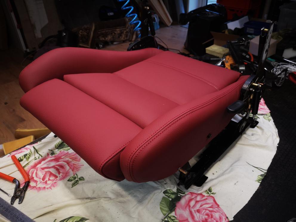

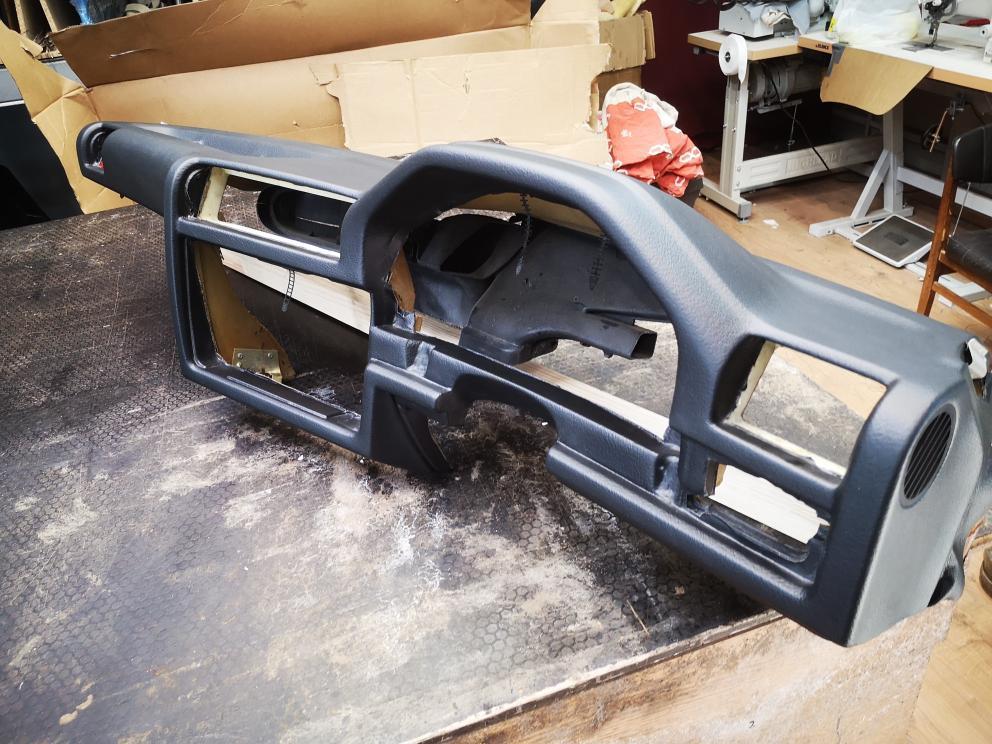

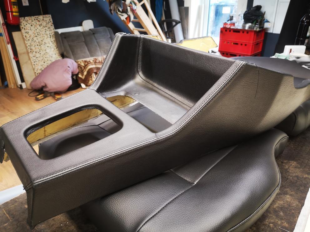

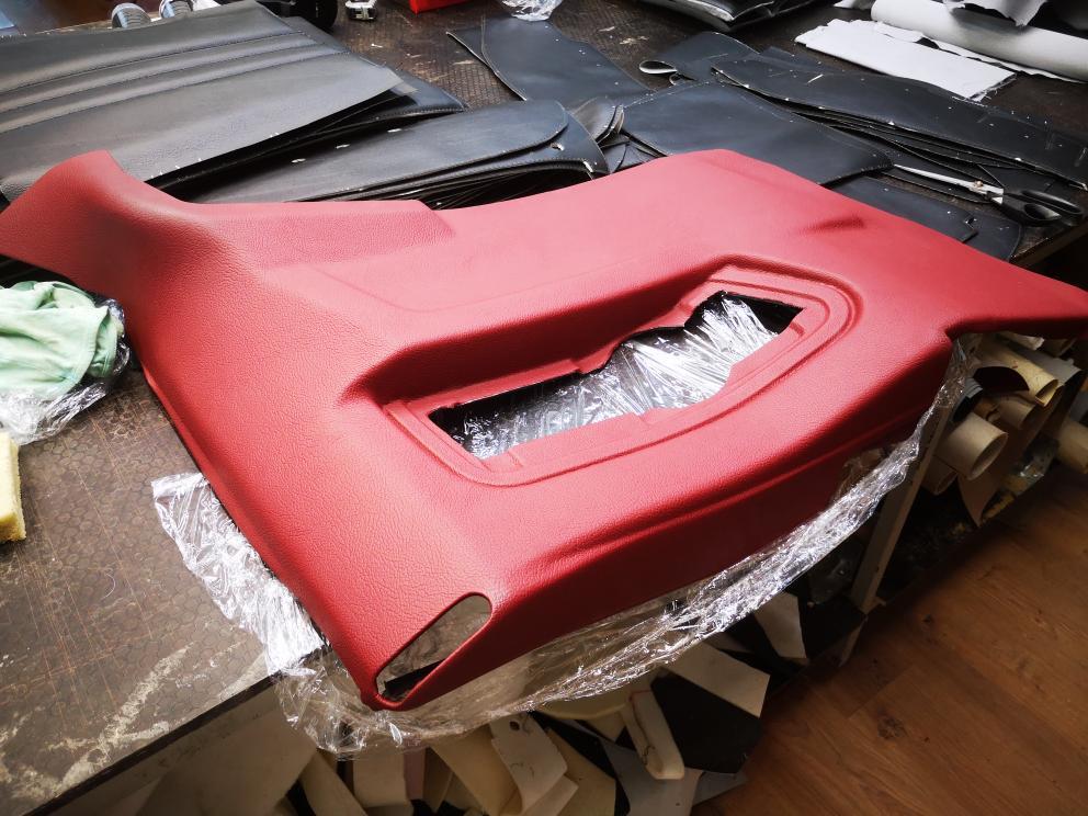

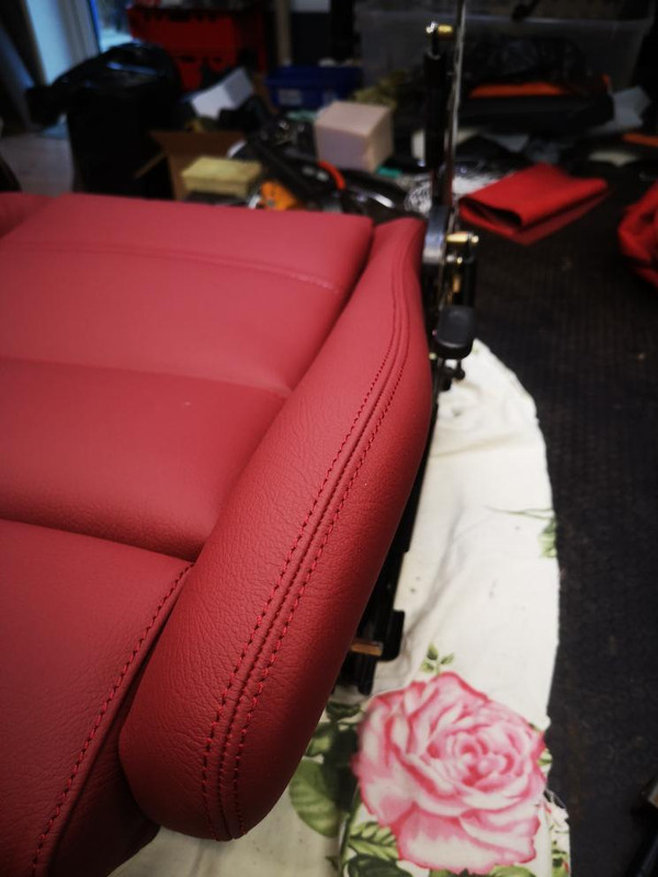

Also wrapped the interior and this is now with RESTAAuto in Lithuania. Hopefully get this back at some point soon but i'm of course in no rush, the longer it sits around the greater the chance it gets damaged. The seats will be
Red Nappa Leather, all the Door Cards & Rear Panels Matching Red Vinyl. All the front of the interior is being Re-done in Stitched Black Vinyl. Price will be in the region of ~2500 Euros, Plus £250 Delivery each way.

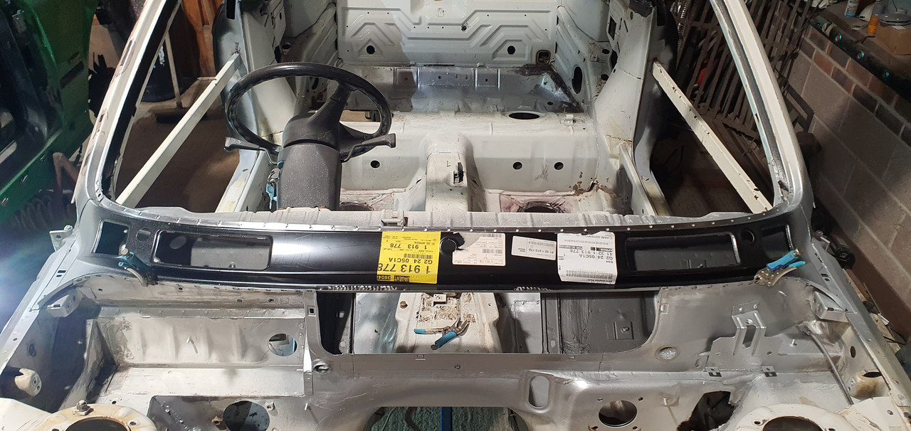

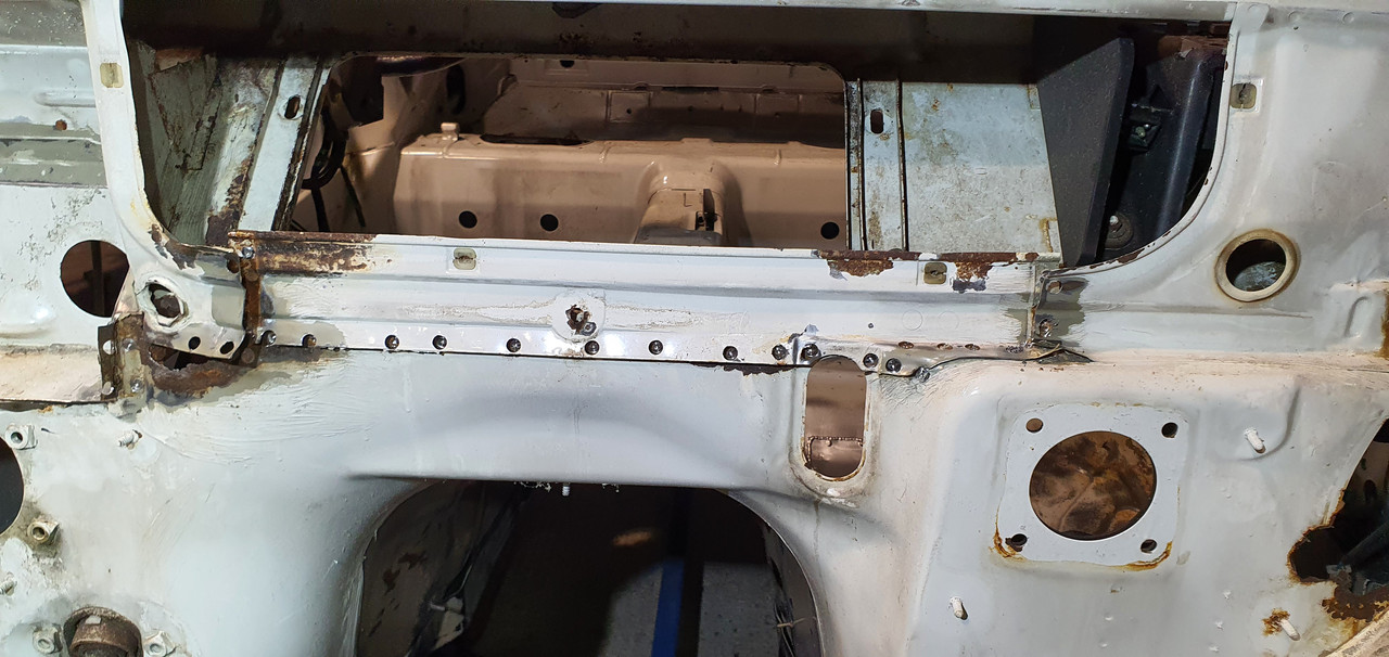

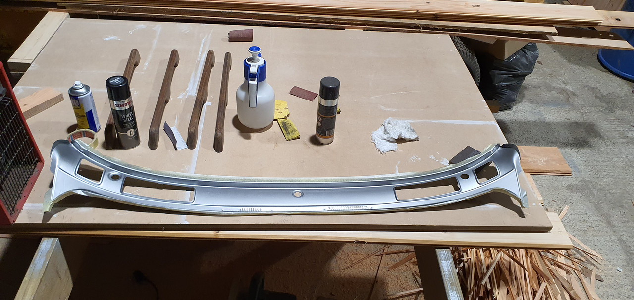

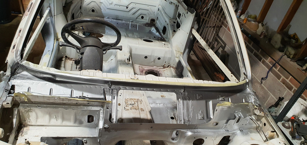

I've not had much chance to work on the car lately, been pretty manic at the weekends, going to try start working on it in the evenings as the days get longer.
Painted inside the scuttle panel area, and the back of the scuttle panel:
Mocked up and clamped the scuttle panel:
Welded in place:

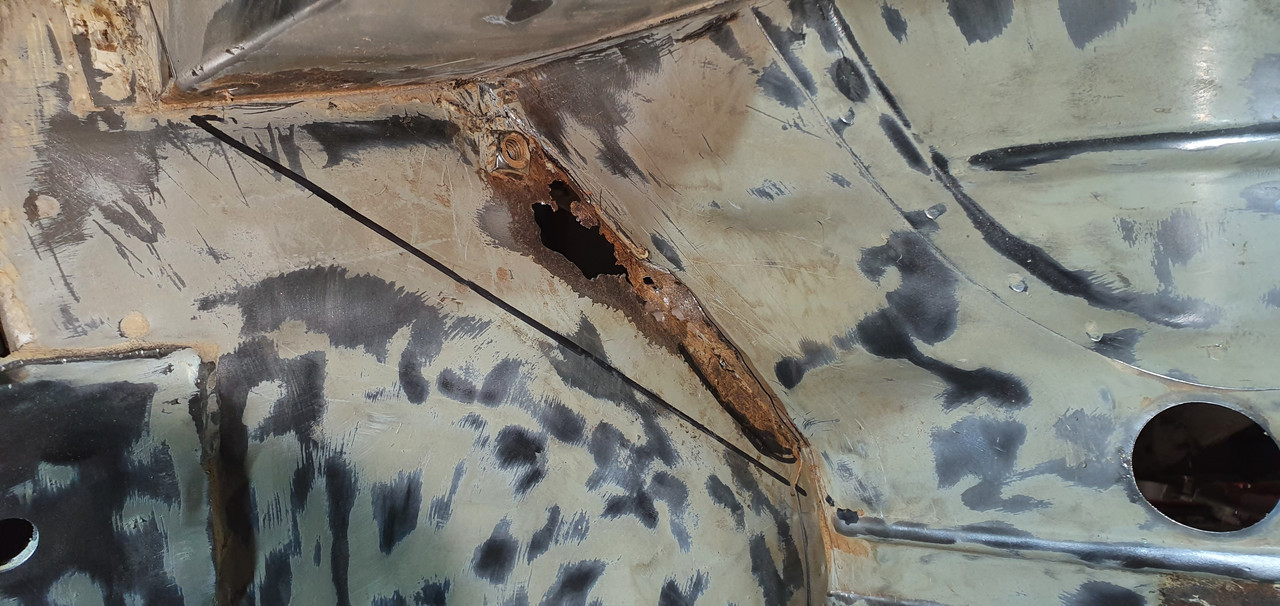

I also corrected a bit of rust on the hole where the passenger door loom plug sits, it was fairly tedious / an odd shape and i forgot to take pictures of it, but with that done it marks the end of the cutting & welding on the car - i only need to re-fit the front crossmember / radiator support when i get the car off the jig, this will be getting bolted anyway.

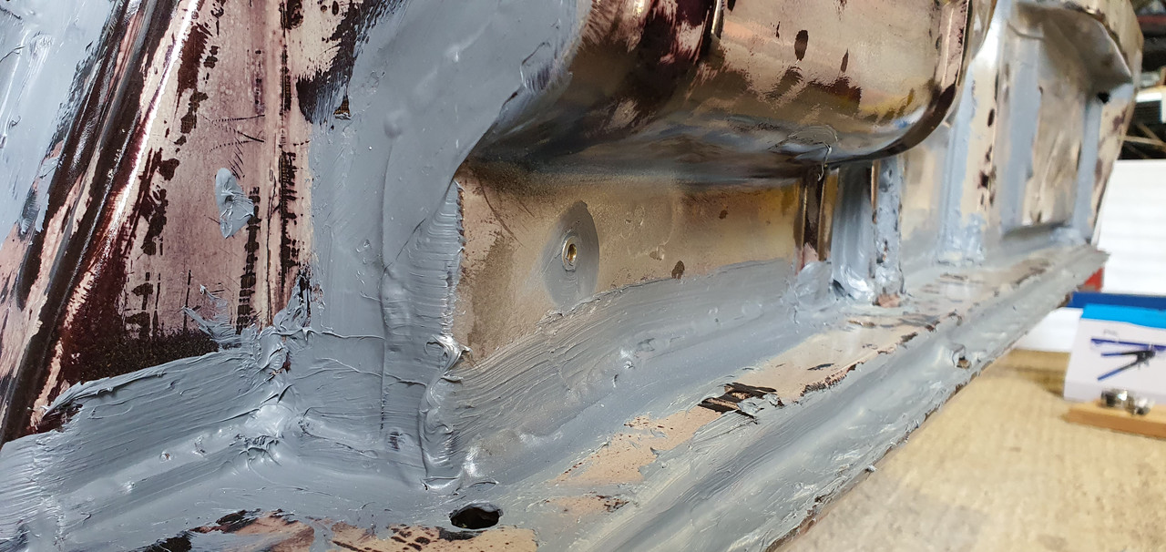

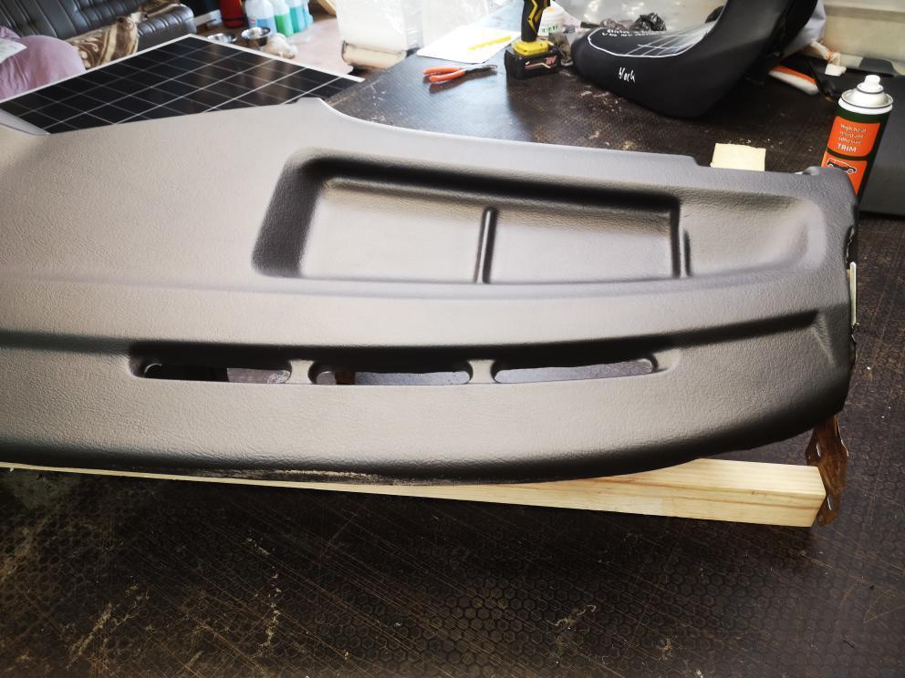

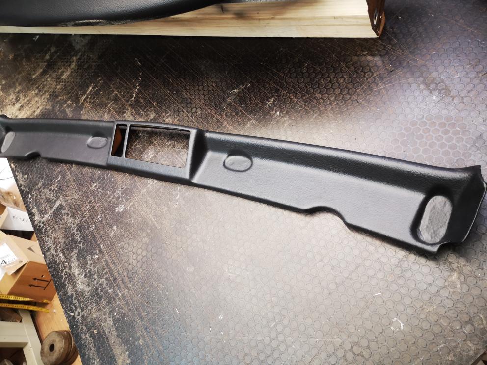

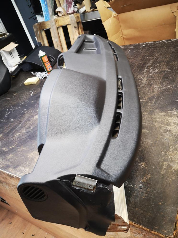

I started seam sealing the underside, ended up using much more than anticipated, i think partly due to filling the rear arch lips completely with sealer to stop dirt sitting in there, i need to go back over it all again for a second coat as it looks to dry quite think (Dinitrol Brand).

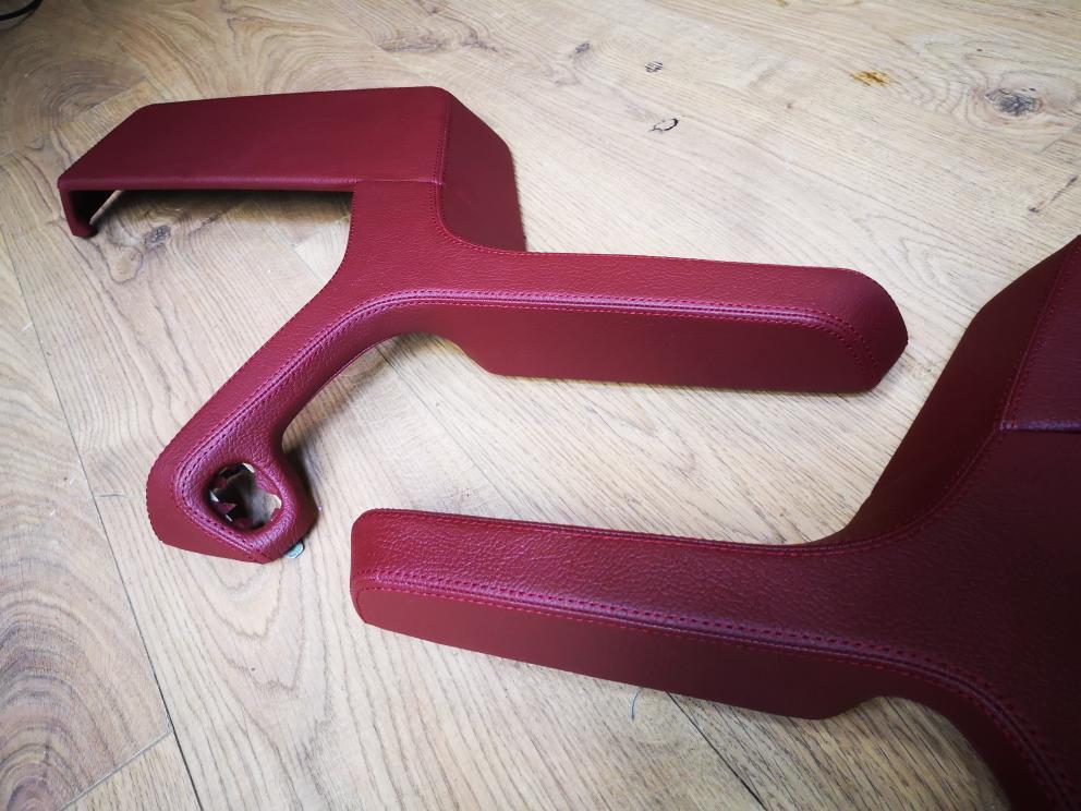

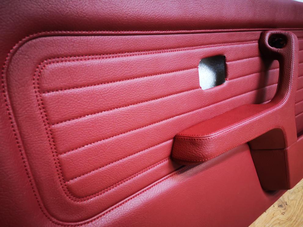

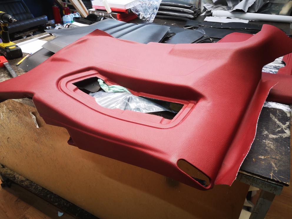

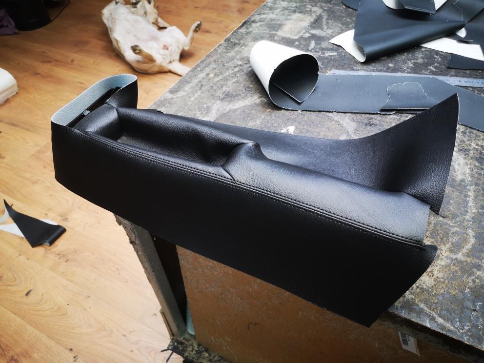

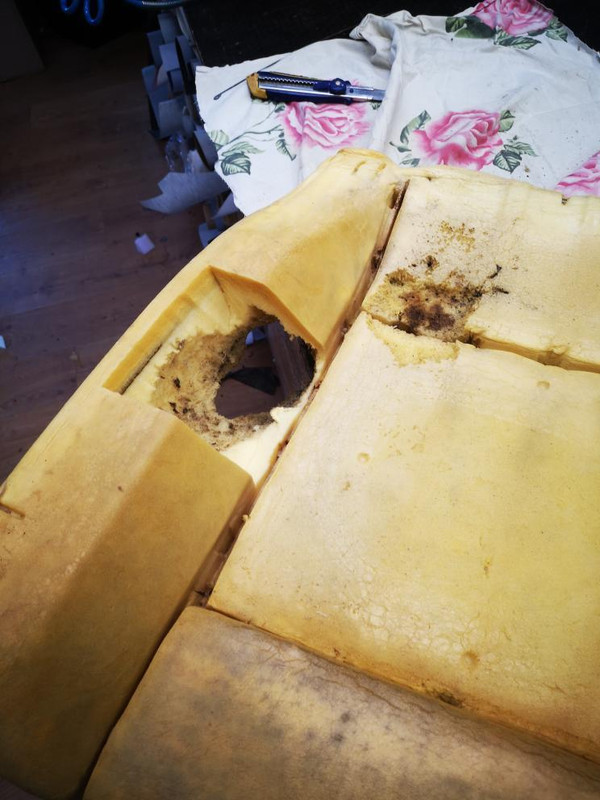

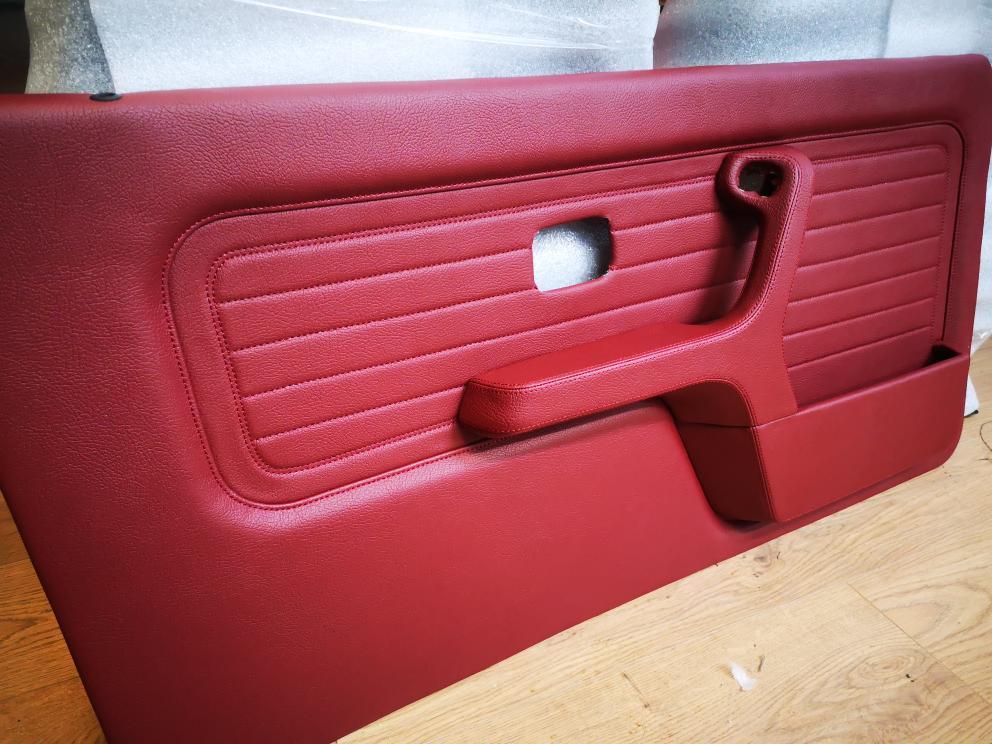

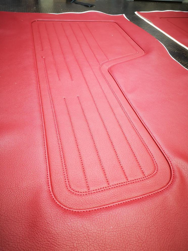

RESTAAuto has also started on my interior, i asked him to send me lots of pictures, which he has been doing. He found a very good match in nappa leather to match the Red Vinyl he typically uses, though this wont arrive to him for 3 - 4 weeks yet. The door cards are done in Vinyl, i think they look very good personally. I was weary how well the same material would last on seats, hence going for leather instead. Very impressed with them so far, great communication and look to be doing a very good job.
Im going to collect my M50b25 this weekend, its from an E34 so has the correct sump etc. I have a build worked out (copying a friends), it will end up being built as an M50b30 Turbo, his has done a drift season @ just over 550bhp so it should be good for a road / occasional track car.

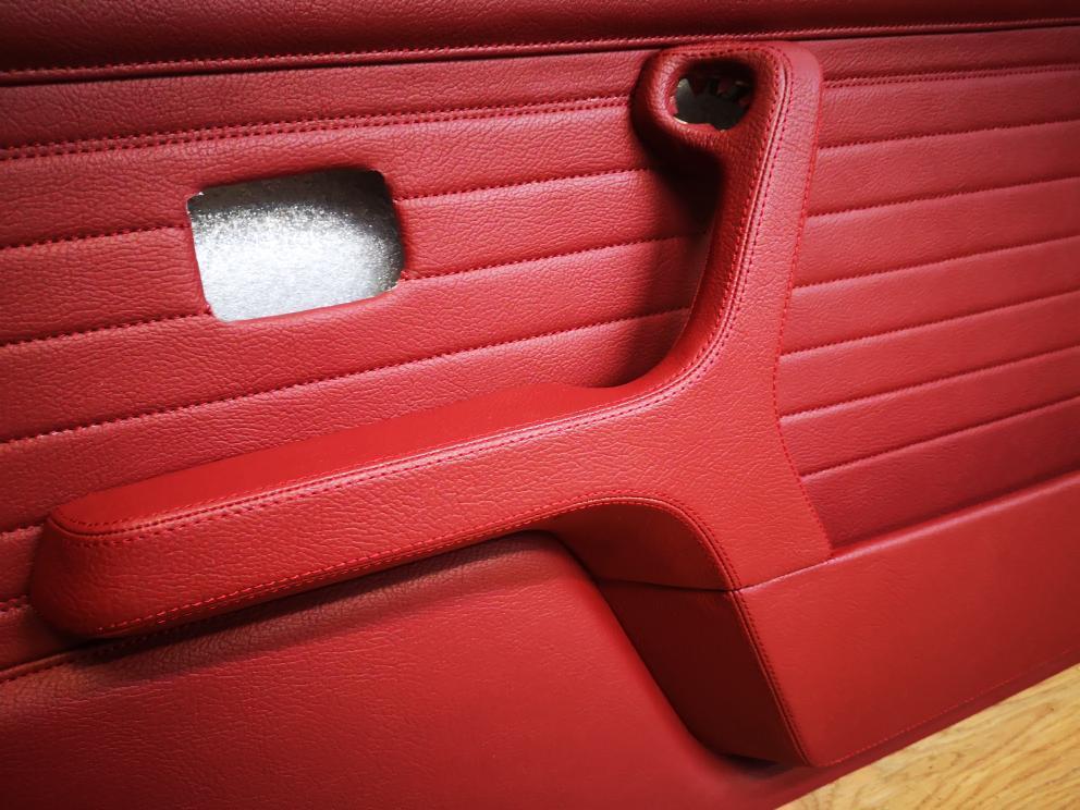

Those door cards look superb.

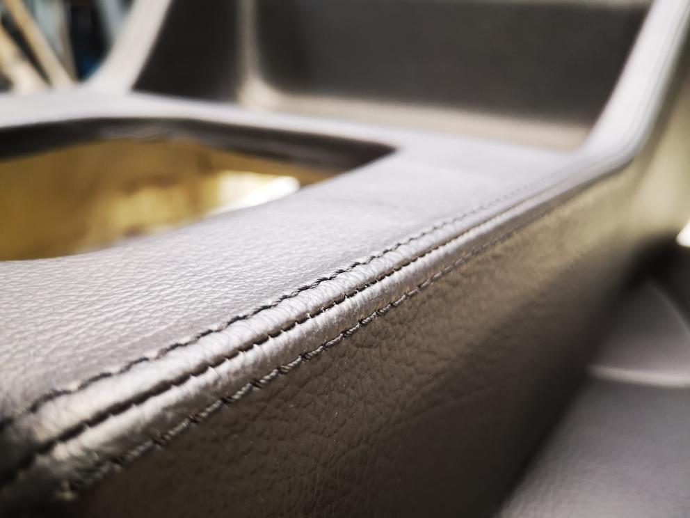

Yeah i think so too, The rears will be done the same, Seats in matching Nappa Leather. Dashboard, pillar trims, center console etc will all be done in the same type of vinyl but black, cant wait to get it back, have to try store it somewhere where it wont get marked.

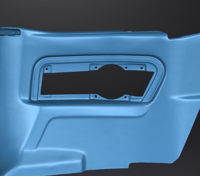

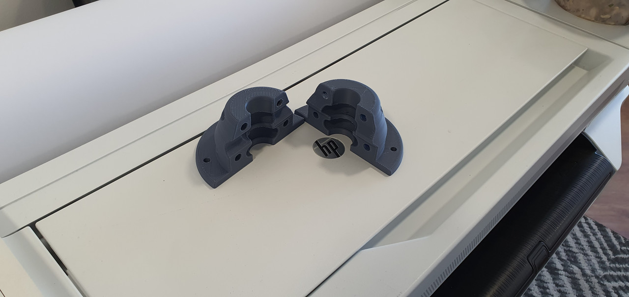

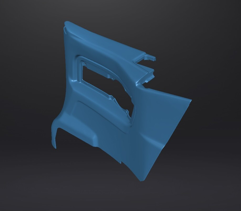

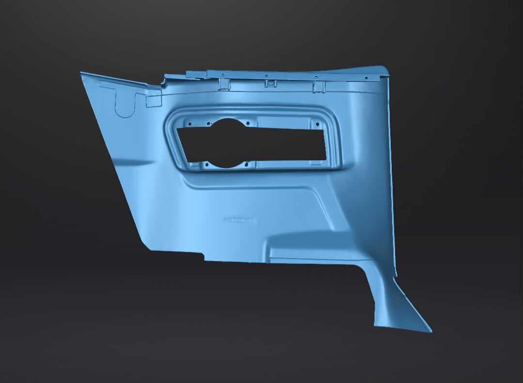

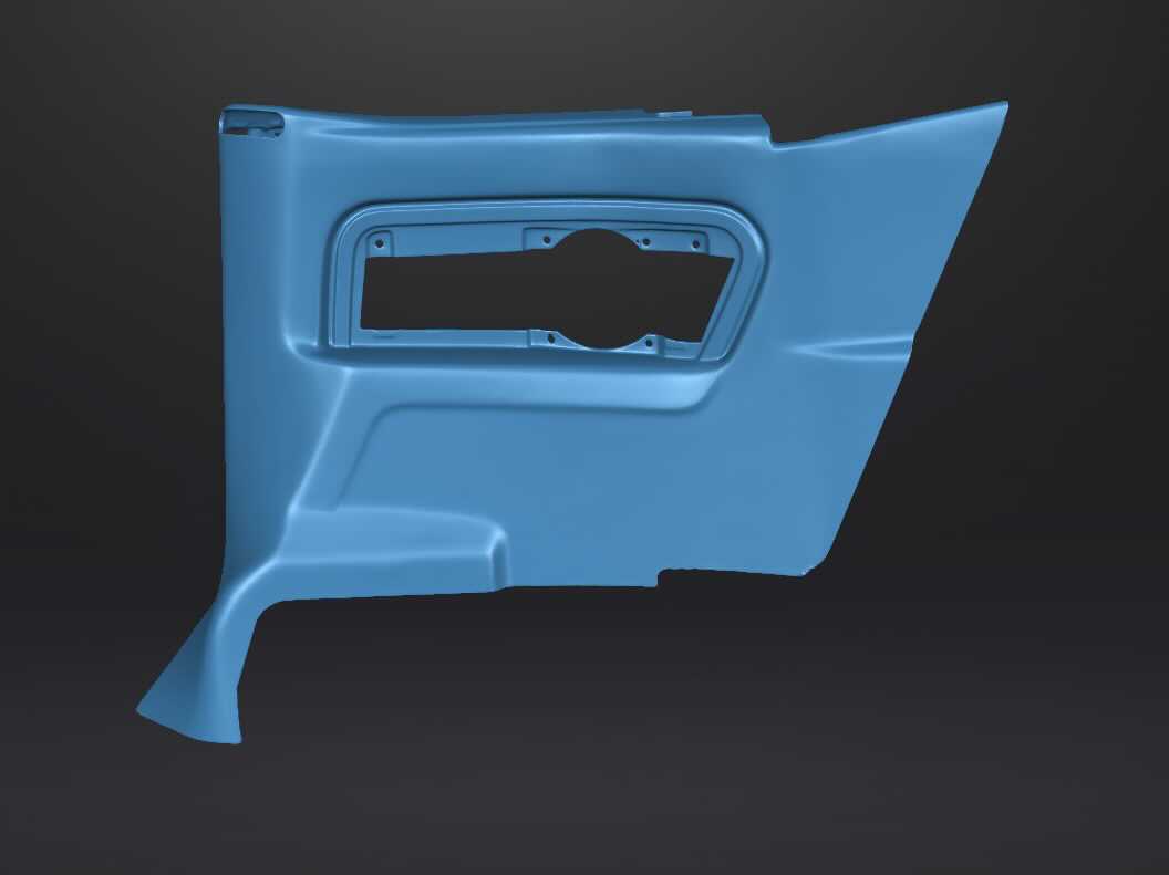

I also sent off one of my spare Rear Door Cards to be 3D scanned, so i can design and 3D Print some speaker grilles / covers, i hate the look of the OEM ones, going to make some nice ones with Mesh / Fabric Covers.

BenHar wrote:
Thu Mar 03, 2022 6:08 pm
Ben
:clap: :clap: :clap: :clap: :clap: :clap: :clap: :clap: :clap: :clap:

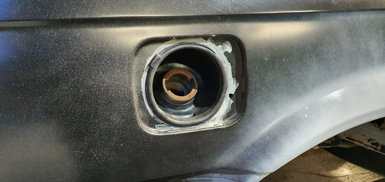

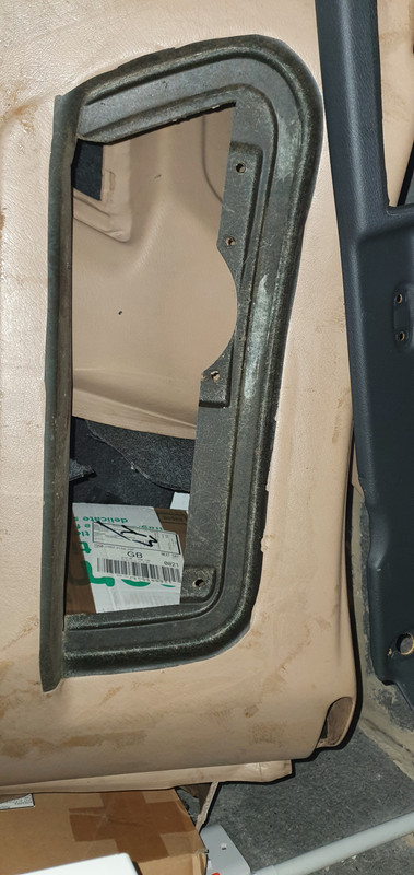

A bit more progress this weekend, unfortunately i forgot about replacing the fuel filler pipe bracket, which was rotten previously. i had to create a basic bracket for this.
Whilst i was in there i also remembered that, most of the threaded studs which are used to hold the breather pipe cover were also gone, only one was remaining. I decided to Rivnut these instead of trying to put studs back in.
I also added two extra ones where the cover meets the pipe that goes through the interior:
I had to modify the cover plate to add two tabs to allow me to bolt down that end of the pipe (it didnt fit very well to be honest, its a genuine part and cost ~£95 but probably i didnt replace the pipe in the exact same location it came from).
Before:
Modified and everything mock fitted:
I also prepped the front wheel arches and engine bay for painting in RC900 this weekend, no interesting pics of that unfortunately.
Im also building a 1500 x 600 x 600 shot blasting cabinet so that i can shotblast the subframes, rear arms etc. i should hopefully have that finished by the weekend.
Im also working on a 3D Printed Loom Grommet that can be clamped round the existing loom and bolted to the bulkhead, ill get some pictures of that once its a bit further along.

Some pictures of the 3D Scan of my Rear Door Card, i can now design a Speaker / Grille Cover that will fit the look of the interior better, hoping to use traditional Black Speaker Mesh or a Nice Fabric Cover - still undecided atm, i will probably do some 3D Renders.
I think the scan came out really well, hopefully get the files sometime this week, i will make the files available too. The company is called Laminar Solutions, it cost ~£70 for the scan which is small price to pay in my opinion for being able to accurately model off an object without having to try take measurements of an organic shape.
I also managed to find a M50B25 Non-Vanos engine for my build. Previously i had one organised, i drove 3.5 Hours only to get there and find out the guy had an M60 sat there waiting for me? So 7 hours of driving wasted but at least now i finally have one coming which should be here today. Pics to follow.
E30 M50B28 Turbo Cabriolet Restoration: Here
AlexD911
Posts: 128
Joined: Thu Mar 11, 2021 4:21 pm
Tue Mar 15, 2022 3:27 pm
Engine Arrived. Going to steam wash it off and then put it away until i start piecing together the internals for it.
More Interior Progress Pics
Here is my idea of the Body Loom Grommet, it can be bolted around the existing loom, with 4 Seals inside, and then bolted to the bulkhead after. Need to do a prototype and go from there.

Wow those scans are incredible, they must have some pretty wicked equipment.
Sweet build too!

Posts: 6204
Wed Mar 16, 2022 4:46 pm
Be30 wrote:
Wed Mar 16, 2022 4:16 pm
Sweet build too!
Keen to see how the loom grommet comes out
Same from me as well.
Are they scanned with optics ?
AlexD911
Posts: 128
Thu Mar 17, 2022 12:06 am
Pretty sure they are using an EinScan HX which are like £12k+. 0.04mm accuracy

Small Update, been spending what little time i have after work getting the shotblasting cabinet finished, its 95% there now. Decent volume chamber so i can crack on with painting all of the suspension & subframe components, i can even fit a fuel tank in here if i want.
Prototype Grommet came out ok, i actually made it much smaller than originally planned, looks like its going to work perfectly fine and fit in the location nicely.
Finished welding, prepping the engine bay and front arches, then a few coats of RC900 totally finishes the underside of the car, i also prepped what was left of rust in the interior and RC900'd all of that as well. I also did in all the cavities related to the car being a cabrio and as much of the chassis internally as possible. This should hopefully put a stopper in any other surface rust that was out of sight, all these cavities will of course have Dinitrol Cavity Wax applied as well further aiding rust prevention.
Finished Seam sealing as well, engine bay is complete - i just need to seam seal a few areas in the interior, inside the inner rear quarter panels and in the boot. I've probably gone through 6 or 7 tins of seam sealer but the car is fully sealed, more so than factory.
I'm now prepping to get the car undersealed, im just wracking my brains and trying to think of anything else that should be done before that. Once i have the car undersealed im going to probably try and run fuel & brake lines.
Once thats done, im going to blast & paint the entire suspension assemblies, get it on and try to get it back on the floor. Im hoping i should be able to move fairly quickly now, most of the tedious work is done (in theory) now i just need to spend a bunch of money on new parts and get it back together.
Couple more interior pics, he now has the leather to do the seats so its nearing completion:

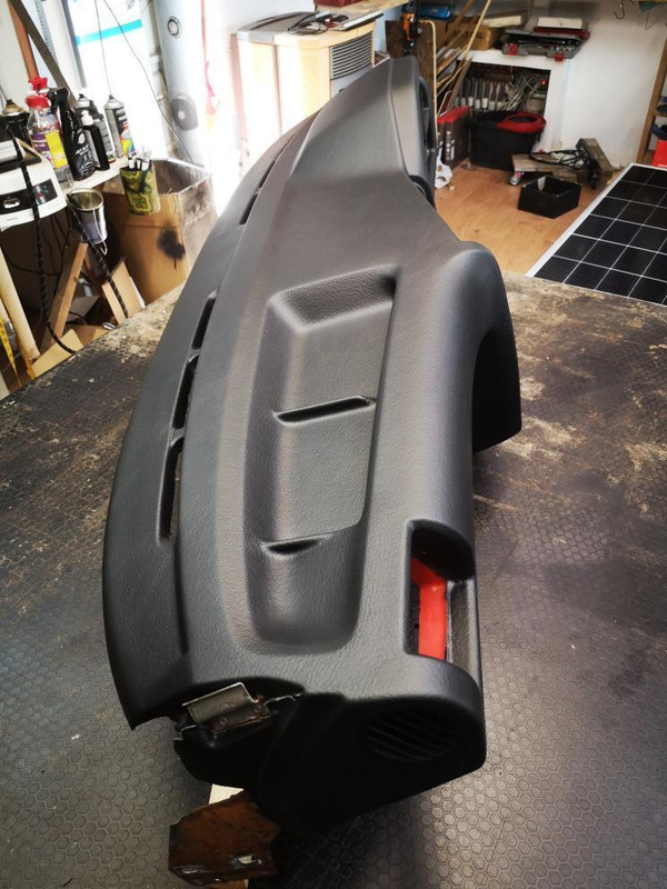

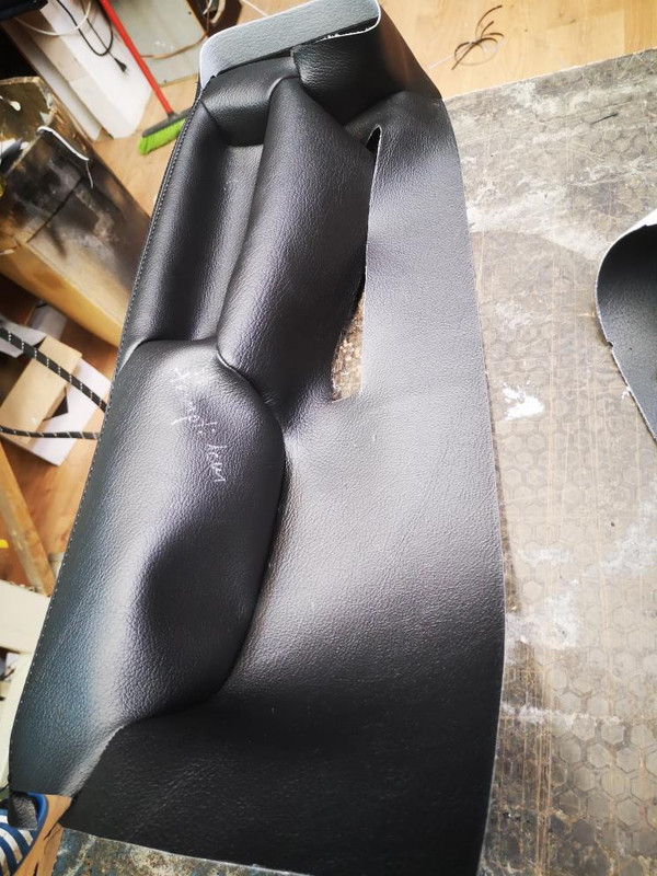

Few more interior pics, my dash was not cracked but the material was faded, worn.

AlexD911
Posts: 128
Wed Apr 13, 2022 12:53 pm
I've ordered all of my poly bushes, and reinforcement kits for the Rear Trailing Arms, Front Subframe & Rear Subframe. I've cleared my to do list now so hopefully i can put some serious time back into the car. Had to spend my free time on my M5 recently, getting it pristine as its now up for sale. Spent a lot of time detailing it and making sure it was perfect. Thought i'd put some pictures here of it.
Thanks
AlexD911
Posts: 128

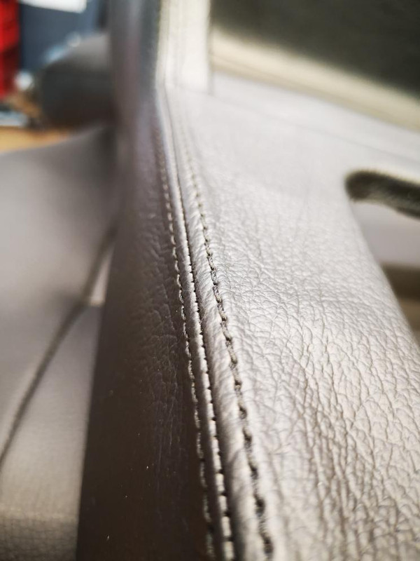

Thu Apr 14, 2022 9:28 am
Couple more interior pics (im really happy he is sending me so many).
Hopefully he starts the seats next.

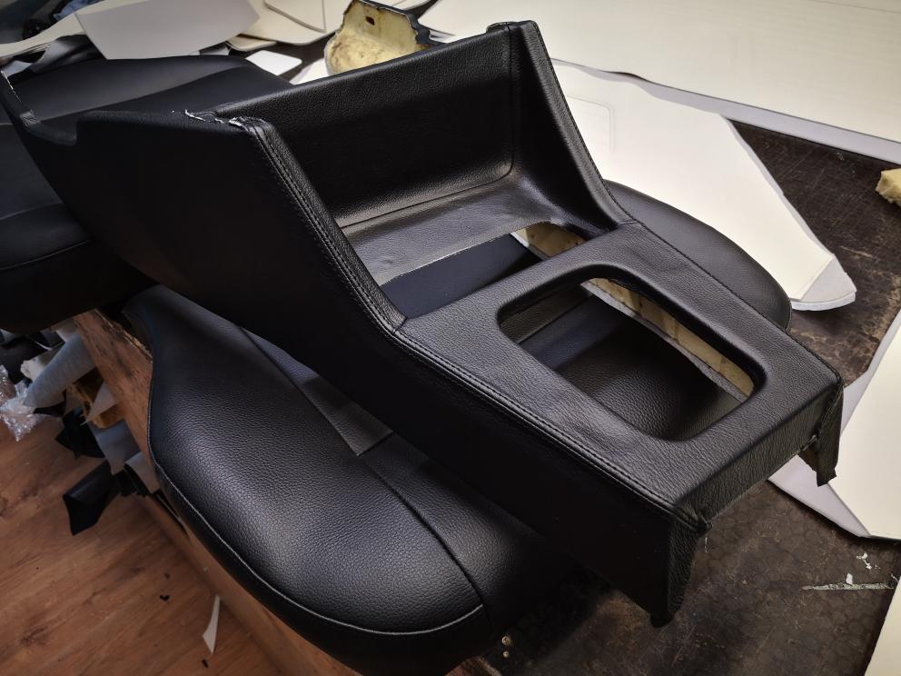

He's also been able to template the centre console pieces i asked him to do so he will be adding those to his DIY Kits he sells on ebay.
Thanks

I also re-fitted the Drain plugs under the front seats:
With this done i masked all the necessary places, filled in all of the rivet nuts and finally undersealed the car. Its still pretty wet in the pictures and has dried to a slighty more matte finish which is nice, i hate the look of a car that has been heavily waxoiled and is shiny etc. Also i masked the areas as best i could by the pictures i took previously, i might have to re-visit this briefly when i start bolting stuff back on to get it exactly right but using the gun is very easy and its such a basic job to do:

RESTAuto has also received the leather for the seats and started to work on them, im honestly amazed at how good the finish of the leather is, super excited now to see them in real life. He's also replaced the heating elements with a newer modern system, replaced any struts that have failed etc.
Was also really impressed with how he repaired this mouse hole, registered well with my OCD:
