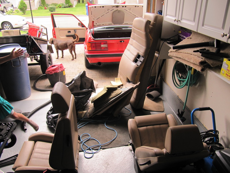

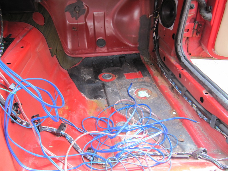

Now, Im not a mechanic and Ive never played around with cars at all but I
thought a closer look was in order... Sooo I pulled out the DS seat...
That was kinda cool so I pulled out the PS seat too...
and then some other bits...

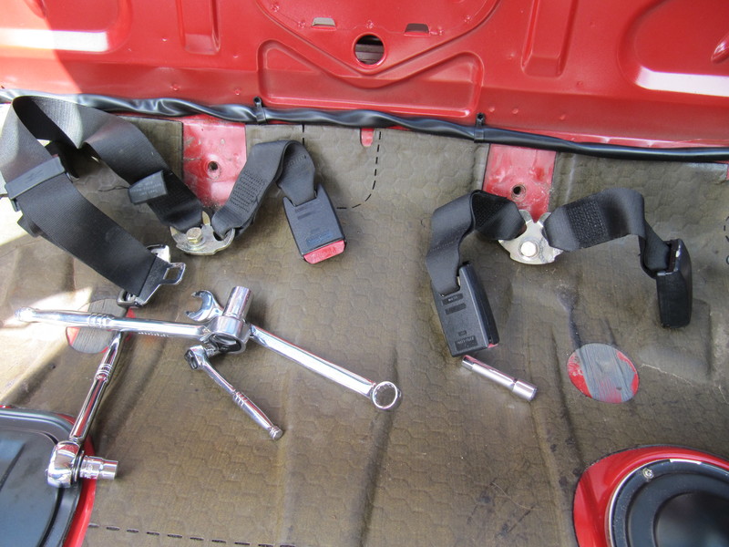

the carpet made an exit and then some more was yanked...

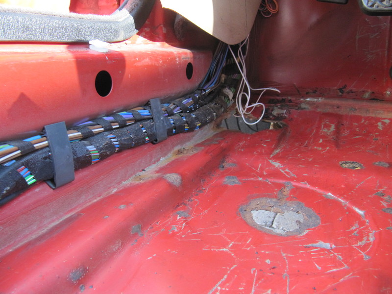

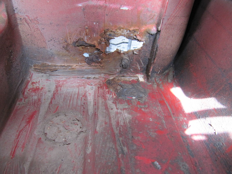

Now the more astute among you may have noticed a wee bit of steel among
the rust there... Im scratching my head now wondering if I would have
been better off spending the $$ Id just spent on bringing the kids to
Disneyland...

Well of course Disneyland will always be there baring any ridiculous rise in the ocean levels so Ive decided to keep the car.... So on we go with strip show...
I had a feeling that sound insulation was hiding some nasty surprises so as you can see above I started scraping it off for about an hour with a screwdriver until I remembered Id just bought an air powered chisel..you know, the kind made just for that sorta thing...
Idiot....

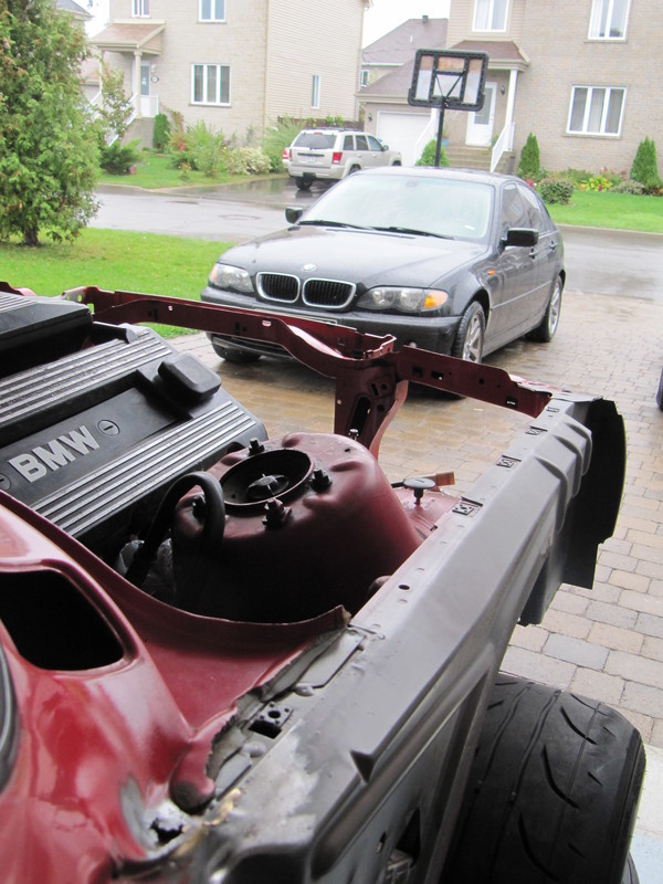

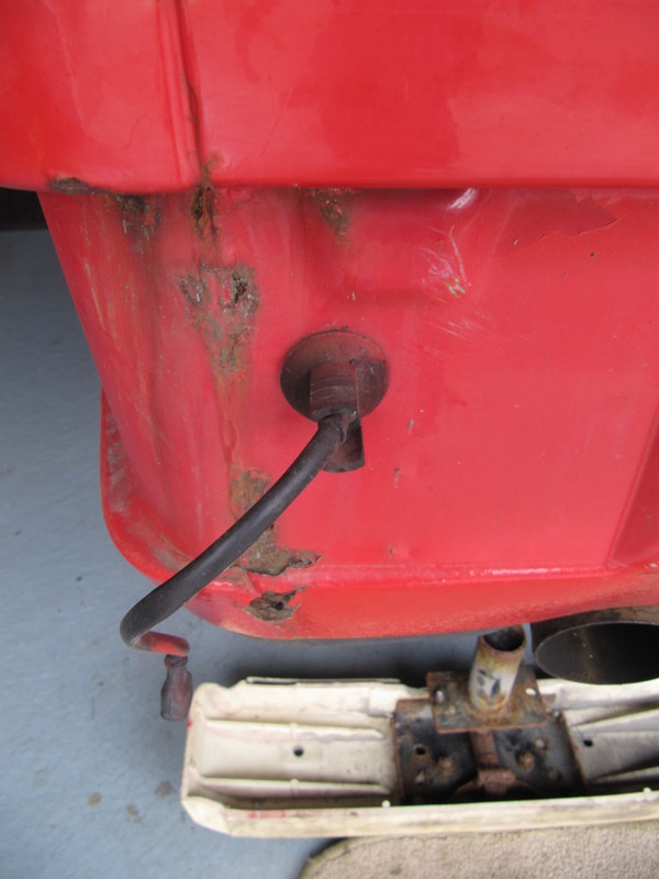

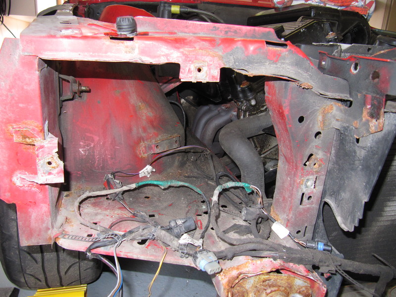

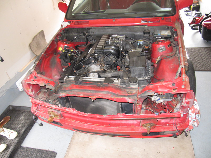

Well the adventure continues...

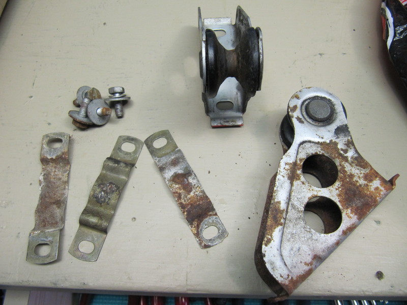

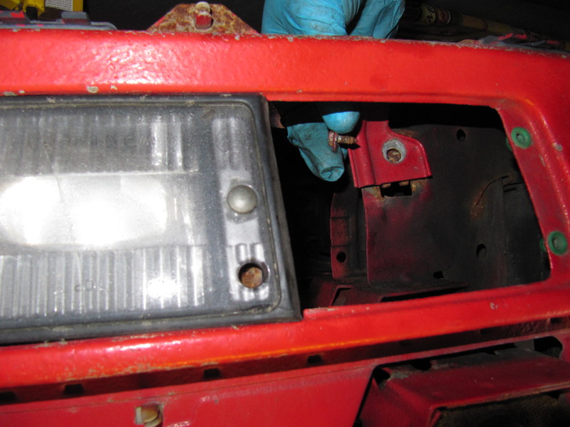

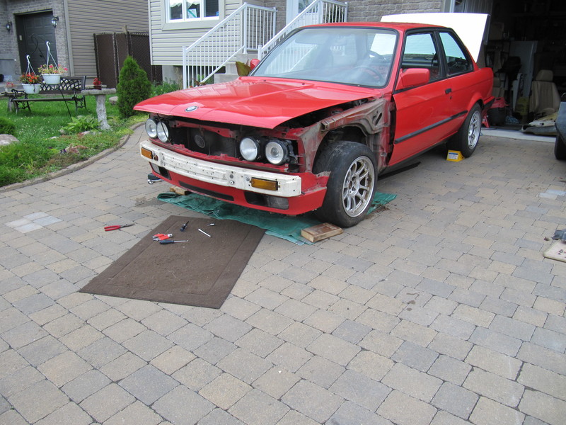

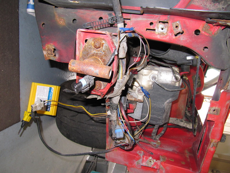

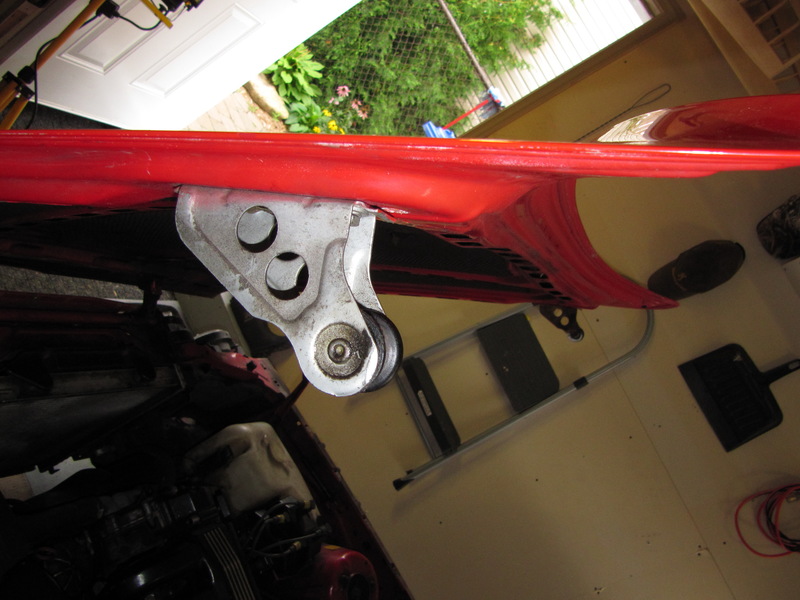

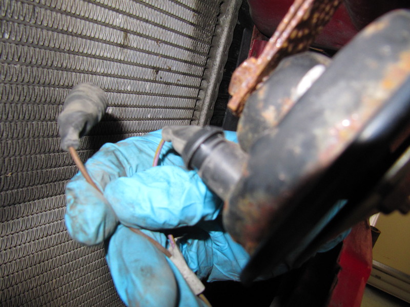

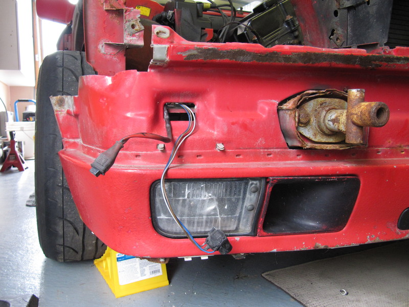

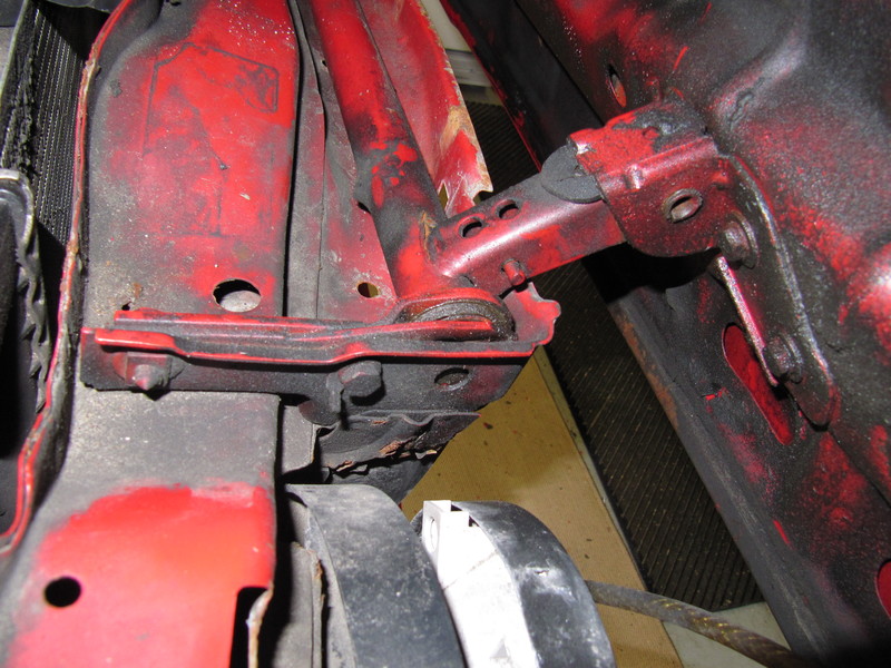

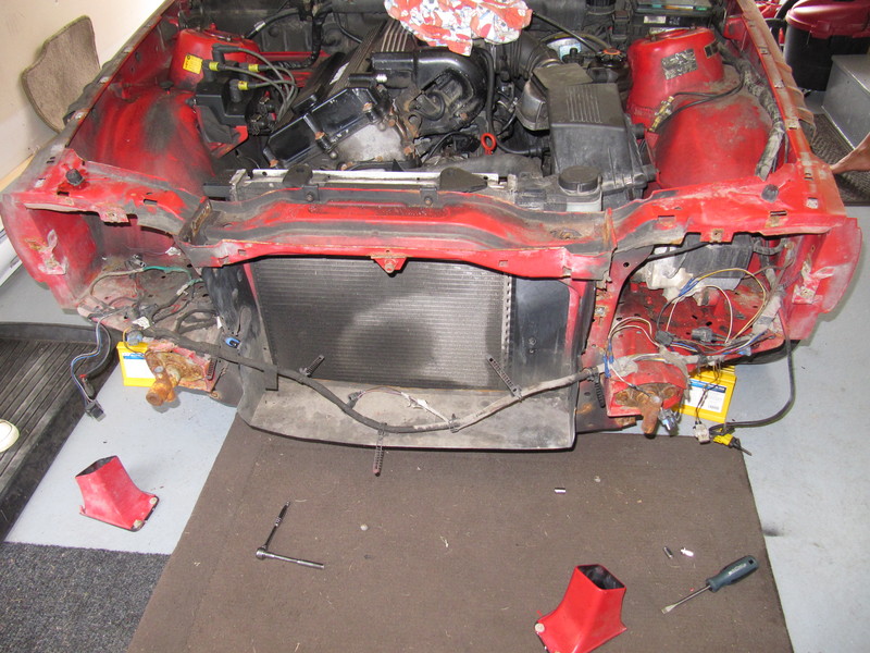

After removing the front bumper cover, which was a fairly straight forward affair: remove screws and slide off, an epic battle was fought with both the front and rear bumpers... The front finally gave in once common sense was applied instead of brute force and stupidity..
Loosen the 2 bolts on the bottom of the bumper. Those facing you hold the metal support plate to the bumper... They dont loosen.
Above, on the far left, you see where the bolt screws into...
The rear bumper however, hung on and eventually needed an angle grinder and some strong language to finally be persuaded to let go.
The bolt heads had to be cut off as no amount of torque, loose nut or cursing was getting them off. As a result I had to cut the tow hook to access the bolts - no great loss - I wanted it gone anyways. Something about a tow hook says to me "This car is shitty, it will probably break down..." So none of that on my car...
Removing the front bumper revealed some very slight damage to the right side shock mount: evidence of a thump sometime in the cars past:
As best as I can tell that is the extent of the damage..The left side mount had no damage at all and there are no ripples any where else or evidence of repair anywhere....
With the bumpers off I could have a looksee at the metal behind and this is what I saw:
I need to get a welder...
Oh.. and I need to learn how to weld.... :(

Automaton
Posts: 453
Joined: Wed Apr 03, 2013 11:00 pm
Location: India
Post Tue Oct 15, 2013 8:21 am

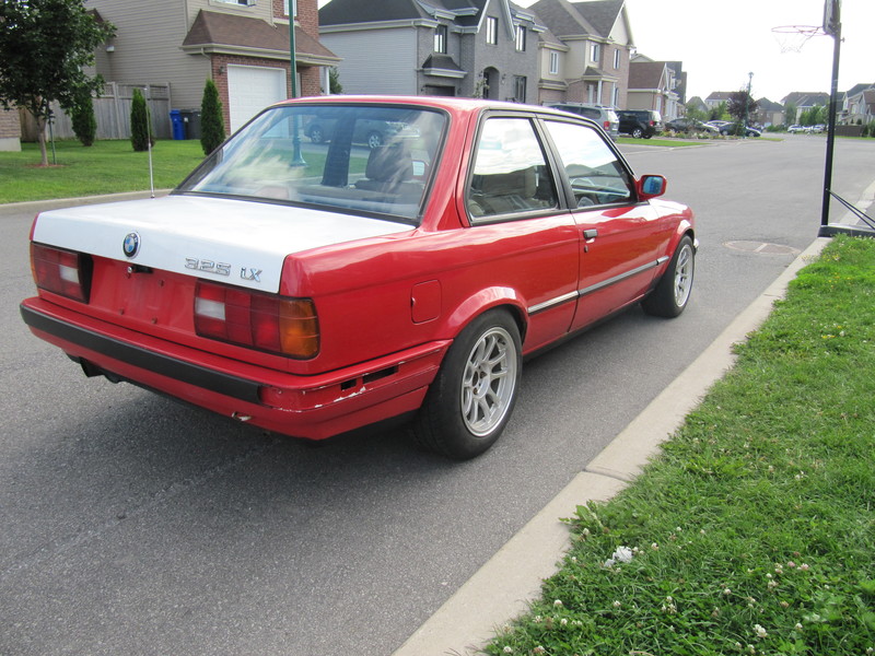

Looks like a bunch of parts from a white car are attached?
Looking forward to the cut and weld adventure.

nickso
Posts: 4396
Post Tue Oct 15, 2013 9:12 am
When you replace the battery box in the boot just bin the tow eye, its a pointless rust trap. If you still need a tow eye you can fab one out of a front tow eye and put it in the rear bumper like mine.
Least the front bulkhead looks solid.

Split_S
POR 15 junkie
Posts: 529
Joined: Sun Jun 16, 2013 11:00 pm
Location: Canada
Post Tue Oct 15, 2013 2:15 pm
Automaton wrote:Looks like a bunch of parts from a white car are attached?
No, only the rear boot lid.. The original, which I have, was rusted all along the seams. The PO had replaced it only a few weeks ago with used 325 lid.
Absolutely..Its gone... I will look into how to cut out the base and patch weld it so it looks as if it was never there... 8)

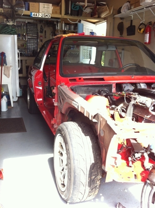

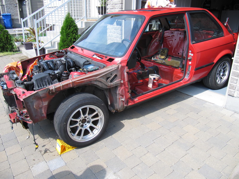

Well work continues... The car seems happy in my garage, kinda like its thinking "F$ck its about time!".. Maybe its just me....
The M42 is a nice looking engine. I look at it and compare it to my M54 in my E46 and see many similarities.. I cant wait to yank it out!
One thing I am thinking about is the seasons. Being in Canada, winter is not too far away and I have to plan my work around the fact its gonna be really cold really soon... I had planned on doing body work all winter but I have scrapped that idea as I dont have ventilation in my garage to deal with the dust all that bodywork will generate. So the plan is now to get some welding done before its too cold to work with the doors open, redo the rear suspension in all its glory, yank the engine and at some point rebuild some components of the engine. Maybe, just maybe, I may pull the dash out but that is scaring the sh*t out of me right now....
Here is the state of the rear of the car as we speak:
Remember my comments on Disneyland?... :roll:

Chugging along...

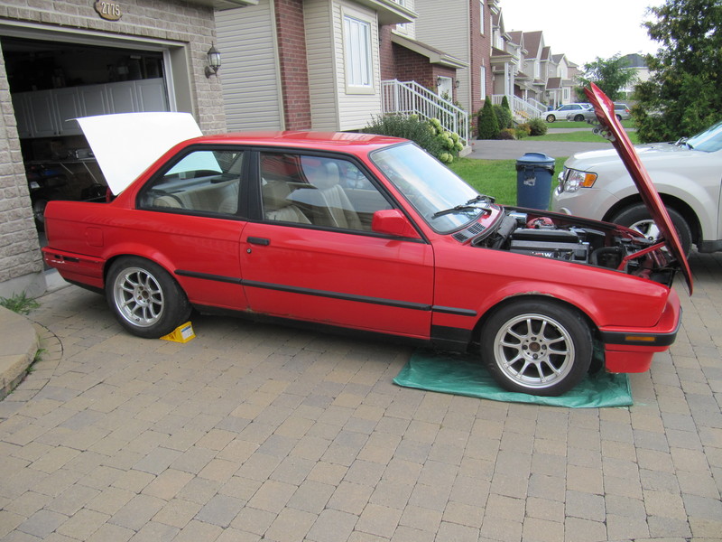

Time to get that bonnet out of the way...

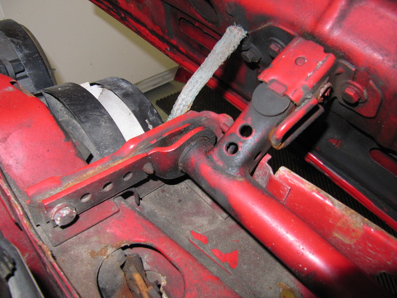

Step 1: Open bonnet...
See bracket on right under all that grease..
Bracket on left under same grease...
Both at once... BEAUTIFUL...
Identify tubing for wiper spray nozzles... Remove...
Remove rusty roller guides and set aside for deep cleaning

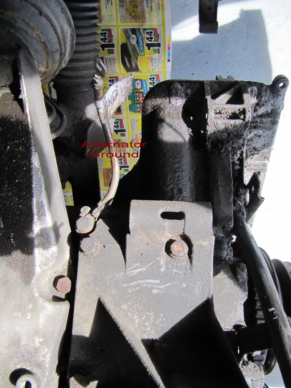

Take note of grounding strap and then loosen all those bolts...

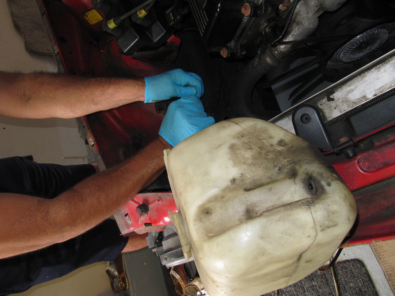

Call a thirsty friend and tell him you have beer.. Once he's at your
place...well... now you know how I got help removing my bonnet..
No time to waste remove that ugly washer reservoir..Im thinking relocating
it to the boot...

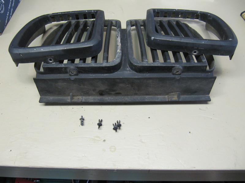

Feeling good I then worked on the lights, removing the plastic grills..
Grills out, loosen bolts that hold light bracket in place then...
Pray to God you can remember how to put it all back a year from now....
Ta-daaaa...
Now I have to build a second shed to start putting ALL THIS STUFF in it... :mad: :mad: :mad: :mad: :mad: :mad:

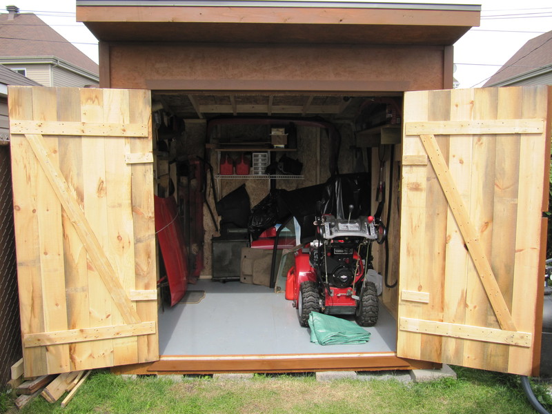

Well, new shed built to accommodate all this stuff, not very exciting pics but for a 2 day job Im happy with it...
Work continues on the car too...
Got all the screws out for the front valence without breaking any...
Dropped the valance, pretty good shape I think... no doubt I'll buy a new one...
Looks awesome like this...
Rads good but Im gonna get a new one, this one will never clean up proper...
Gonna loose that ABS unit..anyone with a guide on an ABS delete feel free to link it!
Lots of grease to clean out... and that damn rust...
Finished the day by cleaning off the ww container. Looks like new....

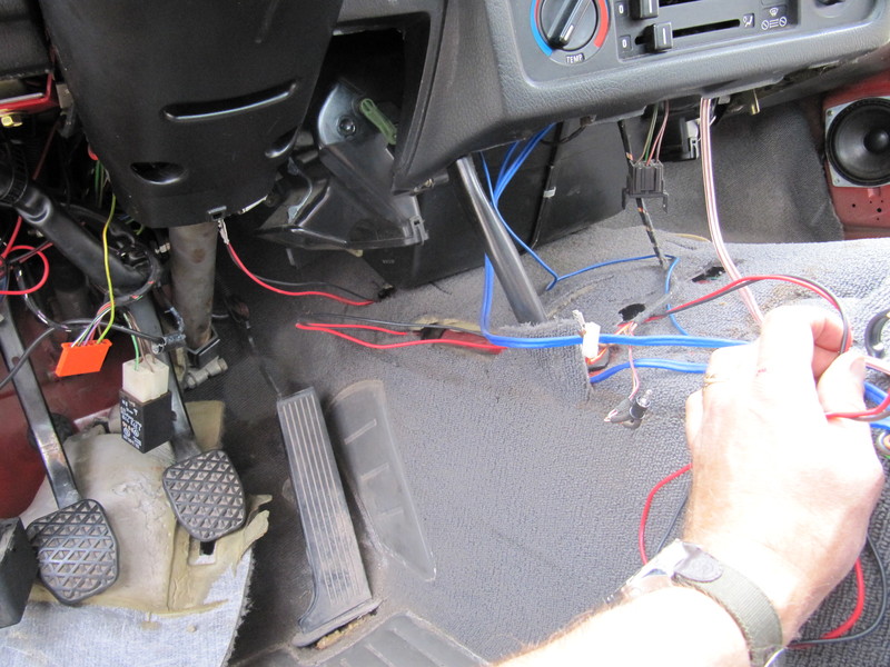

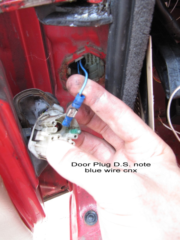

Short Post... Doors are off and those with keen eyesight will see the boot lid is off too... 8) Removing the pins is the EASY way of removing the doors... I left the brackets in place... RH door will have to be replaced though..Bottom is rusted out... :(
Written notes on pics are for my reference...

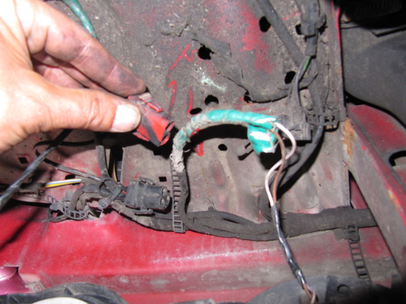

No clue what that blue wire is for...

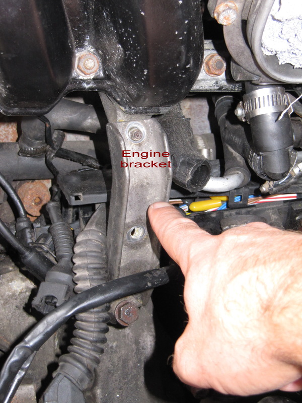

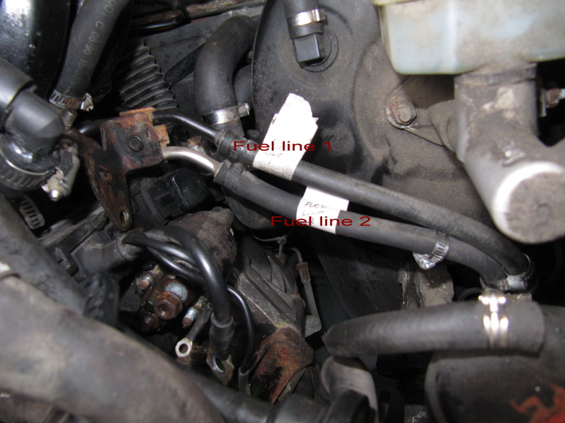

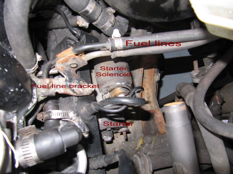

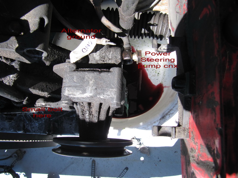

So, first things first was to get the starter out. A lot of these pics have labels
on them, I did that for a bunch to keep track of what goes where - never thought about saving a copy of the pics without the labelling..sorry about that..

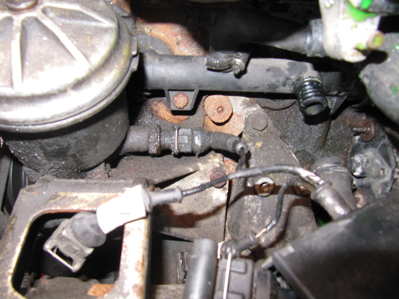

The starter was quite a bitch to get out. Lotsa stuff in the way and the bolts were rusty and and didnt really want to give. Swearing alot really helps though...
Ive become good friends with WD40 already...
All the coolant lines were soft and old. Its all scrap...
The fuel lines too..
I am planning to simplify the coolant lines by deleting the throttle body heater plate as this will be a summer car (well Canadian summer car...:wink:)
I labelled as much as I could.. Funny thing is the flash from the camera removed all traces of what I'd written on the labels!! Aaah the irony...
The coolant hose connector kinda broke off in the engine...Its a rubber ring thats pressed fit in. It basically disintegrated.I searched on realoem for the part but its part number is not listed.. Gonna need replacing..Like everything else! :doh:
better pic of it here..
Starter FINALLY out!!!... Felt like Id just ran a marathon....
The car is looking AWESOME....

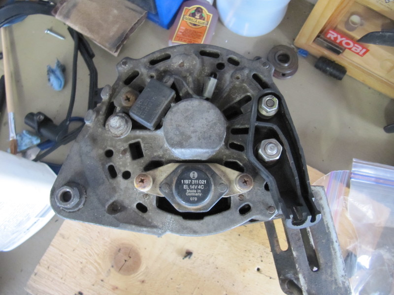

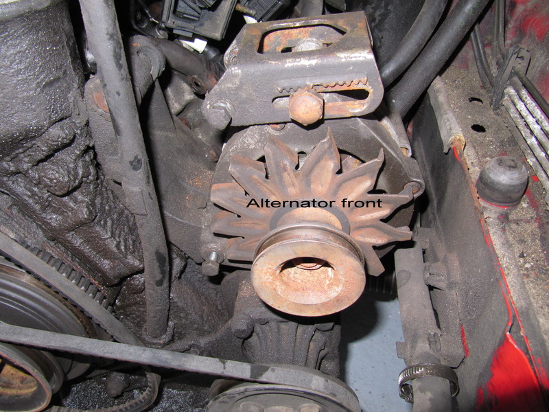

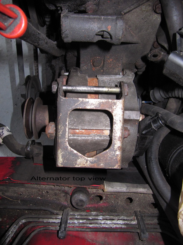

First the alternator, which funny enough Im planning the refurbish over the winter along with the starter... No idea how to but it will be fun...
Getting the alternator out is pretty straight forward. Remove the belt by loosening the tensioner and then loosen up the bolts. The only sticky part was prying it off the bushings from the housing that the bolts slide thru. Mine were REALLY tight. You just have to wiggle it left to right for a while and they'll finally give...
Out and on the workbench... :cool:

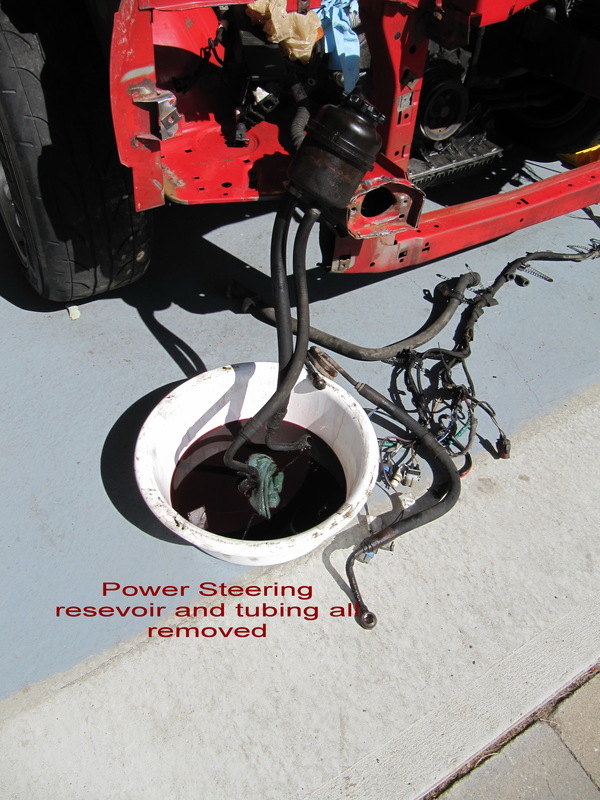

Next up, the power steering pump and lines...Pretty straight forward... Just be ready with a bucket of some sort underneath... duh...
Pretty messy but done! All this will be binned and bought new...

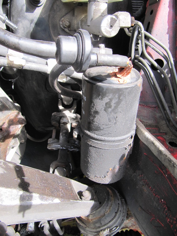

Out with the charcoal filter...

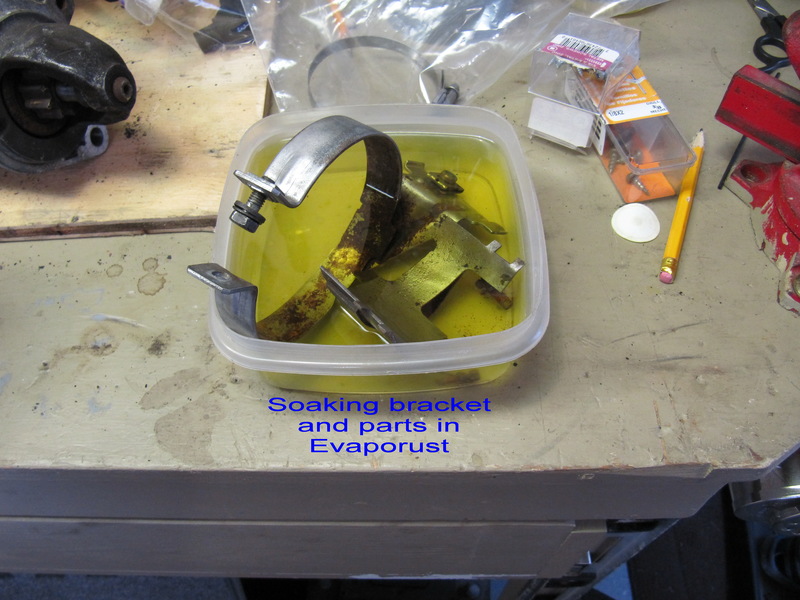

I think this bracket is NLA so Im gonna clean it up...
Charcoal canister out and binned.. These things arent cheap...
Soaking the rusty brackets in Evaporust...Works great...

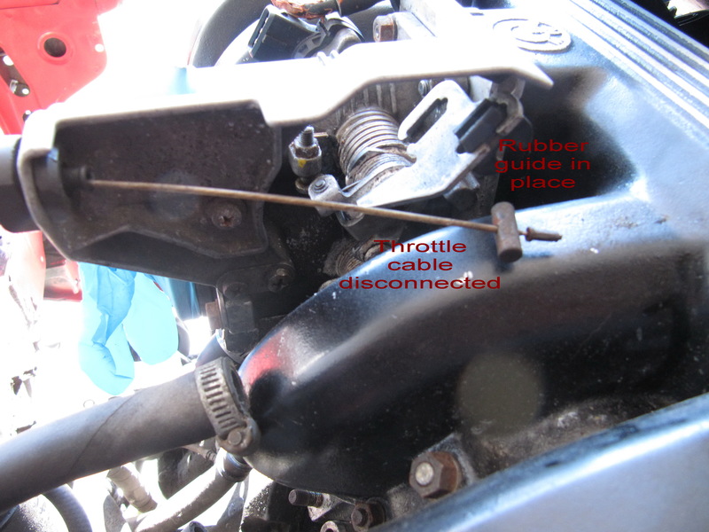

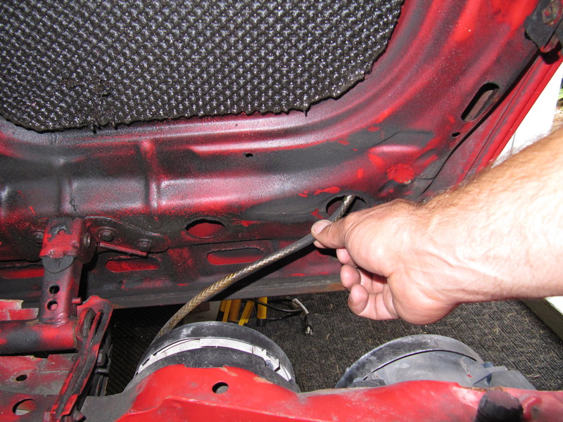

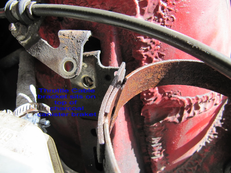

While doing all this nonsense I also found the courage to disconnect the throttle cable...
Bracket is overtop the charcoal canister bracket:
Pic of throttle assembly but what I like in this pic is my completely SEIZED blower in the background.. Can't wait to tackle that biatch.... :cry:
Joining the starter and other orphaned components on my workbench:
Mr Power himself:
and his amigo, El bomba...
Soaked this stuff in Evaporust:

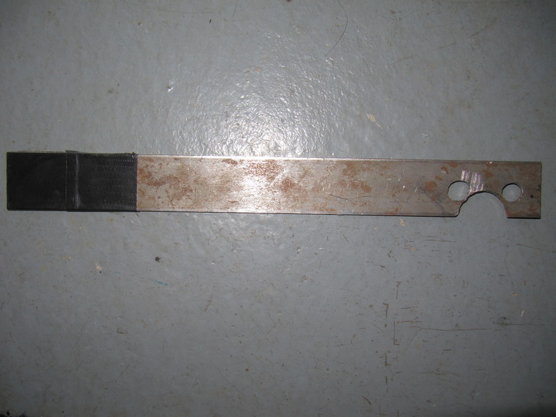

I also removed the fan using my home made fan clutch removal tool which I'd just recently made for my e46... (shitty thermostat!). Here is a pic...
Its 34cm long by 4cm wide... Center of 1st hole is 5.8cm from edge and closer hole center is 2cm from edge...
Diameter of half moon is 3.6cm with the center at 4cm from the edge...
Worked great on both the e30 and e46... Hope this helps someone out...

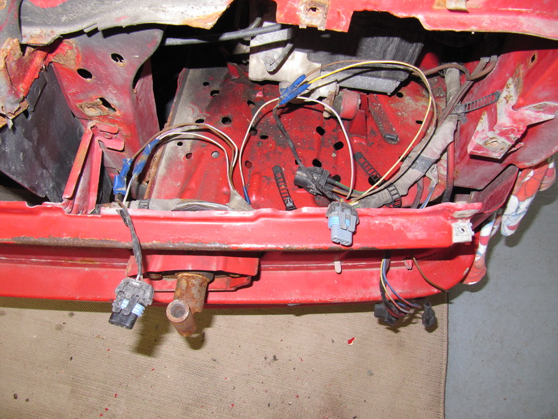

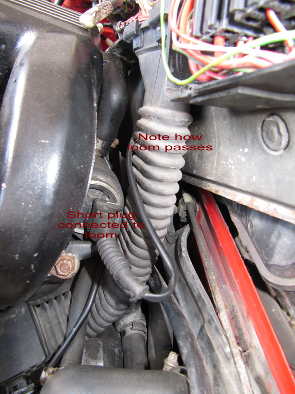

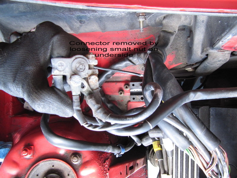

I also started removing the loom in the engine compartment too... It was kinda like the first time I had sex: slow, awkward, kinda scary.. :o:
With it all disconnected I put everything in a plastic bag.. Im not planning on removing the loom from the car as that scares the sh@t out of me...
Joking aside it was quite straightforward to take off but Im not at the point of taking the complete loom out. Im trying to pace out the work and I dont want to pull the dash just yet as Ive simply got nowhere to put it!! Can't build another damn shed now can I!! So the plan is just to remove what I can and get it all ready... I've wrapped the loom ends in garbage bags to keep from repeatedly stepping on it...:roll:
All in all Im pleased with how far she's come.. Unlike most of you I've never messed around with cars before, so for me, this is pretty intense!!

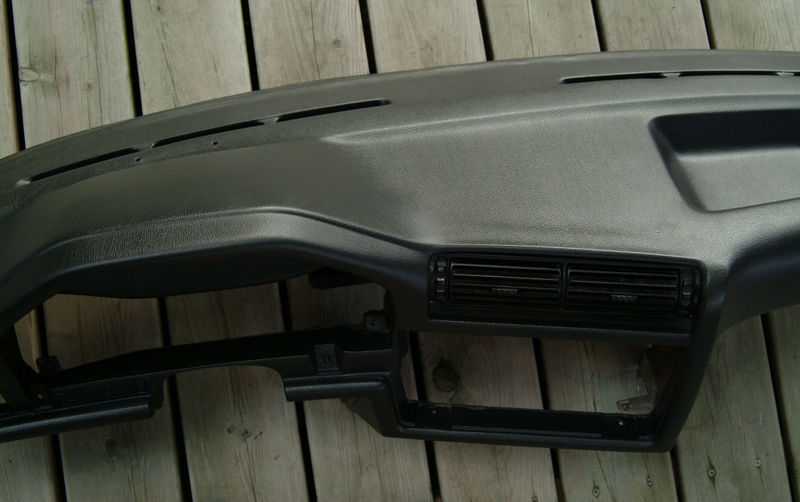

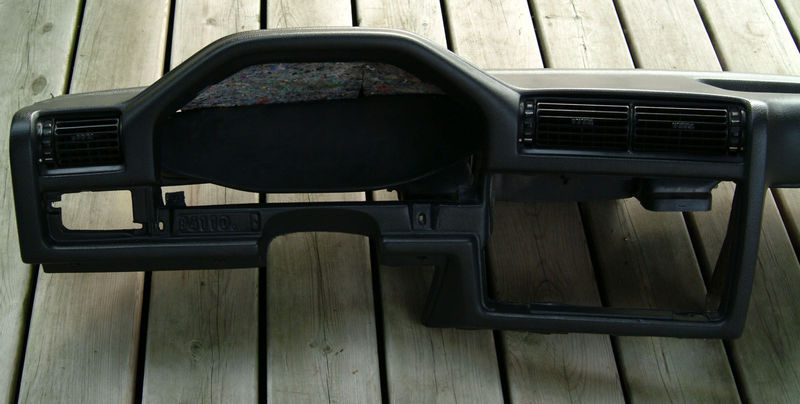

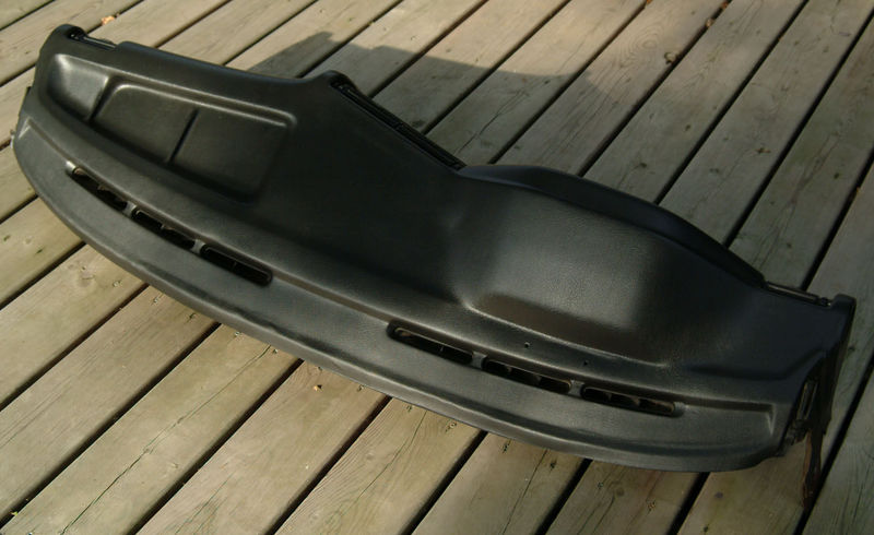

Not that anyone cares but just scored a MINT crack-free dash on ebay... 450 cdn... looks new... pics to follow...

Pics...
Just 7hrs of driving to go pick it up, 570$ to pay for it, 2 more years of toil to get the car up and running and she'll look great!
