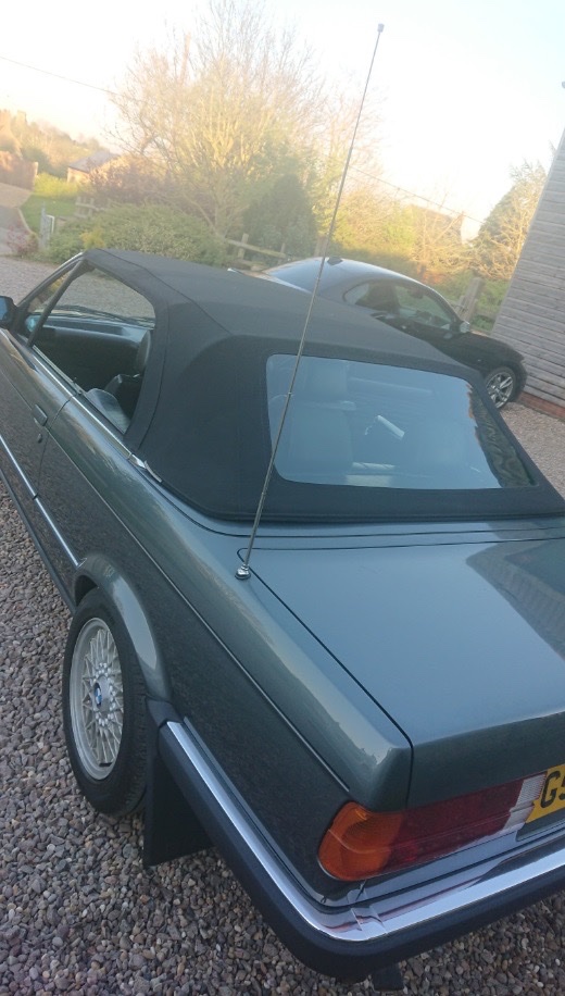

Had a few weeks off because of bad weather, but I’m guna get back on it today. Hopefully look at installing the new speakers and the sqr46 🤞
My brother also sorted the pinstripes for me recently 😋
Not the best pics, but it looks epic! So pleased!
Pinstripes look great!
Where did you managed to get a set from?

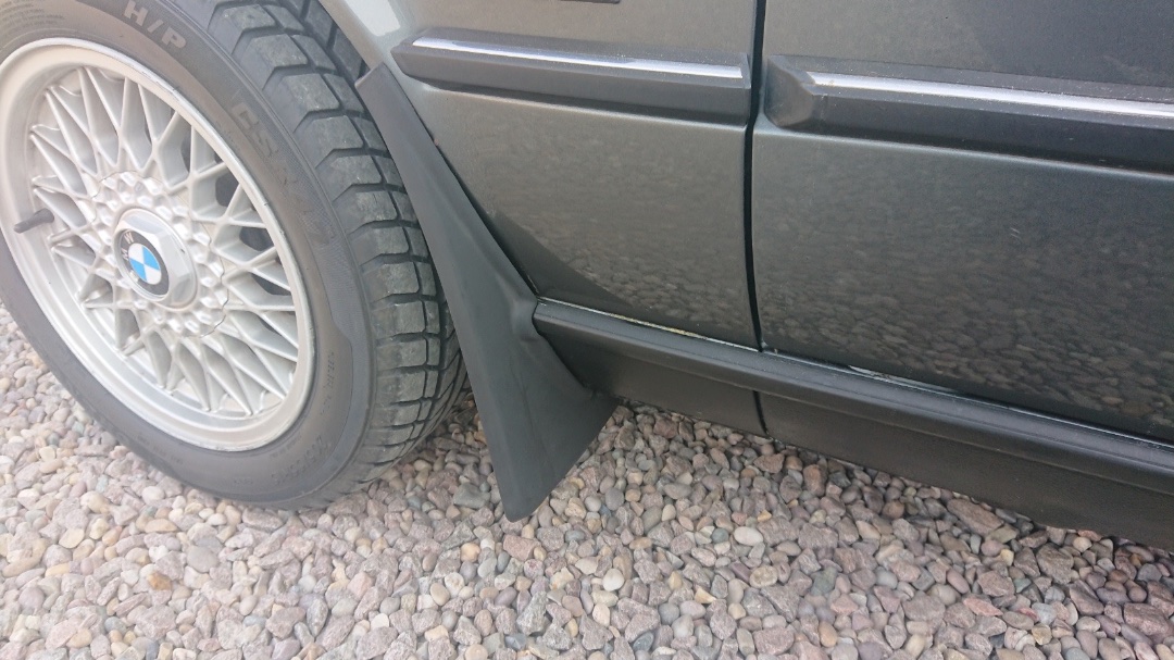

Original front wheel arch liners plastic welded as new aftermarket ones were poor quality.
Mud flaps refurbished, new clips, nuts and bolts, brackets media blasted and painted.

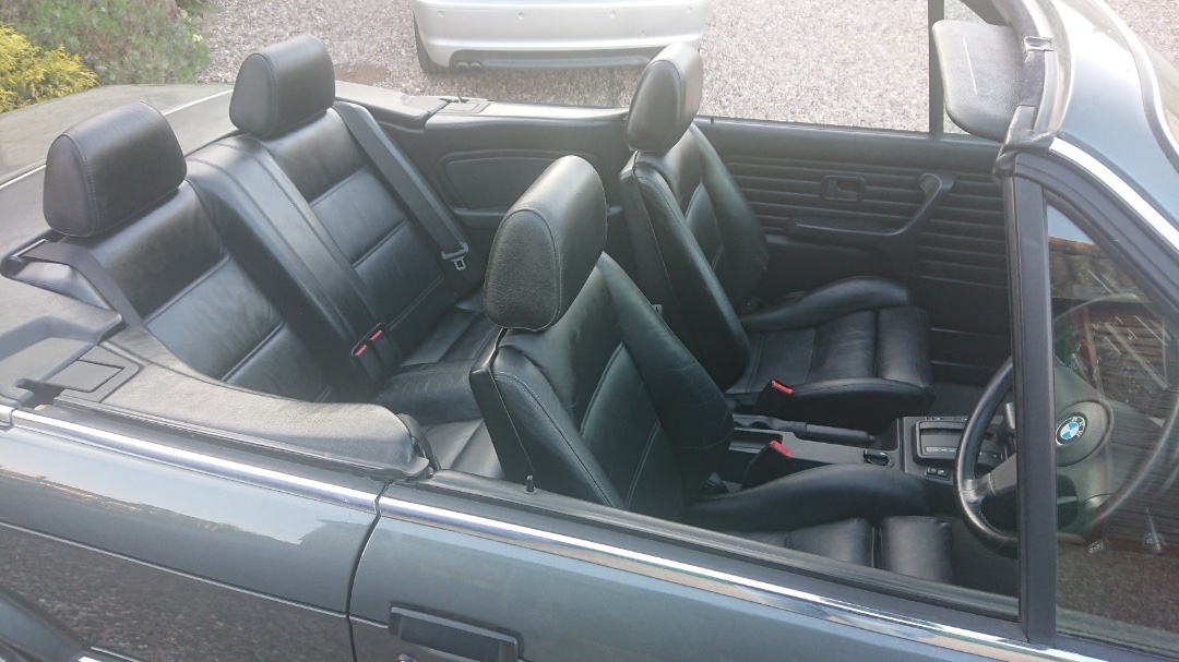

Rear seats leather fed, and refitted.
Replaced rear seat belt buckles as old ones badly faded.

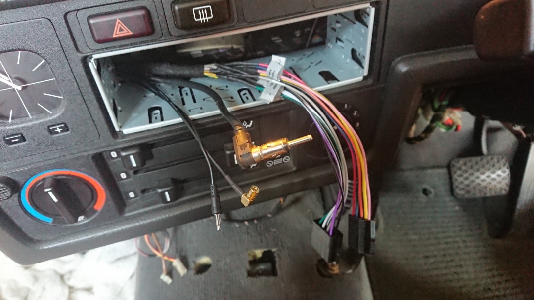

Wire up and fit new stereo. DAB aerial and microphone routed up to the top of the windscreen.

Refit front seats, leather fed again.

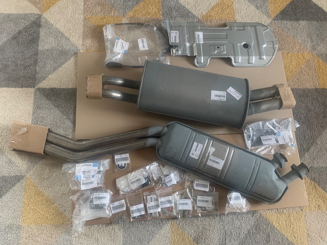

Exciting post from Germany today! All OEM exhaust parts and a new Bowden cable for the cruise control :)

That exhaust looks decent - would be interested to hear your thoughts on the quality and sound

Very nice, when you replace the heat shield above the rear silencer, make sure you keep the original nuts. The new ones I got from BMW didnt fit, they just kept spinning, it may be just an error that you wont experience, but thought I'd give you a heads up.

Will post a video once fitted! Chuffed with it, just needs a good paint job to protect it before fitting?
Need to decide whether to go with stock grey or black.... thoughts?
Thanks for the tip! Defo brought the same ones as are on the car so hoping the new ones will be OK.... will save the old ones for sure tho just in case!

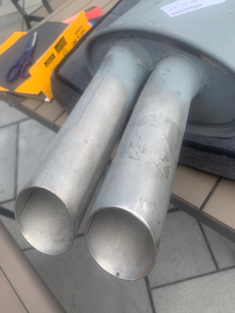

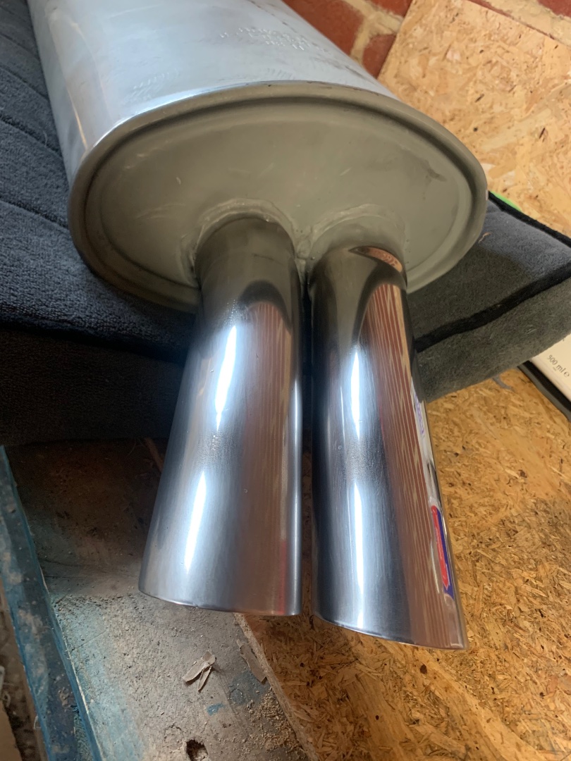

So I decided on stock grey for the exhaust but with polished and lacquered tips..... 1 hour 45 of hand polishing and one of the tips is done!!
Before
And After
Will do the other one tomorrow, my arms are killing 🤣

ocde30
Posts: 237
Location: Yorkshire
Thu Jul 23, 2020 9:52 pm
One hour 45 minutes well spent in my book !
bexwoods
Posts: 249
Joined: Sun Nov 03, 2019 10:20 pm
Sat Jul 25, 2020 9:42 pm
Thanks hun :) first pass on the other side too now but not as happy so will do another pass tomorrow.

Posts: 6193
Sun Jul 26, 2020 2:20 pm
What media are you using to polish with ?
bexwoods
Posts: 249
Sun Jul 26, 2020 8:13 pm
Just worked my way through from 240 to 2000 grit wet and dry and then some metal polish! Worked a treat!

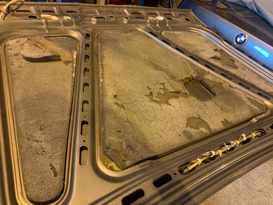

Bonnet off and washer bottle out as well as a few covers off to clean up during the week.
Bonnet to be cleaned up ready for new insulation!

God this stuff is persistent!!!! More wd40 purchased.... back at it tomorrow!!

Oh yes, I think pre FL had different stuff to stick it on, like a mix of araldite and chewing gum :-x
