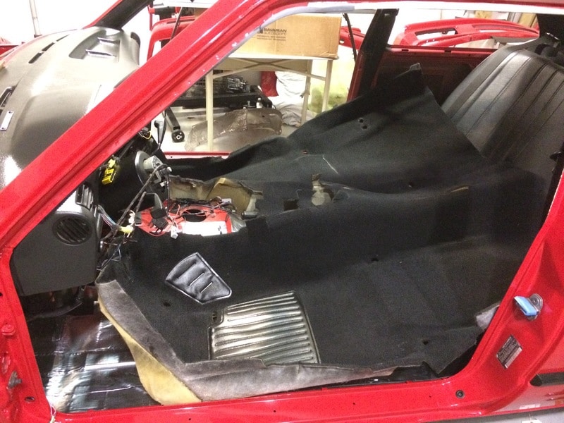

Sometime in the middle of this I've also plugged away at the cabin.. It's weird as there is so much to do, I have to try to figure out what is the best order to do it in...
The dash area is still scaring me..so I'll avoid that for a while...
The sunroof fabric was loose so I tackled that instead...
Using a bit of automotive glue I glued the edges and tightened everything up...
As you can see from all those clothespegs Im the one who does the laundry around here...

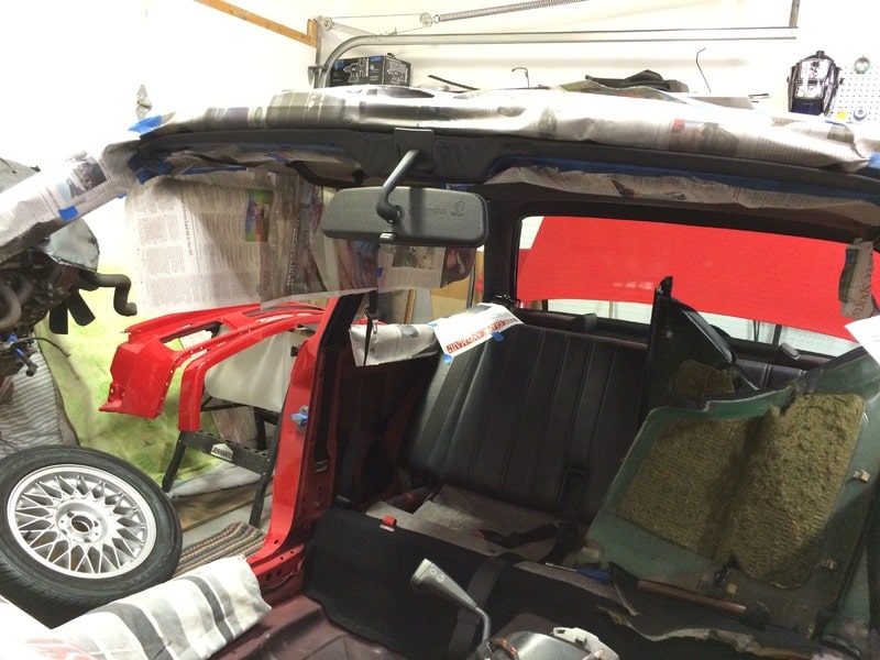

I DID decide to change the color of my headliner however..
Yes. Black and red go good together.. Blotchy stained tan SUCKS... So off I went like a drunken sailor to a whorehouse..
Painted some odds and ends while I was at it...
And finally the headliner...
A bit of sag on the sunroof as the panel isn't installed yet but overall I think it all looks pretty nice...

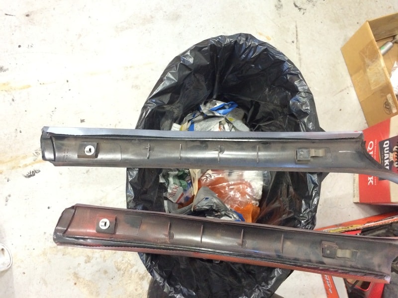

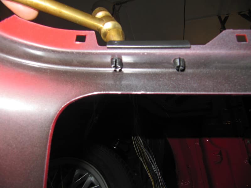

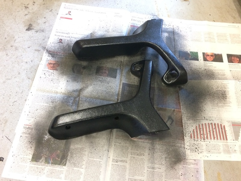

I also removed the A pillar covers and fixed them up...
These are easy to break and are pricey...
So if you have to remove them this is how you do it:
First remove your glareshields.. two screws for each.This will loosen up the headliner near the top of the A pillar..
See the knobby thing below? This is located near the top of the A pillar.. Gently pull the cover outwards (towards the center of the car) at this point. You will feel it pop out from the pillar.
Next you will gently slide the cover upwards along the pillar a few centimeters (2") as you pull the headliner down slightly for it to clear... This will allow the clip you see below to slide free of where it is clipped into the A pillar..
If you do the above you WILL NOT break them.
Regluing...
Here they are repainted and ready to go back in...

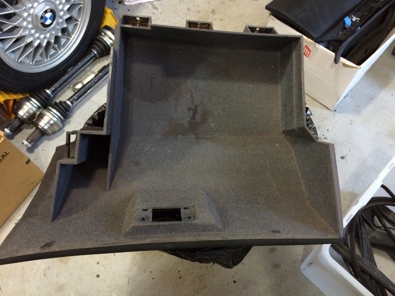

So I did a quick clean and repaint of the glove compartment..
Before..
After..
I've also been trying to take some decent pictures of the headliner but they come out looking like CRAP honestly..
This is the best I could manage considering my feeble photographic skills...
The flash creates a bit of white reflection where there isn't any.. me thinks it looks much better than the stained tan that came before...
Before..
After..

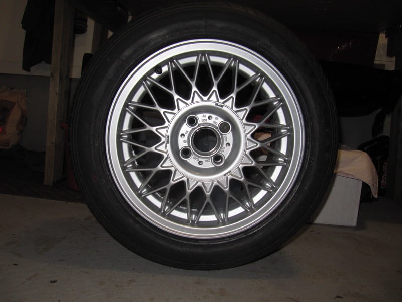

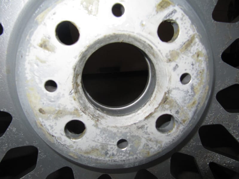

In between all this I ran into an interesting problem with the wheels Id bought off another e30 enthusiast back in May..
He had 4 of these, BMW BBS Style 5, all refinished with new rubber:
Classic e30 rims... I thought "Great! Im good to go!"
So I paid cash and set them aside while I worked on the sanding of the car for the next 5 months...
When I finally put them on I realized I wasnt as good to go as I had thought..
Did you spot the trouble spot??
Seems the offset was different.. If you didn't know it let me tell you BMW used several different offsets for the same wheel style.. These were ET41: 41mm offset from center. For most e30's with this wheel style the offset is ET30 = 30mm..
Live and learn right?
The solution?
oh, and Ebay.

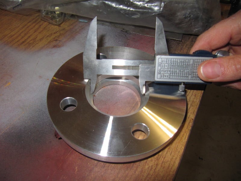

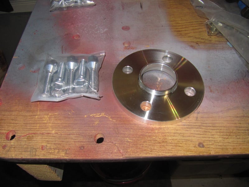

To make up for the 11mm difference I purchased 12mm spacers (there are no 11mm spacers..)
These have the center bore at 57.1mm which is standard e30 diamater for the hub:
The outer flange is also 57.1mm to accept a standard BMW/BBS wheel..
They install flush to the face of the wheel: You should put a light coating of copper grease to prevent corrosion and binding between the spacer and the wheel and the hub. Im not as I will be disassembling these a few more times before Im done...
Like so.. You can also see the standard lug vs. the longer one needed as supplied with the spacer...
Once mounted they corrected the offset and the front wheels now sit where they "should"..
The rear wheel clearance is fine and actually look alright but I may yet put spacers on them as well..
Here is a link (German) for all BMW wheel styles and offsets..
http://felgenkatalog.auto-treff.com/
Now I can go to bed a little less dumb than when I woke up this morning!

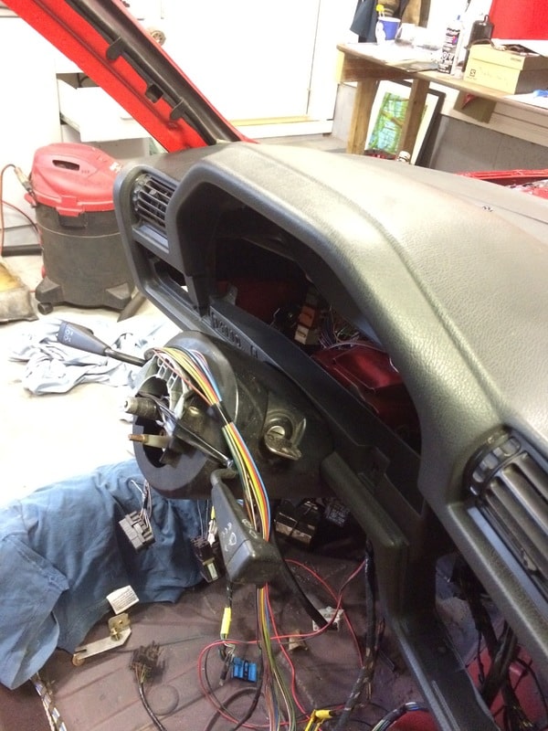

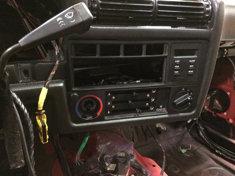

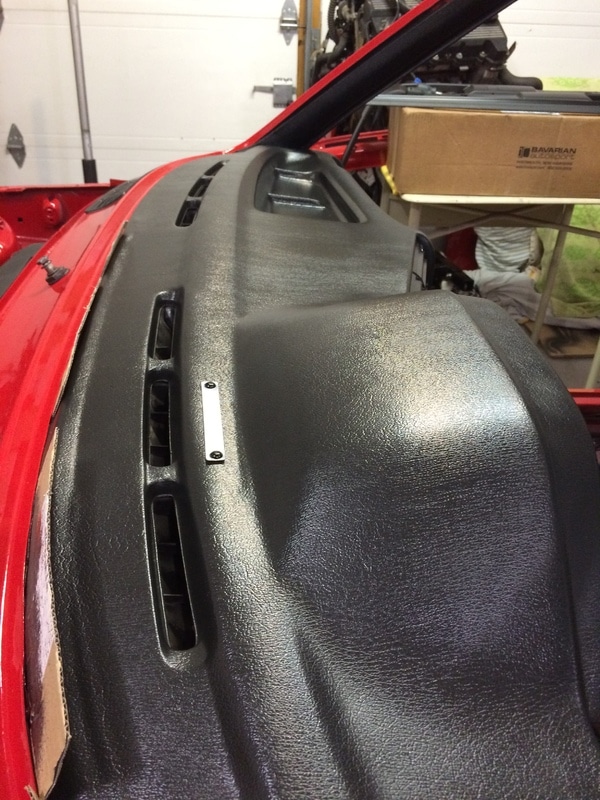

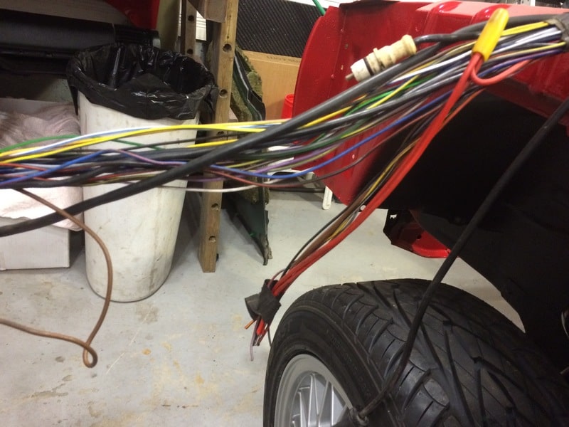

Finally feeling brave I decided it was time to get the dash in.
I started by routing the wires across and where required pinning them down with the fasteners...
Now, how many people have this problem? Two crack-free e30 dashes.. which to choose??
The best one of course!
So, of course, I did this alone.. but its much easier a deux as the french say...
Getting this over the steering mount is the tricky part.. Its all pretty fragile and you just have to be careful...
I almost forgot the support column but I put it in loosely as I will be getting the carpet in eventually...
What a bloody mess...
I had prepared all the wiring beforehand and that helped tremendously...
In and trim back on...
Last little step was to swap the VIN plate... saves some explaining with the law later on...
Thank the sweet lord!!

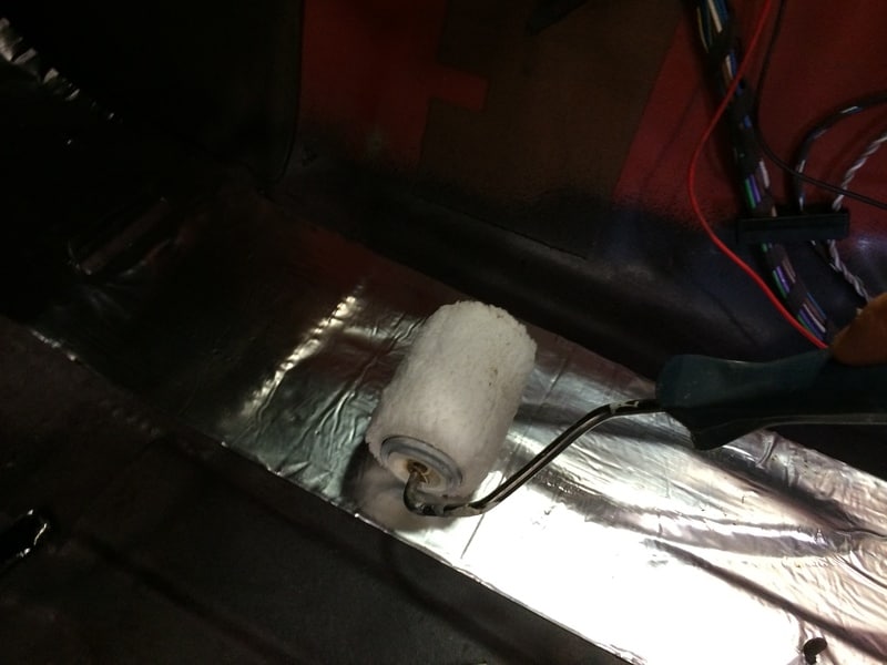

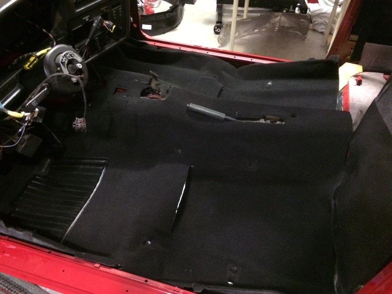

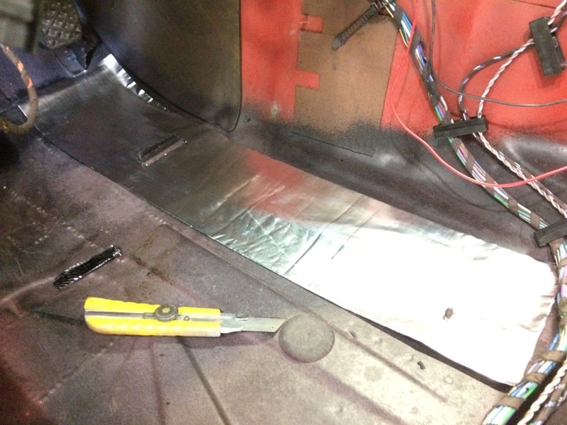

With the herculean task of jamming the dash back in place my attention now turned to sound insulation...
I could have bought a few rolls of dynamat and set myself back many hundreds of dollars but I opted to buy the exact same thing at my local big box store and pay about 90% less...
Its simply tar with a aluminium liner used for chimney flashing... love the name: "RESISTO!"
Cut out a strip..
Quickly apply a little heat...
Press and/or roll it on...
Nice...
I used three rolls and I doubt they added up to a kilo in weight.. . total cost under 50$ cdn...
Guess I will go find that carpet that must be lying around somewhere and see if I can get it in....
Cut out a strip..
Nice...

With the sound insulation in place and the dash area wiring "sorted" (read: untangled as best as I could figure) I went looking for my resto'd carpet which, conveniently, was laying on top of the snowblower...
She had been like this...
But got her looking like so...
I remember 50 million years ago when I removed her, it was a "challenge" to get her out... I was hoping getting her back in would be easier...
Oh, crap! That was too easy.. I must have done SOMETHING wrong...

It is an easy job if you do it without the heater box fitted, or as in your case have cut out the section of carpet that runs under it.
Does looks so much better dyed black!

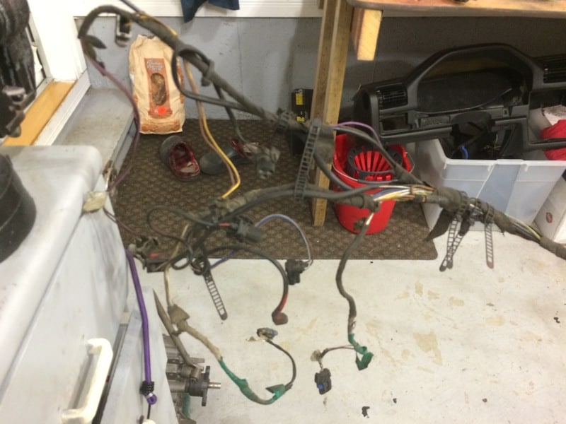

Warning:
The following post contains images some viewers may find offensive and/or disturbing. Viewer discretion is advised.
Yup. Wiring loom!
63 million years ago...
The horror...
Look! Someone's cut them ALL!
Uggh...
It was all so bad I put the whole thing in a garbage bag, taped it up and its been WAITING for me ever since...
Yup. Wiring loom!
The horror...
Uggh...

As it couldn't be avoided any longer, I opened the bag up and decided to deal with the inevitable...
Where the ABS got cut out...
The whole thing was full of grease, oil, dirt, wiring falling apart, broken connectors and a few "mystery wires"...
I steadied my nerve and got out the only tool I knew of to deal with this devil's breakfast...

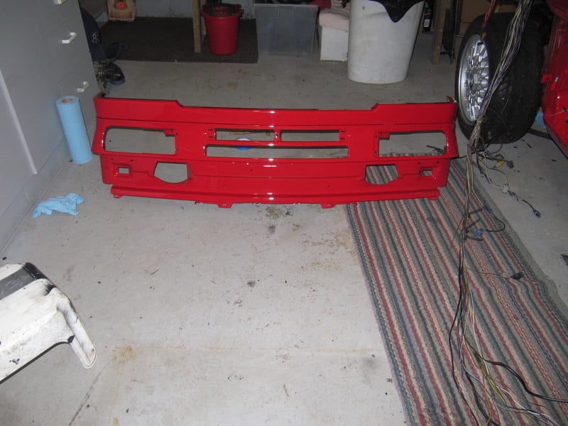

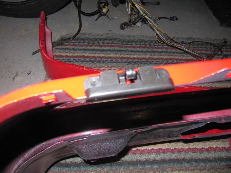

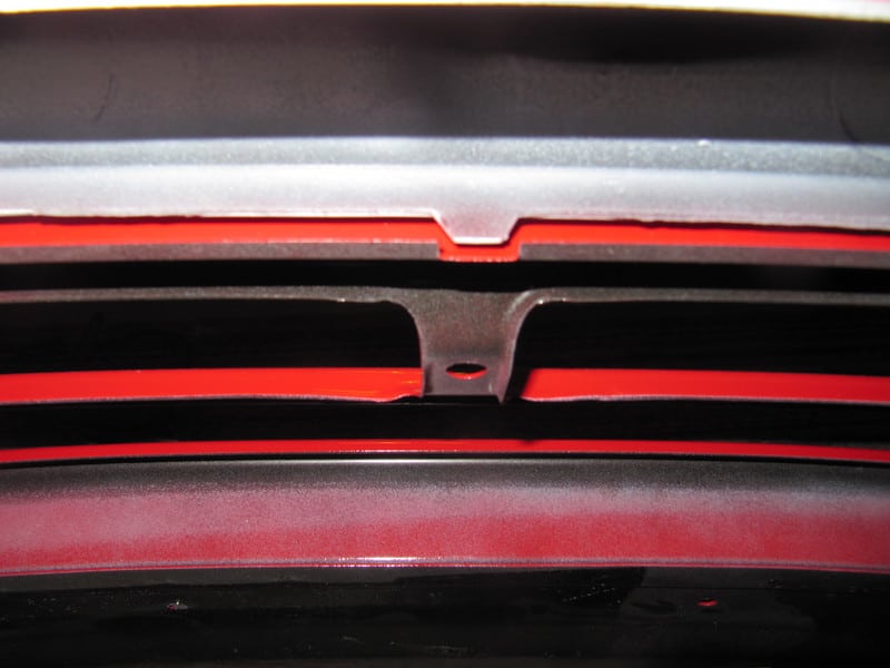

So you want to fit an iS lip?? Here's how..
Order these: 10 to be exact..
Put them in these holes..
Like so..
You will need to tap down these little holder pins.. Go slowly..
the clip is now locked in place..
Proof...
Place your lip in position, here you see the center marking point.. line it up..
Get the edges equally in position and slowly push the lip into the clips equally..
That amigo's is the cat's meow... that wiring loom you see on the right is another story....
Like so..
Proof...
