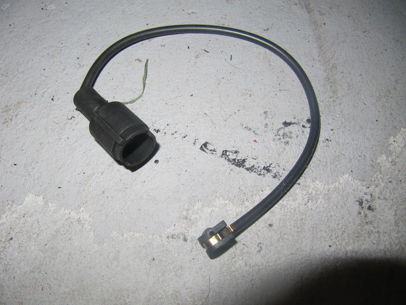

The RH rear wheel will also need the brake wear sensor..

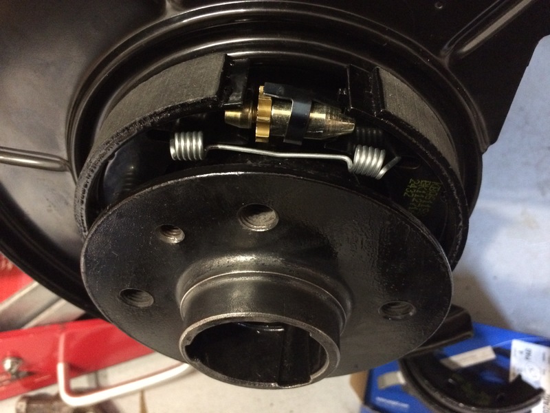

With that in, fit the adjuster in the top indents and place the retaining springs in place..
There are two retaining springs (the LONG ones). One is curved the other is not.. The curved one goes on top, to be placed under the adjuster and the straight one on the bottom along the expanding lock..
You can see them clearly here...
Place one end in the made-for-just-this hole of the pad..
Using a pick with a 90 degree curved end pull the other end into the opposite hole.. It WILL be fairly difficult.. VERY difficult if you're a complete PANSY... :D
For the top one, be careful of its orientation, place it so the curve allows the adjuster to turn.. Make sure they are fully in too...
Do the same with the bottom one.. and the parking brake setup is done..
This pic shows how the adjuster is adjusted.. Nice eh?

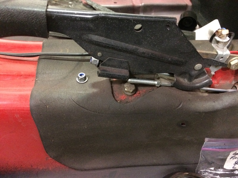

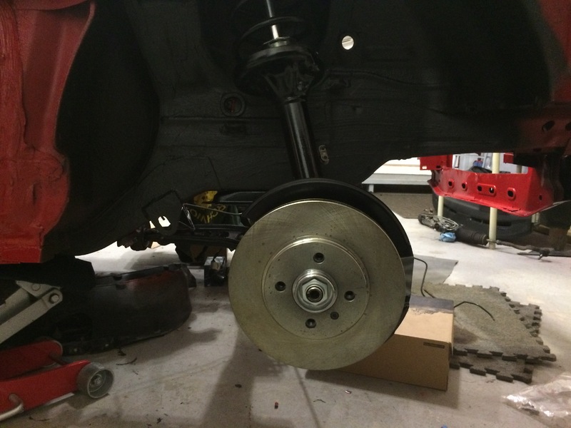

What you want to do now is put the disk back on and tighten up the nut on the parking brake cable you loosened. About 7-8 threads showing is good.. Then turn the disk and listen if the pads are rubbing. Adjust the adjuster (downwards motion expands it outward - if not its the opposite!!) until the pads JUST rub and then back off a bit.
That's it. 8)
It's VERY important that you don't tighten the nuts on the handbrake lever enough to start moving the expander. Best to leave them right on the ends of the thread until the shoes are adjusted at the hubs on the star wheel, then tighten them so that you get both wheels to lock with the lever on about five clicks.
I purchased FEBI cables and with about 7-8 threads showing after tightening the nut there was no expander movement. Other cables may have slightly differing lengths which may make your experience different. Great point though!
A bmw manual I referenced said 3-4 clicks max to lock up the wheels.. I imagine anything close to that is good as long as it DOES lock up.. It will require more clicks to lock the wheels as the pads wear....
As I've done it she locks up at 2 clicks and doesn't rub. So Im happy.

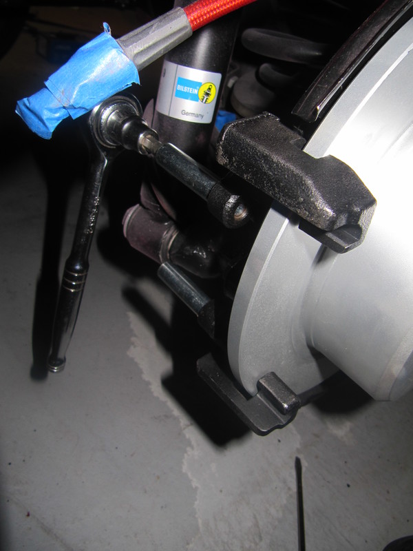

Calipers were next..
I had these rebuilt right at the very beginning of the resto..They've been sitting in their boxes for quite a while!
Carrier first..
No need for me to compress the piston, it was already done..
Slotted the pads in with anti-squeal already on..
Place the caliper over the disk..so easy...

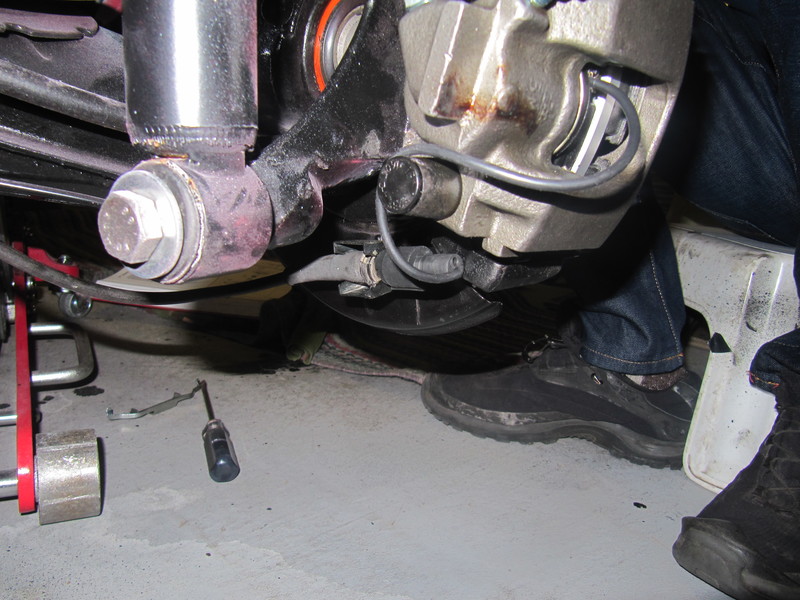

PS requires the brake pad wear sensor...
Pops in right there...
That plastic cap holds the brake pad wear sensor where it connects to the line from the car.
Temporarily routed.. There is a clip which I dont have which is used to hold the cable at that point.. I will get it..
Press on the anti-rattle clips and that's it..
The bottom sure is dusty.. Got to clean that crap off...

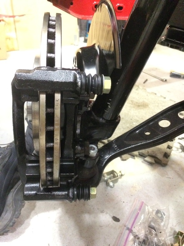

Front brakes..

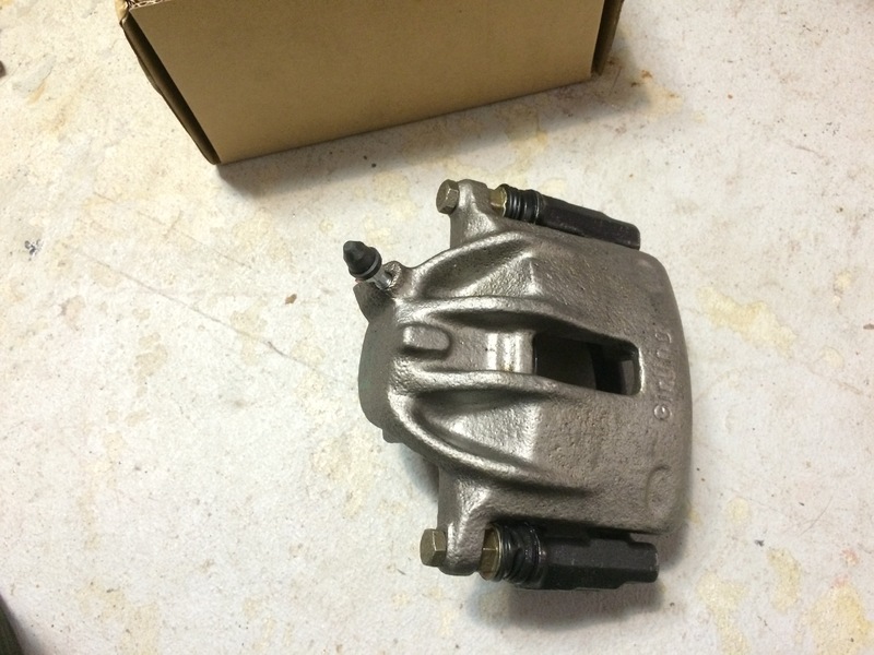

This was new for me.. E30 brakes are a wee bit different from newer BMs and the M3.. Still I think I figured them out..
Rebuilt calipers..
and new pads.
Not sure I'll need it but anti-squeal applied..
Standard rotor.. boring but effective...
I must have done something wrong because it was TOO easy to assemble the front brakes...

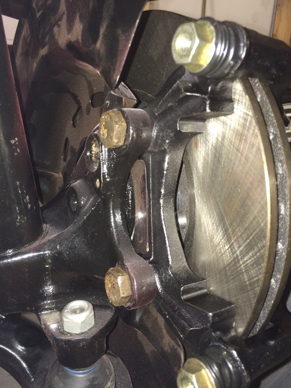

Carrier first.. 2 17mm bolts...thats it...
Pads first.. This took me a while to figure out...

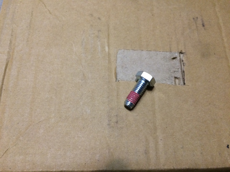

and the ONE new bolt for the caliper (takes two but its meant to swivel, so just replace the one you remove)
Caliper next.. brake line screwed in first...
On and brake pad wear sensor in place...

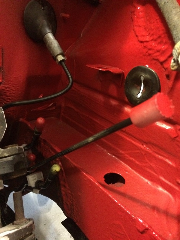

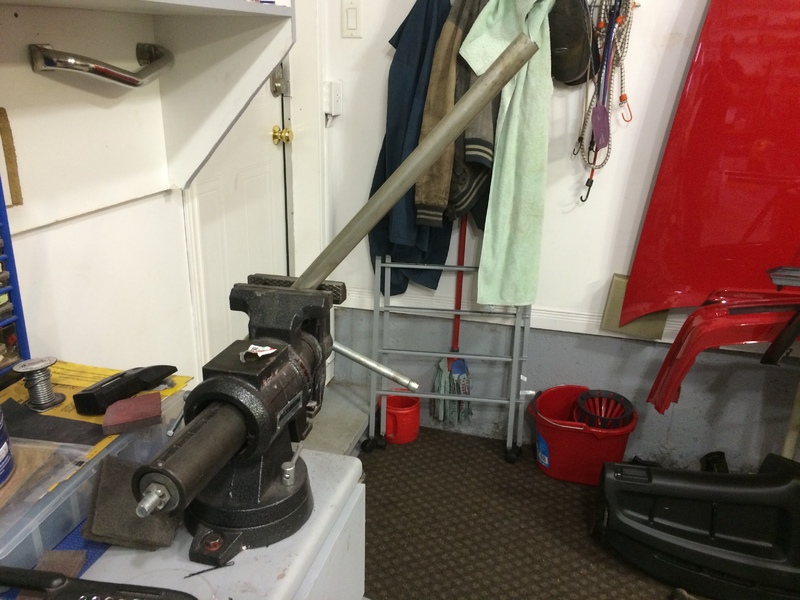

With the front and rear brakes in I turned my attention to the lack of brake lines in the front.
I love brake line bending.. Very ZEN when it goes well.. Not so much when it doesn't...

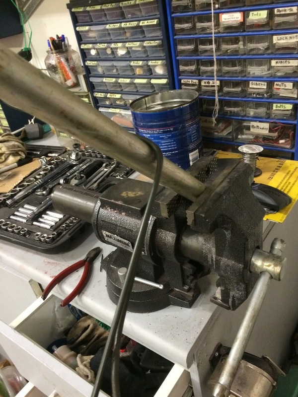

Bottom one is the old front right brake line...
Get the specialists tools out...
Couple them together and match the bends..
Getting close..
In place..

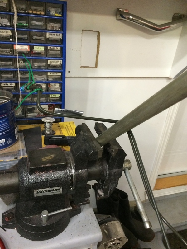

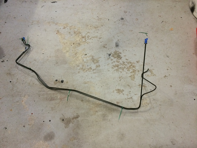

I set that aside and turned my attention to the rear brake line and the bends it was going to require to match it up to the brake balancer.. This part tortured me when I did this on the M3 (of course the engine was still in place!)
That rear brake line is over 3 meters long and I had to get it right the first time.. So I used a length of electrical wiring to get the rough form..
Happy, I hoped for the best and started bending..

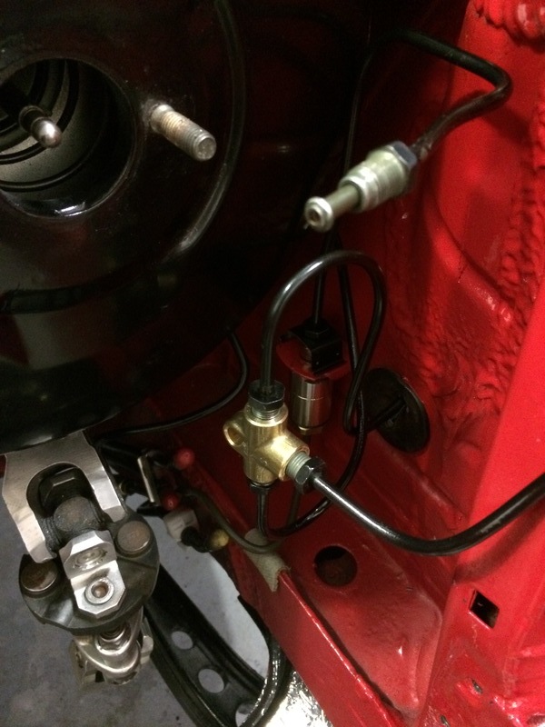

Next was to figure out my ABS DELETE brake line jigsaw...
Split_S
POR 15 junkie
Posts: 529
Joined: Sun Jun 16, 2013 11:00 pm
Location: Canada
Wed Jan 13, 2016 8:37 pm

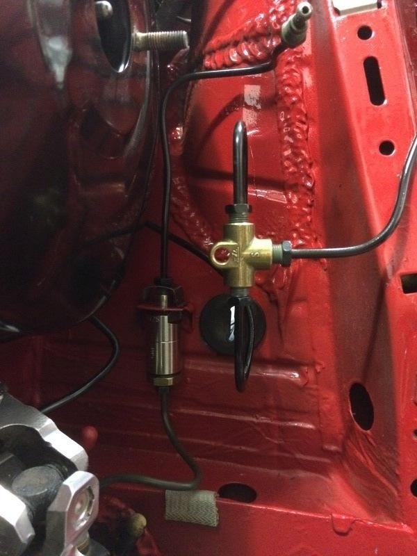

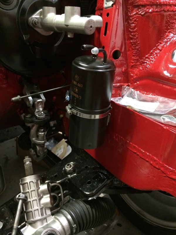

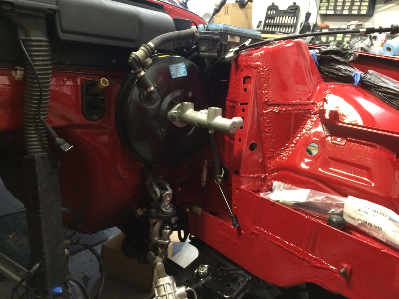

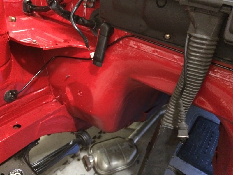

With the rear line to the brake balancer done I now had to reinstall the brake booster and MC to get the dimensions right for the ABS delete lines I had to create..
So..
At this point I haven't reconnected anything in the cabin as Im not sure if I will need to remove them again to fit the engine.. I dont think I will need to remove them but who knows...
To be 100% I also installed the throttle bracket and power steering and charcoal canister brackets...
With all the stuff that could get in the way I started bending..
I did it the hard way as I used pre-flared piping which was stupid really since I purchased a bubble flare kit the works great... Go figure... :?
Once bent they were painted...
Installed.. (I may have said a few bad words getting it all to fit..)

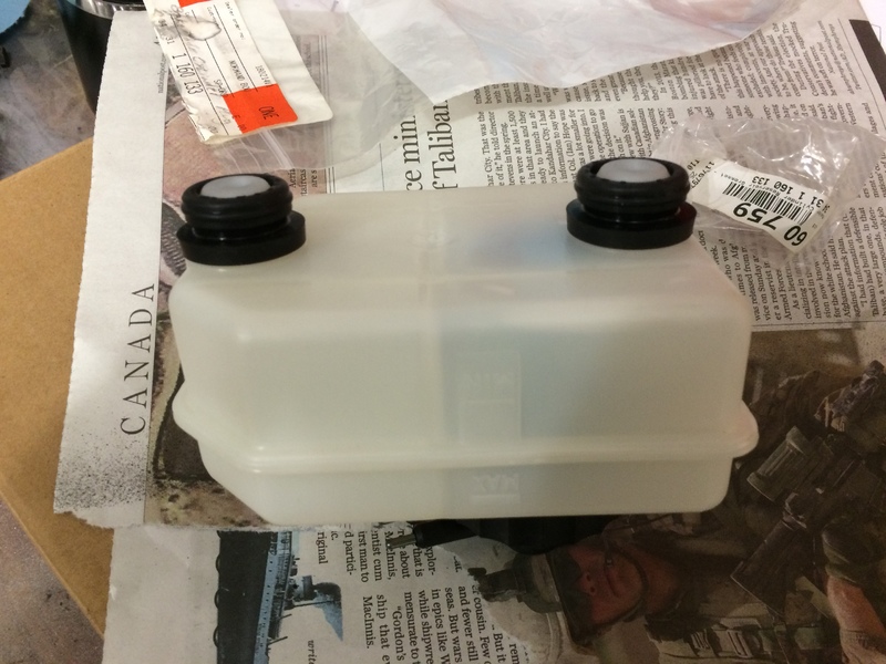

With all those shiny new brake lines showing I realized the MC looked pretty shoddy..
So..
Nice...
Dont put in the rubber gaskets on the MC like in this pic..
Instead put them on your new MC reservoir like this..THEN press it into the MC.. Ask me how I know this... :?
With that the brakes are done. I will find out later if I did them right once she is filled with brake fluid and the engine is running..

Split_S wrote:With that in, fit the adjuster in the top indents and place the retaining springs in place..
That's it. 8)
