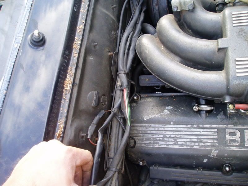

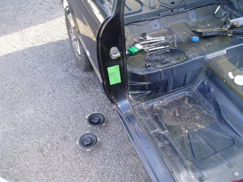

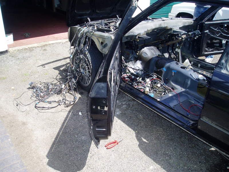

Right had a good crack this evening after work, dash out, engine loom, stripped the boot down, all the stereo wiring (sp), heater matrix out and half the old Cobra alarm system which is a challenge as they fitted it pretty well to my eyes! They must of had fun installing it all those years ago.
I originally thought this was aload of crap done on the engine loom, not so. It's the old alarm stuff. So i don't need another engine loom
Why do people do nuts up so f**king tight?

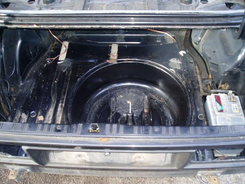

Boot stripped, theres som nice dents in the spare wheel well, how they got there i don't know!

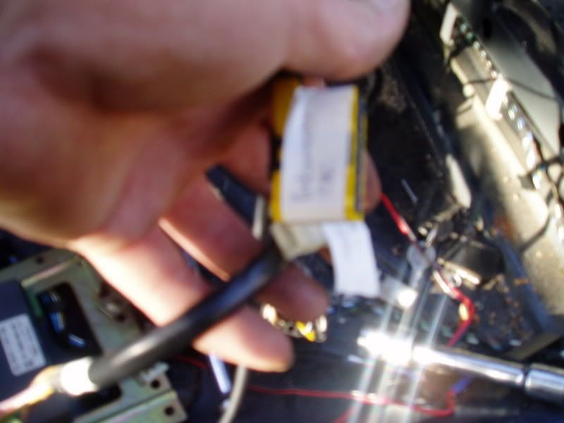

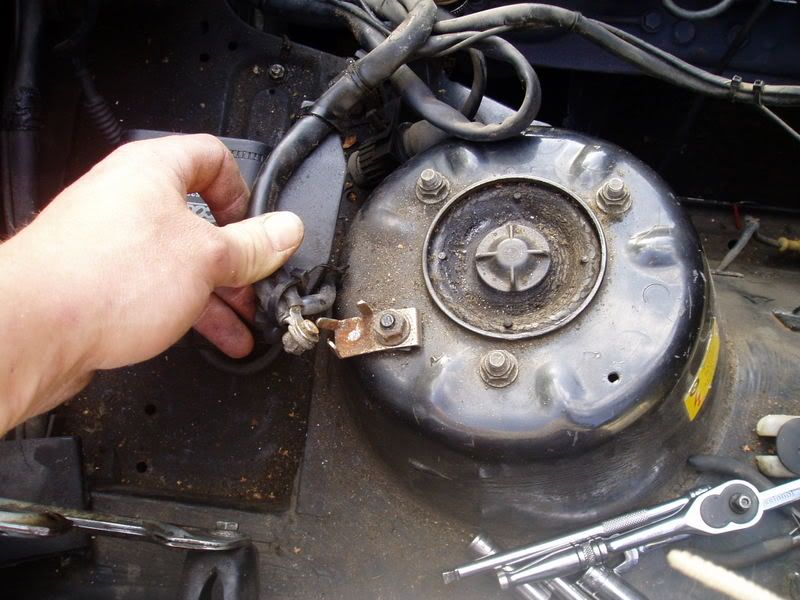

Labelling the car loom up as you can't remember everything- wicked tip given to me by Mr Oldskool

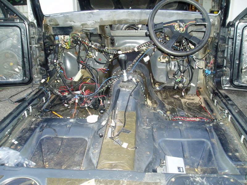

heater box out and dash. I looked at all those wires today and thought Jesus f**kin Christ. Forgive my rudeness, but the show will go on!

Good work dude.
That last pick looks shocking though, will you be taking all that wiring out too?
- Posts: 22697
yeah man it's all coming out, gotta be done as i want a bare shell to give it some loving to the rustical areas

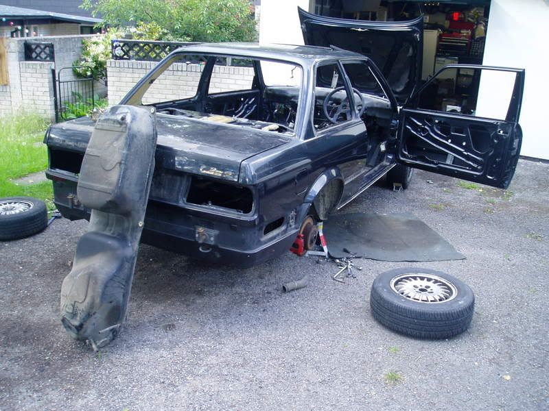

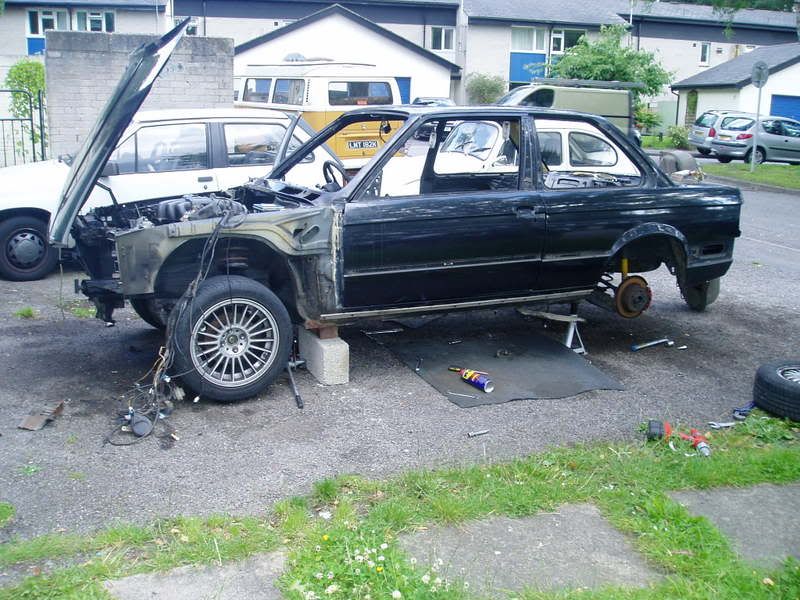

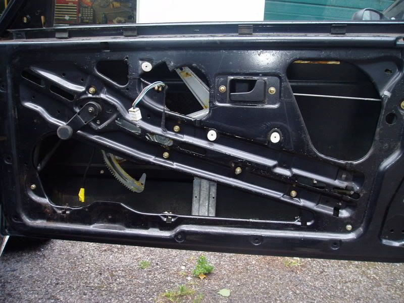

Been a while but i have been busy! I knew there was a lot of work stripping but as always theres more to it than you think.
doors stripped now and very light! passenger door is badly aligned i can see now as it never shut properly

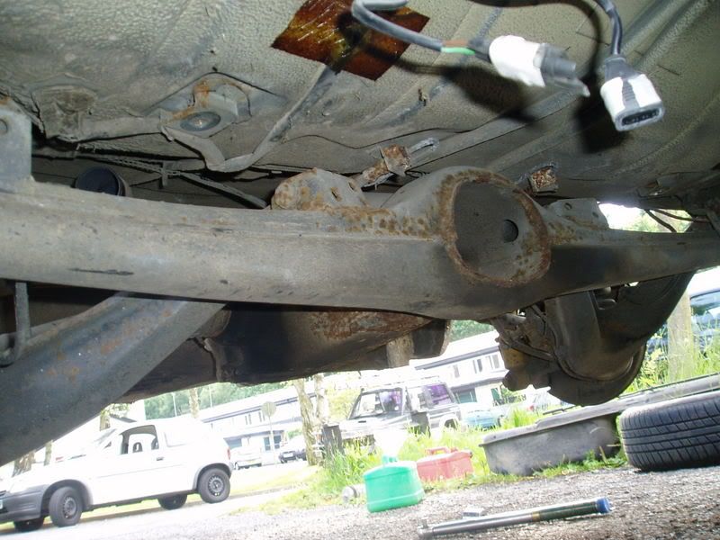

In my quest to remove the cars entire wiring loom i've had to remove everything to get it out. Not for the faint hearted and giving me a fright about refitting it

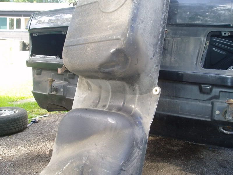

but the show will go on! So i dropped the prop, fuel tank and all the lines on Saturday.
Nice dent......
tank out and lots of space to sort new brake and fuel lines
and any rust!
filler neck and that all out now, Can you buy new stuff and goes through the metal whole? theres 3 pipes which slide into it. Sooooo much dirt wedged all in this area it was almost like concrete! It's not too bad here for rust either which is a relief just 2 plates needed me thinks

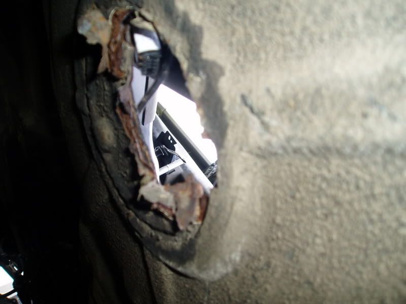

Can you see the sky through the floorpan and sunroof?

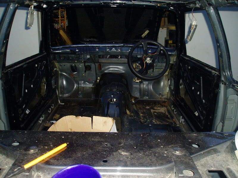

loom gone and all sound deadning (sp) plus pedal box

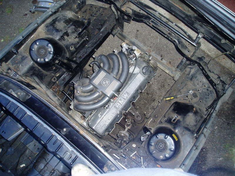

Just the engine left to come out now, all nuts, clips etc all removed from the front end now aswell
So only engine to come out now car is ready for some rust removal, which should hopefully start in the next few weeks!
