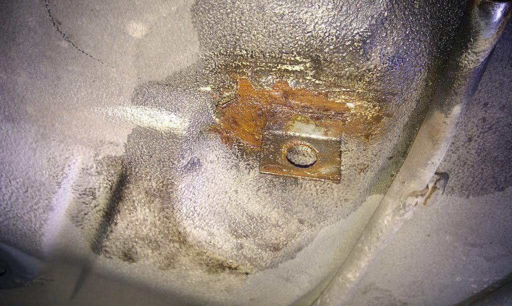

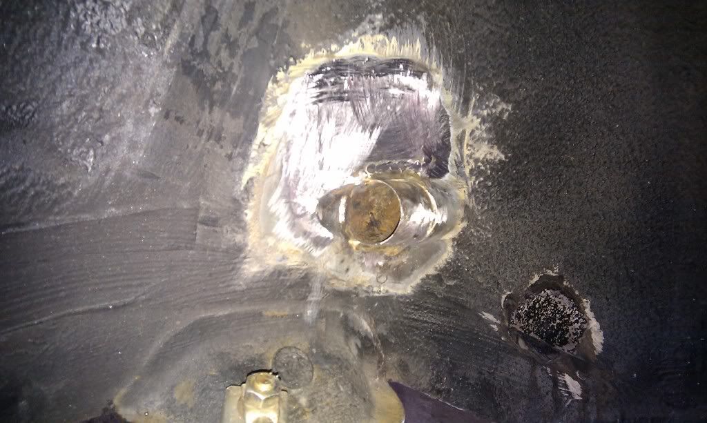

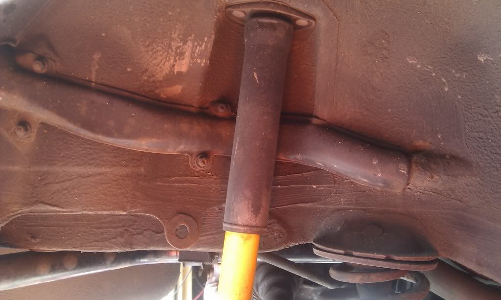

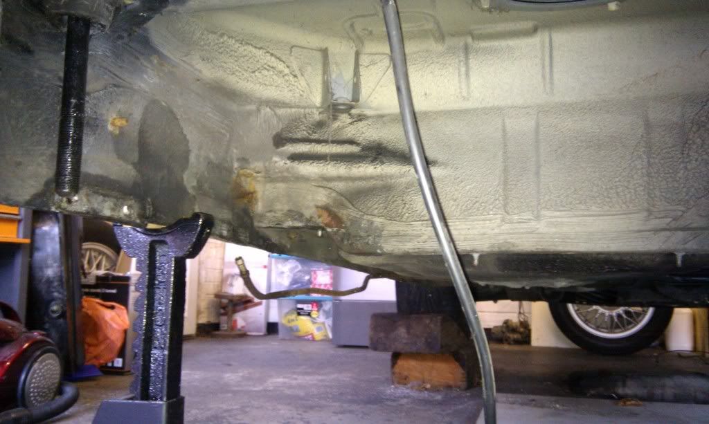

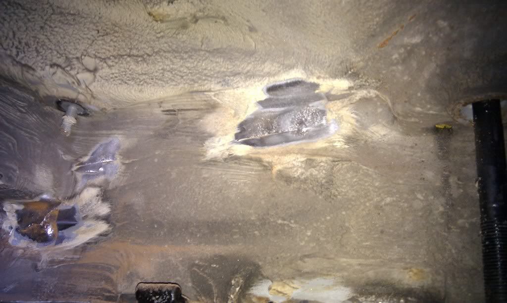

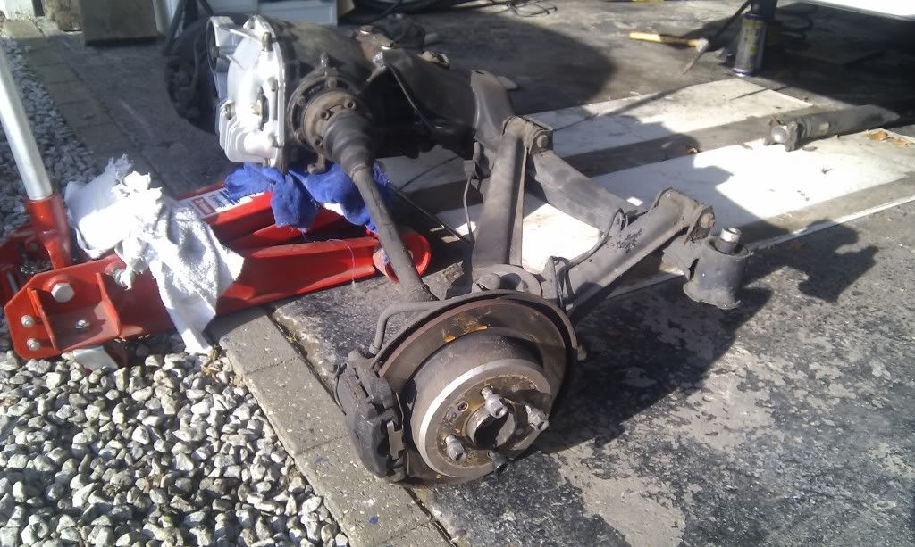

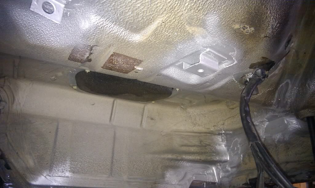

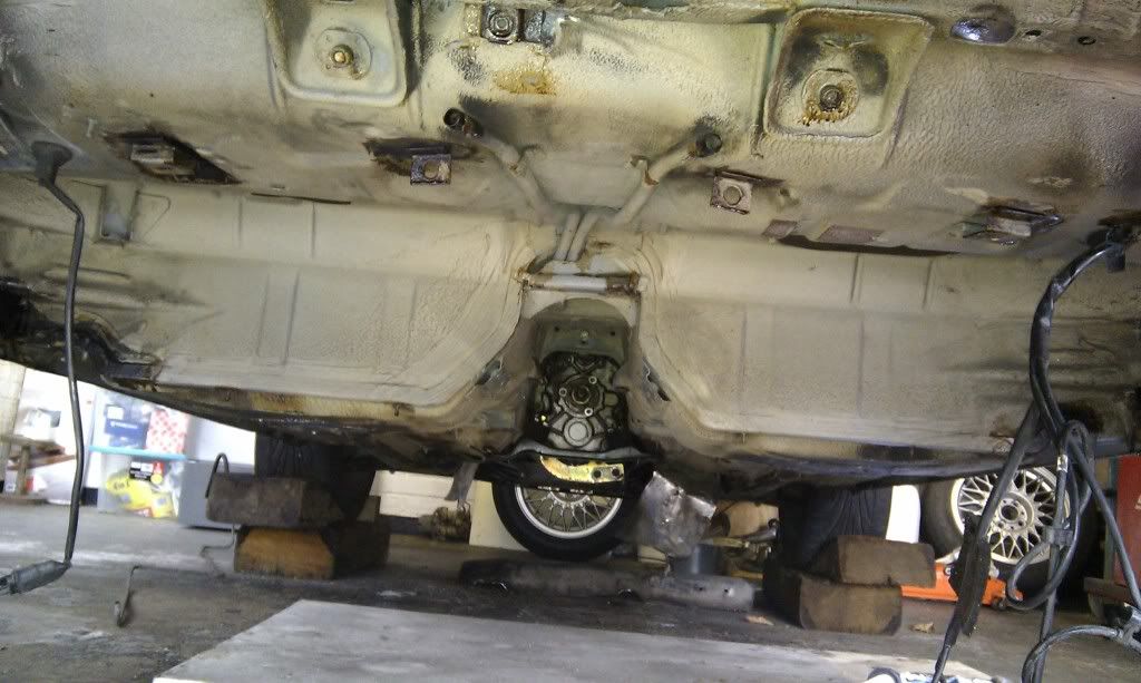

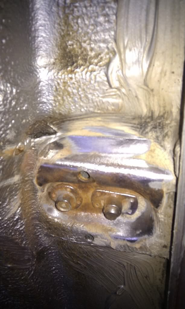

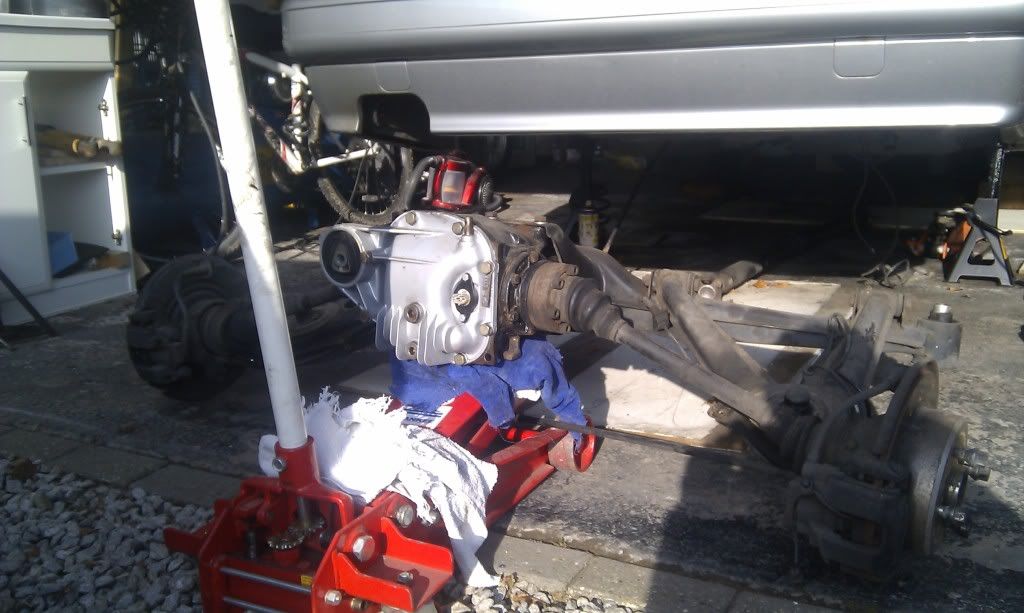

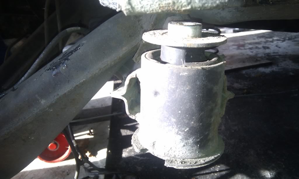

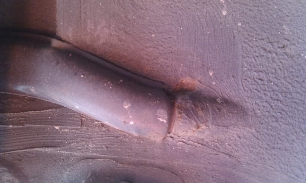

I thought it was about time I pulled my finger out and got on with sorting the underside refurb of the sport.
I basically bought all new shocks,springs,bearings etc for my old rusty turd but when this turned up just couldn't carry on with my original black sport.
So the plan is to pull everything off the underside of the car and either to replace with new or refurbed parts much the same as diddler, simon13, topless to name a few.
I managed to remove all the rear subframe, fuel tank, brake lines etc over the past two days and started to remove the under-seal where it has disculered with rust. 8O
Its surprising what lurks benieth what looks like solid underseal.

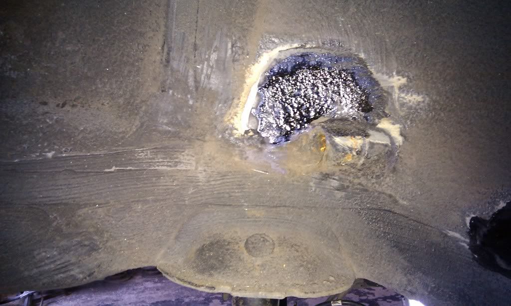

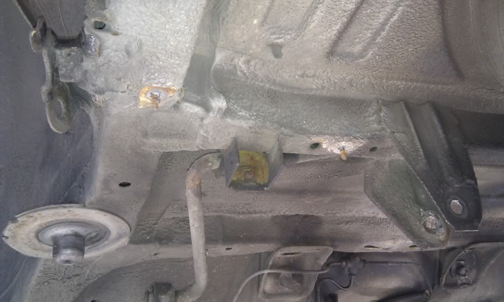

This is the only disappointing part I found after a real good dig around. Everything else on the shell is rock solid and Mats work is really standing the test of time.

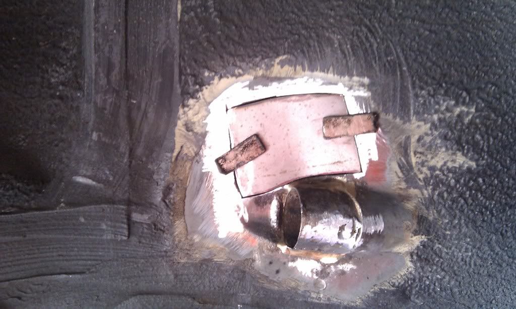

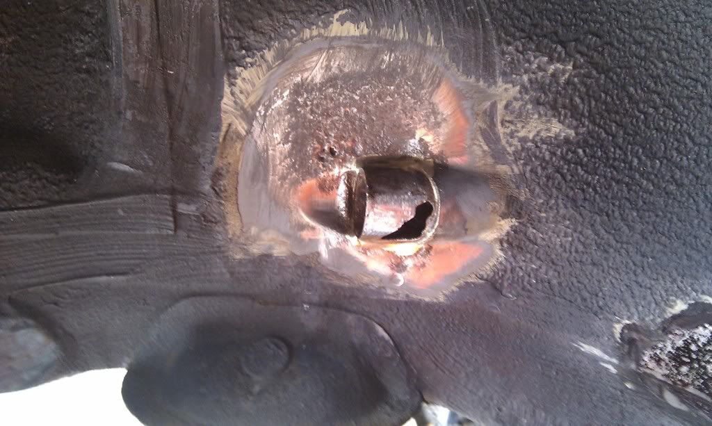

This is the section were the fuel tank filler pipe runs through the inner inner arch. It needs chopping out and doing properly as the metal has some tiny holes in it. Its the only metal work needed. The rest is all savable.
The plan is to treat the areas with fertan then zinc prime,paint and then re-underseal. I will then rebuild the arse end, do the same with the front before going to Mats for the metal work and some paint.
I'm going to need some advise on the best products to use for this job.

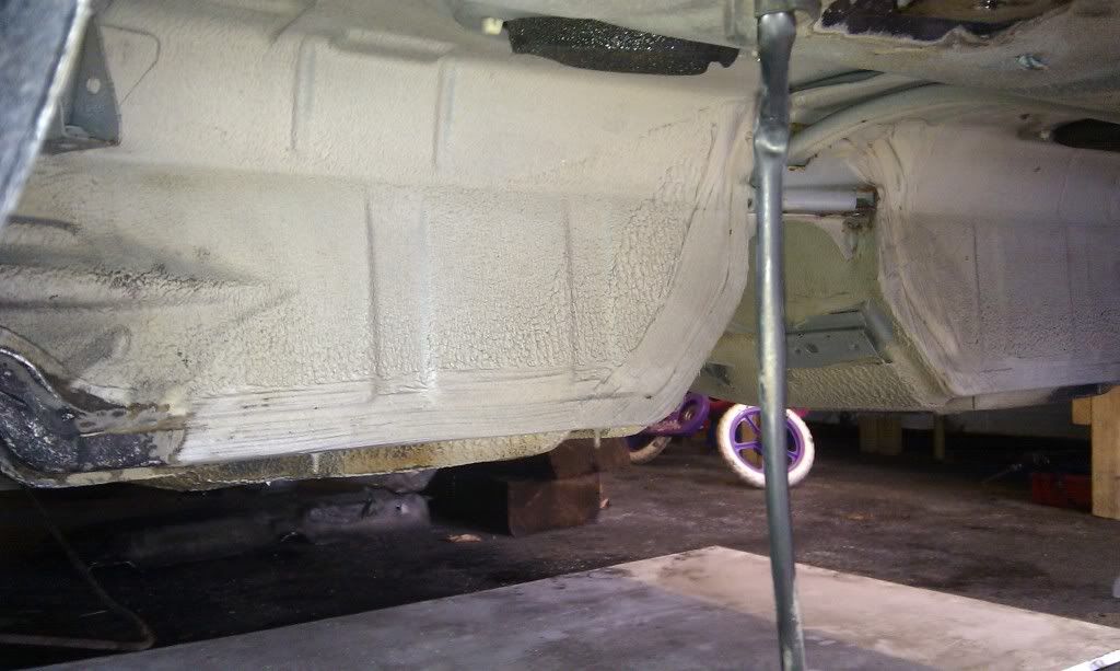

Some pics of the tank area.
Time to crack on as I want this done for the pod :mad:

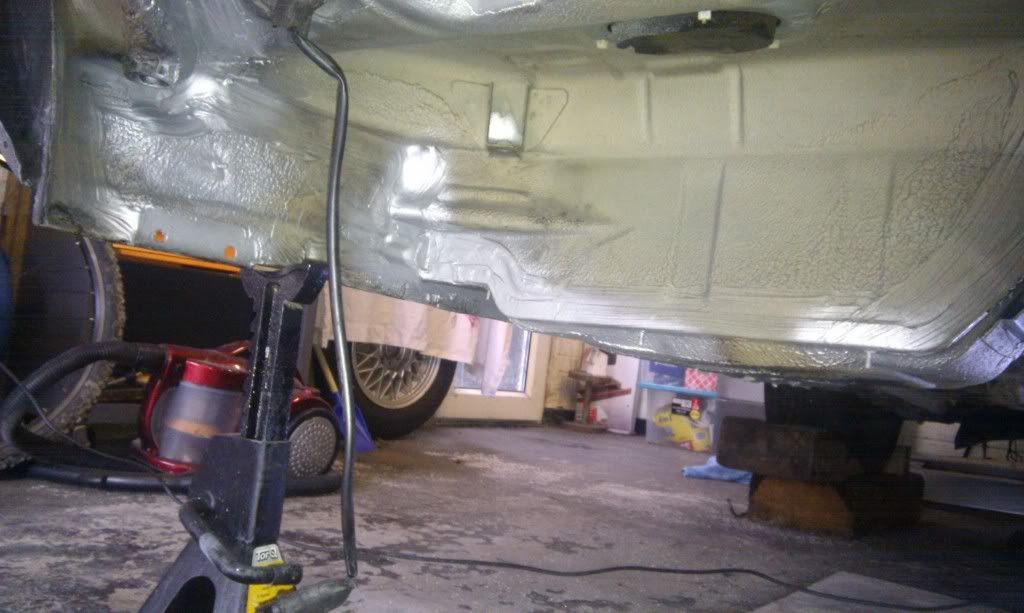

A quick update.
Well I got out the TFR and a selection of the wife's scrubbing brushes and set to cleaning all the grime off the underside.
I was using the TFR neat in some places and managed to burn my shoulder in the process but it was worth it to have a clear rear end :D
Some before and after shots

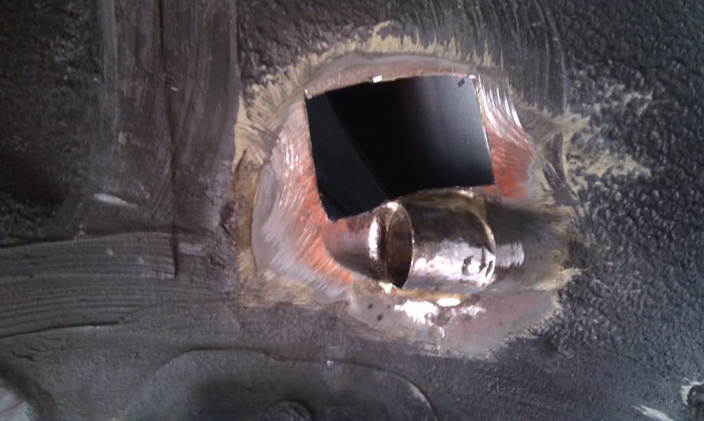

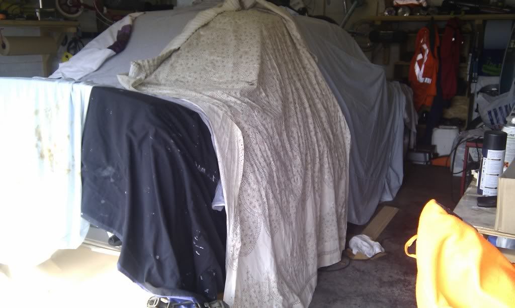

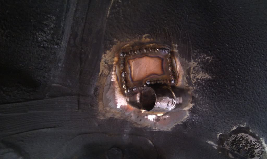

I then hit all the little areas of under seal that had swollen up with a wire brush. Rust treated the area's with Fertan and then zinc prime and re under seal.
Then out with the mig :D I couldn't leave this bit of rot in so I had to fill the hole in the tube using a little fillet piece and a brass bar to fill the hole. I then cut out the bad section and blasted in a new piece. I also climbed in the boot to weld the inside the inner as well just for good measure.

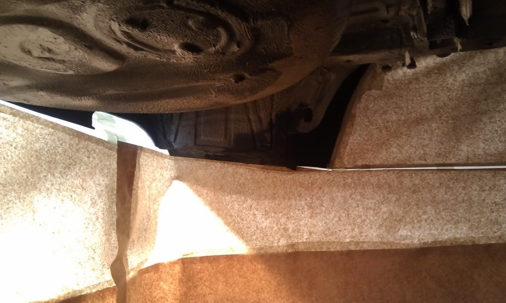

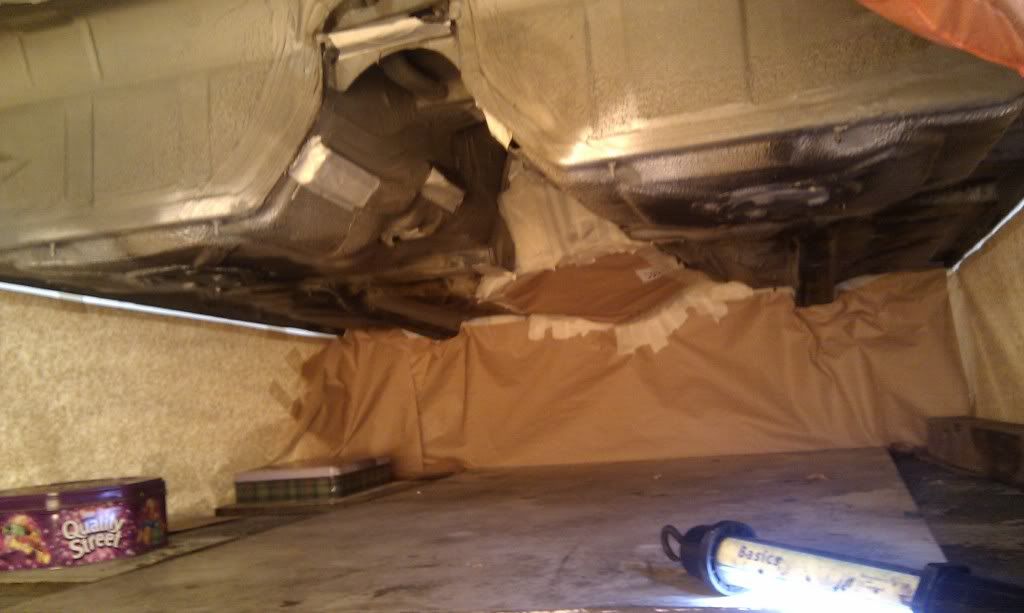

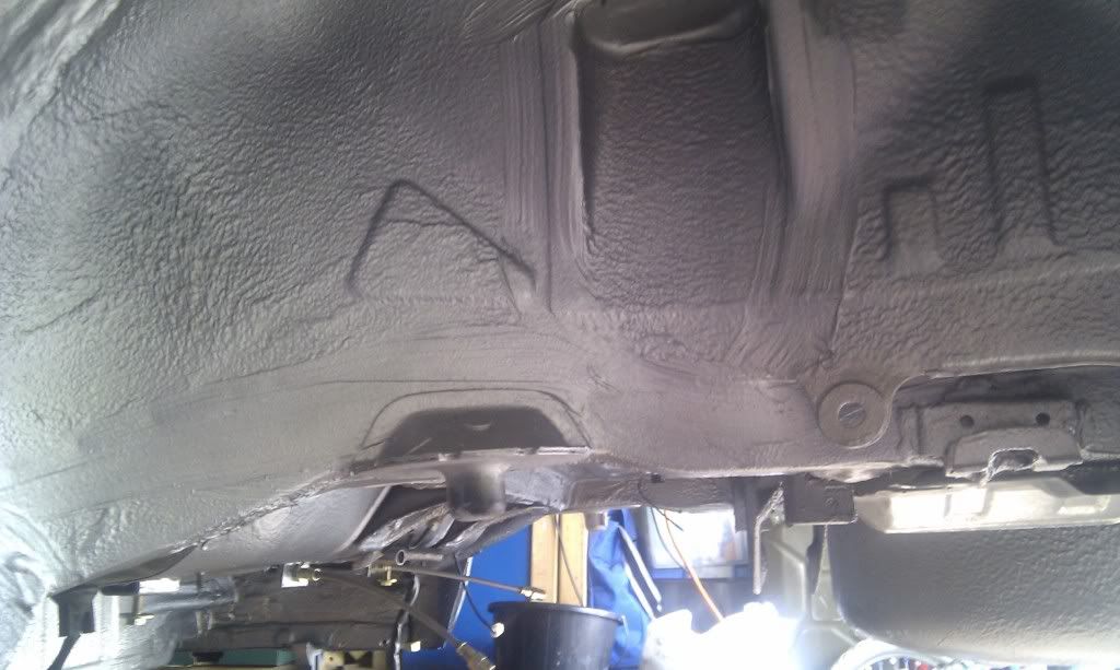

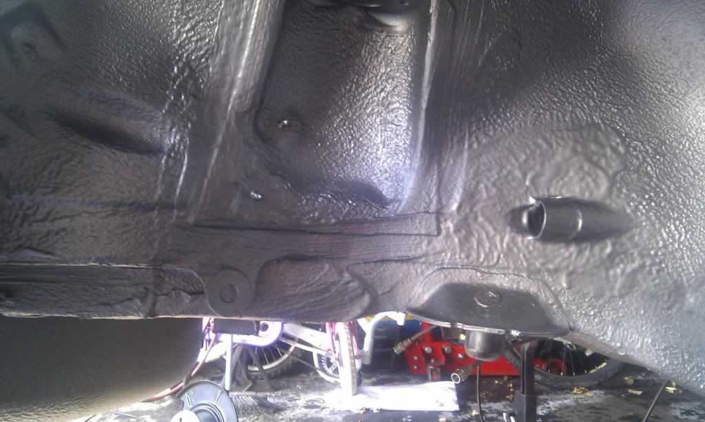

I then made a temporary booth under the rear arse end ready for some anti gravel/stone guard. Its really difficult to get a body colour match mixing paint and anti gravel together.
I made the mistake of not wearing any mask whilst under the car :o: It really fooked me up. Went all dizzy and sick. I can strongly recommend leaving this to the professionals.
I'm not happy with the colour finish underneath. It looks almost like I have covered the car in primer although the texture is right the colour is not what I wanted so the plan is to flash over with some tins of silver.
I will get some more pics up when my headache and munches disappear.

There was quite a few frilly bits that got replaced by Matt a few years ago, just goes to show what can be lurking beneath
Kos
Posts: 15448
Location: London / Cyprus
Post Thu Mar 29, 2012 10:44 pm
scott180gtb wrote: Image
blankets FTW :D

Kos that black one must have been wrapped around some frag you sold.
Bed sheets like a Plasterers Radio winkeye

I'm glad you all like my selection of blankets. The black one spent most of my teenage years glued to my bed. Lets just say "Only the corners needs starching". :D
As for rust. If I hadn't attacked the under-seal you would have never of noticed what was underneath. Its all good now though.

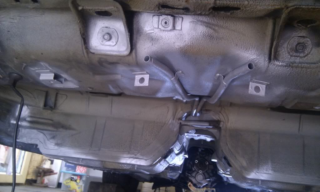

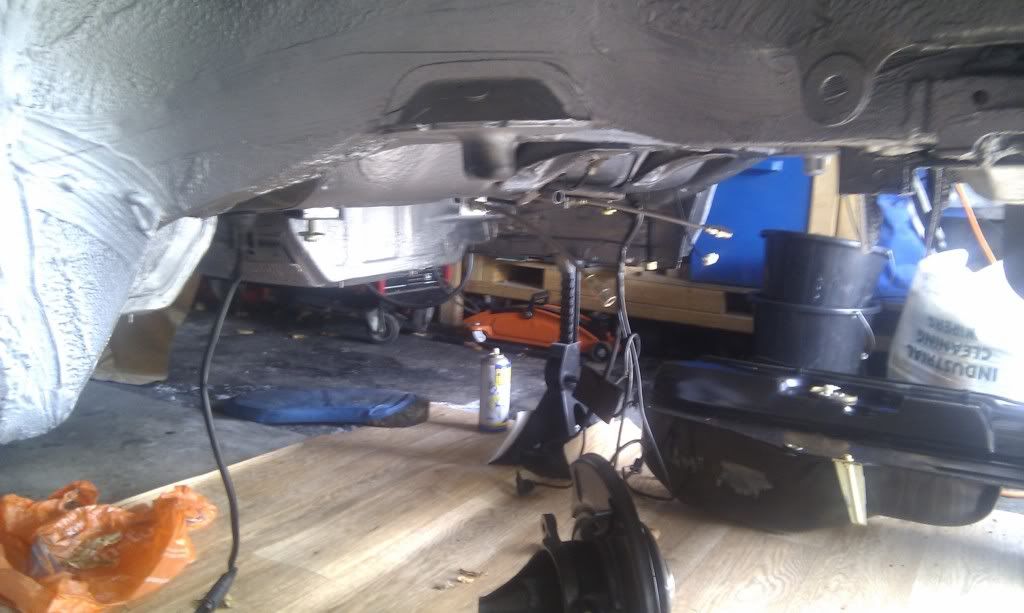

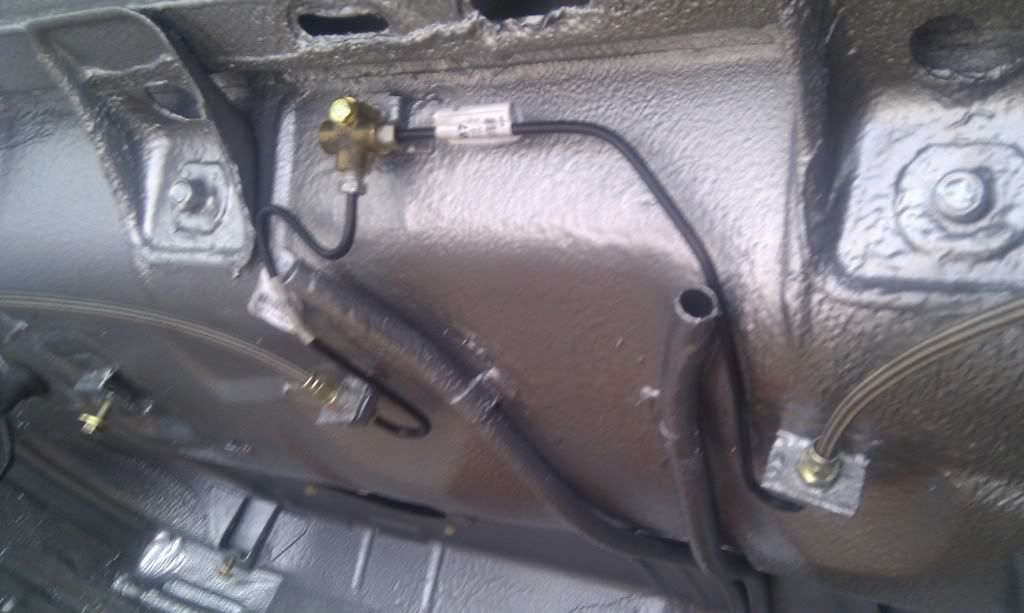

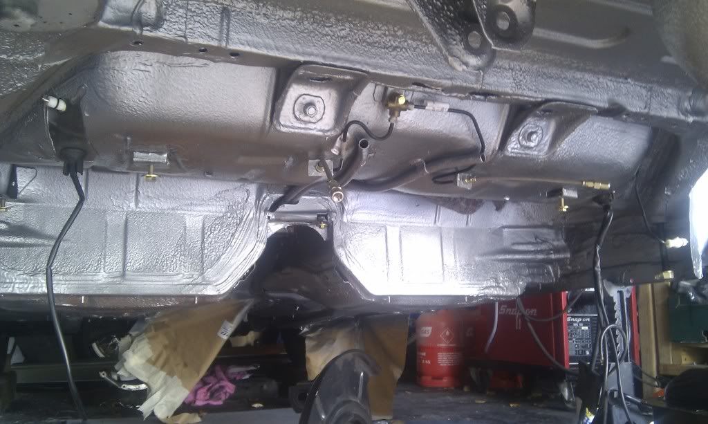

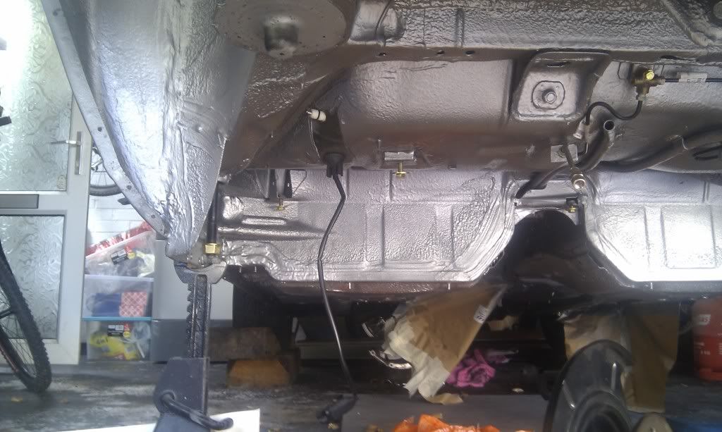

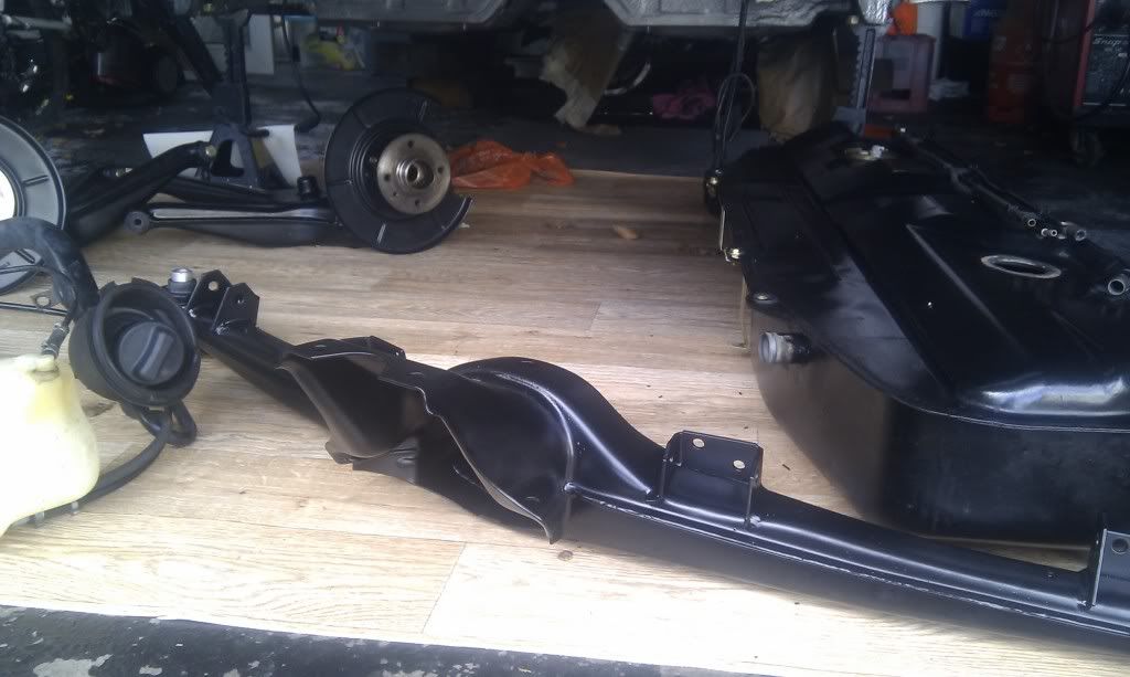

A quick update of some recent paint action. The pictures really don't do this justice.
I had a bit of a day trip down to see Andy for a very good 325 fuel tank. 600 miles in one day.
I've started putting the brake lines back on and should be bolting the rear end back up over the next few weeks. Progress is too slow for my liking but work is mental at the minute. :?

Fook me. I'd not be wanting to drive that now!
You massive hom! 8)

That's lovely workmanship right there. Gonna be one of the best Sports in the UK, certainly in the top 3 - it was a lovely thing to begin with.
