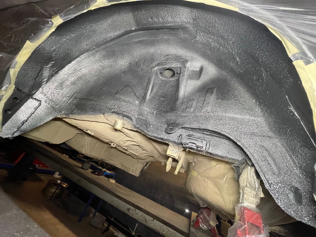

Went shopping today…. Ready to finish the inner wheel arches.
Would fully recommend SPS for anyone in the Northamptonshire area looking for custom mixed paint. Service was spot on, existing car paint scanned to ensure a perfect match too 🤌

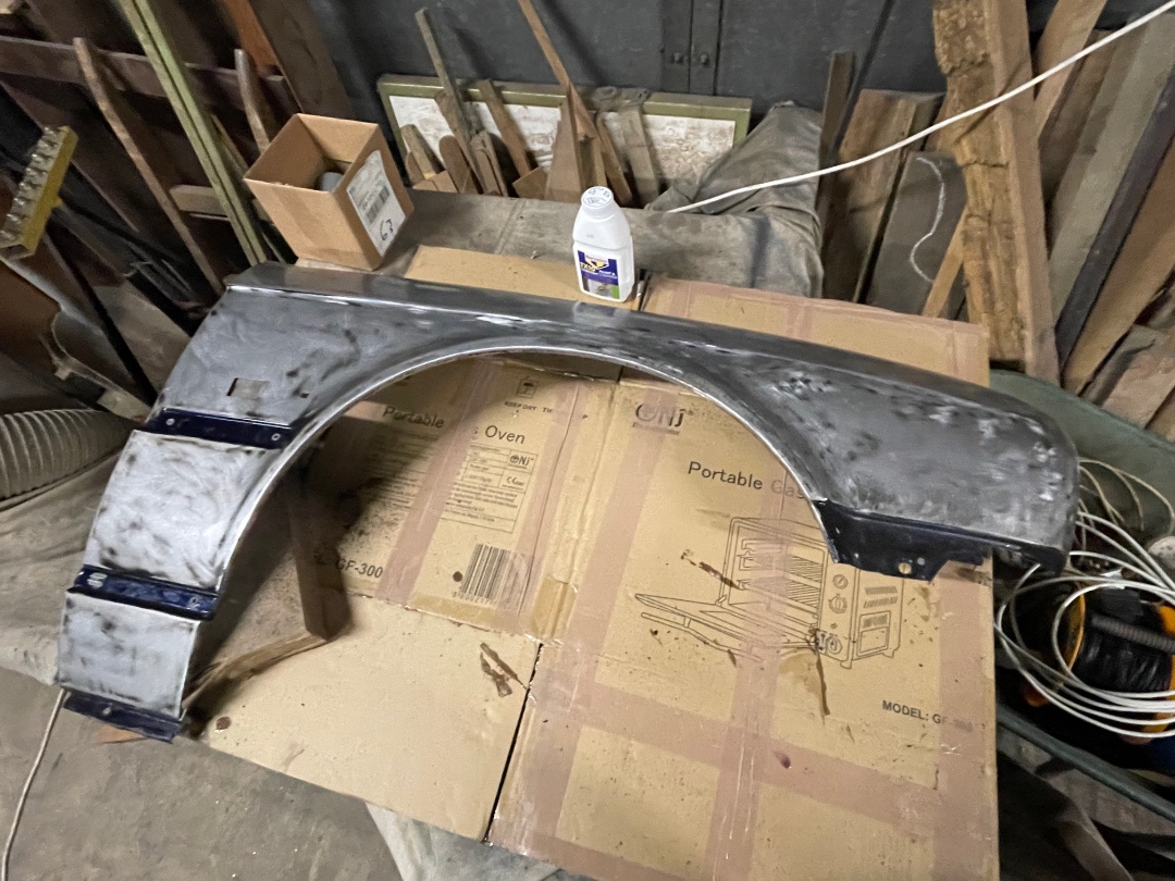

Post Sat Sep 17, 2022 10:49 am
Rear arches restored 👍👍
(Overspray on chassis rail is deliberate, as no masking done in the factory)

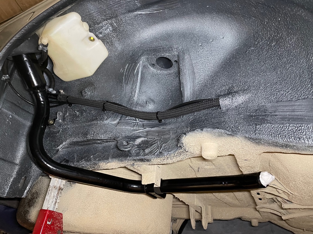

Post Wed Jan 25, 2023 11:17 am
After a bit of a hiatus for personal reasons I’m back at it and determined to get this little guy on the road (new target, sommerfest!) I estimate 16 full days and 30 evenings work, so I’ve got my work cut out fitting that all in around work and other commitments, but we all need something to work towards right?!?
Anyway!
Last nights job was fitting the new fuel filler neck, rubbers and expansion tank. One tick off my very long list done 👍

fixedwheelnut
Posts: 909
Location: South East London
Post Wed Jan 25, 2023 10:40 pm
Anyway!
Never underestimate how much time you waste looking for nut's, bolt's and sockets that you are sure you had in your hand a few seconds ago :D
I worked out I have spent approx. 630 hours on mine so far.

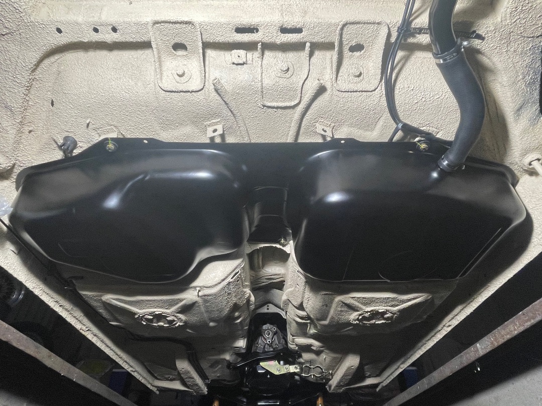

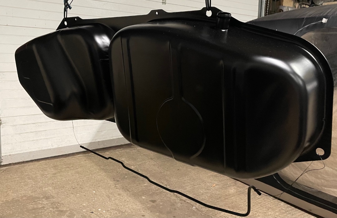

So after spending an age cleaning the outside of my fuel tank, sanding it all (back to bare metal where it had rusted) and etch priming it ready for paint I discovered rust on the top inside (from the car being stored almost full previously)
Annoyed at the amount of time I’d spent on it ahead of this and scared witless at the price of a genuine replacement I tried to use rust remover, ‘made by Ollie’ sender and pump hole covers, 500 washers, as much time shaking the dam thing as mine and my brothers arms would allow and hours of soaking.
Exhibit A:
But a week later it was still not 100%, so I admitted defeat (temporarily, I am hopeful but just couldn’t afford to waste anymore time) and brought a shiny new tank!
BUT when it arrived it was grey, and looked crappy next to my shined new beige undercoat, so attempted to get it powdercoated, thinking of the long game always! But sadly no1 would touch it, to blast or overcoat (and after being told the reasons why I agree with their decision, I might add) so, I spent 5 hours flatting the brand new tank back and giving it many coats of chassis black 👍
‘Prepped’
And Painted!
Next job, fit it! With new hoses, fuel pump etc 🤞

Tell me you’re a perfectionist without telling me you’re a perfectionist……
Decided a new wing was ‘easier’ than attempting to sort the rust issues on mine…. Found a minter but it’s blue so taking it back to bare metal myself before it goes off for paint with the front valance.
I’m a glutton for punishment! These new ‘compliant’ paint strippers are useless!

Productive day of new shiny bits being put back on the car 🫶
Exhaust and gearbox brackets, crossmember and fuel tank including new fuel pump.
