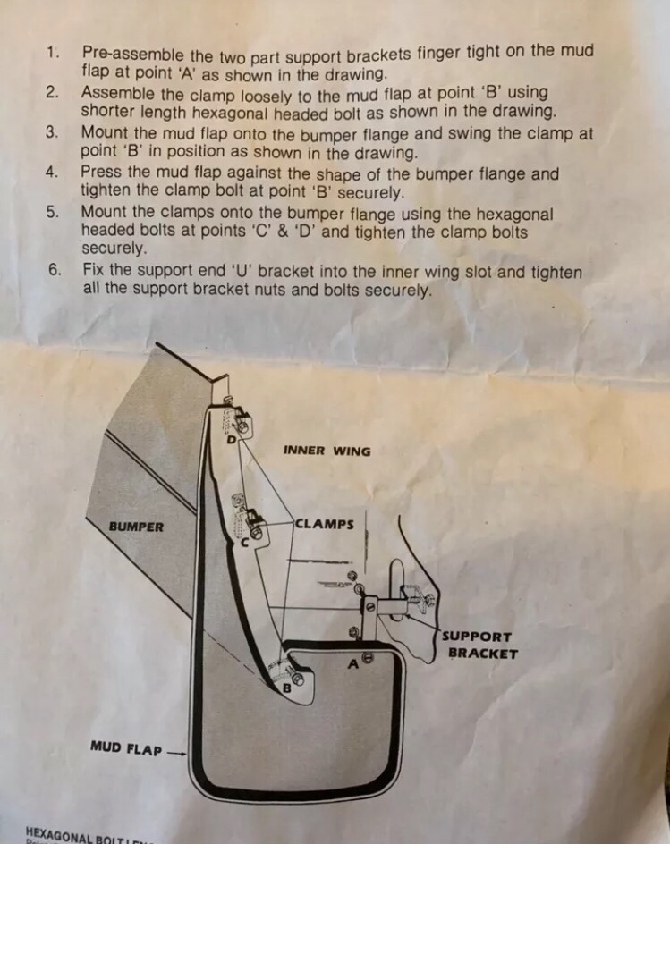

A third question (which I don't have a pic for) is how do the bloody mudflaps mount? They've got that weird metal bracket with a kind of hook at the bottom, all I can guess is that the bracket used to hook on to/around the factory jacking point (which is now gone)? Does anyone have some pics as I can't see a nice way of mounting these...

Mudflaps!!!
The amount of time i spent agonising about these things to just give up and make my own mounts from pictures i found from a group buy on revlimited forums..... i was desperate lol
Ill get some pics of the mounts i knocked up. I only wanted flaps on the rear.
What i did was cut some rectangular strips of metal out and bend two 90 degree corners into them with a hole in the centre part so the metal can hook back onto the lip of the arch and a bolt can hold the flap/ mount in place.
Poor explanation..... ill take pictures of it when its light!
