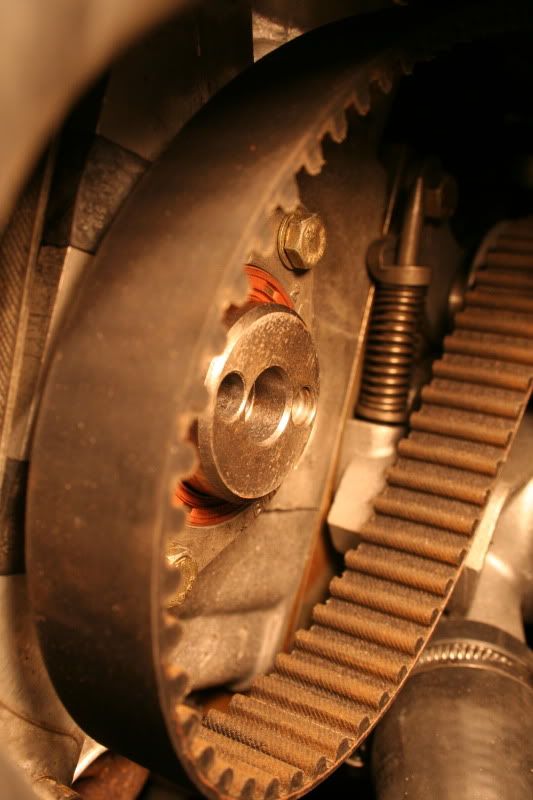

i did the cambelt on the C2 wagon today and i could help but take the pulley off to have a look. Well as you can see this cam is idiot proof like the stock cams. So my question is how the fook is the supposed same camshaft from the same company drilling 2 in now?!
It still doesn't excuse my mistake but people take heed of my failing when using a schrick stick in future i think is the big lesson.

Simon13 wrote:[img]............Well as you can see this cam is idiot proof like the stock cams. So my question is how the fook is the supposed same camshaft from the same company drilling 2 in now?!
My guess would be that the engineer mistakenly drilled it wrong the first time and rather than scrap the otherwise good cam, plugged it and redrilled it in the correct place. Did I read somewhere that you had to push a plug out?
It's an acceptable engineering practice, but the plug should have been an interference fit that you couldn't get out without a press.
Do they all have two drillings? If not, you've a decent case for some compensation.

Simon13 wrote:Image
idiot proof it maybe but can you break it down for the retards? what is it that im looking at here thats the obvious problem?

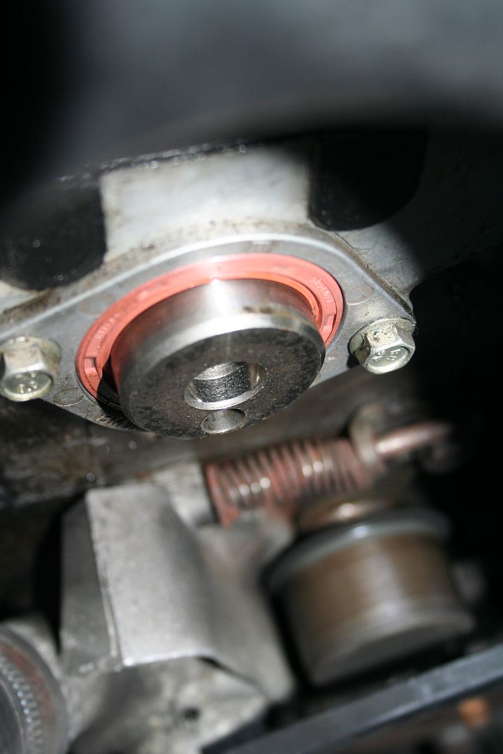

/\ that pic is of the same spec shrick cam from my touring engine.
Now the 2 door one has 2 holes. What threw me was the plug was fitted to the CORRECT hole for the sprocket to fit to. The INCORRECT hole had no blanking on it.So fitted the sprocket on the wrong way from that. I think its a trap many would have fallen into.
As you can see below
its quite clearly here nearly flush with the end of the cam.
Do we really think its worth hassling Shrick or Neil McDonald about this? I bought the camshaft through him

Post Sun Jan 15, 2012 7:19 pm
1 hole to time it from..

You have the perfect proof here. Allegedly the same cams but one with an extra (plugged) hole and the plugged hole WAS THE CORRECT HOLE TO USE!!! :mad:
I'd ring McDonald and advise you intend to make a complaint and then do it in writing.

If you're adding another hole for whatever reason you're going to ensure that it's not exactly the same diameter and exactly the same position from the centre point as the sprocket locator surely?
I think it's worth asking them.

Even with a second keyway in the end of the cam they would probably say you should have confirmed the correct valves were closed, sorry that's probably what you don't want to hear.

Thinking aloud on the cam/claim side of things..... Aren't schrick just going to say, irrespective of how many holes are in the end of the camshaft, the valvegear obviously was not timed up (with the appropriate valves open etc at TDC. I reckon they'll just say their equipment should be installed by a professional and tell you to shove it, but still worth a call.
I would still go to the guy you bought it from though, he may get further with Schrick than you.

I'd email them saying you've received one of their cams with 2 holes, and ask which way to fit the pulley. When they say the larger one (which fits), give them a good legal roasting!
